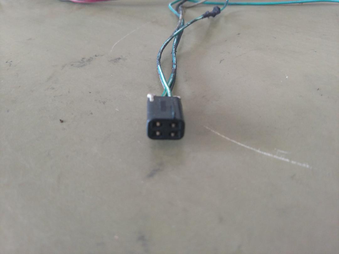

I actually thought I would have more mystery connectors, but I did a decent job of labeling things as I pulled the harness. I can't find this one though, anyone recognize it? It is a foot and half or so from the BCM plugs, it has a couple of wires that go to the blue BCM plug and one that goes to the fuse box.

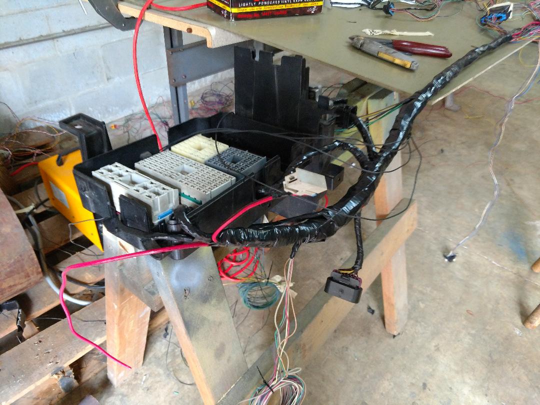

I am on the last harness video! I am enjoying doing it, but I can't wait to get done with it. Scratch that, I can't wait to see if I did it all right and everything runs..... Anyway, the issue I am having now is that the video, and the harness map with the dimensions on it and the 4 x 8 picture do not all agree on where wires go and how long they are. Generally I am just taking the longest option and going with it, I am sure that will make for some extra wire here and there, but I would rather that then having to extend things later.

I can tell you that the lengths in the Main Harness Map from ignition switch and up to the tail light/license plate wires are pretty much spot on. I did have to extend my OBD-II wires a few inches, but that's only because of where I chose to put it.
I also wanted to mention that the Main Harness Map doesn't seem to mention the lengths of the turn signal and headlight wires. So don't forget to account for those. The turn signal wires can leave the bundle around the area of the OBD-II and cruise control connectors. Route one group of three wires (red=marker light, orange=turn signal, green=ground) to the driver side, and another group over to the passenger side.
The head light wires can leave the main harness around where the fused BCM power wire exits. Make sure you leave them long enough to route around front suspension components. I think I made mine 40" long from where they leave the tunnel to the end of my connectors.

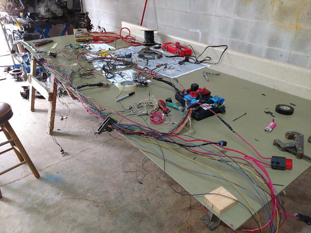

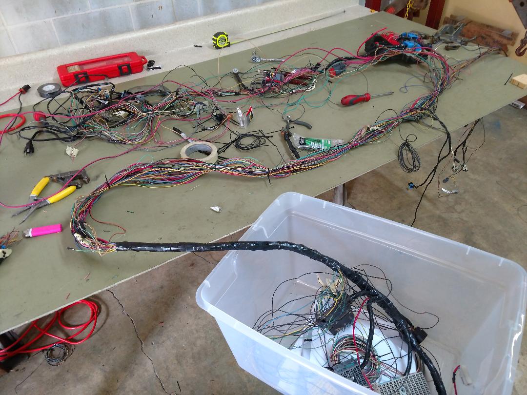

I am through the last harness video. I have all the wires extended and connected as shown in the video, but I did not do any wrapping. I think I will wait until we get the frame and do a pre-powdercoat mock up and actually plug everything in and wrap the harness at that time. All in all I enjoyed the harness job. The video was very good and systematic, there are a couple of things I am worried about, but when we turn that key and it goes vroom I will be relieved. lastharnesvidl.jpg
RichRich
I thought doing the wiring was great. Im not a wiring guy but still enjoyed doing it. I did the same as you and didn't clean the wires. I know what you mean be the stick, melted, gummy mess. I think it is a little better after ALL of the tape is removed.
I had to unwrap a few parts of my harness but it wasn't too bad. You will love the assembly process so much more.
Looking great man, keep the updates coming!!

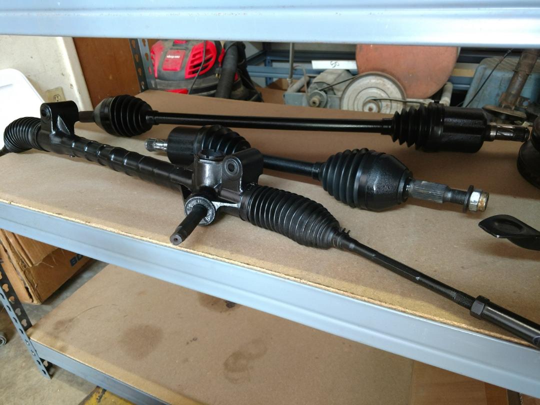

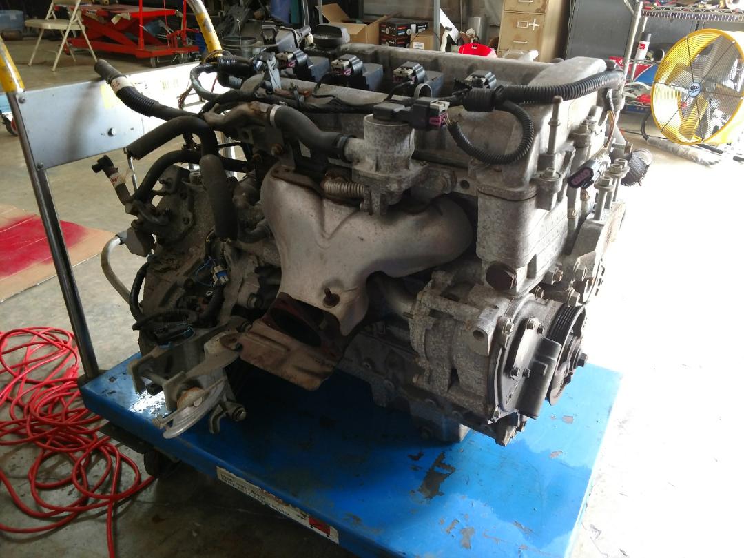

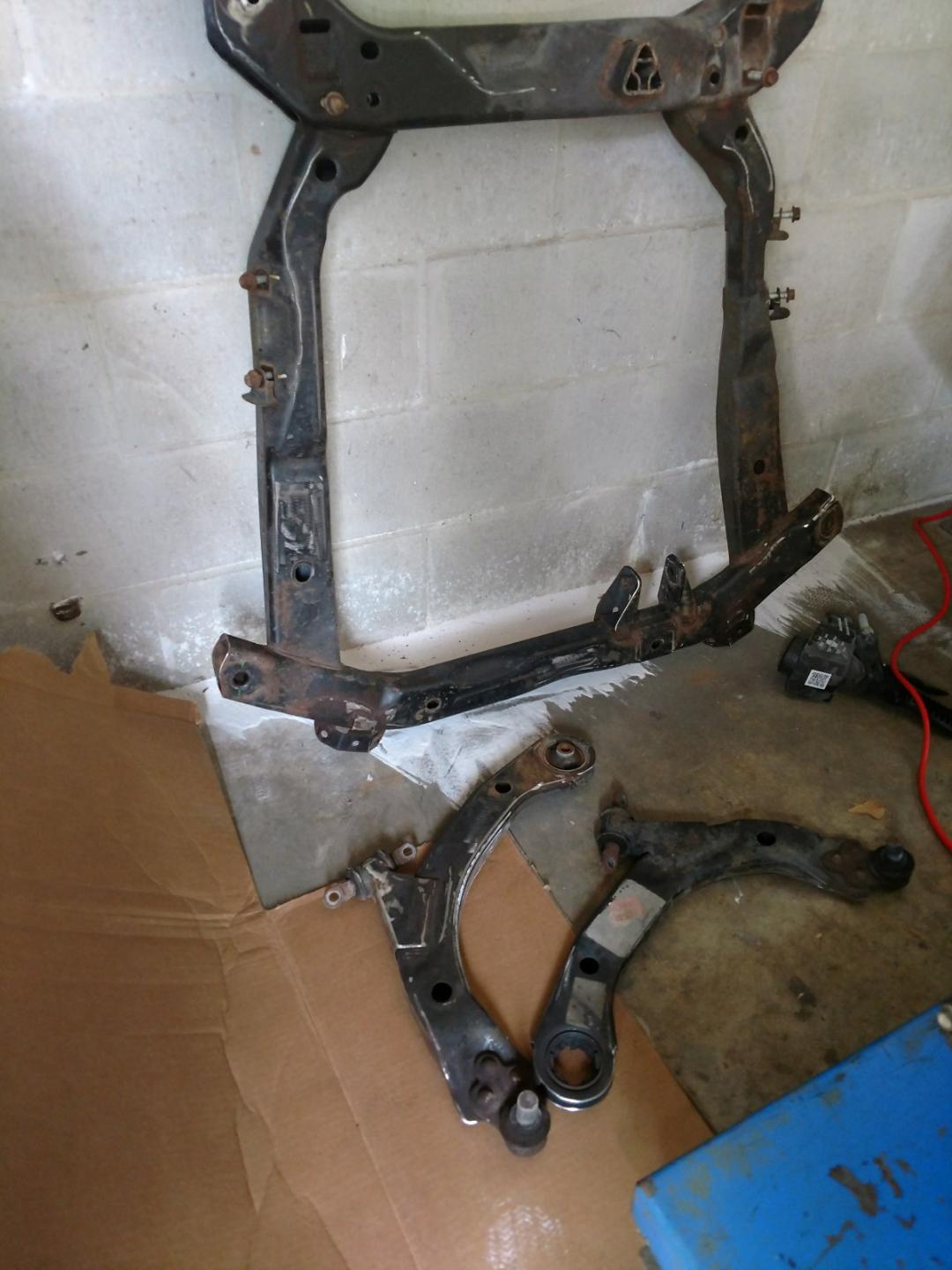

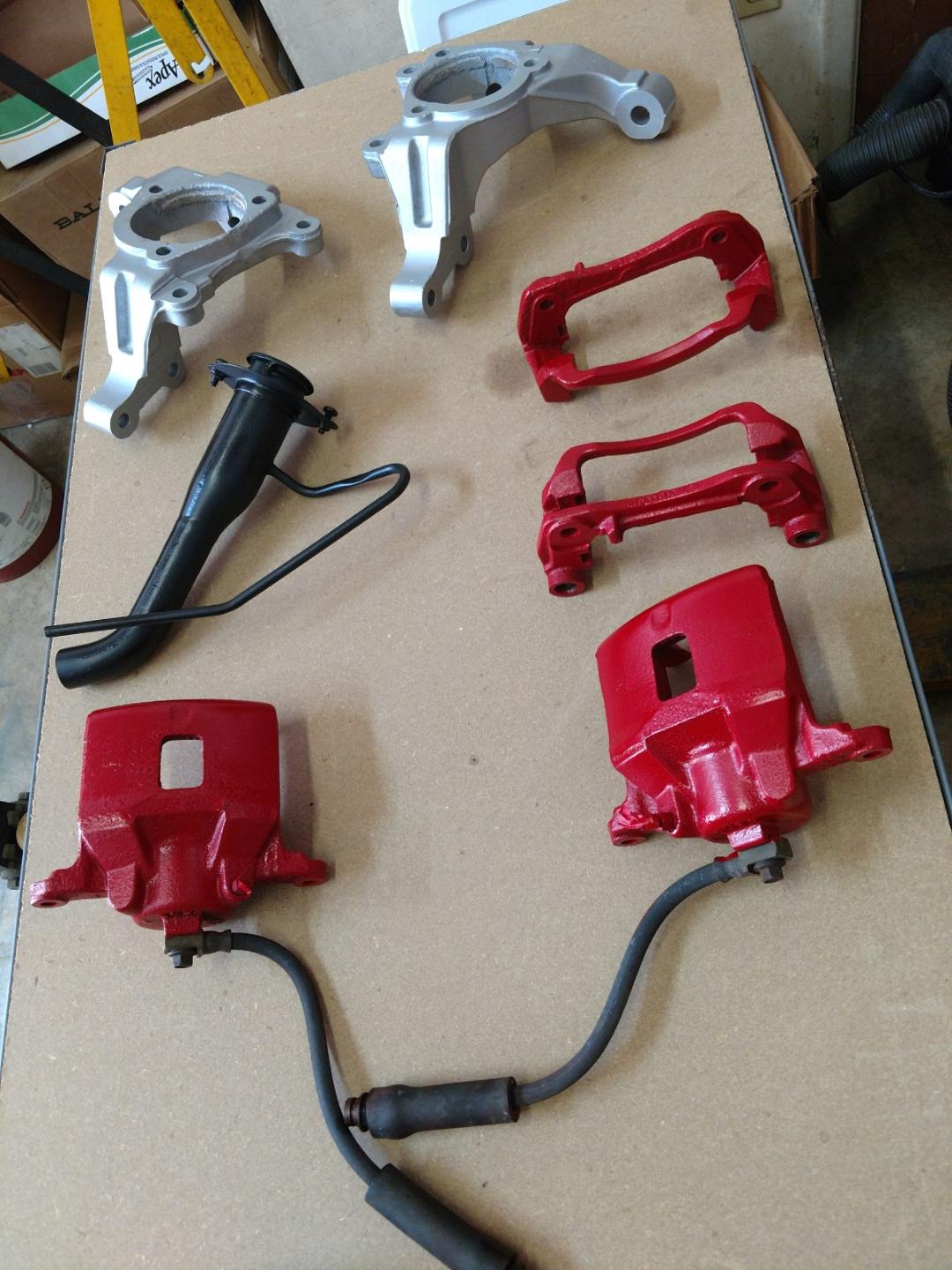

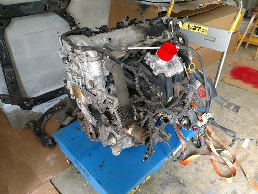

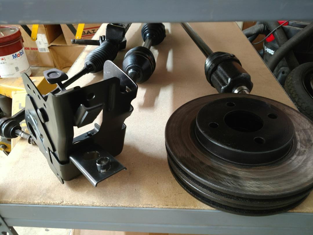

I been working bit by bit on cleaning up the donor parts. I am sure I will find more to do as the assembly gets going.
