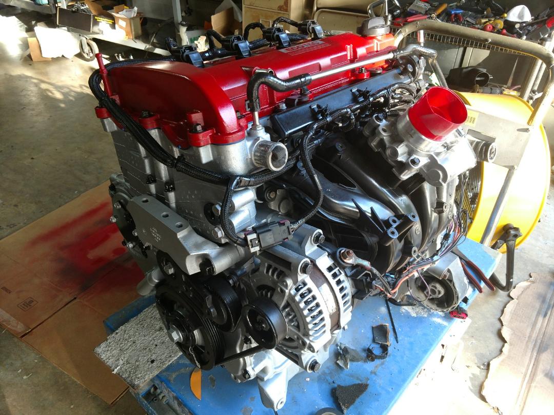

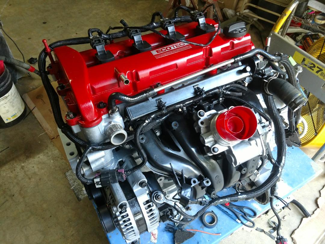

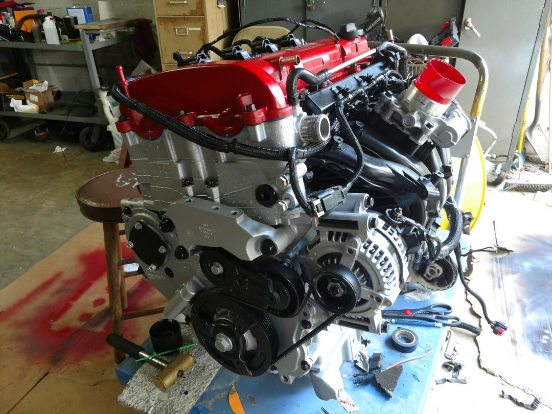

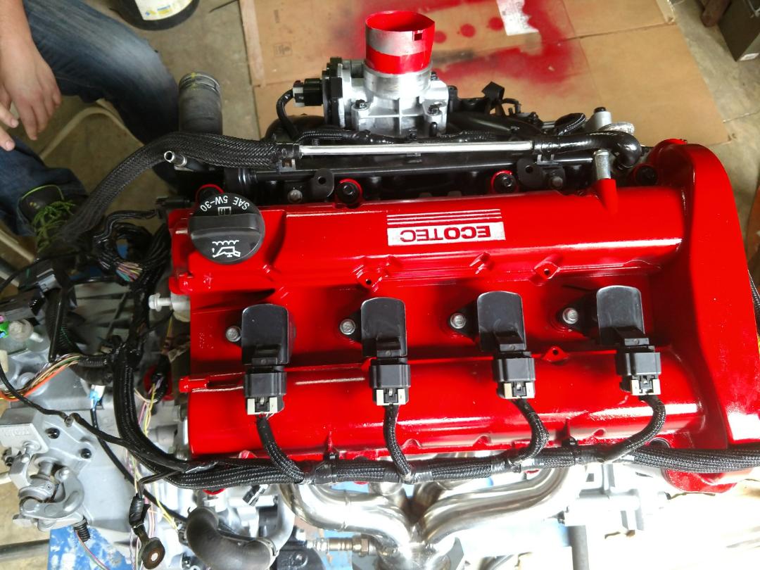

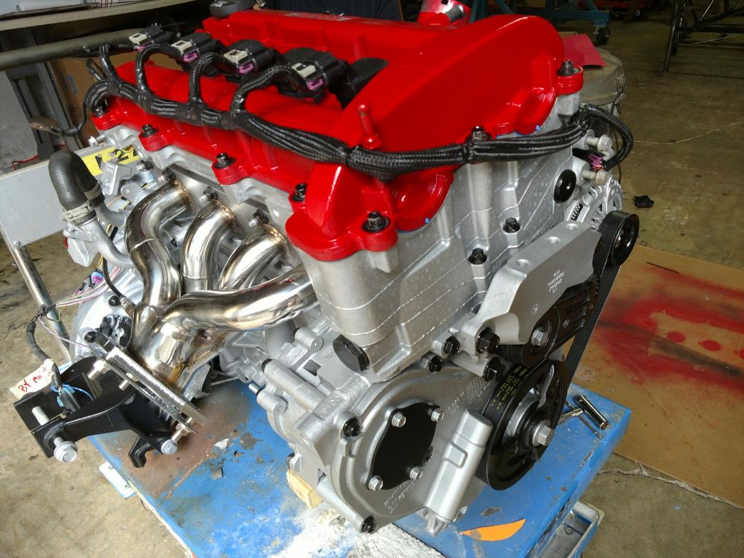

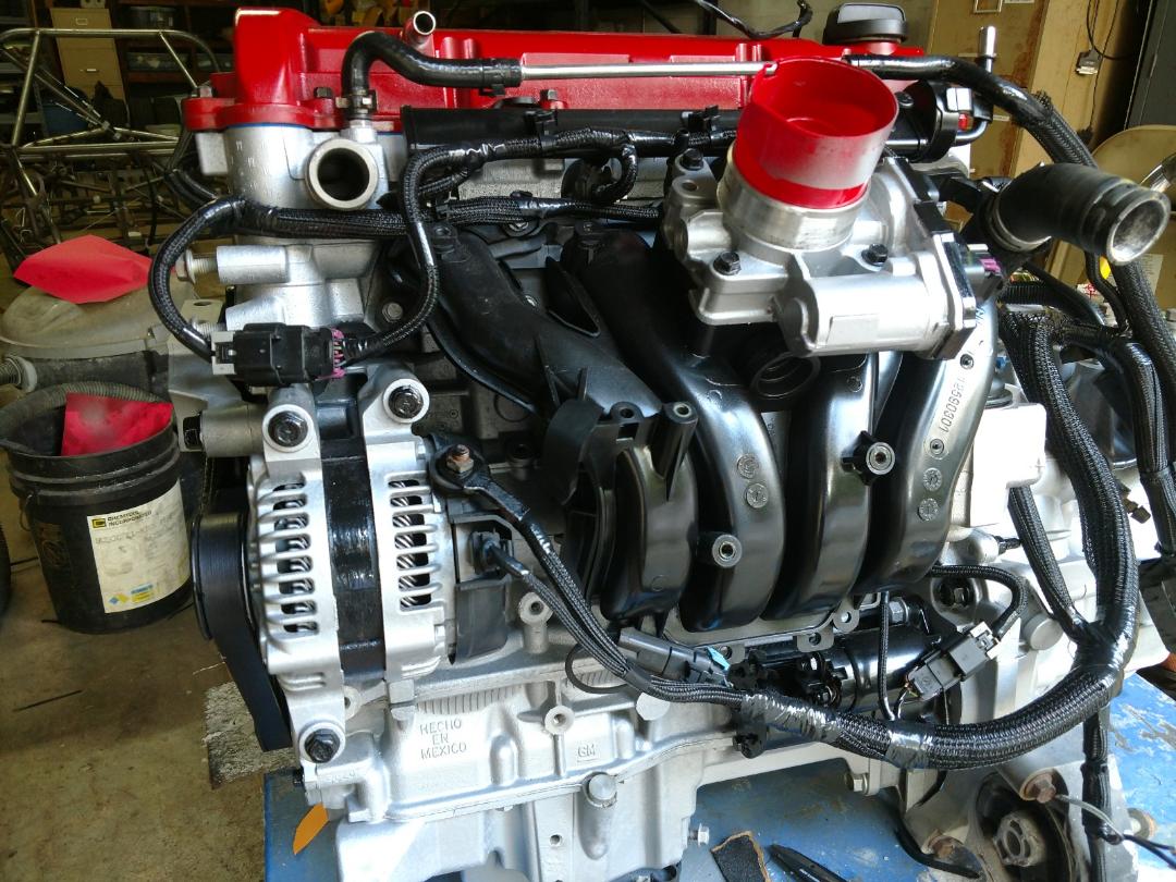

I wanted the engine to look special since it will be so visible in this car. I used a soda blaster to get the surface prepped after tons of degreasing and scrubbing. I used Painless brand powerbraid to recover the engine harness after moving the MAF and removing the air pump, air solenoid, and A/C connectors. The valve cover came off and was flat sanded smooth. I used engine paint (Cast Aluminium, Gloss black, and red). I have no doubt that there will be touch up to do after it gets in the car, but I like the look so far.

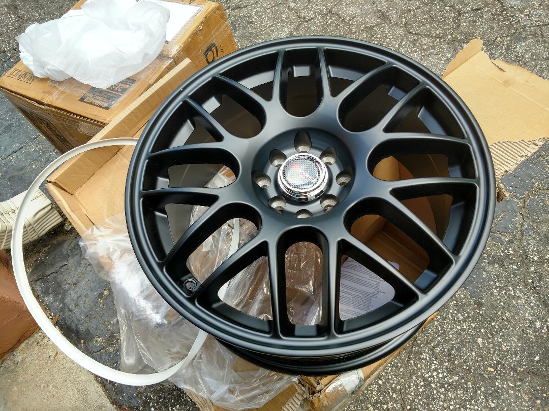

Planning on running 225/55r17 in back and 205/50r16 in front.
Your rear tire will be 26.8 inches tall which is quite a bit taller than we normally run. When we run 17s it is usually on an SS build and we choose 245/40-17 tires. They are 24.7 inches tall. The tallest tire we've run (besides on the all-terrain) was 26.1 inches a long time ago on P2. At 26.1 we had to use spacers to get the tire outside of the spring perch on the stock struts.
With your wheel choices and base model donor, here's what I would go for:
  • Front
    • 205/45-16 (23.2" tall)
    • or 205/50-16 if you want something a little taller (24.1" tall)
  • Rear
    • 235/40-17 (24.4" tall)
    • or 225/45-17 (25" tall)
I didn't extensively check the availability of these sizes but a quick search showed that there were at least a few options available on Tire Rack.
CncMan333
I appreciate your input Adam. I changed my order to 225/45r17 in the rear and 205/45r16 in the front. I like look of the bigger tires although I think the performance might be better with smaller tires.
I wanted the engine to look special since it will be so visible in this car. I used a soda blaster to get the surface prepped after tons of degreasing and scrubbing. I used Painless brand powerbraid to recover the engine harness after moving the MAF and removing the air pump, air solenoid, and A/C connectors. The valve cover came off and was flat sanded smooth. I used engine paint (Cast Aluminium, Gloss black, and red). I have no doubt that there will be touch up to do after it gets in the car, but I like the look so far.View attachment 4216
Beautiful engine! A lot of work there!

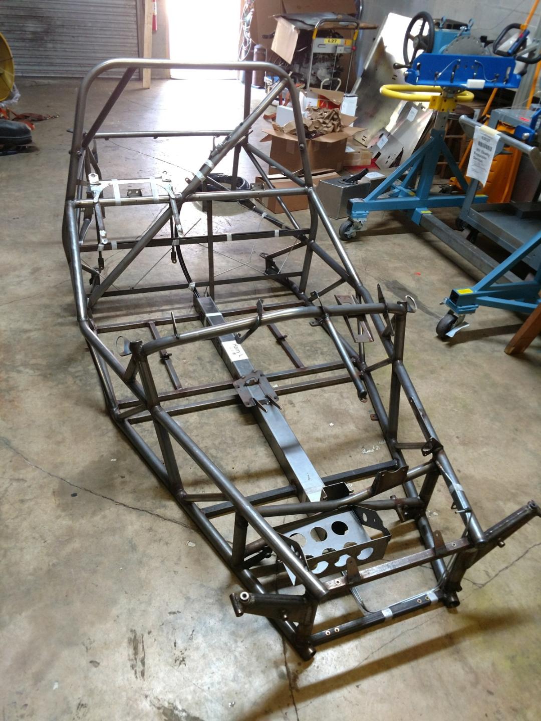

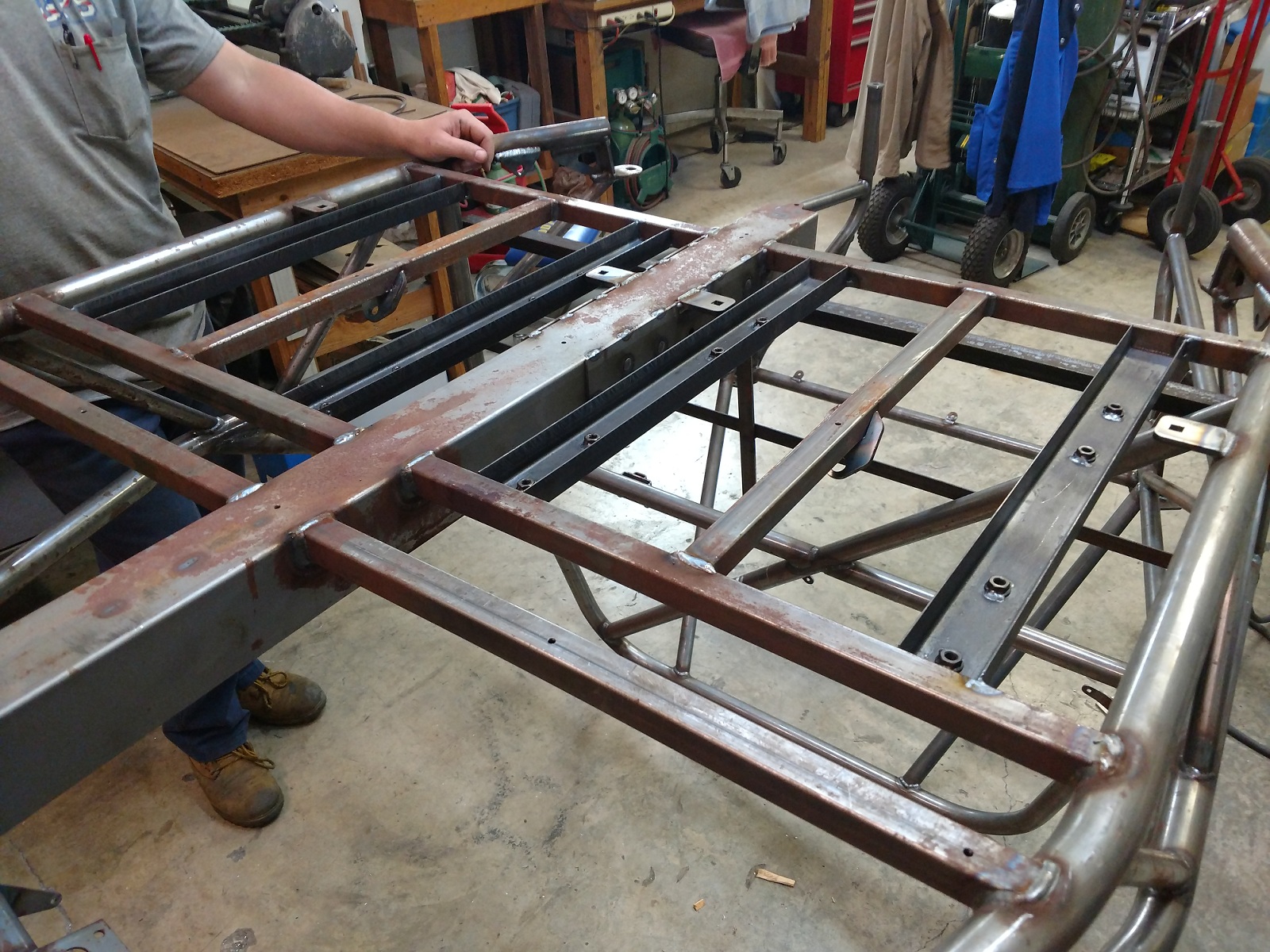

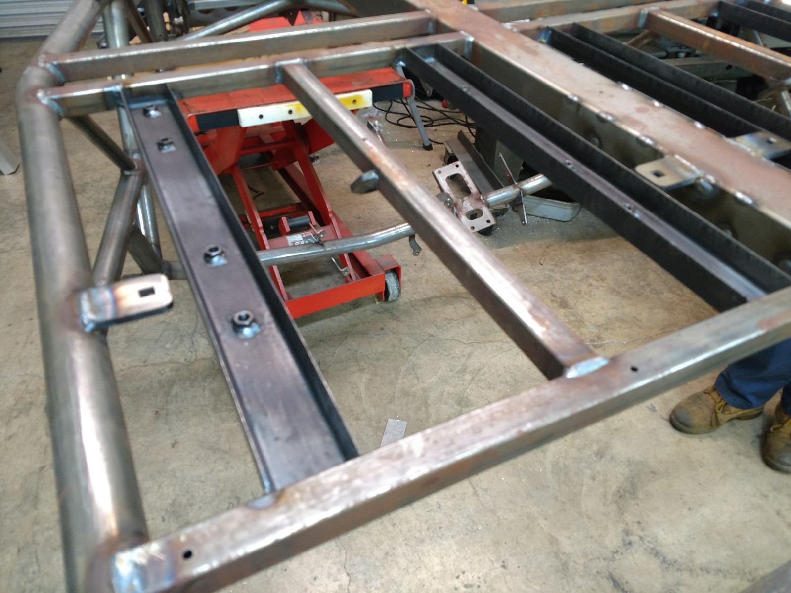

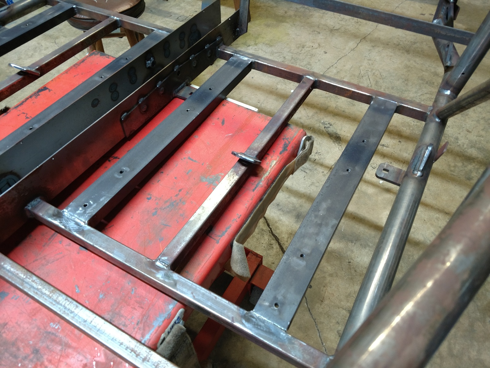

Made some progress today. Welded in some extra cross members to align with the Sparco seat slider. I marked it out with the rear of the slider movement just about all the way back, then put in an extra set of holes 4 inches up from that so I had another option. I used 1 X 2 steel channel. Also welded flange nuts to the inside for easy mounting.

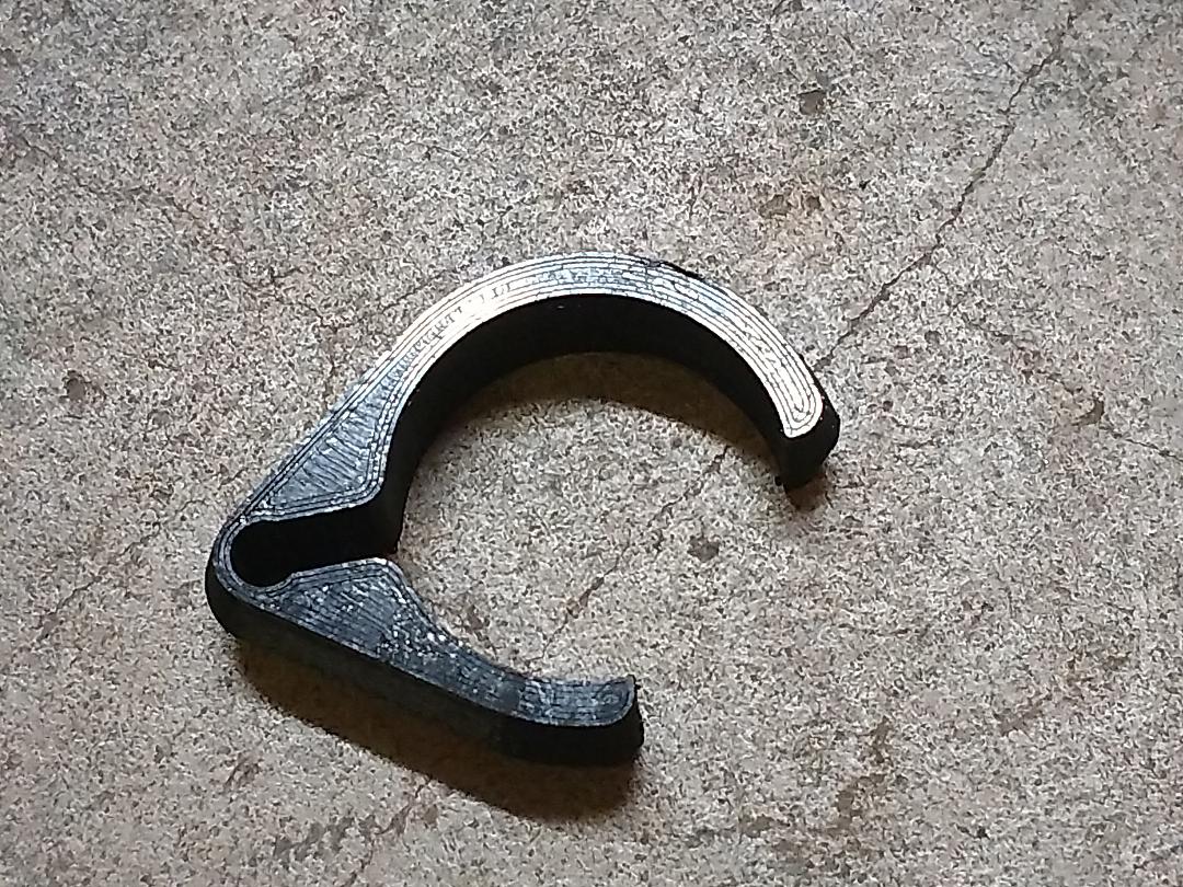

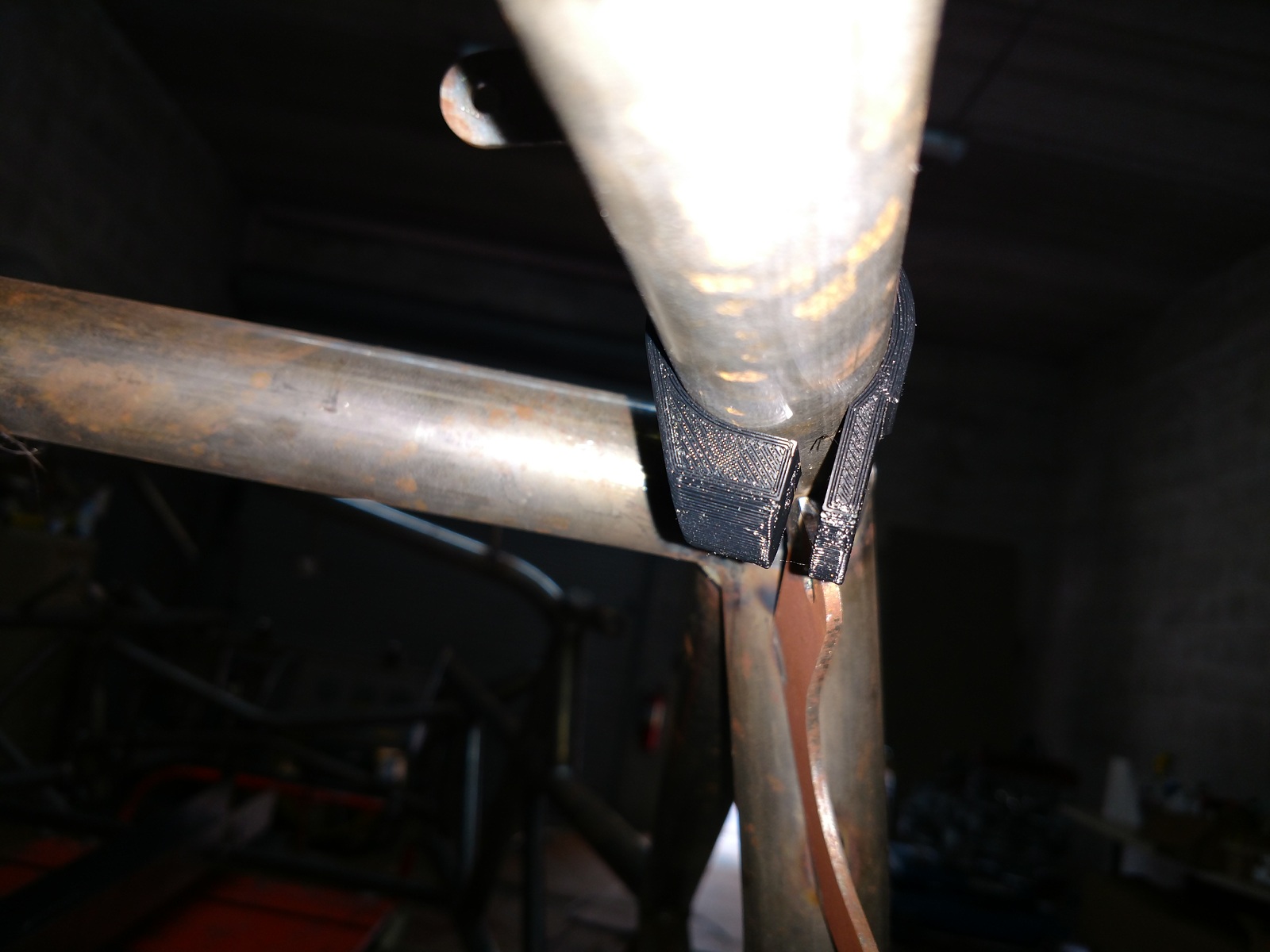

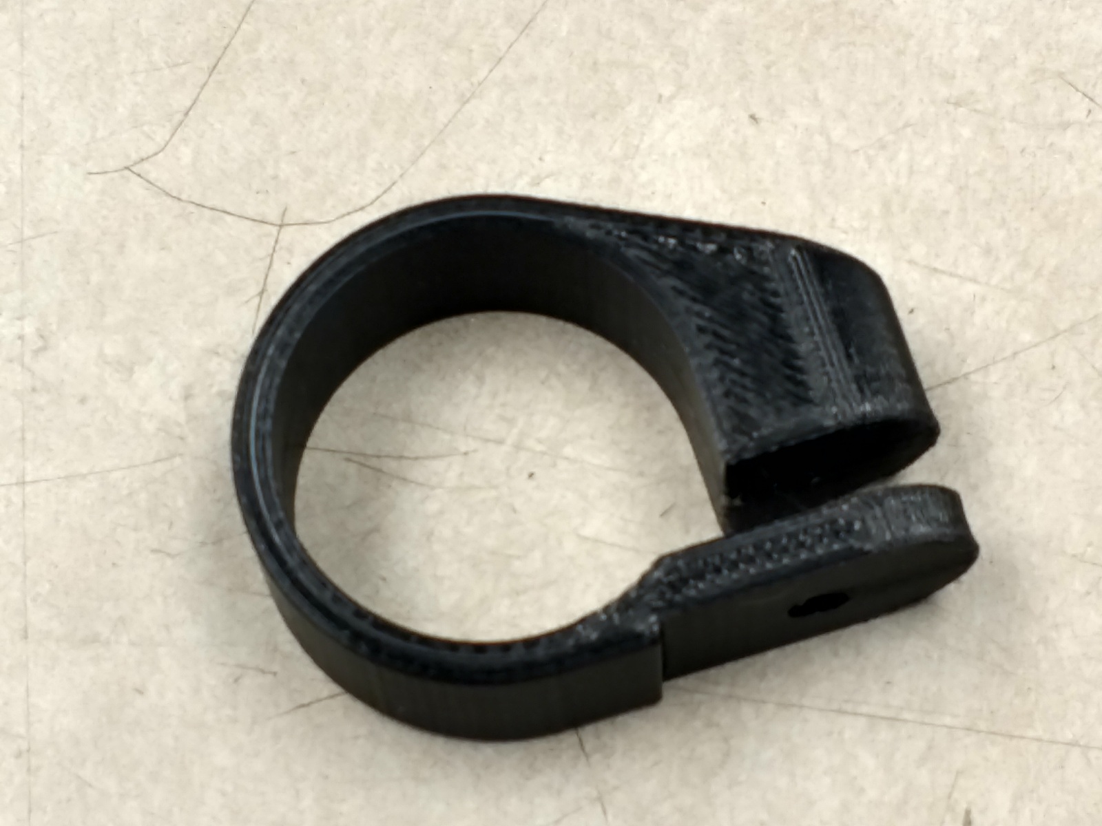

I printed a prototype body panel clamp today out of PETG. It is .125 thick around the bar and has a flat .062 from tangent to the outer diameter and a provision for a push type stainless theaded insert. It snaps around the bar very nicely although I will have to increase the ID after powder coat as it fits very well now on bare steel. Because the flat is tangent to the outside of the clamp it puts the edge of the alum panel below the center line of the bar that it is mounting to, so I am thinking once I am ready to try mounting the panels I will see if there is a plastic edging that I can use to fill the gap. That will make the panels more stable. I plan to upload the files for anything I print to thingieverse.
I'm confused as to what body panel do you plan to clamp with this clamp? The side panels are typically pop riveted on and the front has mounting provisions already. Unless you are referring to the engine cover, which I do not have and have no experience with, but again I thought it had mounting tabs welded to the frame already.
CncMan333
I am doing my own side panels. Rather than the ones in the kit which are just the bottom section, I am thinking I will come up higher and continuing back past where the gas tank fill is. But before I know how big to cut them I need to know how to mount them. I am curious about the hood mounting provisions. Does anyone have pictures of where the fiberglass hood mounts?

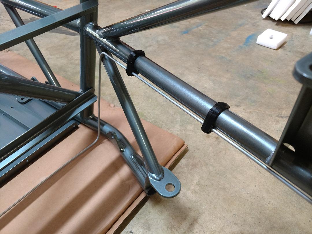

Mainly for the purpose of learning my 3d printer and Fusion 360 I printed some brake line guides. I think the method used in the videos with the loop clamps is fine, but I wanted to try something different. I plan on making a block that clips on to the lower fuel tank angle bar.

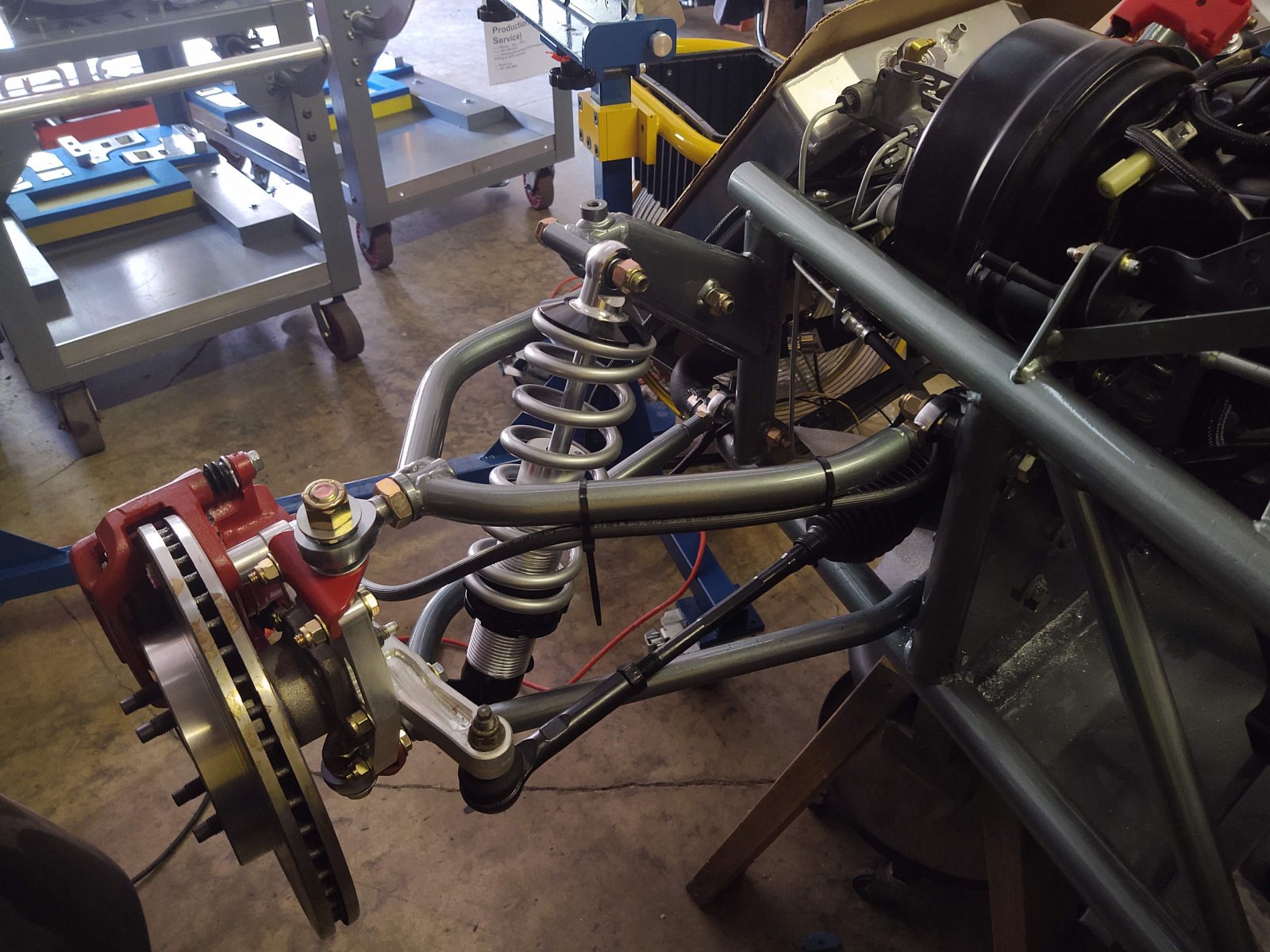

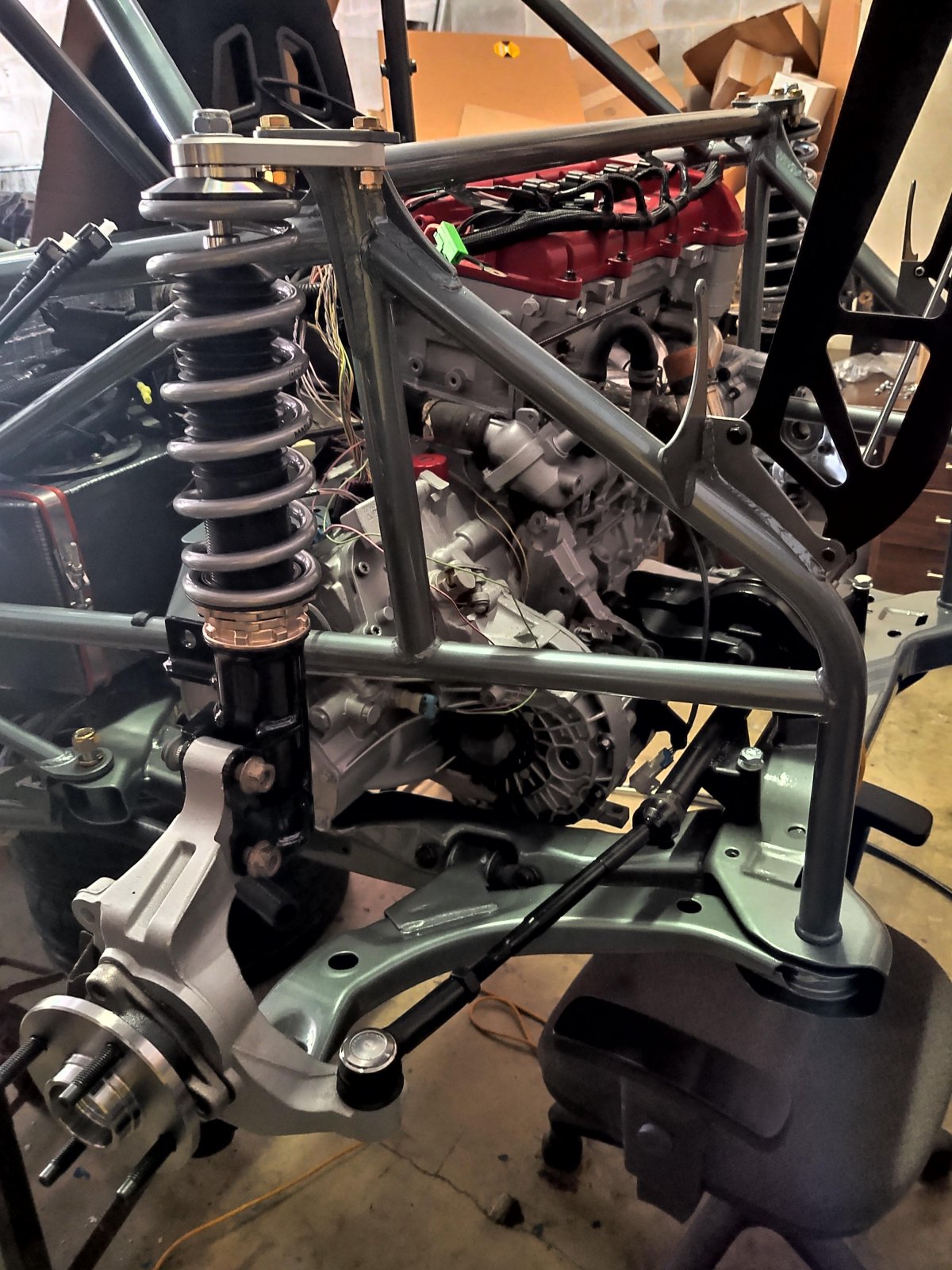

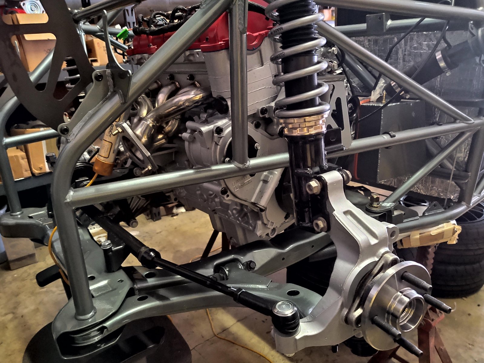

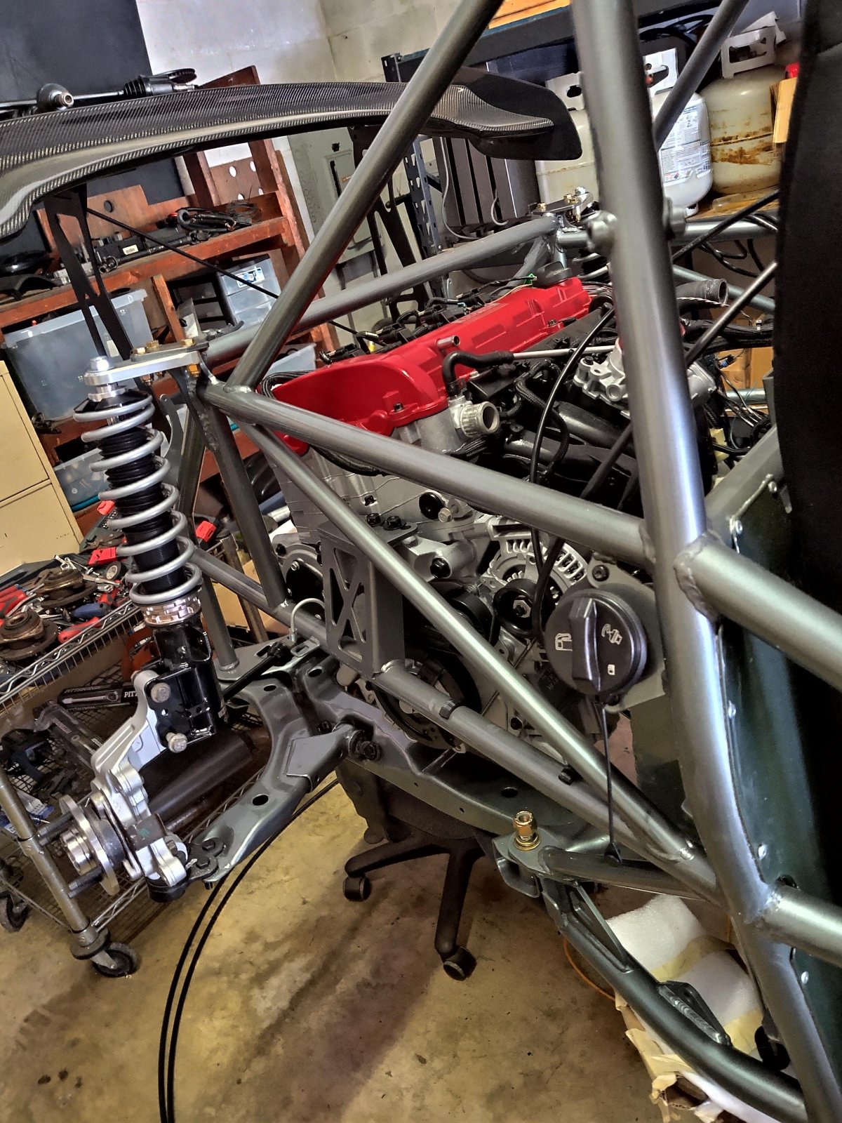

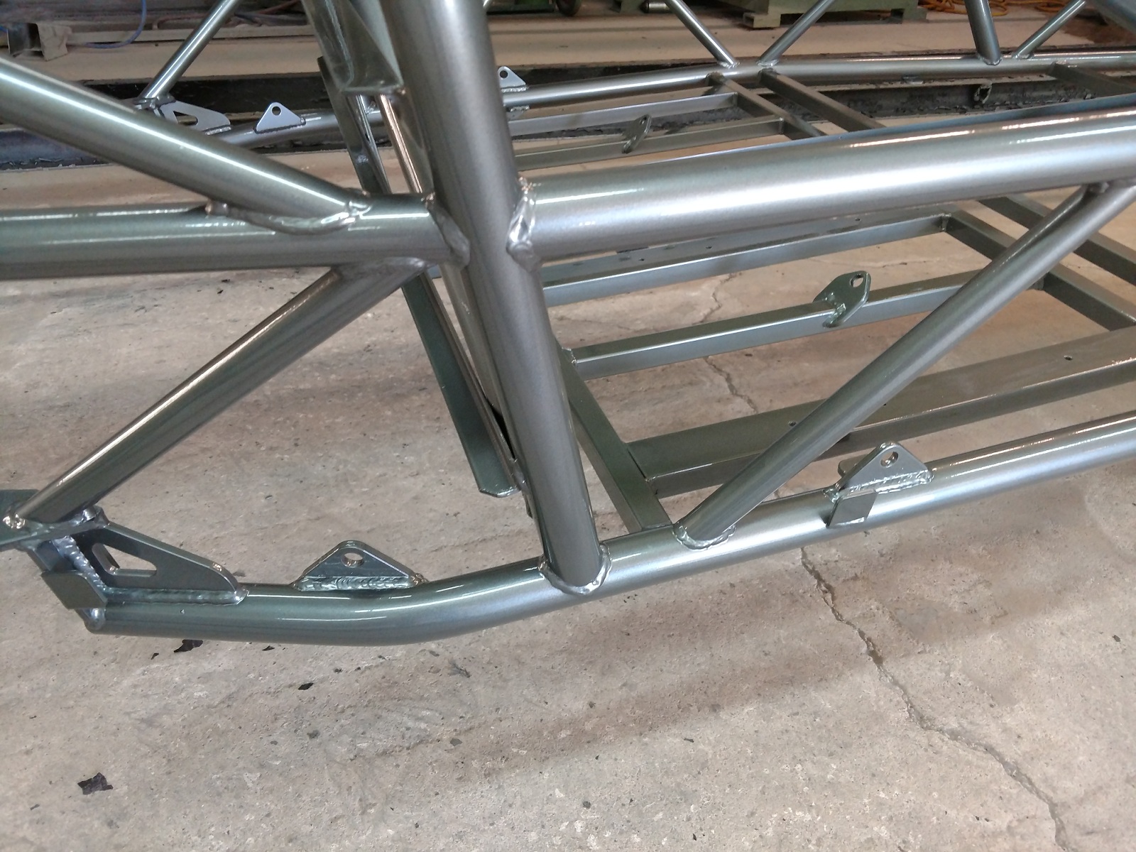

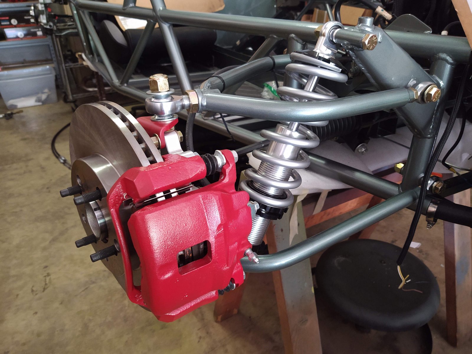

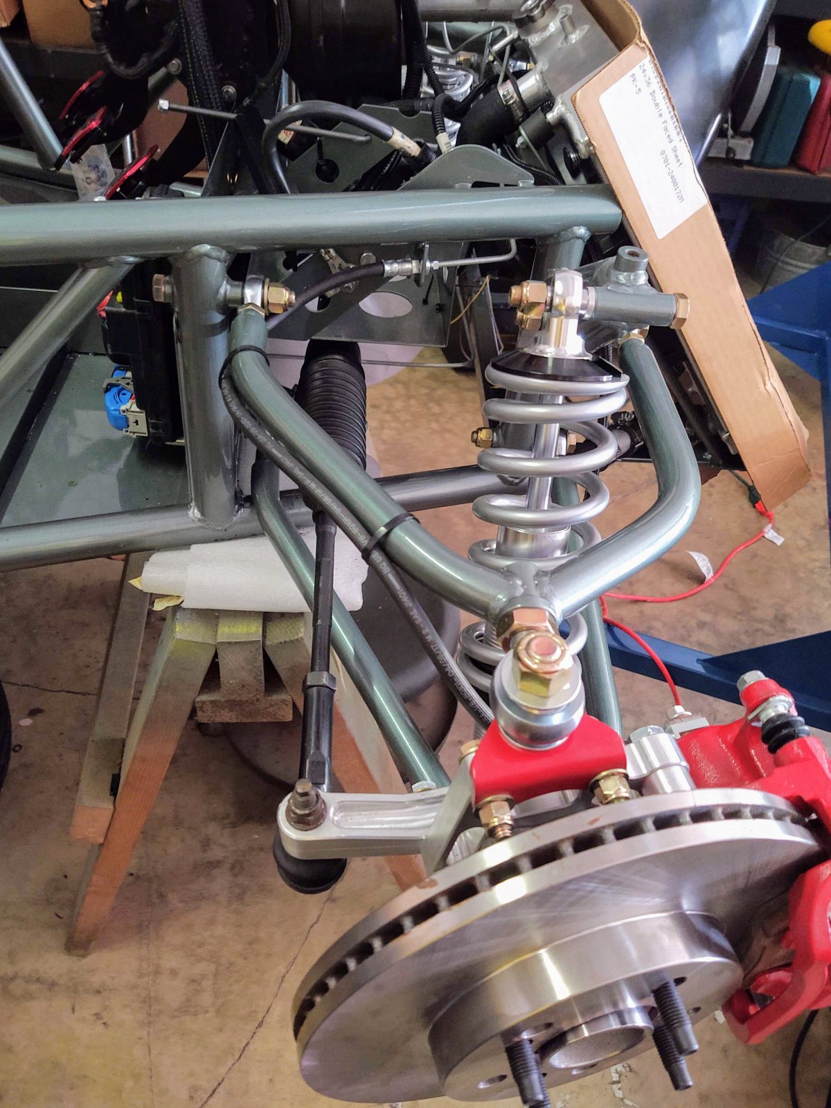

Been a while since I sent an update to this page, but I am still here and still picking at it when there is time. The goal right now is to get it on wheels so it is more movable and the space can be freed up up some. The motor is bolted in but not connected. Things are coming together.
