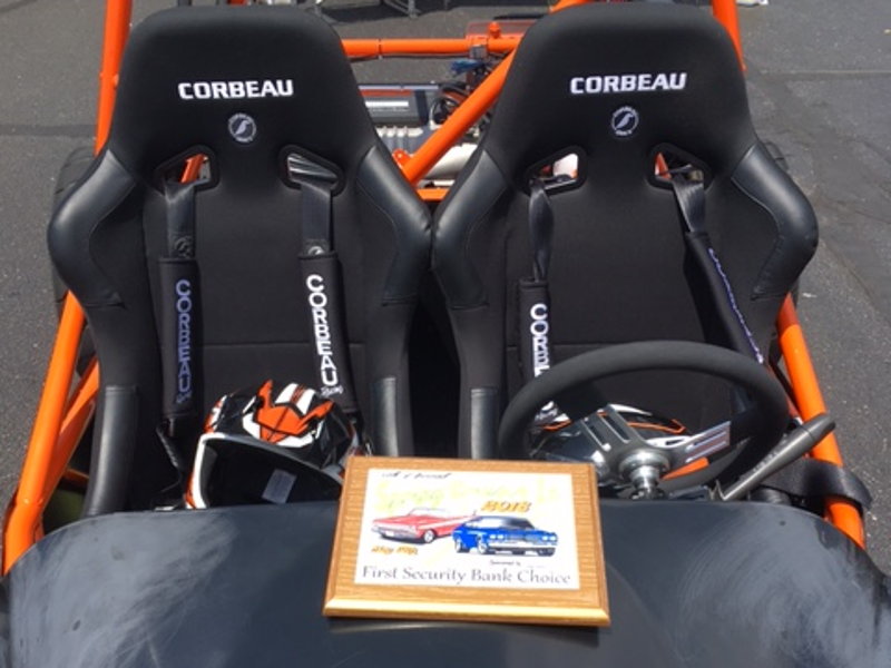

So Kaleb and I rode with the group this morning but detoured around lunch time to head back to town for the car show. We arrived as car number 99 out of 105. The Goblin got lots of attention and the questions flowed for the next hour or two. And very surprising and very honored, we were selected as the top choice pick for First Security Bank (a sponsor of the event). This was one of only four awards given and the only for First Security Bank. We were certainly not expecting to enter a car show (with a car not even wrapped yet) and win!
Kaleb receiving the award from one of the volunteers.

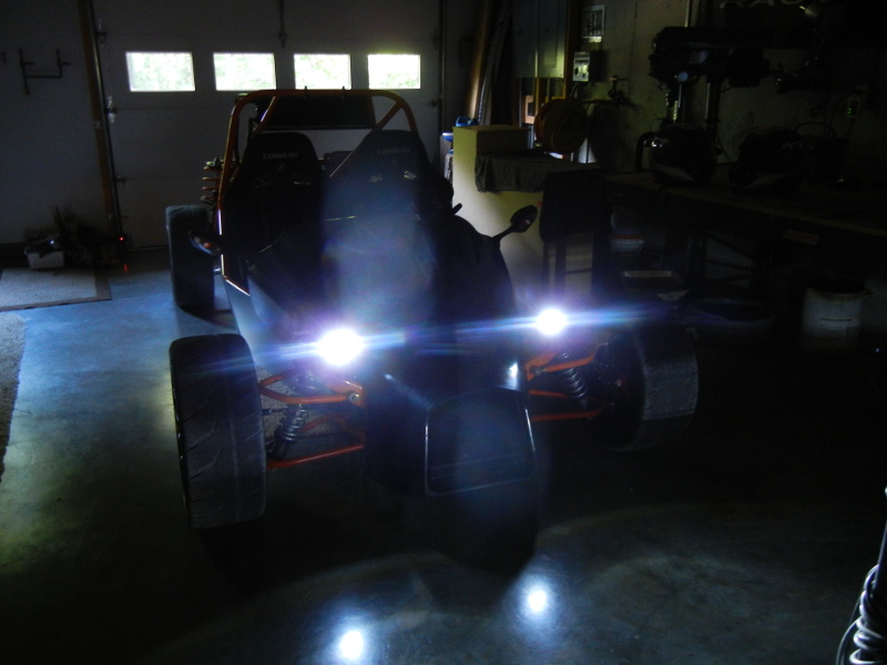

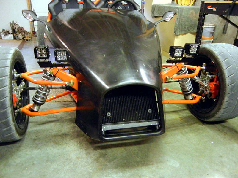

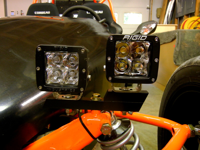

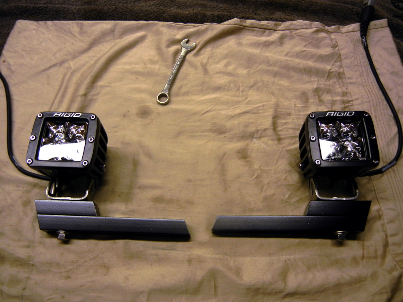

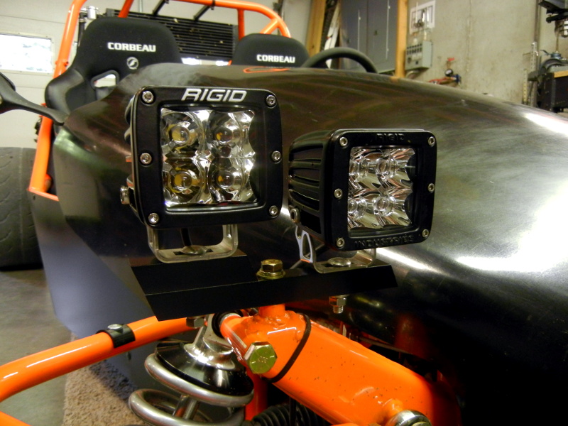

We opted to ditch the standard headlamps for something a bit different. We struggled with coming up with something that we really liked and was yet still affordable. We already had a set of Rigid Industry Dually LED lamps that we had on the ATV and really, really loved them! So we moved them over to the car and added an additional set. The inner low beams are a flood pattern and the outer high beams are a spot pattern. I used the leftover square stock from mounting the heat exchanger to make a mount for the pair. I cut the stock with my mitre saw and drilled them with the drill press and brand new bits. It's a pleasure to work with good tools, it really helped it come out nice. The layers pieces are drilled and have press pins inserted to hold them together and keep them from moving. Kaleb wired up both the lamps. We will have to align them when it dark out.
I know the your burning question, do they meet the DOT requirements? Anymore does anything really meet the DOT requirements? I am so sick of these new pickup trucks with $^&# LED lamps pulling up behind me on the highway and completely blinding me in my little car. They are no less of a hazard then these! These really aren't that obnoxious when aimed properly and this low to the ground. End of rant.

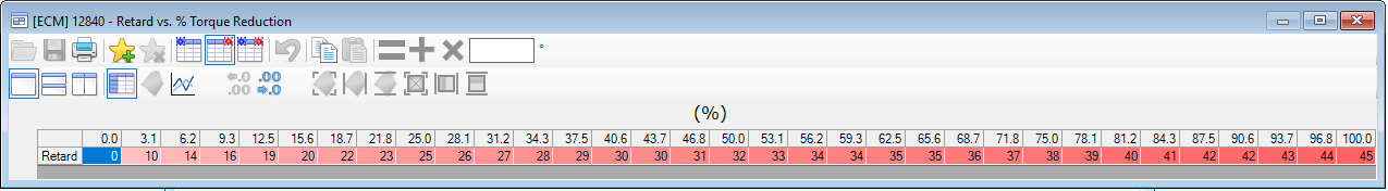

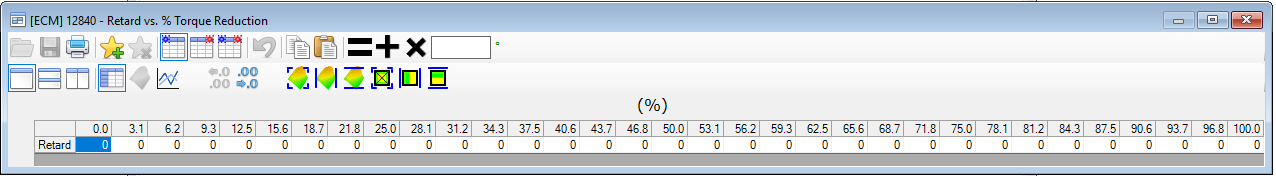

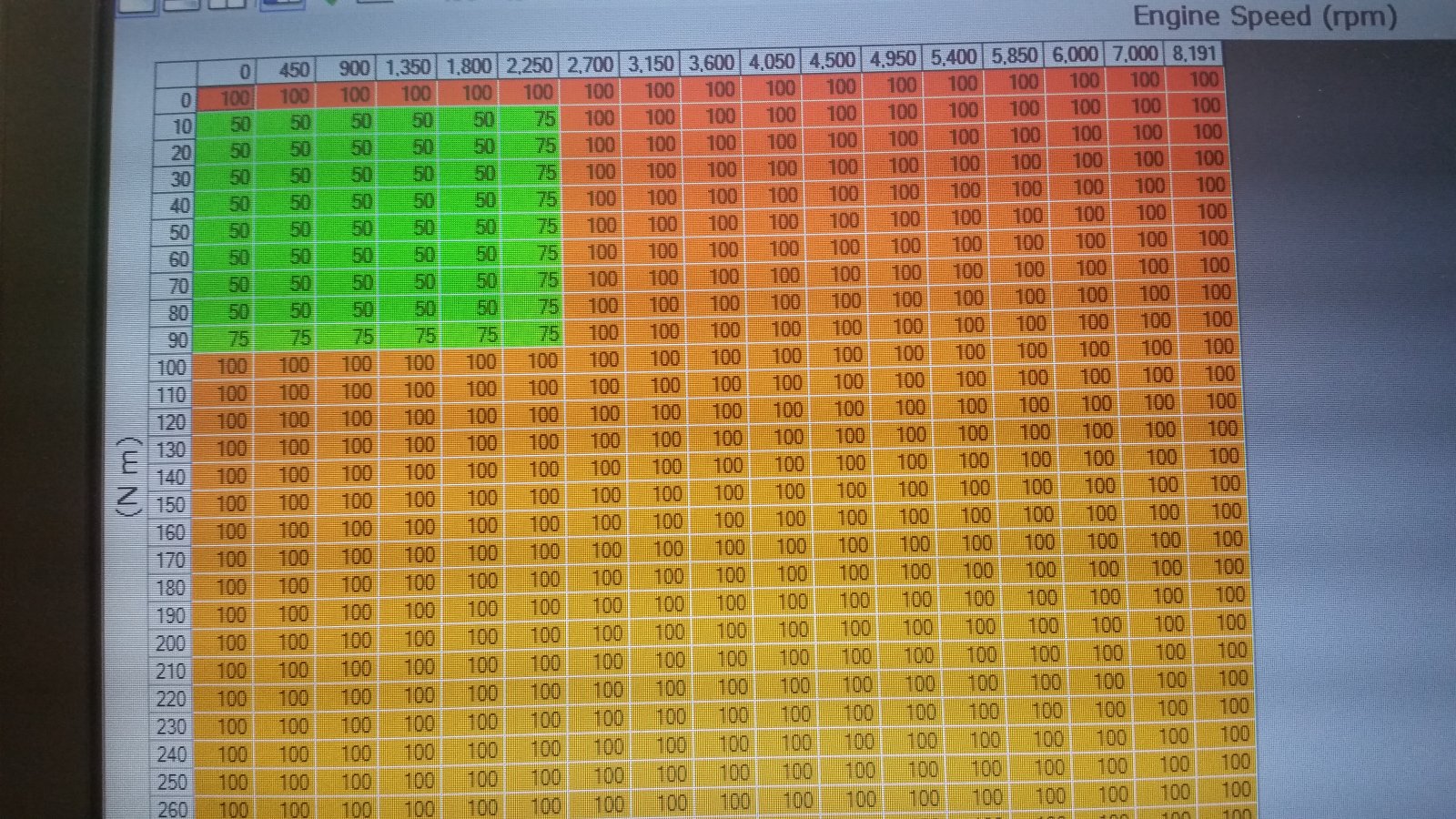

I also might have found the reason for the uncontrollable throttle response. The Retard vs. % of Torque Reduction has been zeroed out. So in other words, there is no Torque Reduction available at all. There is another table that shows when there should be.
This is my current table:
And this is the sample file table from a 2006 Cobalt SS:
I'm certainly not claiming to be an expert on this, but I am learning. And I could very well be wrong about this.
Might be a good idea to go back to the stock tune and go from there.
Wish I had one. The PO had sent it off to ZZP and they put a tune on it. I can compare my tune to the sample file and much of it is the exact same. This was one area that was completely zeroed out and I can see that it has been set up for 60lb injectors (which I do have). So I feel that it's not really messed up or anything. There is a little bit of timing adjustments.
Anyone have a stock SS/SC tune by chance that I can use to compare?

I believe there is a GM stage 2 in my computer at work I could send to your email tomorrow and a couple of changes to mine.
Adam will have one I believe. And if not zzp will.
But right off the bat I recommend you pay zzp for the remote tune. They’ll work with you to get it running right. Took forever for me but holy **** it was the best $200 I spent on the whole project.
