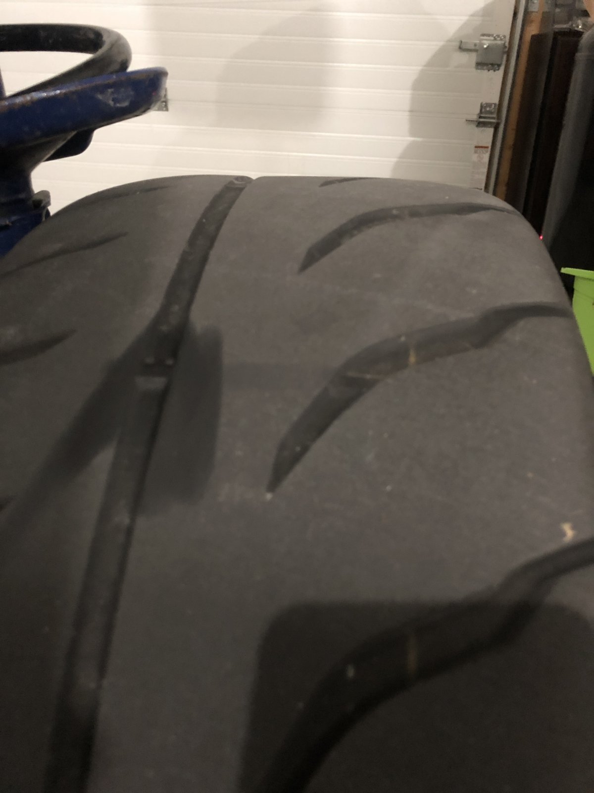

On another note, the TOYO Proxies R888 are not lasting very long. We are not doing burnouts or anything. The tread wear indicators are now flush with the tread at about 3000 miles on the rear. We rotate the tires already, yes at 3000 miles! Hoping to get at least 6000 miles out of the set. Next time I think I will go with something more street-able and keep these for the track.
TheNuker
Wow you must be burning some rubber :P I have about 7700 miles on these rears and they have a bit left. Toyo R888Rs
Fronts are very good I'd say over 60% left.
