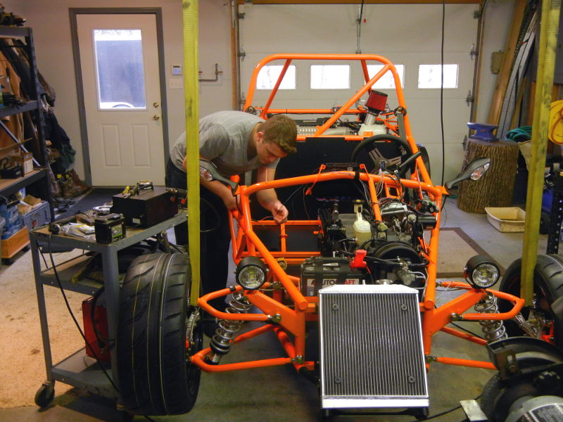

Here he is finishing up the wiring to the lights. I was surprised the headlamps had LED bulbs in them.

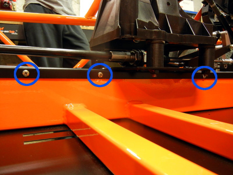

In order to stabilized the center tunnel cover for shifting purposes, we drilled and tapped four more holes around the shifter and installed M4 screws. I did not rivet the cover on but instead drilled and tapped all the holes to use M4 screws so we can remove the cover if needed without too much trouble.
I added the two right screws to both sides.
Did the screws seem to help with rigidity? I would think the wings there would be what gave a bit of flex
The screws pretty much took care of it. It wasn't really bad before, but the four extra screws really made the cap solid at the shifter. The tunnel cap was twisting under hard left-right shifter movements. The wings are welded so close the the cap there is nothing really to flex.
