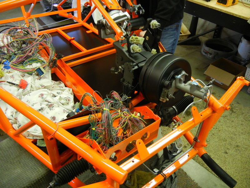

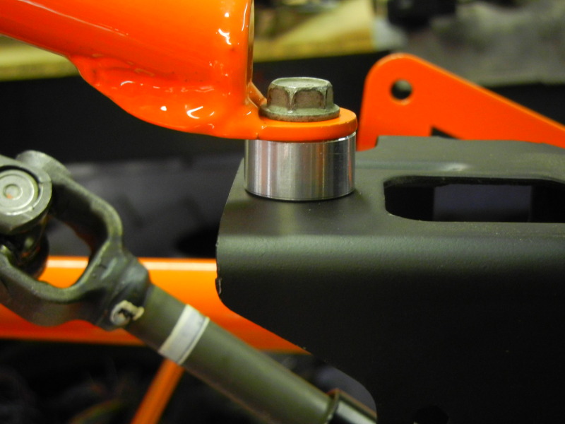

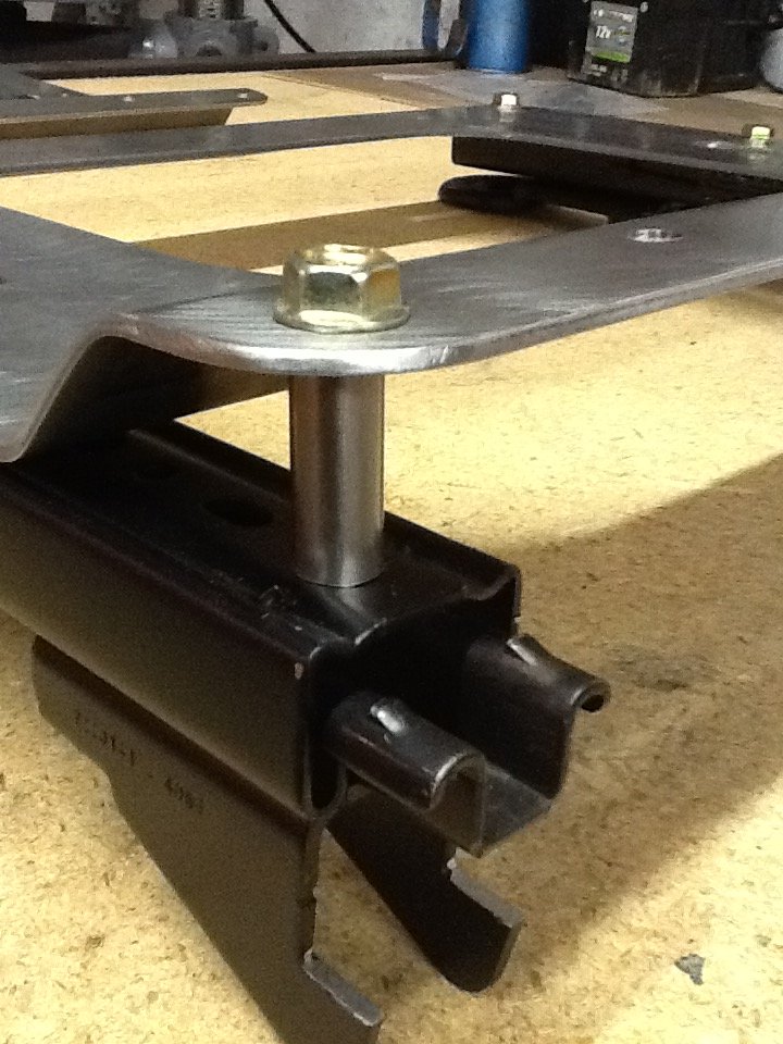

Got a bit more done yesterday. Many of the interior and driver components are in. As expected with any kit, there are little issues here and there to work through. The pedal box just did not line up with the bolt holes. If we lined up the two in the front on the bracket, the top tube didn't line up, it was 1/2" out. Not sure if there is difference in the years of the car or what. I ended up using the aluminum slug from the radiator hose pull to modify the mount. It seemed to work quite well. The only issue I can see is that it will rotate the pedal box down in the rear a bit. We will have to see if that causes other issues.

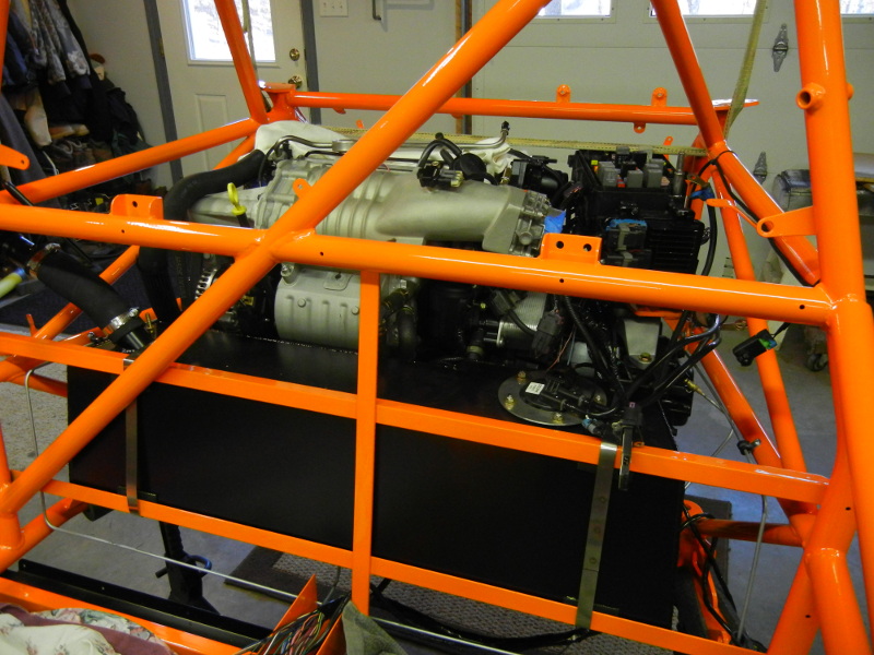

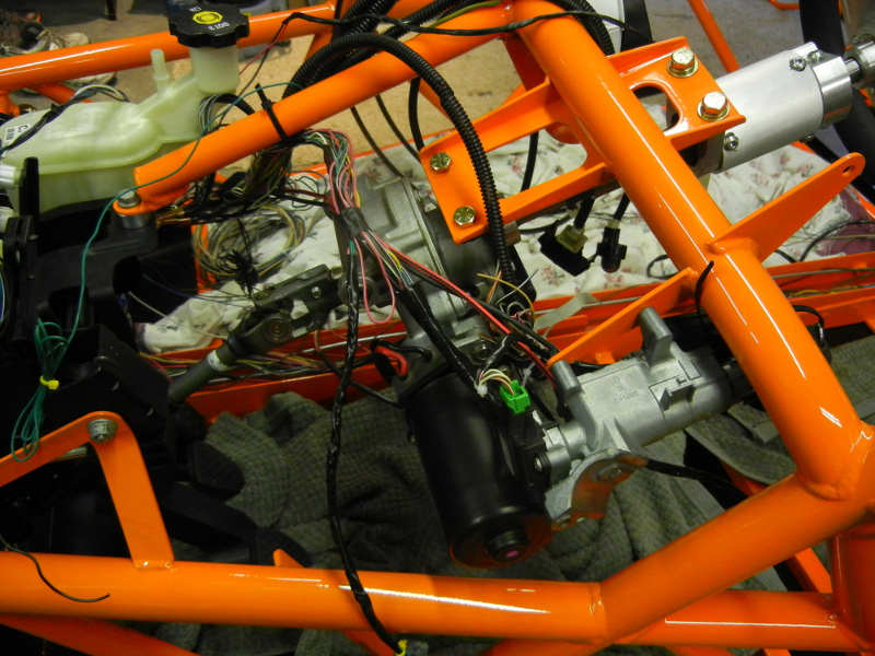

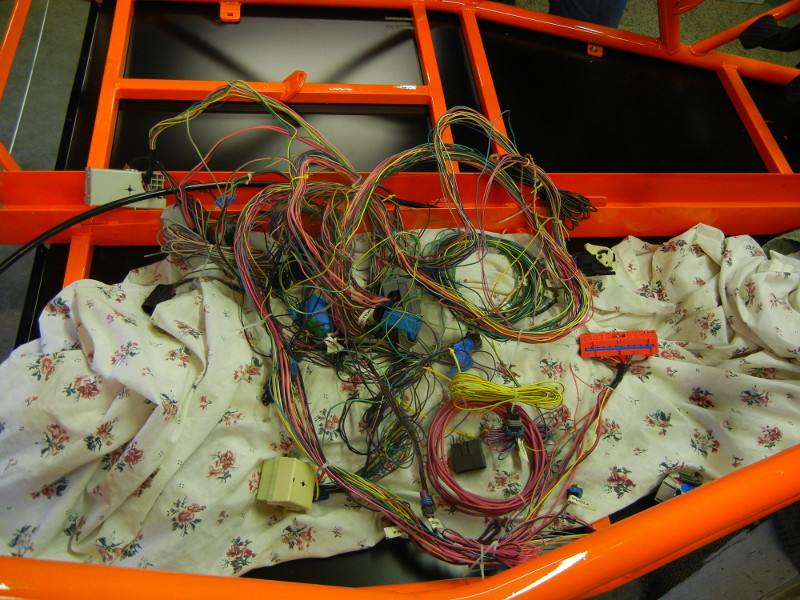

Now on to cleaning up the wiring. Like many others, I just couldn't bring myself to cutting and splicing the wires until they were routed in the car. I will probably spend a lot of time on cleaning up and looming the wiring. I know I will be modifying things along the way such as running wires for aux lights, power ports, and an additional gauge and button pod. I just hope it doesn't slow me down too much.

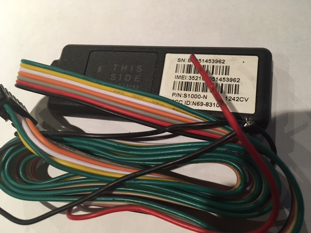

Also during the stripping of the donor, I found this little item and tossed it in a box to figure it out later. My guess were right as it's some type of Goldstar GPS locating device. Interesting, I wonder if they will ever find the car.

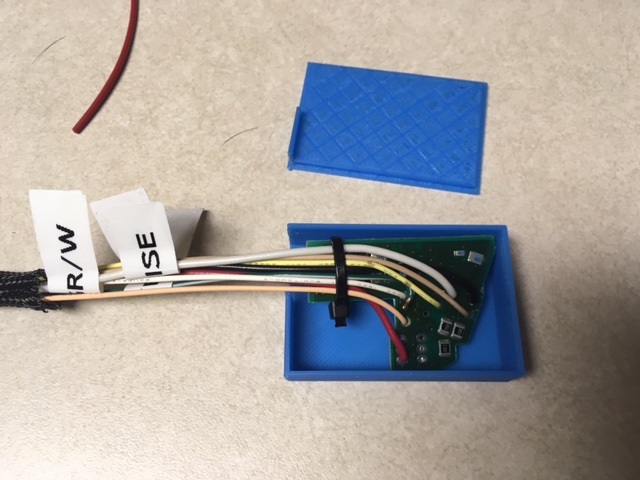

Working on the dash wiring for buttons for the Info/Enter, cruise, fog lamps, hazards, etc. I reused the circuit board in the steering wheel instead of having to find the resistors and I know this will work. Kaleb is working on making a small box to house it in that will probably fill with silicone once it done and tested.
The final color won't be blue, that's just the prototype (and it's easier to see in the photo).

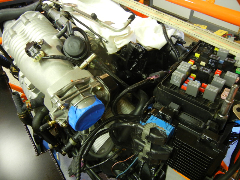

Today was the day for the first start. We didn't attempt to start it weeks ago when would have liked to since we didn't have the valve cover yet. I was hoping that there were no major issues after trying to start it since we did some much more work. Did have two quick little issues. One, I didn't tighten down one of the fittings on the gas line. Sprayed gas everywhere and a bit dangerous. All the while keeping in mind my neighbors house just caught fire last week due to a gas vapor issue. Once that was tightened up, she quickly built up to 70lbs of pressure. Second, it wouldn't fire off after 5-10 seconds of cranking. A quick inspection and I happened to remember that the ignition coils are wired up using the EXACT same connector as the headlight harness! Apparently I was trying to light off the headlights instead of the spark plugs. I switched them around and this was the result....

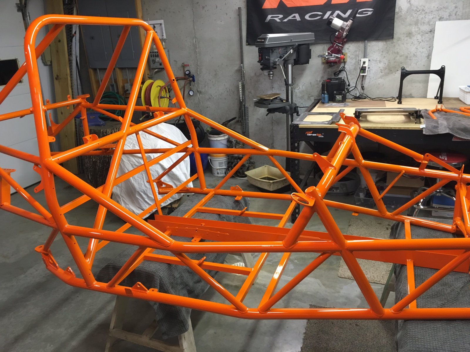

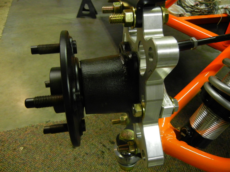

I love looking at all of your all pictures and your builds! And I've been terrible about posting pictures of my own. I have been taking them along the way but just not posting anything. So I finally sat down tonight to post up some. Sorry for so many at one time and some are a bit redundant and out of order.
