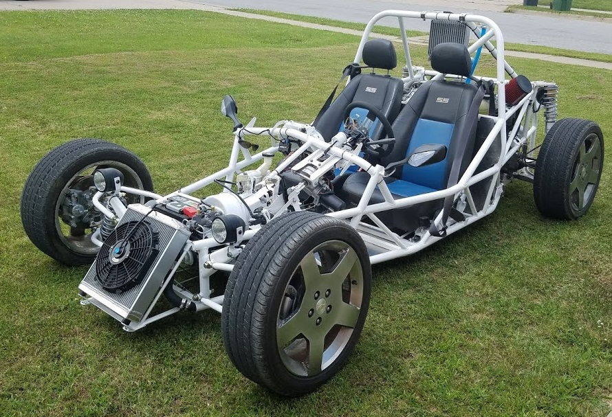

I'm at about 19k into mine. Pretty stock SS/TC with all the extras other than the city/standard frame.
I didn't want to use the SS seats, and I didn't want to spend $1200 on the Corbeau seats, so I bought cheap no-namers off eBay for $290. They're comfortable, they recline, and they're holding up so far. Very happy with them.

View attachment 24829 If you do your own wiring harness, that can save you some bucks, but it is a bit of work. You can source your own lights if you want pick a custom look, maybe save some bucks. The L61 should make getting a donor car cheaper. Buy a crunched one for even more savings.

The extended city with easy entry is the "loosest" chassis. That doesn't mean that isn't not a good chassis, it just means that it has the least amount of structural members. Ross had an odd wheel hop that was due to his frame flexing. He runs a pretty big tire compared to the other folks and most folks don't have that issue.
The cars are as safe as you make them. I personally wouldn't want to drive mine without the multi-point harnesses but that's a personal preference. Lots of folks run the stock seats and seatbelts and don't have any problems. If you do your due diligence with used parts, clean/inspect/rebuild/etc, then you'll be fine.
