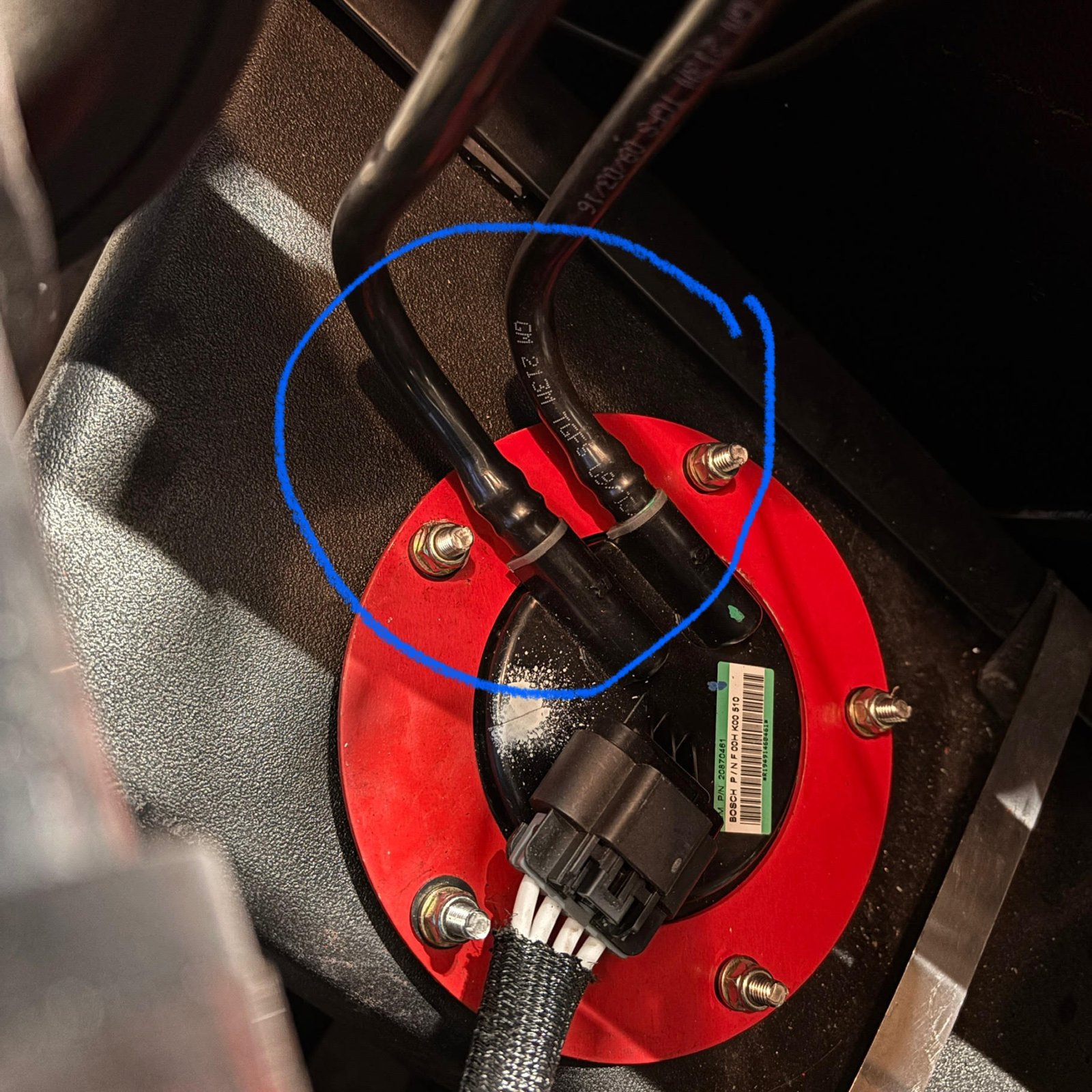

We pulled the fuel pump out to see if there was a float issue and we found the fuel pump had become sort of disassembled. The two rods that run up through the springs had pulled out of the plastic sleeves on the top half of the assembly and the lower half of the assembly was just sort of floating in the fuel. We put it back together and it seems to be better now. The only issue now is that the fuel gauge runs in reverse. When full it reads empty and moves toward full as I drive around. Would switching the two sensor wires around solve that?
The other thing I want to do it change the rigid lines coming out of the assembly to some rubber fuel lines to make it easier to place the fuel filter. I'm thinking I could carefully razor blade off the rigid lines at the pump and use rubber hose with hose clamps. Does anyone see a problem with doing this?
I did that with mine. Just have to be very careful you don’t damage the connector.
It's a fuel line from ACE. Is that maybe not good enough?
Very possibly. A lot of fuel line is lined on the inside to allow for fuel contact, but the outside is not meant for continuous contact with fuel and will very quickly break down.
And I think it is typically called as submersible fuel hose/line. There was a problem with some that was bought as submersible hose from Amazon on HPT forum last week that still failed quickly, so if you get it from somewhere like that, it still might be an issue.

I broke my fuel line connector coming out of the fuel pump, but was able to fix it with epoxy and a metal tube.
Make sure your rubber line is rated for continuous immersion in fuel and is sourced from a reputable source.
I think he’s talking about external lines not the internal ones. If they are internal, then yes, must be submersible and capable of holding over 60psi. If external, then it just needs to be fuel injection hose capable of over 60psi. I used Gates 4219BF 3/8” hose.
