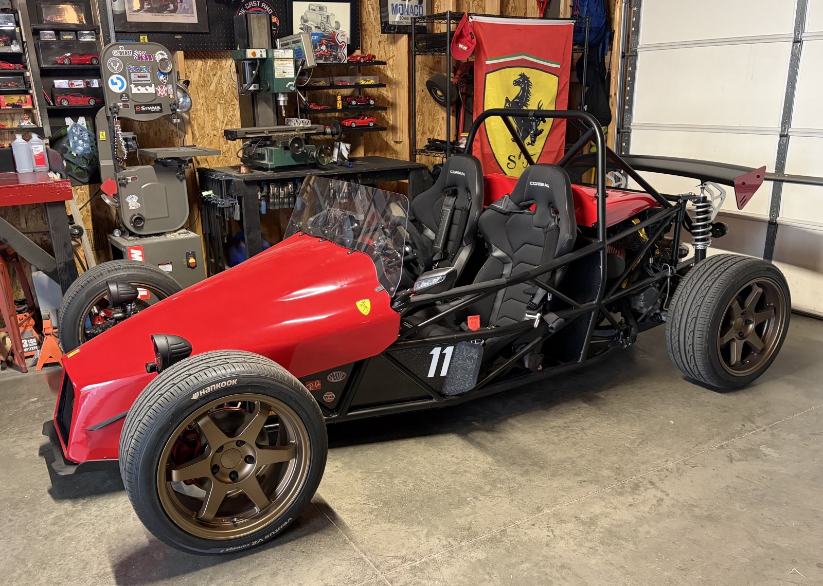

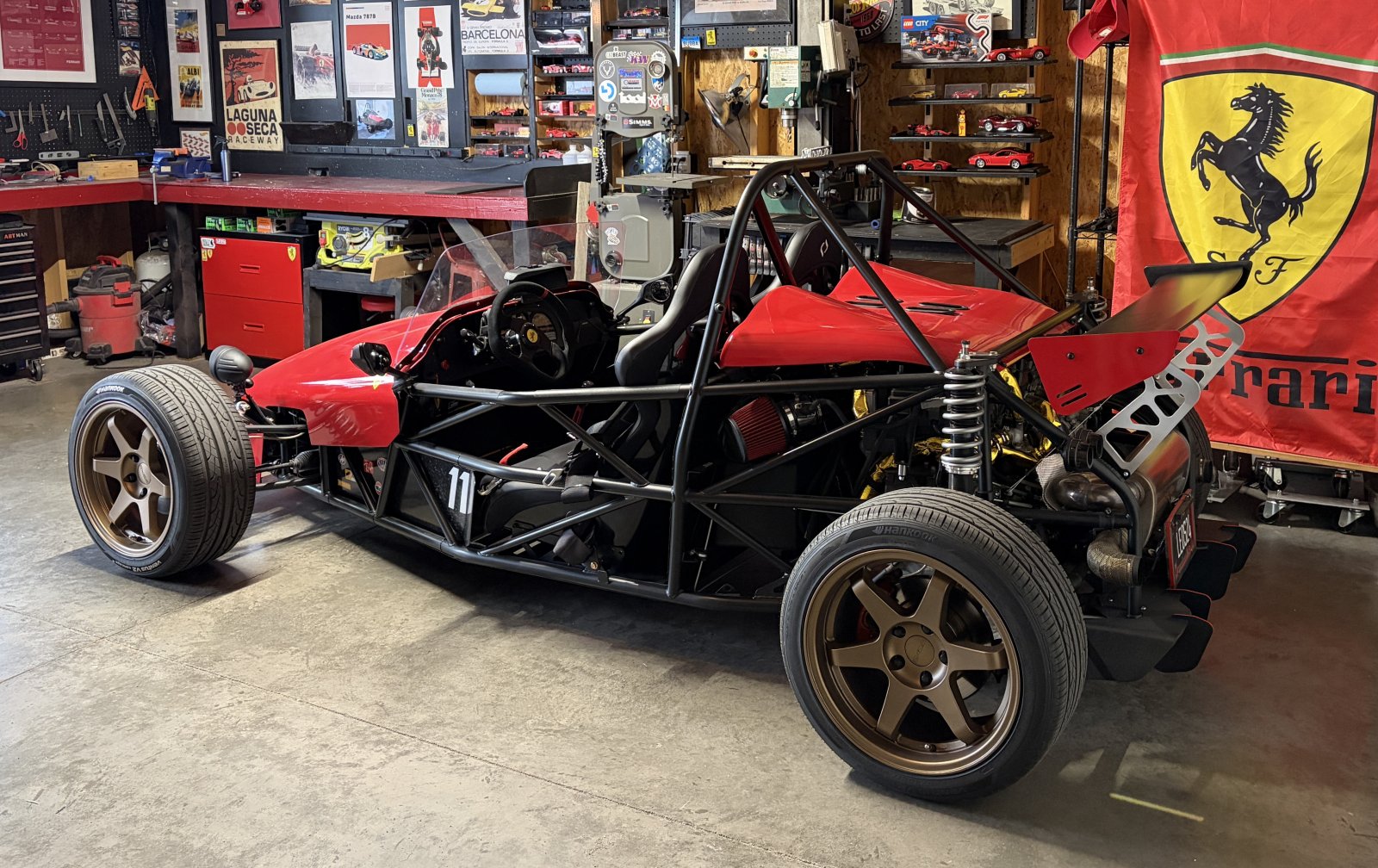

Haven't posted in a long time. Car is "done", registered, insured and back on the road for the spring. Have had a blast driving it around town, been to some cars n coffee, had some little issues and some bigger ones, but over all been a blast. some pics of the car and some little project parts that i had fun making.

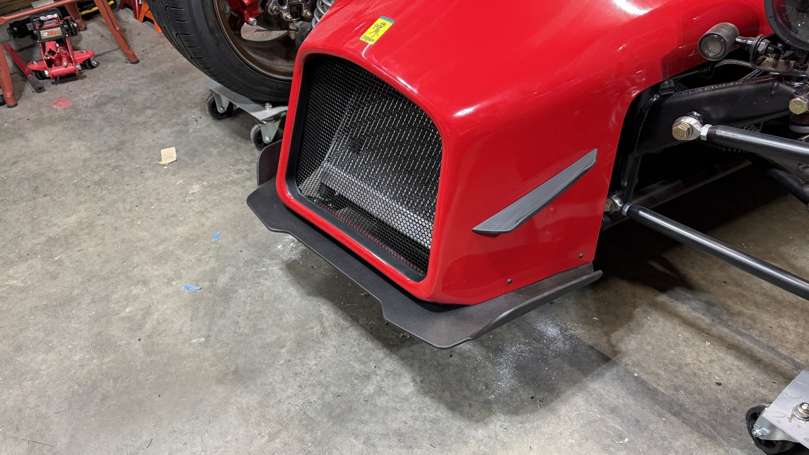

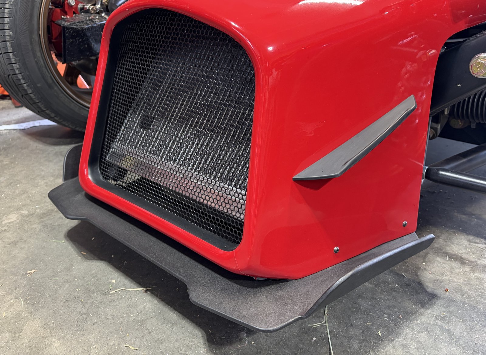

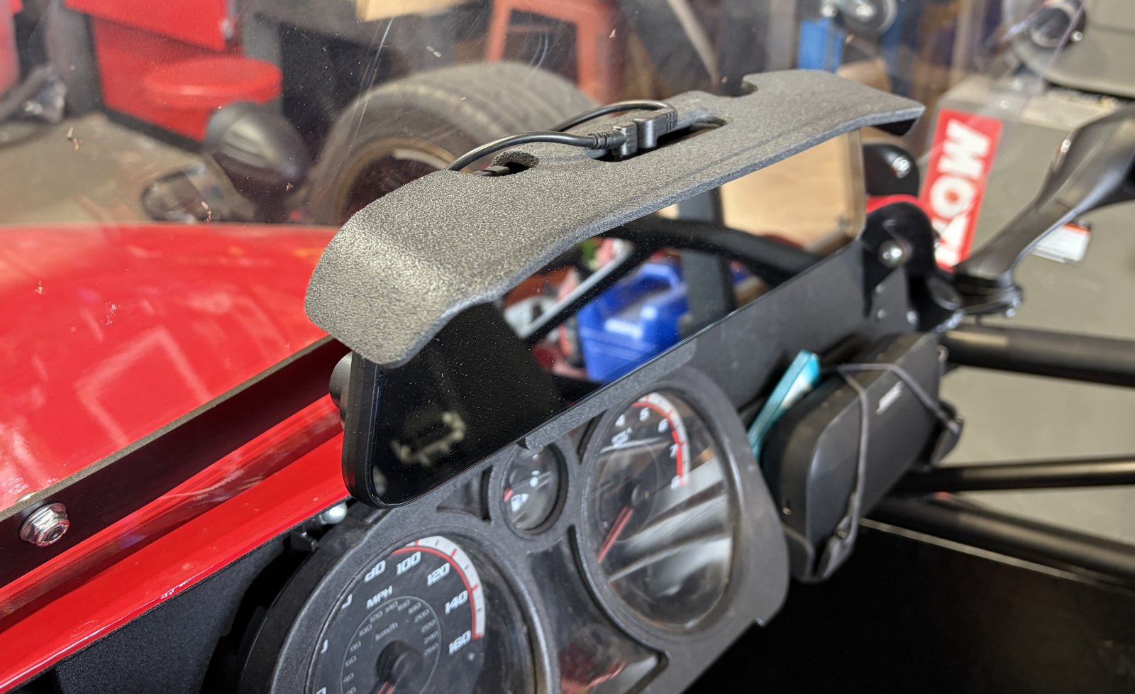

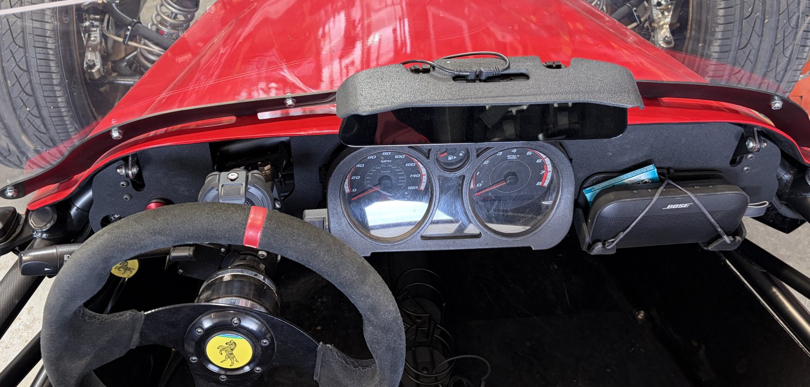

So here are some shots of my winter projects:
Rear view camera screen sun shield

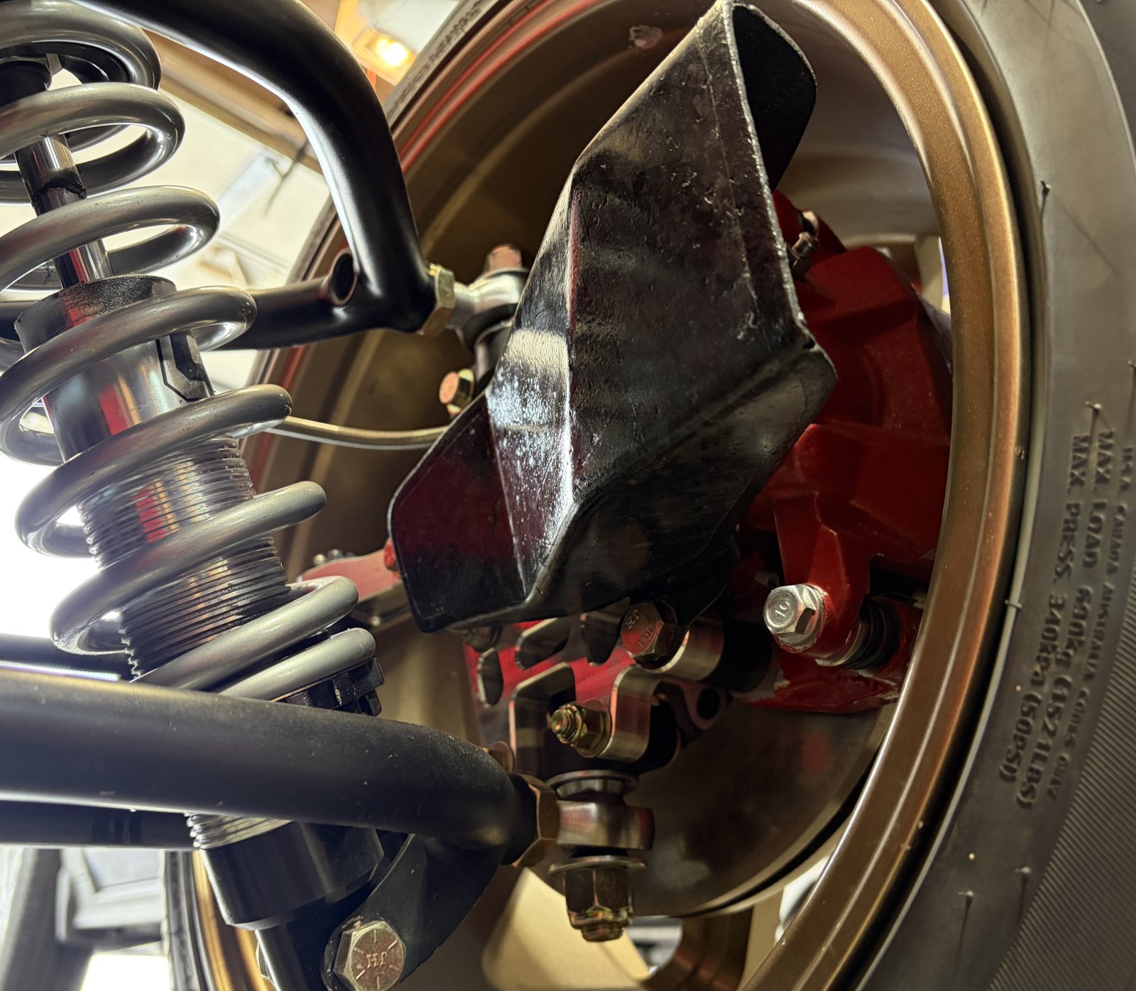

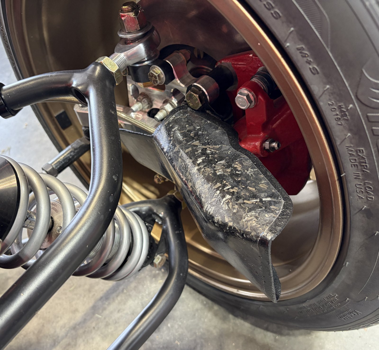

Front brake scoops
Rear “diffuser” to cover the subframe

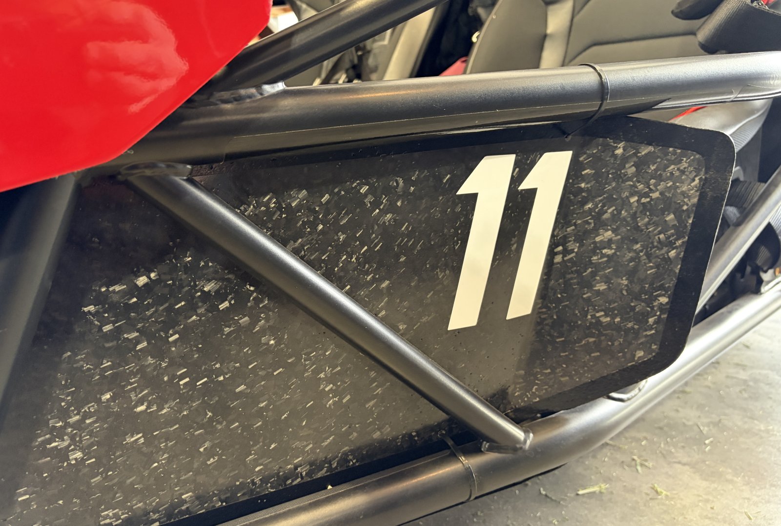

Side panels to keep debris out of the footwels
Dashboard

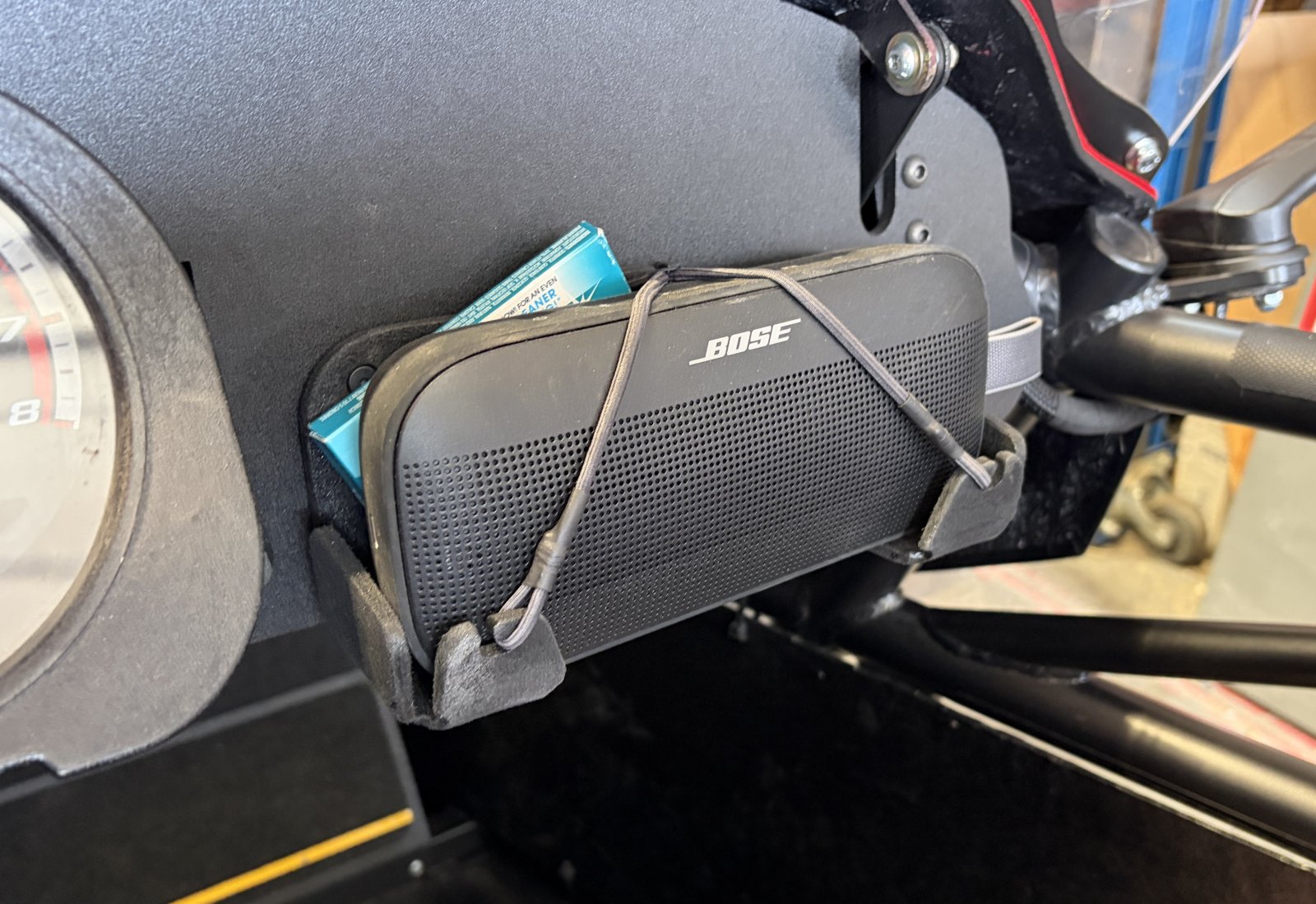

Bose speaker holder

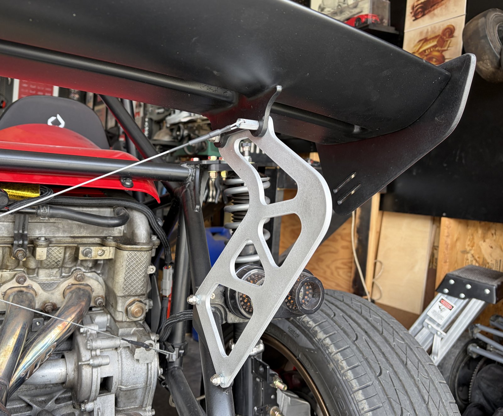

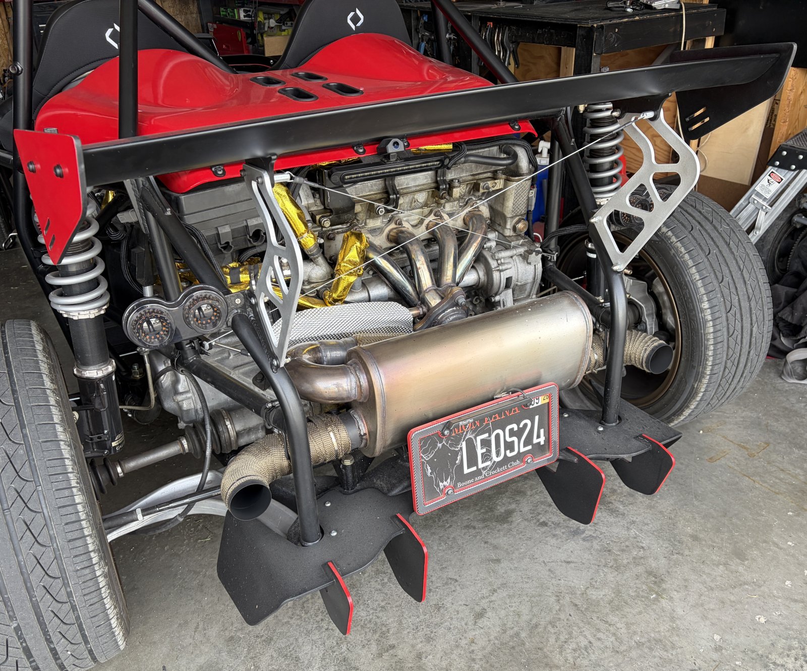

Rear wing made out the old cobalt wing. Designed and ordered uprights and wing mounts from send-cut-send

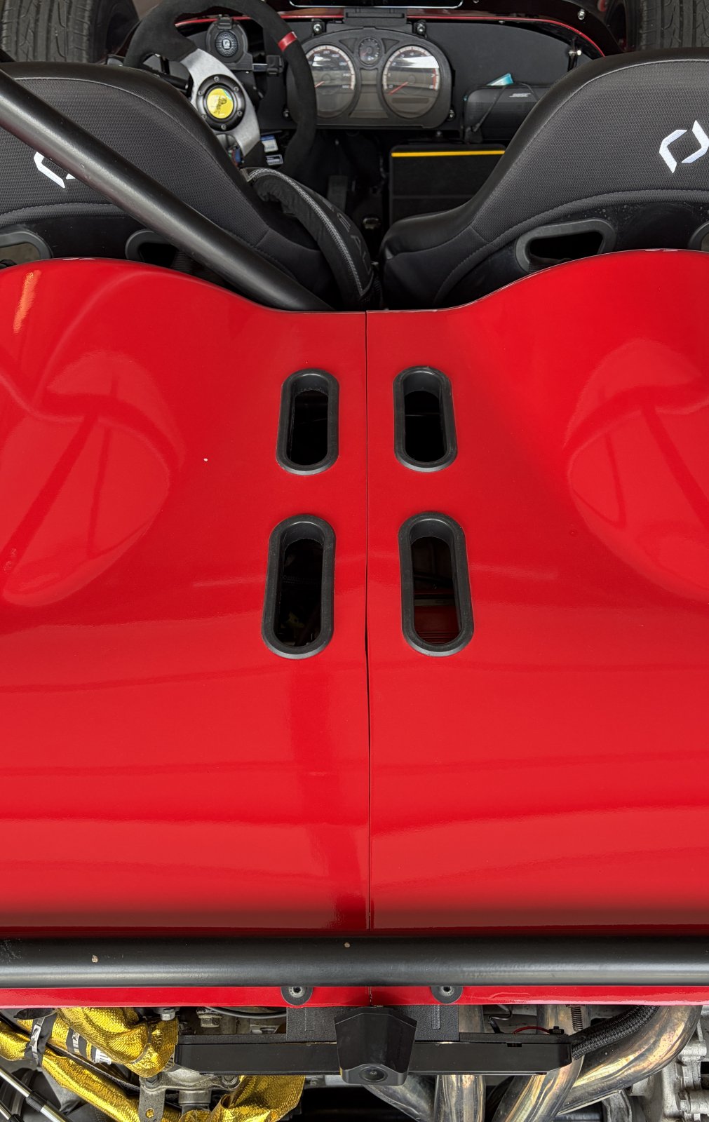

Engine cover vents
Front splitter

Yeah, the exhaust caught my eye out of all of it. The other items are really nice too.
Thanks. I knew I wanted a dual tip exhaust. It’s actually a jeep muffler. I had to get a new header cuz the old manifold was cracked, welded, and recracked. My buddy and I made the new pipe to run from the header to the muffler. Then made new tips to be symmetrical with the frame.

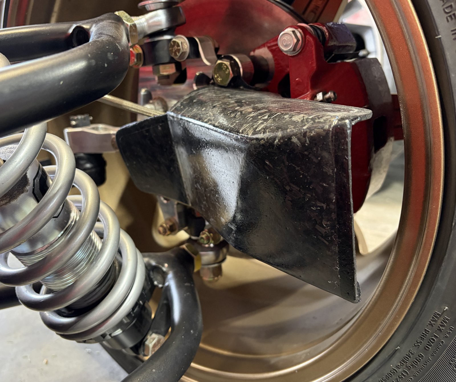

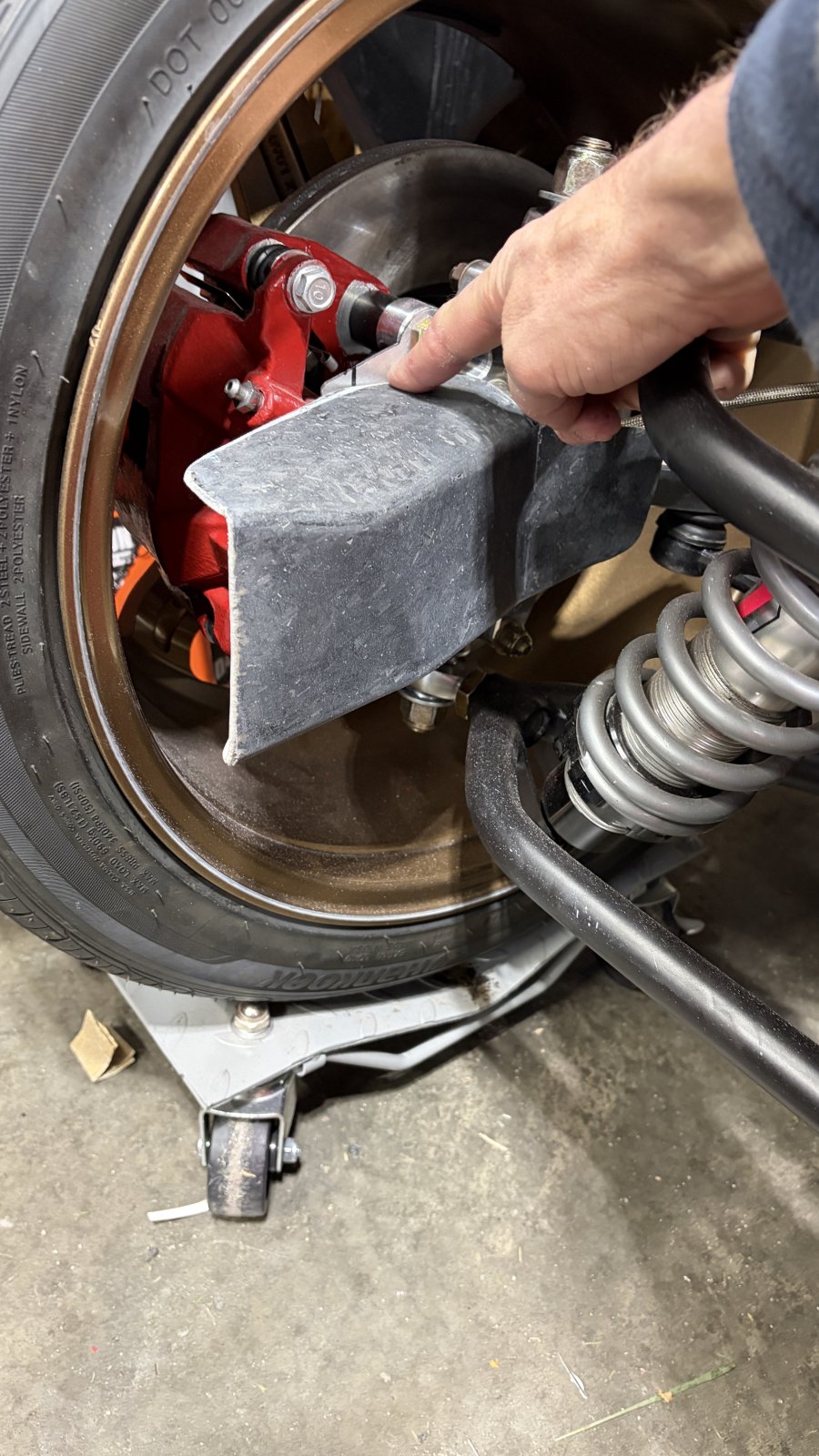

Tell me more about the material and process used for forming the front splitter and other pieces.
Are the brake scoops the same material or made out of metal? How did you make these?

For the front and rear "aero", I designed the shapes I wanted in Illustrator and lasered the flat parts out of ABS ( I think) then used a heat bender to make the angled parts. Then just used machine screws to go through the body with nuts on the back side. The panels on the side were a similar process but I used to the bent plastic as a mold. I laid fiberglass, composite foam core, and then chopped carbon fiber to make the actual panel. Then ditched the plastic. These work well to keep wind, rocks, and water out of the foot wells.
The rear wing is actually the wing from the cobalt. I took off the stock uprights and lasered out new endplates from the same plastic. I designed the new uprights in Illustrator and had Send-Cut-Send cut them out. Then bonded them to the wind with fiberglass. Its actually a two part upright so I can separate the wing from them if need be.
The front brake scoops were made with the same plastic mold method i used for the side panels. I going to remake them though now that I've learned a bit. The ones in the pic are a little sloppy for my taste.

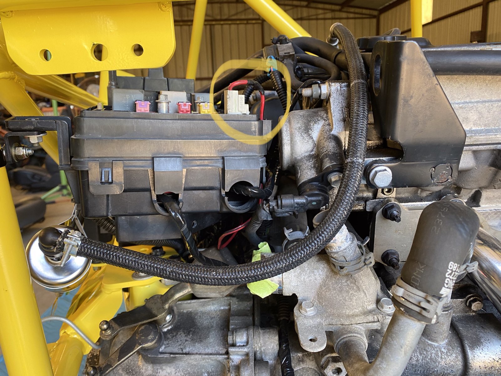

Hi everyone. So I bought a oil filter socket (32mm x stumpy) and tested it on the oil filter cap. I immediately dropped it and it's now sitting somewhere on the engine. I can't find it for the life of me. I've got under the car, used flashlights, reached in, etc. Any thoughts on where it might be sitting or a way to grab it? I'm gonna take off the intake tube next to maybe be able to see a little better.
It’s in the land of 10mm sockets now. Go ahead and say goodbye.
Small flexible magnet is your friend. It’s probably wedged behind the oil filter housing.

OK. I sort of figured. I thought about a magnet but it's an aluminum socket. Don't think it'll cause any issues living there? I'll make some sort of tether for the next attempt.
