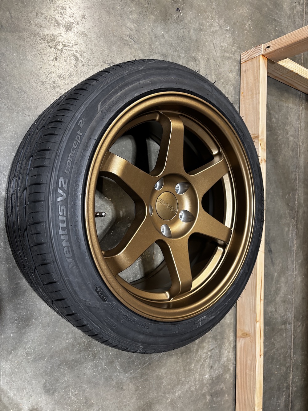

My goal for the theme of the car is sort of a late 60's Ferrari F1, resto-mod, sort of deal. I've already for my vintage bronze wheels.

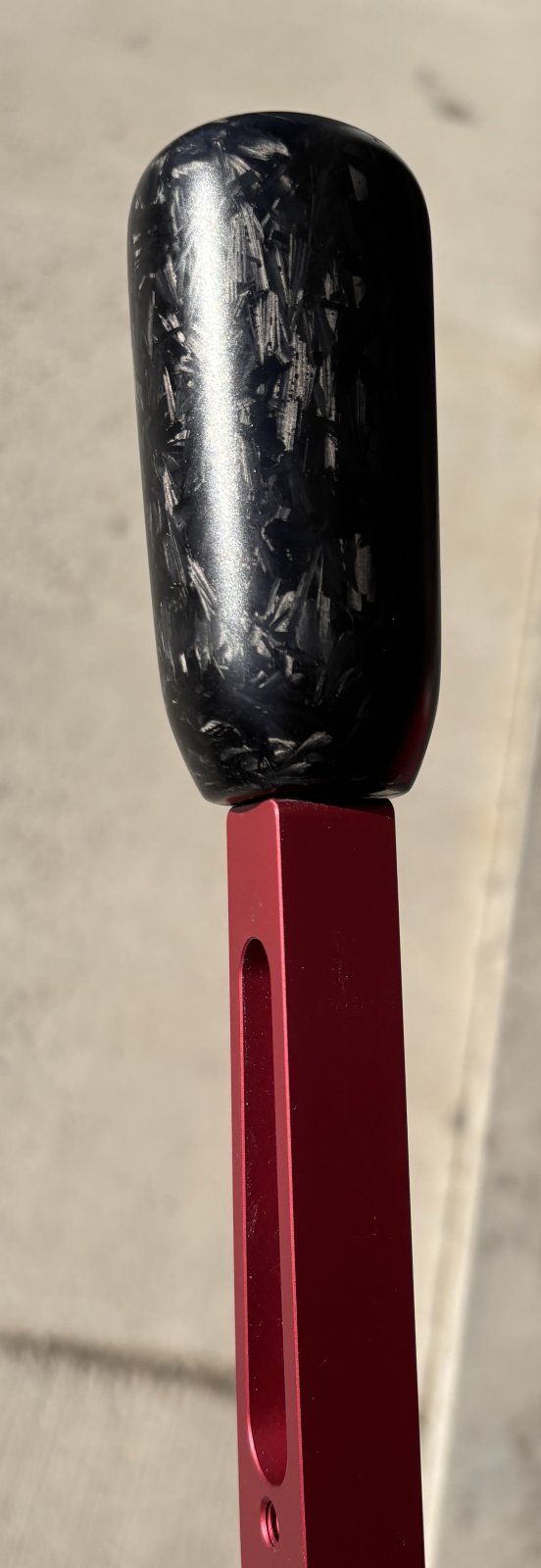

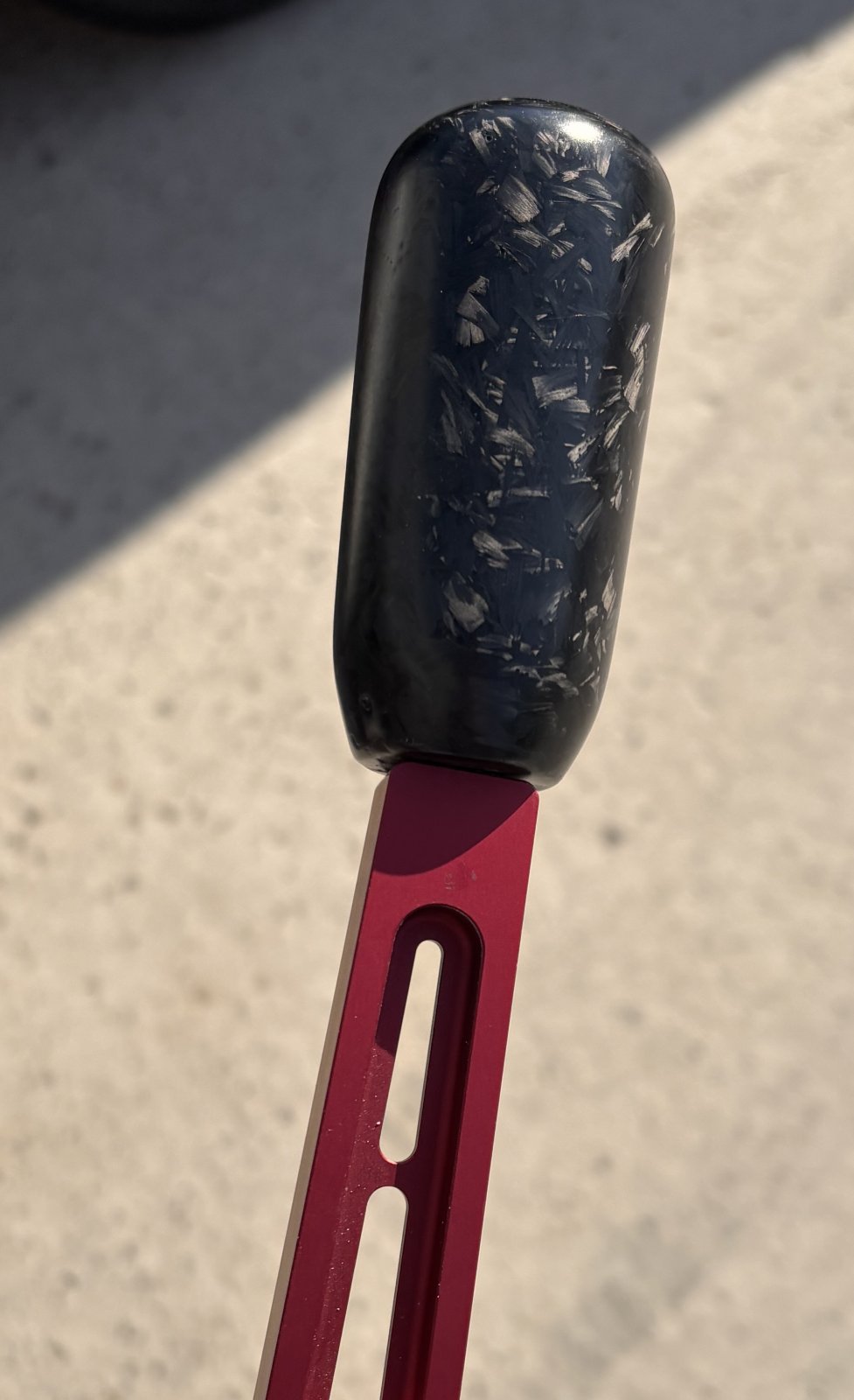

Just a quick update. I haven’t been working on the car much, as I’m waiting for my family to come visit to join in on the fun. I’ve just been working on little side pieces. I decided to make a carbon fiber knob for the shifter. Took some experimenting on the technique but I think it came out pretty good. Excited to see it in the actual car.

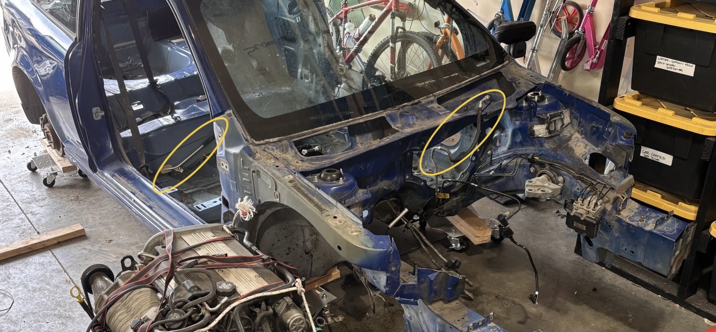

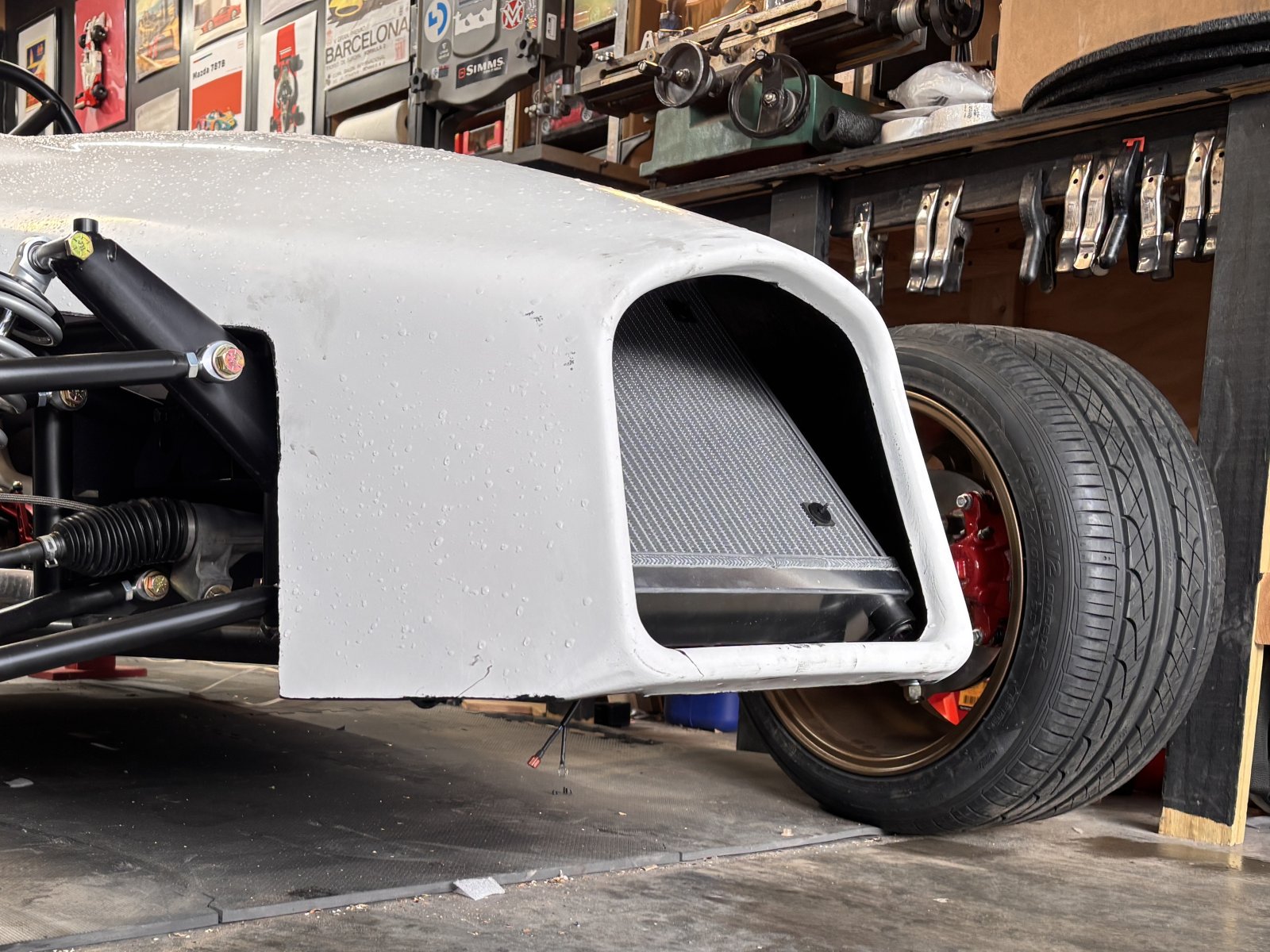

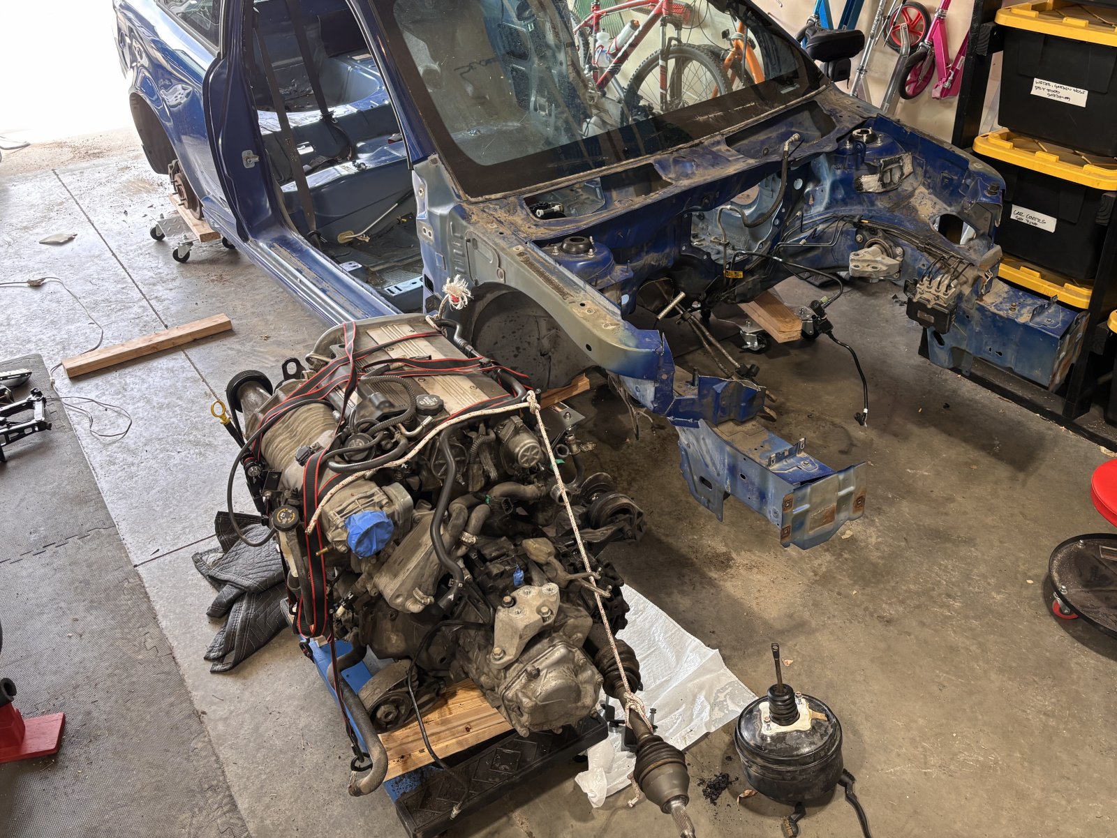

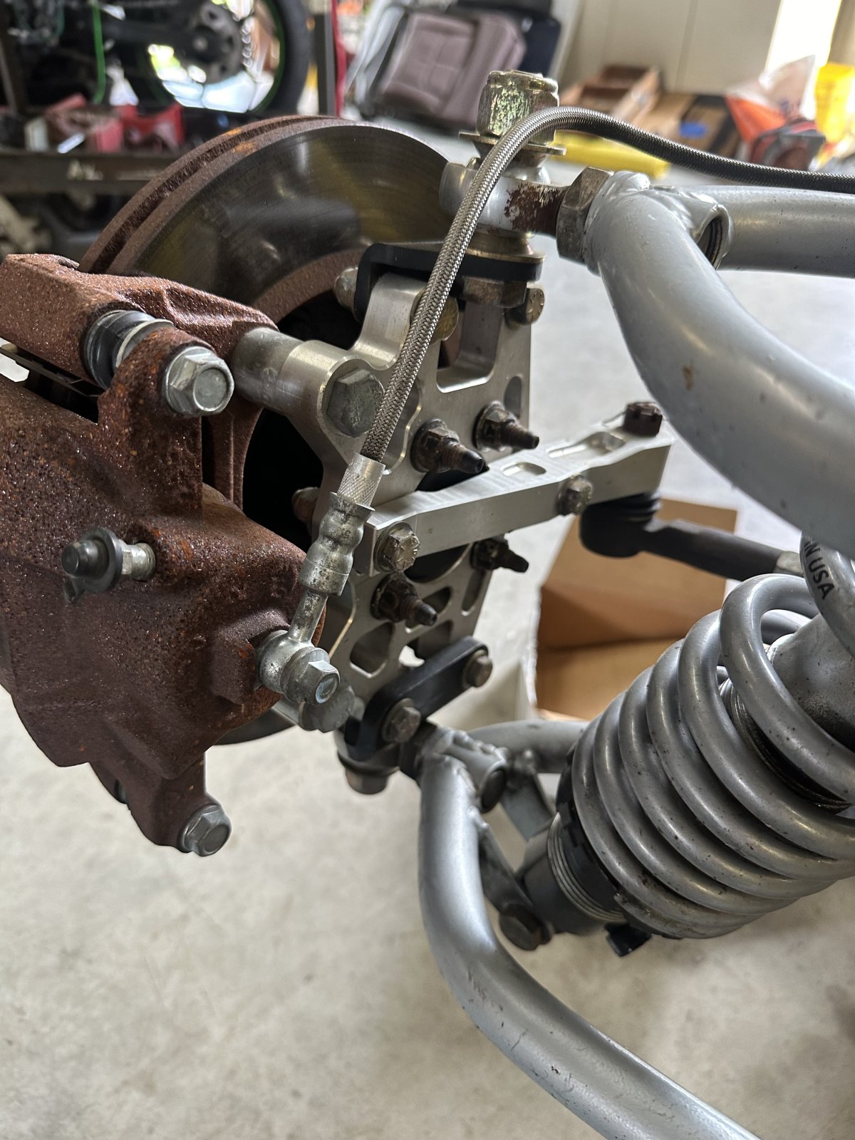

Some huge progress over the last 5 days. My folks are visiting and my dad and I got a bunch done. Got the cobalt almost completely stripped
minus some stuff on the rear. Then we did the steering rack, put in the gas tank, and did the whole front end. We are sort of working out of order so I hope that doesn’t bite us later. We dropped the front down on the tires and my ride height seems really high. The springs are extended all the way and the knob is turned all the way to minus. Will all the other weight drop the front more? The “chin” of the body is probably 8” from the ground. Any advise on dropping the front? We also had an interesting issue. After a bunch of frustration and brainstorming, we found out that the inner surface of the brake discs weren’t machined all the way and we thought the discs were warped. We just deemed some material out and the fit flush now. More updates to come.

And I know you are not done stripping the doner, but don’t forget the park brake cables and guides. I also like to tell people to remove the fuel line to reuse later, for a cleaner look.

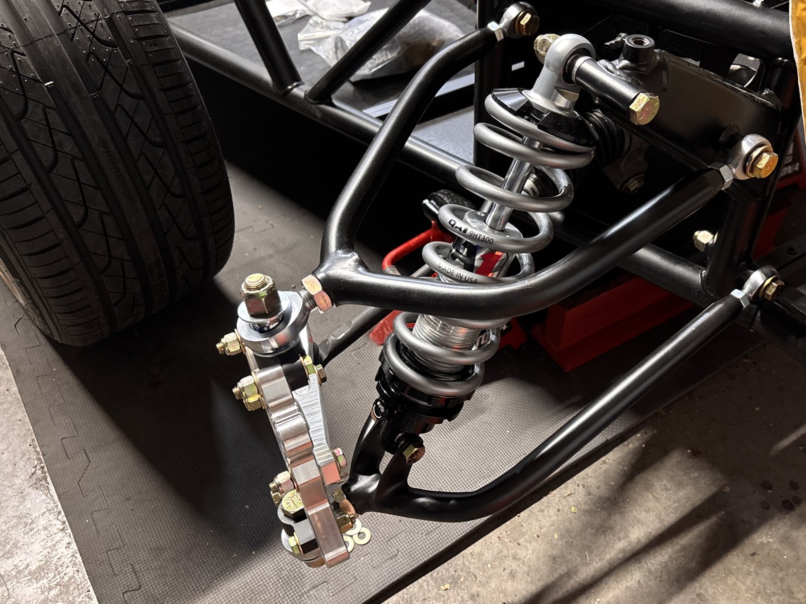

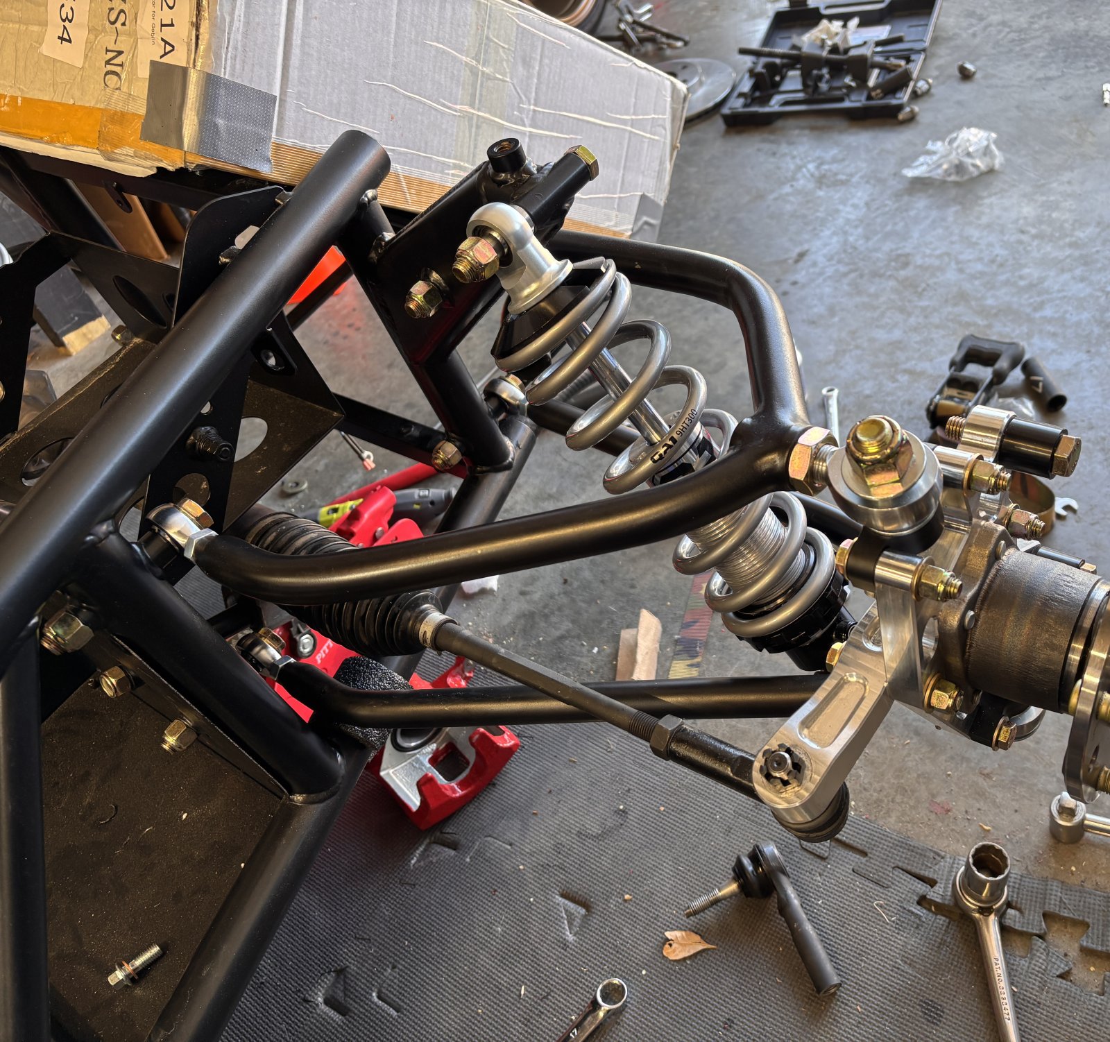

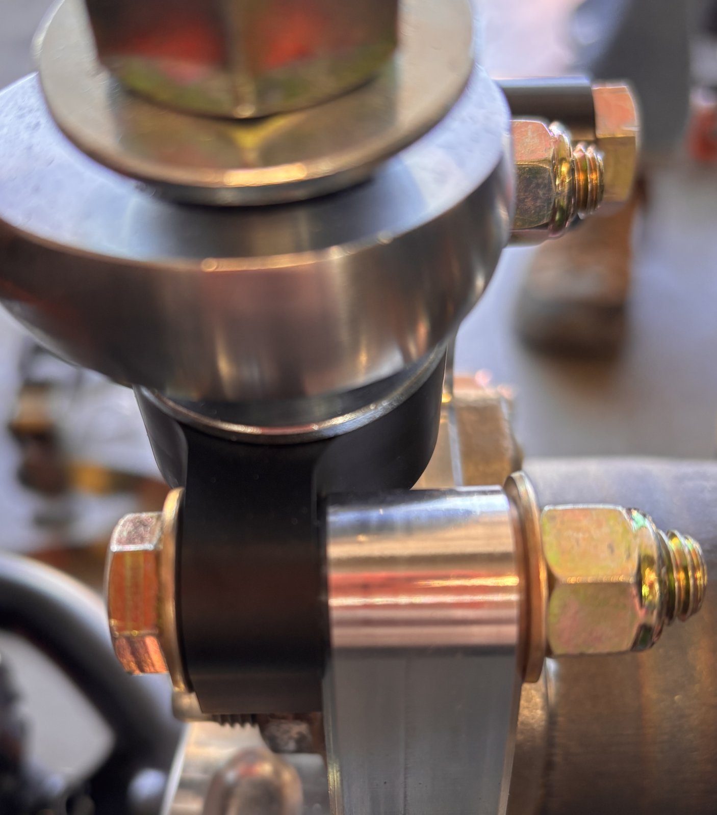

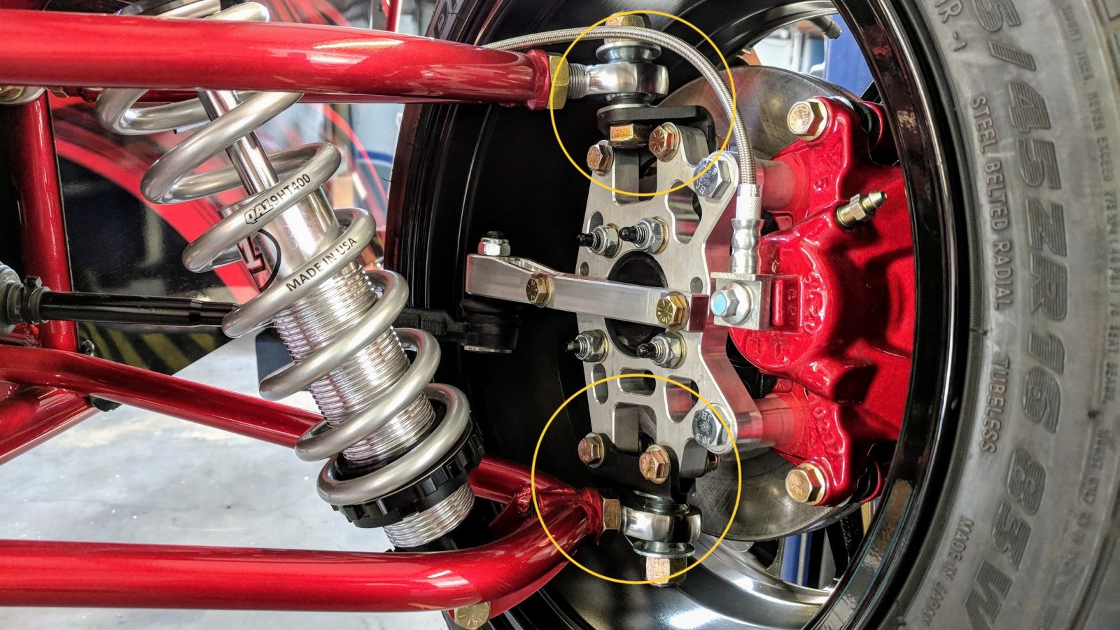

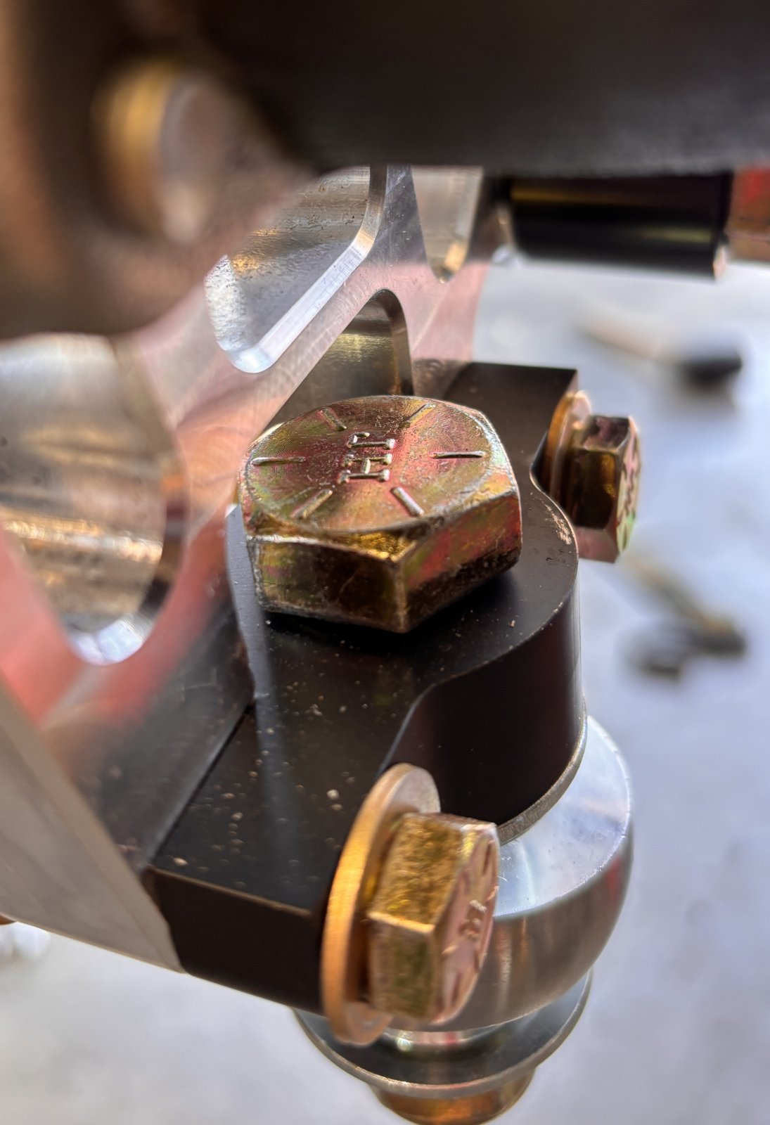

I believe that the larger side of the lobe was supposed to face toward the upright? Not sure if that makes sense. It looks like I have a slightly different design that the pic with the red arms. Mine are billet.
They may have updated the bracket, but orientation should still be the same. Maybe someone with that bracket can confirm
It looks to me like the orientation of control arm to knuckle is similar in the pictures in post 9. Rod end on top is slightly inboard & bottom is slightly outboard in relation to the knuckle.
