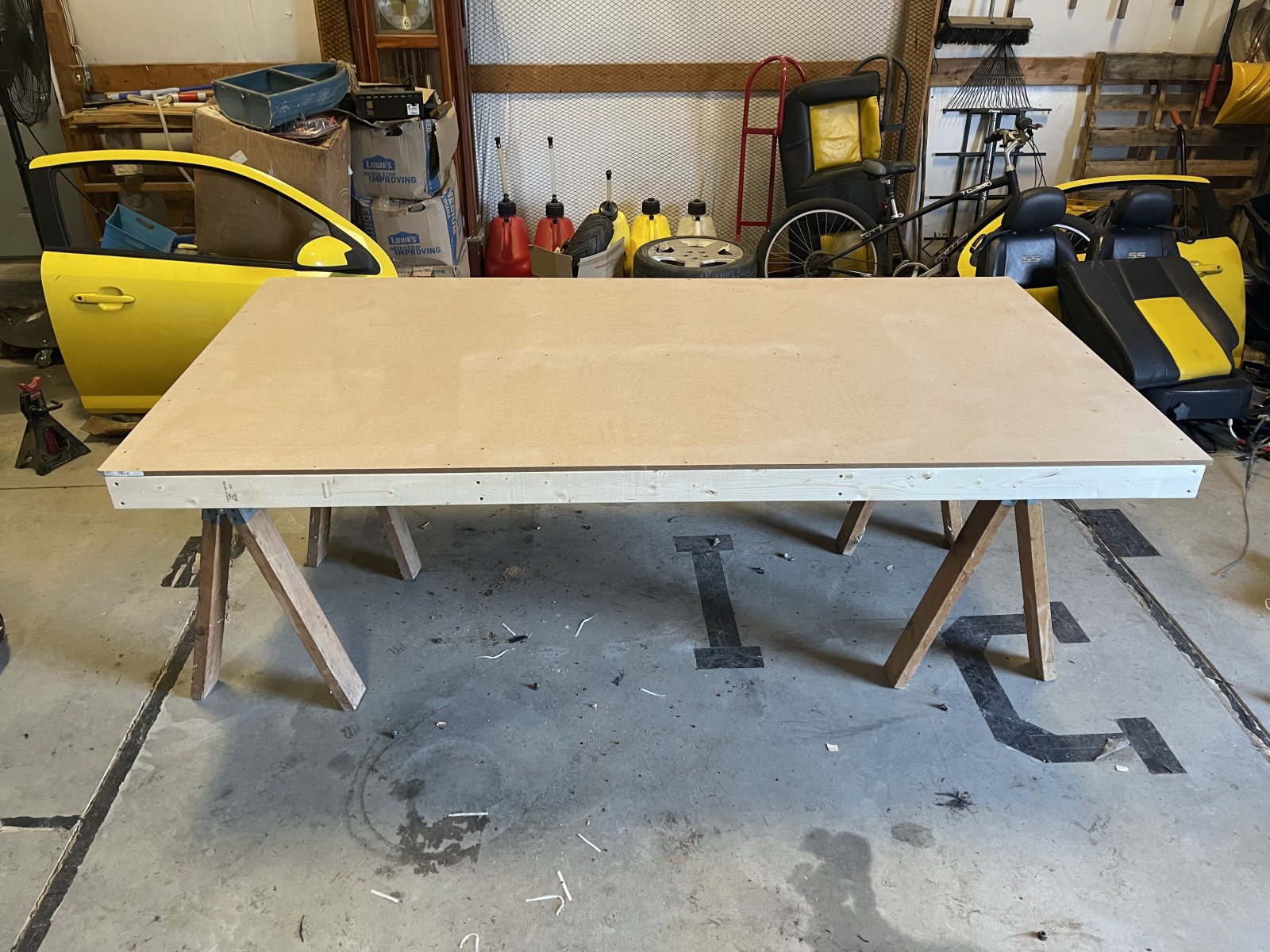

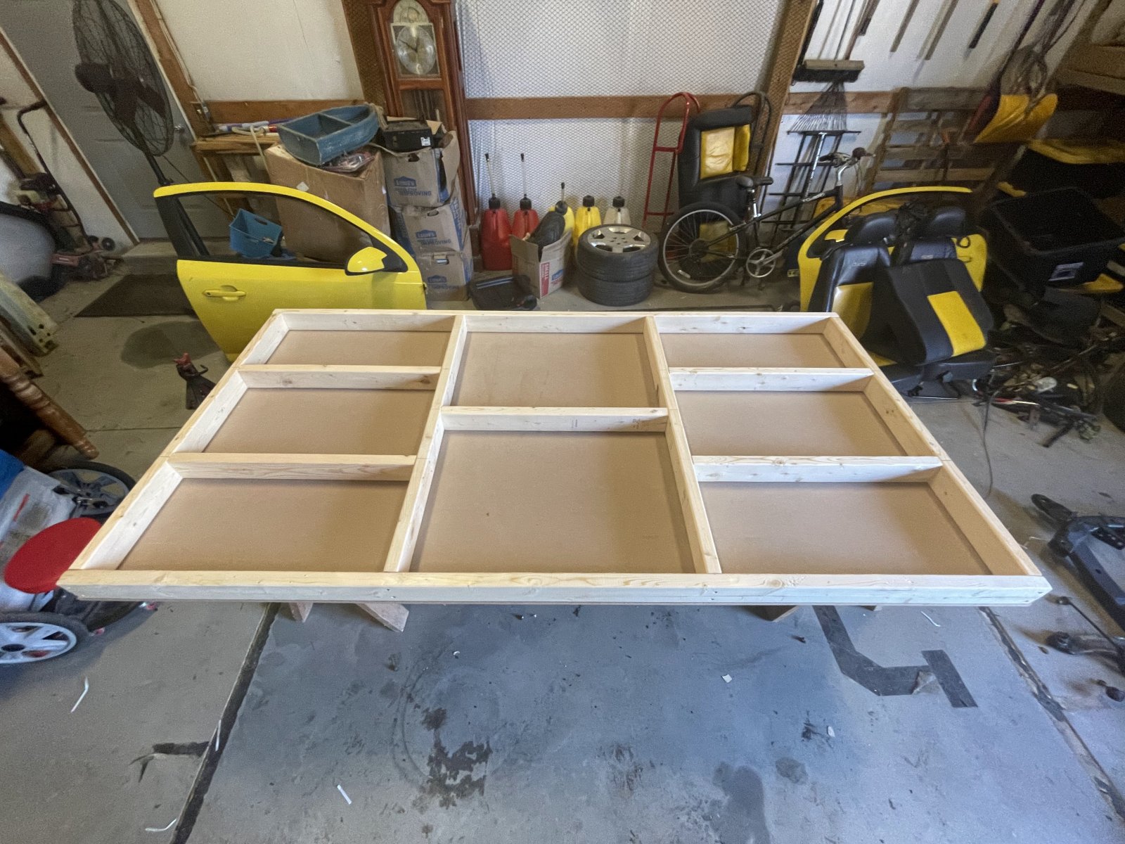

No big updates, but the shell is gone and I made a table from MDF and 2x4s. Table will sit on sawhorses for now, but will eventually make legs. Will seal it with some kind of urethane before using it for harness work, and hope to keep it around for a long time. Hope to get the dash disassembled and donor parts inventoried in the next week.

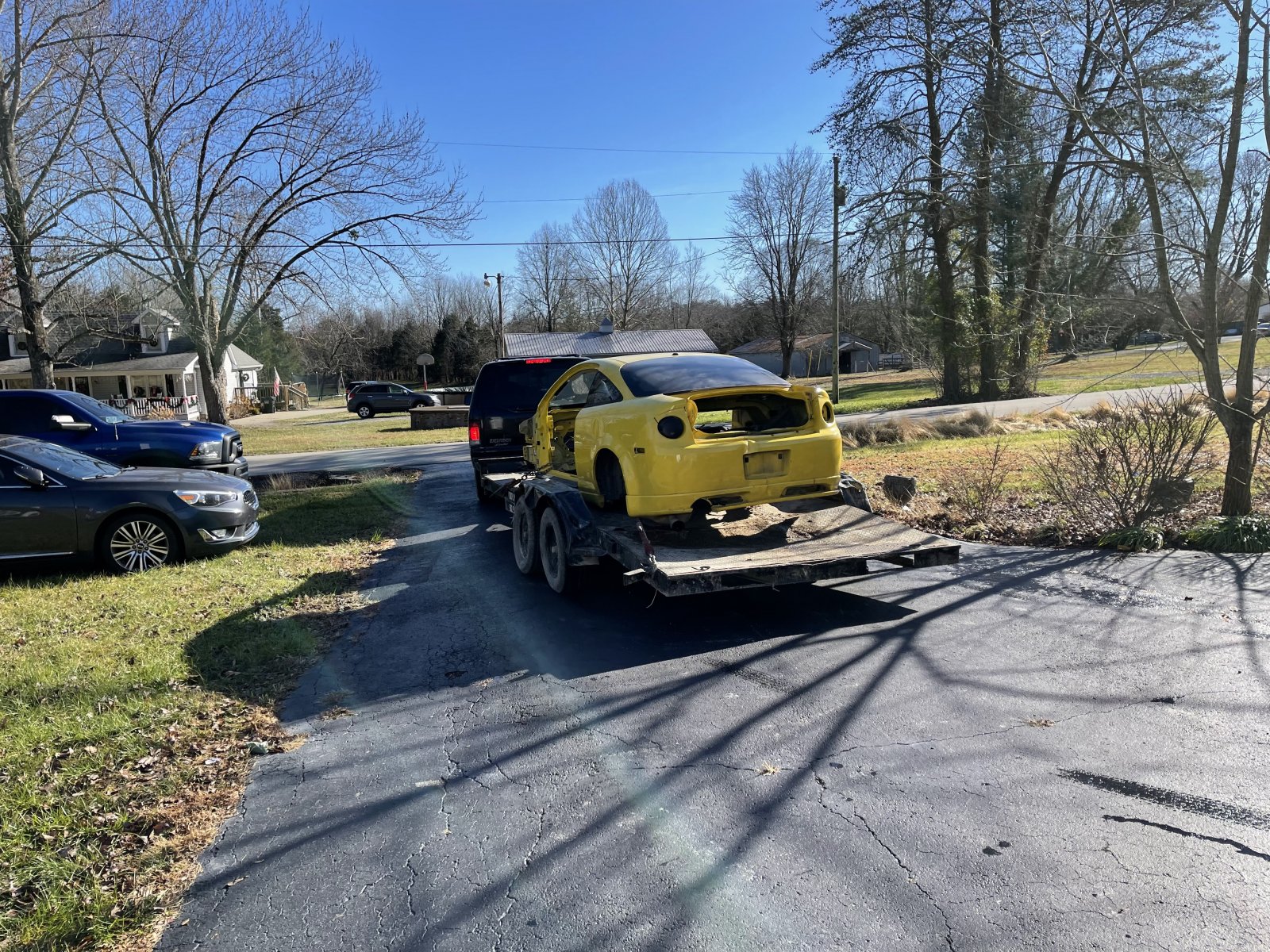

I've gotten my donor disassembled and out of the shop, but I still need to finish disassembly on the dash and do my wire harness work. I made a work table for the harness (nothing special, but it's more just a sheet of plywood on saw horses; nothing wrong with that but it was a good opportunity to make a new shop table). Otherwise I've been focused on other things. The holidays, promotion at work, family time...that's been my priority lately, but expect to refocus on the Goblin next month! I've got a lot of ideas but need to ground myself and set a hard budget for getting this thing built. I figured it will be late March before my frame is finished and actually landed in my drive way. That's around the same time we'll be moving in with my FIL (selling our house, living with him to save money and help him get settled into retirement and allow us to save so we can build in the next 2-3 years). He has a 40x78 shop, and another 30x32 garage...so plenty of space for activities.

I took a long break from dealing with my donor (got cold, holidays, laziness...typical excuses) but finally finished the dash disassembly, which means I am done with disassembly. I got my donor shell out of the shop mid December, so it's been gone a while now. I made a table (2x4 frame, 3/4" MDF top) for my wiring work, which I'm actually looking forward to. Been thinking about any extras I want to add into the harness (wide band, additional accessories, etc), and plan to take my time. Solder/de-solder, de-pin connectors instead of cut, wire loom tape, etc. Afterwards I will be taking inventory of my donor parts, ordering replacements for anything that needs to be replaced (likely to replace any consumable parts which makes the most sense to me) and doing cleanup/prep/paint.

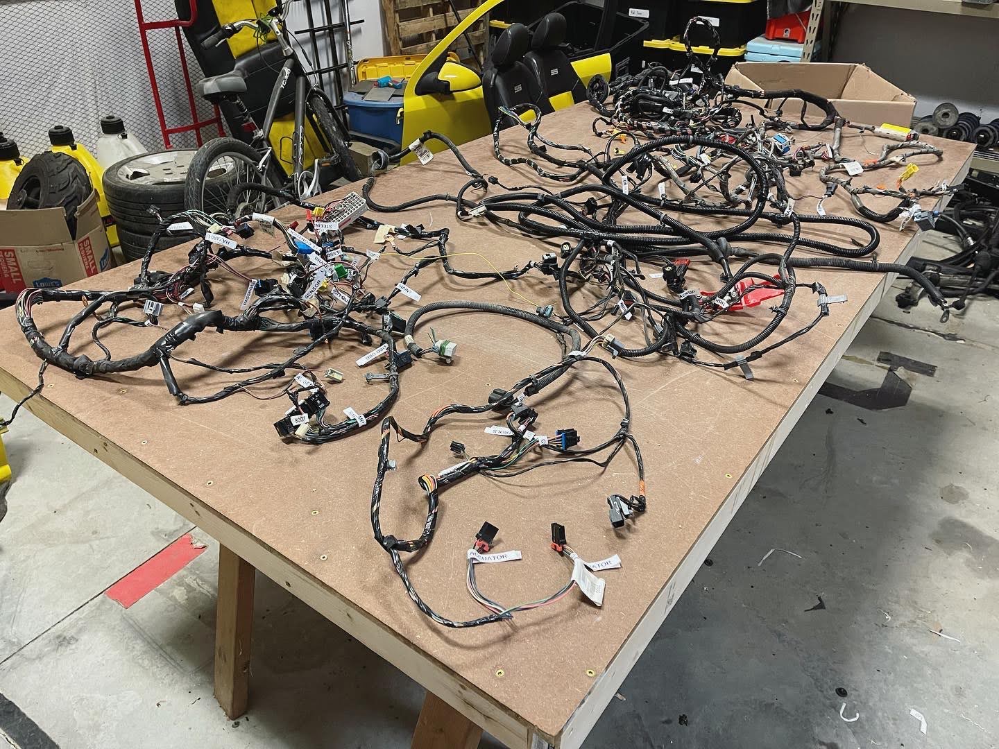

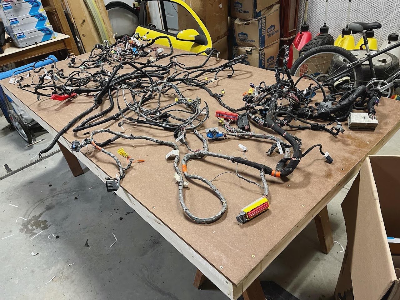

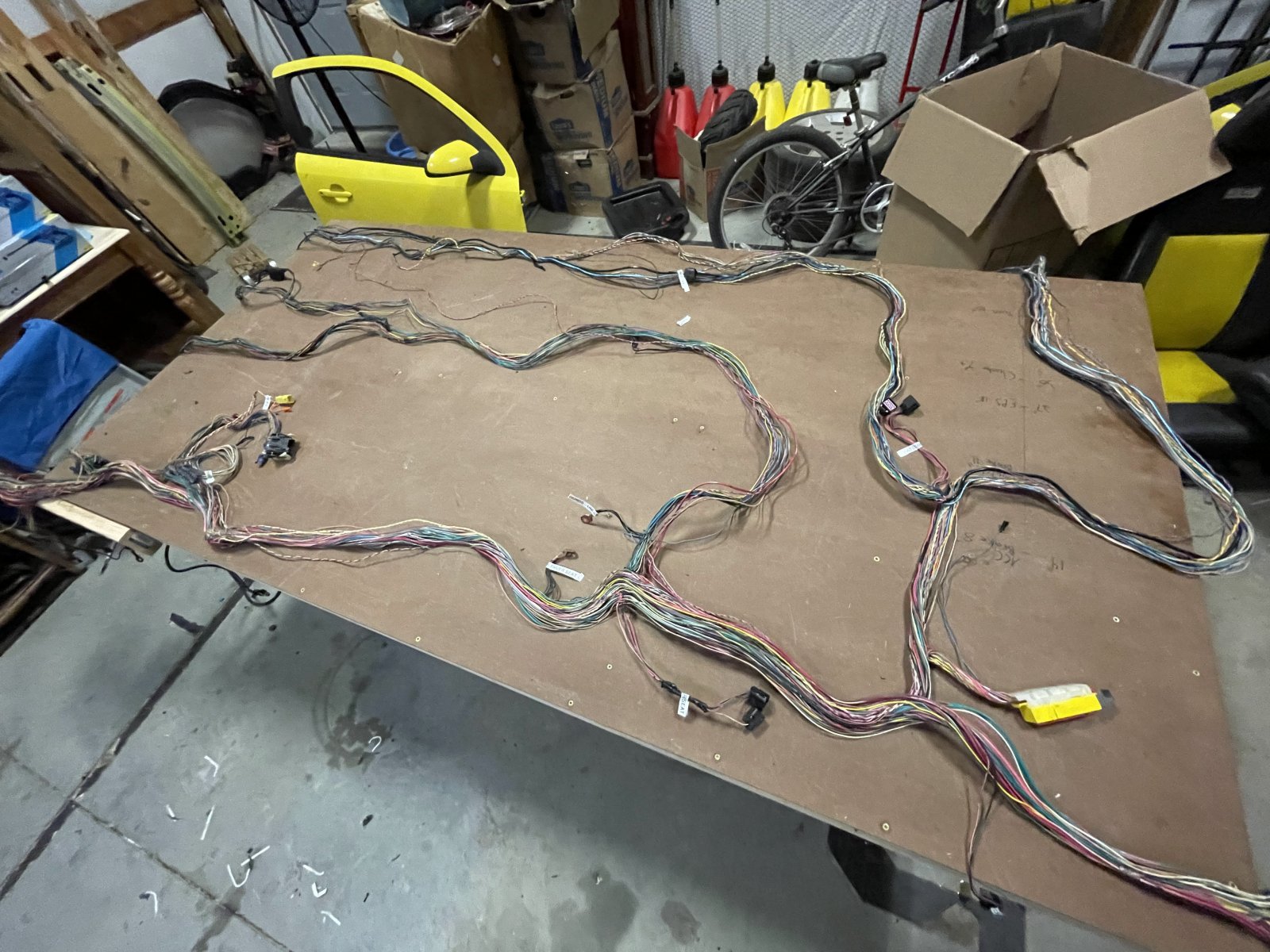

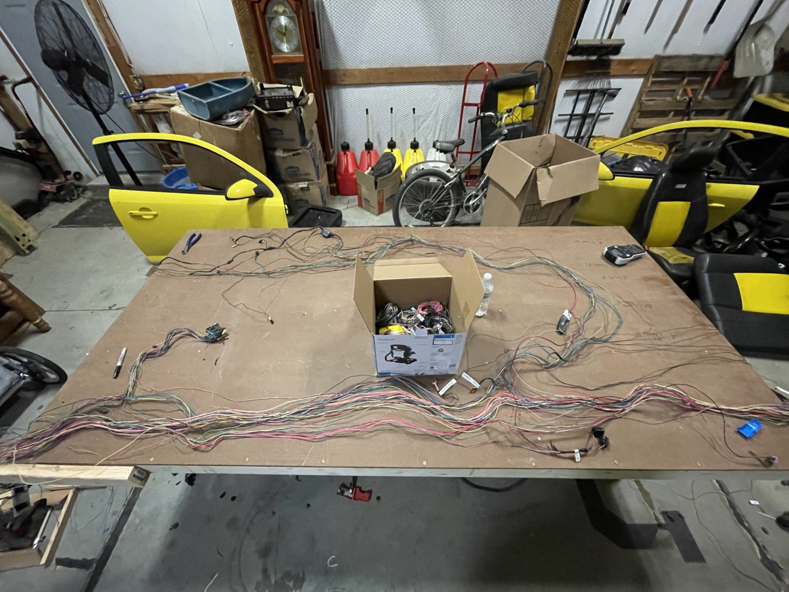

Found a little time to get started on the main harness thinning. Completed video 2 (thinning the harness 1) and 2/3 of the way through video 3 (thinning the harness 2). I found 1 broken wire that I need to trace and determine where it goes, but a wire diagram should make that easy but waiting until I finish thinning the harness because that may be a wire I don't even need. Pictures below show a before and after of the work I did yesterday, which was about a hour. I did realize that I traced and removed grounds from the lugs, that it seems I shouldn't have done but not a big deal as I can make a new lugs as needed for grounds.

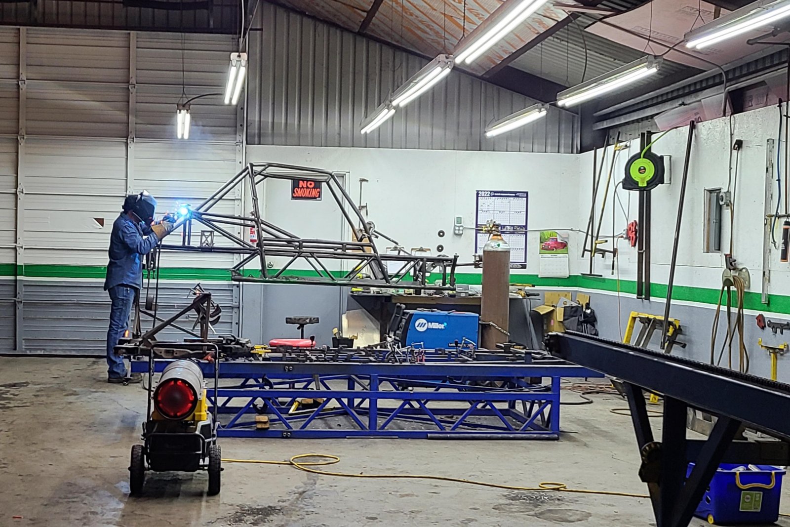

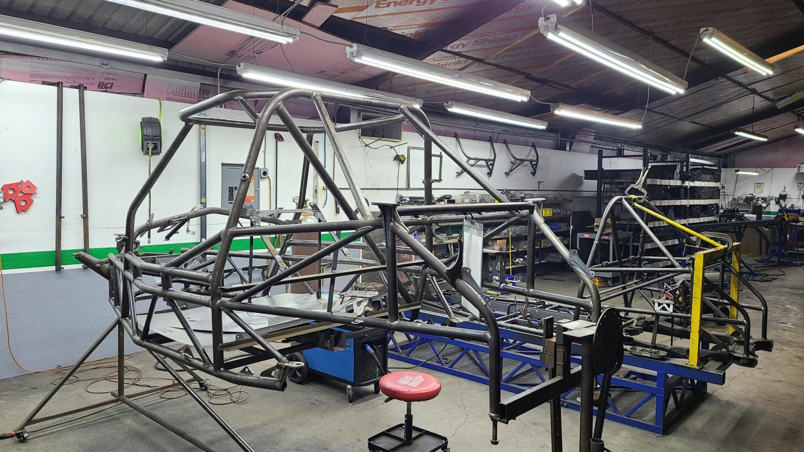

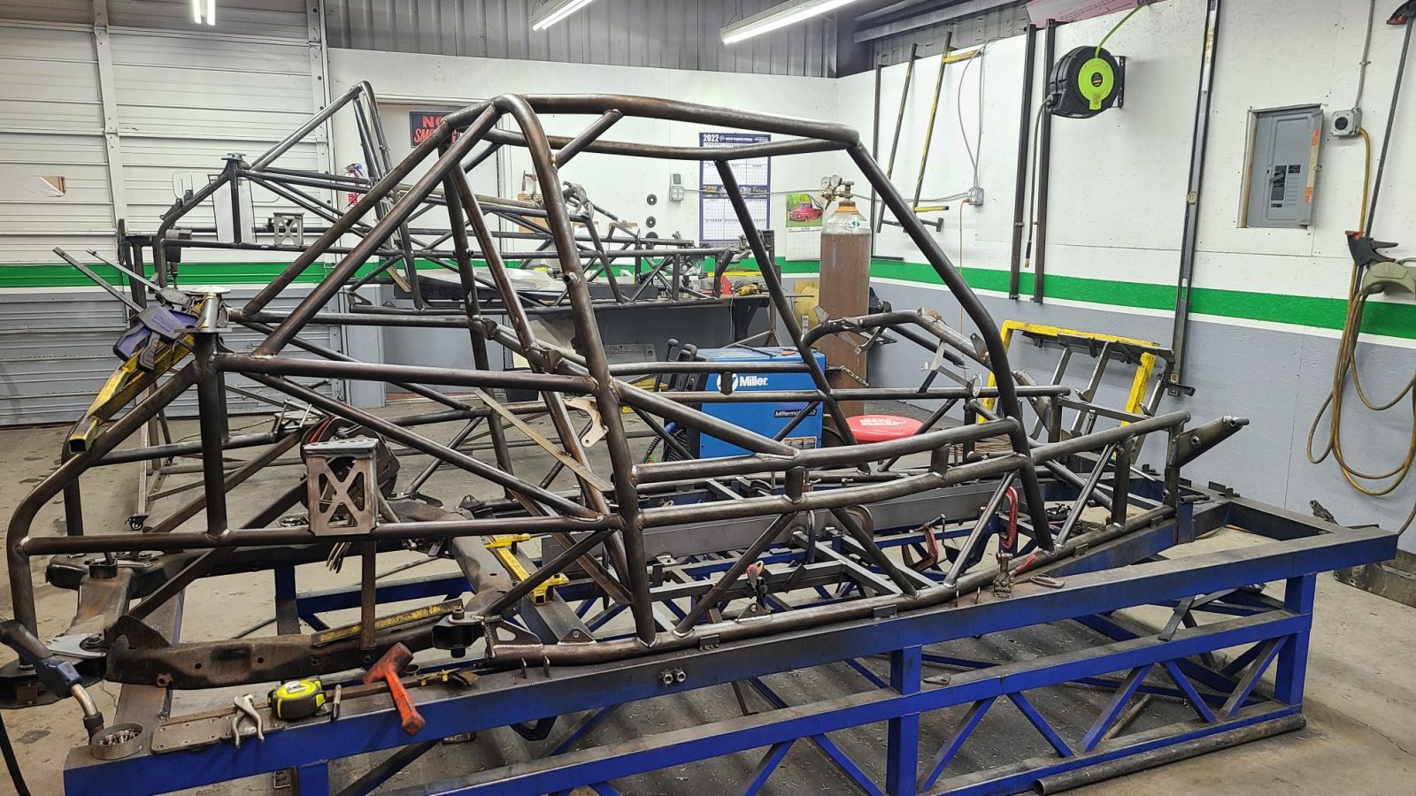

No updates on the harness or donor part prep. Really waiting for the cold weather to break before I refocus back on that stuff. But, on Feb 07 my frame went on the jig, and only 2 days later on Feb 09 passed inspection! This morning I got my invoice and got that paid for stage 1. Shipping quote is $700, and estimated "ready date" for carrier pick up is Mar 07.
