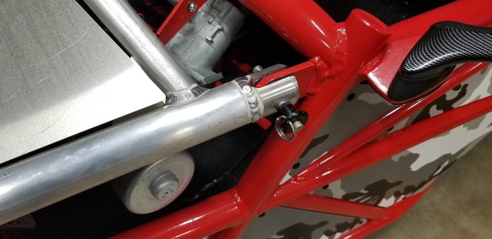

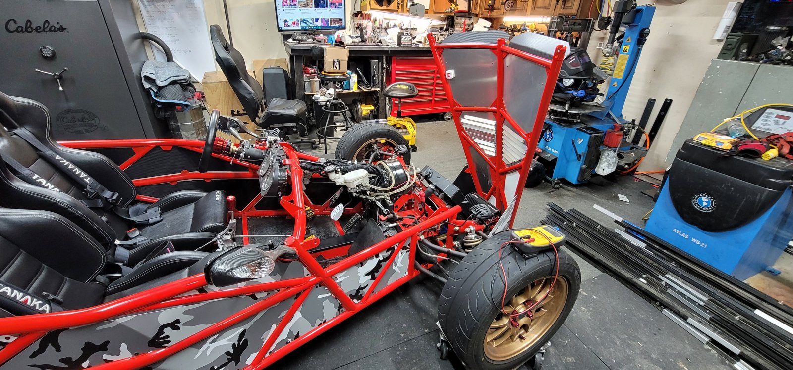

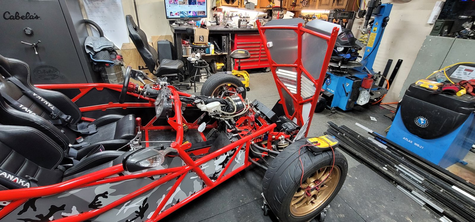

Probably mine, I only welded tabs to use inset panels instead of the solid aluminum panels. I also removed the tabs that were in place for side and engine panels.
Yours looks great too! The inset panels and exposed bars is a look I'm definitely going for well!
Thanks appreciate that! I like having a goblin that stands out against other goblins.

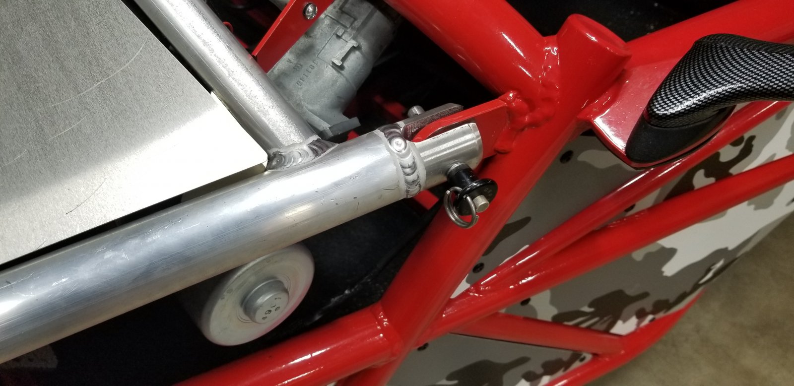

The hood you made, is it hinged? I'd love to bend a couple tubes, weld it up with inset panels, and do a front hinge like a Corvette hood. It'd be awesome!

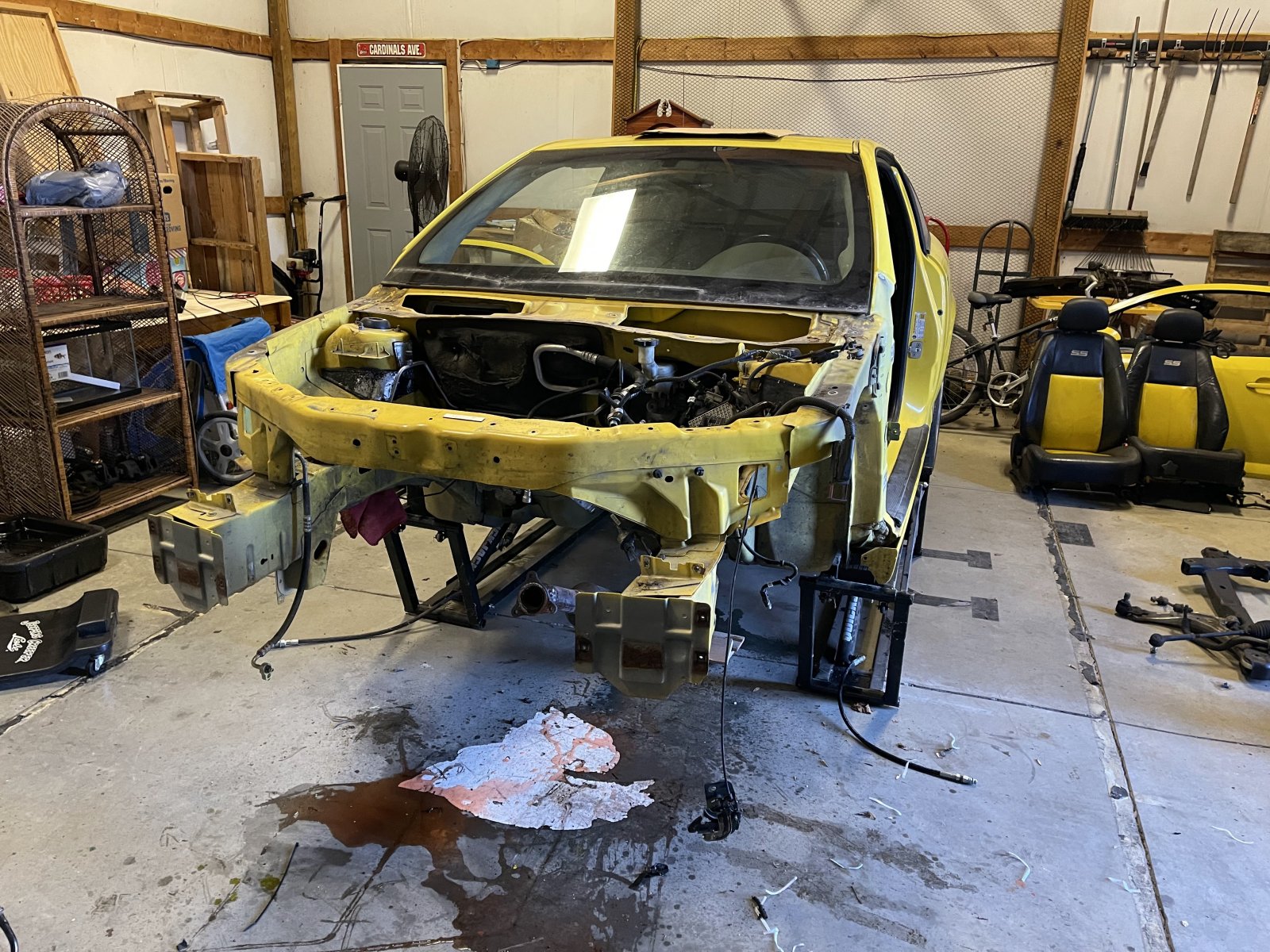

Today was my first real day working on the disassembly. I basically made it through the first 2 videos which took me about 75-90 minutes to do. I'm basically committed at this point to leaving the donor where it's at in my shop, up on the QuickJacks, until she's completely tore down. Will use the tractor to get the shell out, but that's probably after the new year.
Before tearing into it, I did (with some help) bleed the clutch slave cylinder, which definitely had air in it. Got it flowing fluid, but the pedal still isn't grabbing. Oh well, not going to let that slow down progress and I'll go over everything once the engine is out (new slave and master cylinders, since I'll already be there; upgraded clutch, hopefully find a LSD to add in, etc).
Already have the hood and front bumper sold for $400, so now I'm only in the donor for $1400. Hoping to see $100 for the fenders, $250 for the doors, and $100 for the spoiler pretty quick. I will probably sell the stock wheels and tires, and maybe the sunroof if I can find a buyer first. Hoping to pay off my donor and have extra cash to put toward new wheels/tires, seats, and steering wheel. Oh, and I'm probably going to make a recining shop couch out of the factory front seats (unless I can sell the seats for decent money). They need to be reupholstered, but I think it would look awesome!
Anyway, pictures aren't anything too exciting, but it feels great to finally get started!

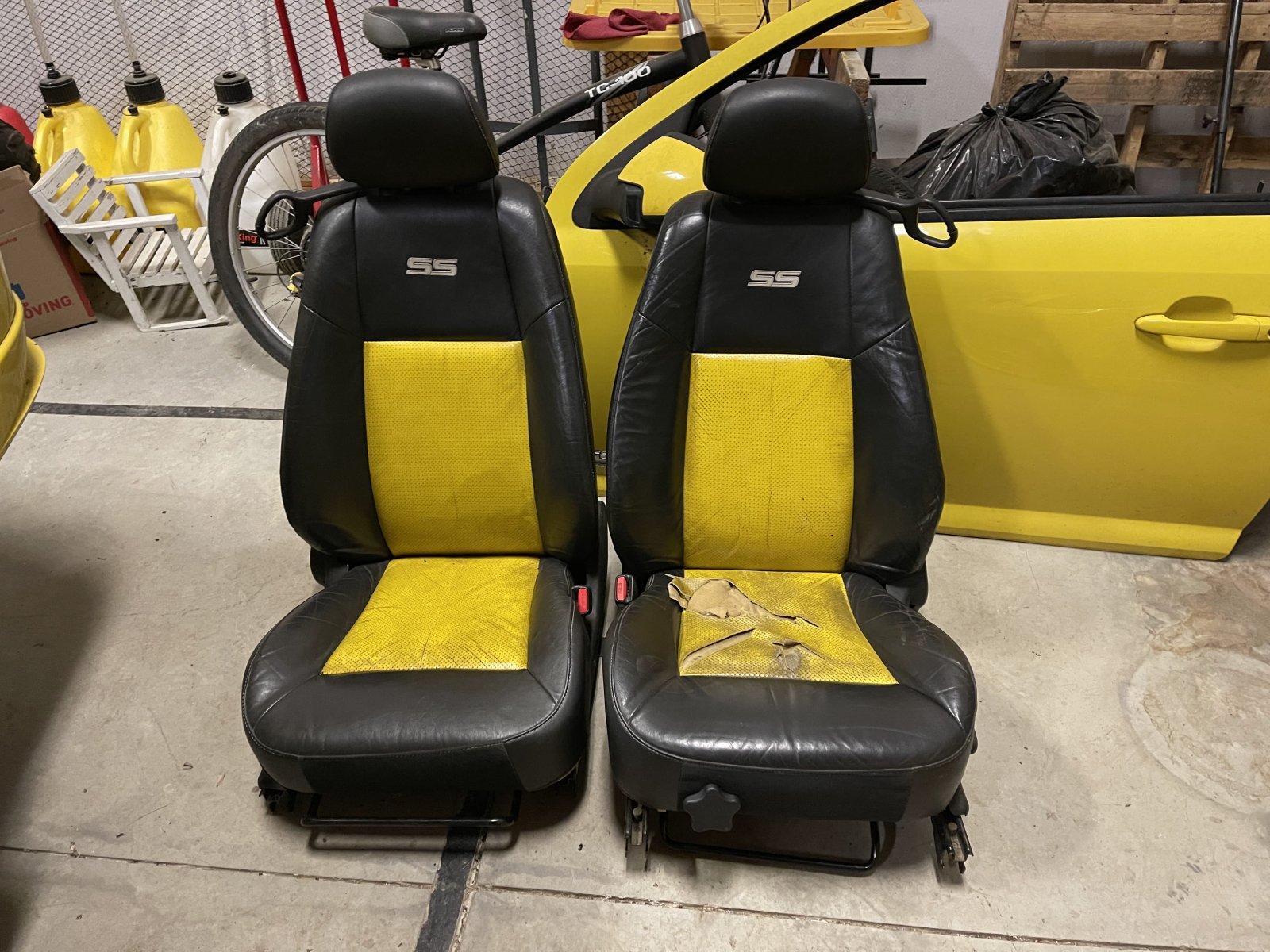

I was planning on selling my seats, but after getting them out of the shop and onto the floor...it just clicked. It would be really cool to keep those seats around especially considering they were from the donor. What did you price your doors for? I have my fenders listed for $100 and doors listed for $250 on FB right now. Listed last night and have a few people interested already.

DCMoney
Yep, I made the front mounting bolts the pivot points, welded tabs to the frame prior to powdercoat for 3/8" detent pins.
Man, you’ve done exactly what I had pictured in my head. I have an idea to do some tubular bends instead of all straight tube, but the principal is the same. Love it!

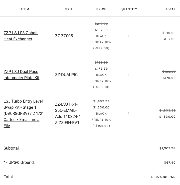

Black Friday got me. I ordered the ZZP Entry Level K04 Turbo Kit, along with their S3 Heat Exchanger and Dual Pass Endplate. This wasn't in the plans, but plans are made to change; right? Looks like my "version 1" build will now be a LSJt K04 setup with 80# injectors and tuned on 93 Octane. Hopefully this can get me 300whp and 350 ft-lb torque!
I fully expect to also buy neutral balance shafts and a new intercooler pump before the kit is built. Otherwise I'm going to try and stay off ZZP/OTTP for the time being.

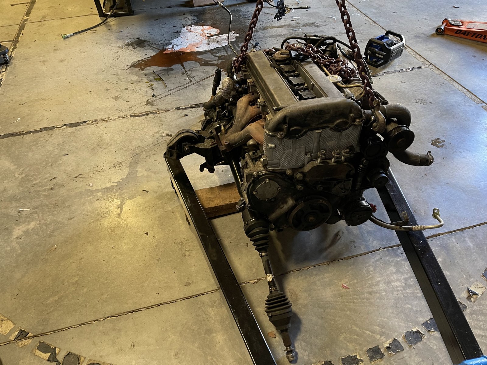

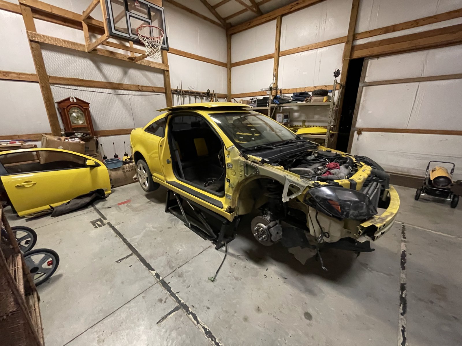

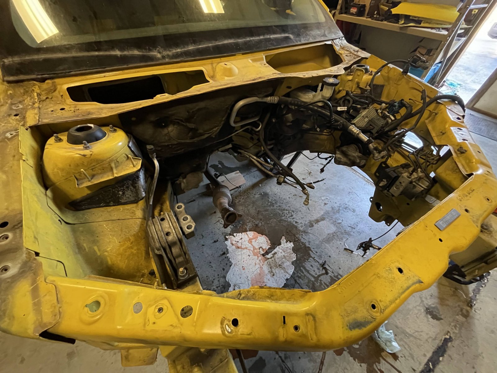

Made it through videos 3 and 4, removing the powertrain. Really wasn't too bad, just time consuming making sure I label everything. Definitely was a little messy but manageable.
Next up is getting the interior stripped and dash out, which I don't think will be too daunting. Thinking ahead, I'm hoping to have the donor completely stripped and the shell out of my shop by the end of the year. Should be doable as long as I can find the time to get out to the shop!

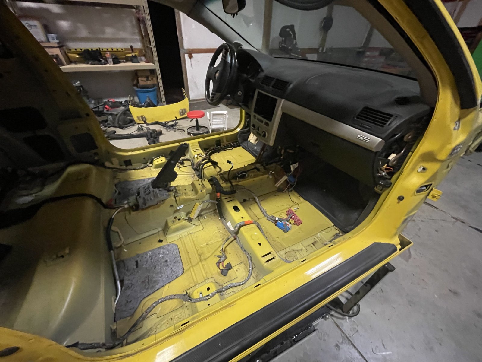

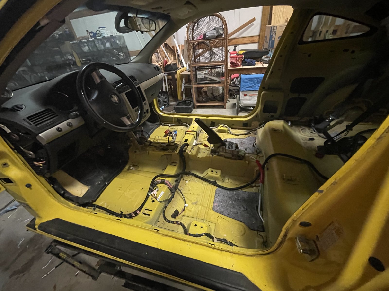

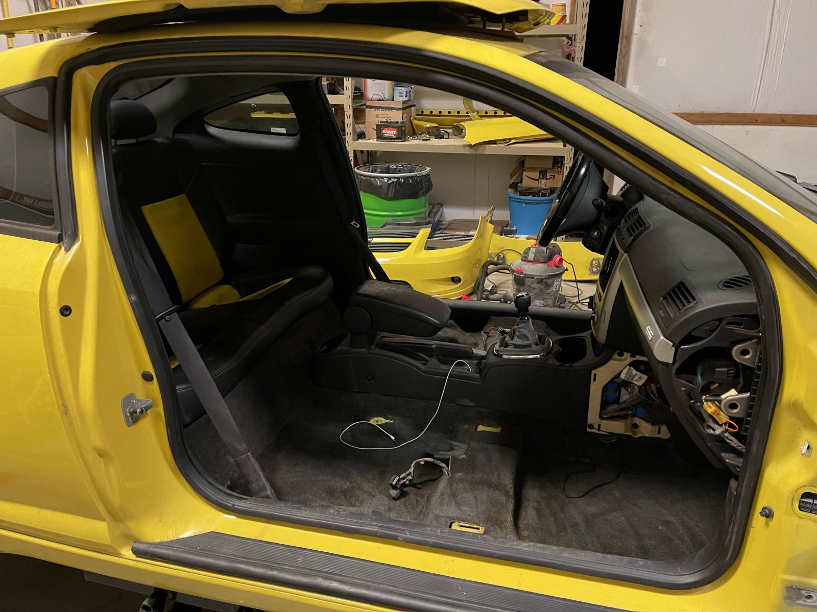

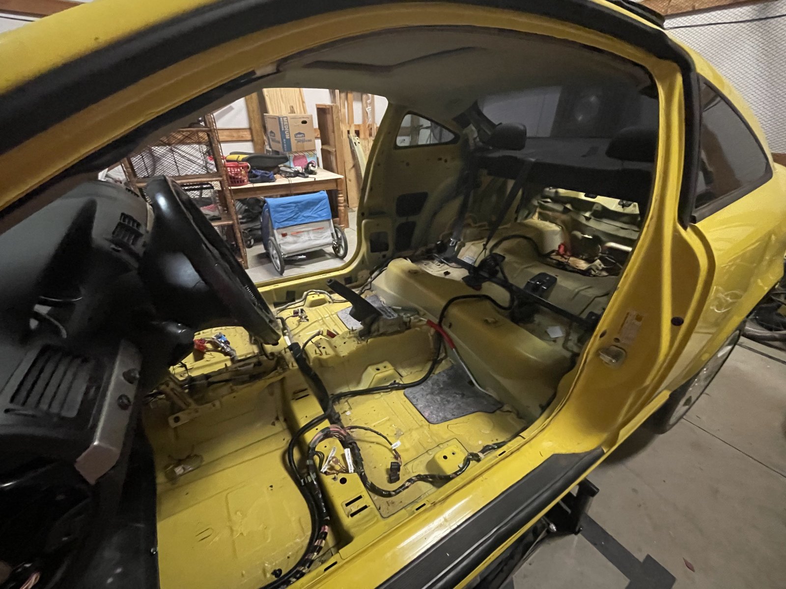

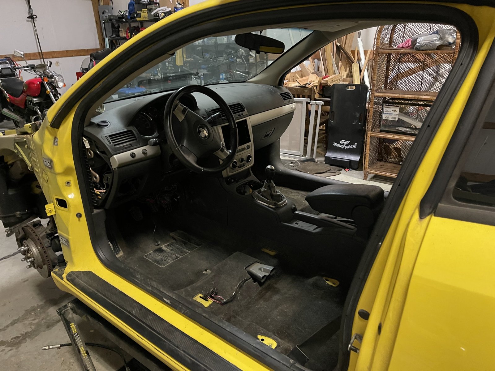

Made it through the first half of video 5, in about a hours worth of work pretty much stripping the interior minus the dash. Only 1 of the seatbelt T50 bolts gave me trouble, otherwise my ICON brand T50 held up great. Also got my first touch of old sticky harness. I'm actually looking forward to reworking the harness, but do dread the stripping and cleanup of old tape/loom. Part of the fun though.
Hoping to get 2 hours in tomorrow and get the dash and harnesses out of the car.

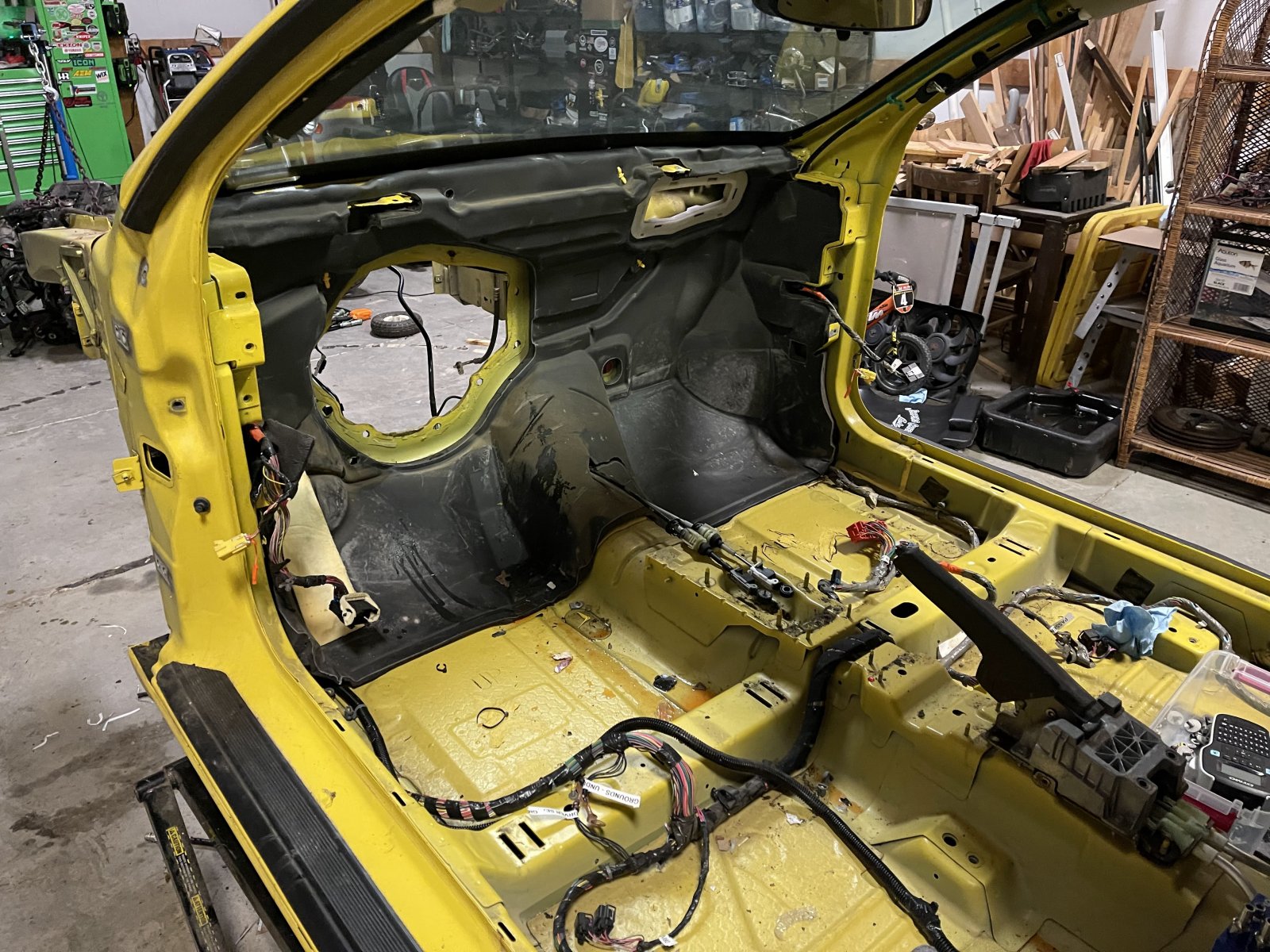

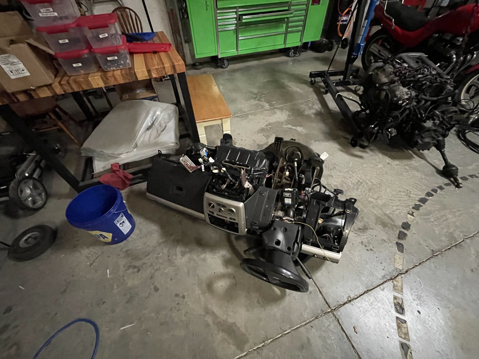

Finished video 5, and got the dash out. Progress has been slow due to life and kids, but I think we all have run into that during a project like this. Not to mention the below freezing temps, but my torpedo heater has been doing a great job keeping the shop comfortable.
Previous Cobalt owner had a Viper alarm/remote start installed, so it took me a good 20 minutes to unwire and remove that. I also didn't have an extra set of hands so I had to get creative to get the dash out, but I did it without damage. With any luck, the donor shell will be out of my shop by the end of the weekend so I can setup spots to tear down the dash and start the wire harness work.

Be careful moving that pig around. I smashed one of my BCM connectors during the dash stage somewhere, so be mindful of the plastic danglers as you move and rotate that thing for disassembly.
devianteng
Yes, I was quite worried about that and ziptied everything I could up out of the way. I sat the dash down as gently as I could inside the car, then rolled it to it's topside and dragged it out that way. Don't care if I tear up the top of the dash, but those multiplugs? Yeah...want to protect those as much as possible!

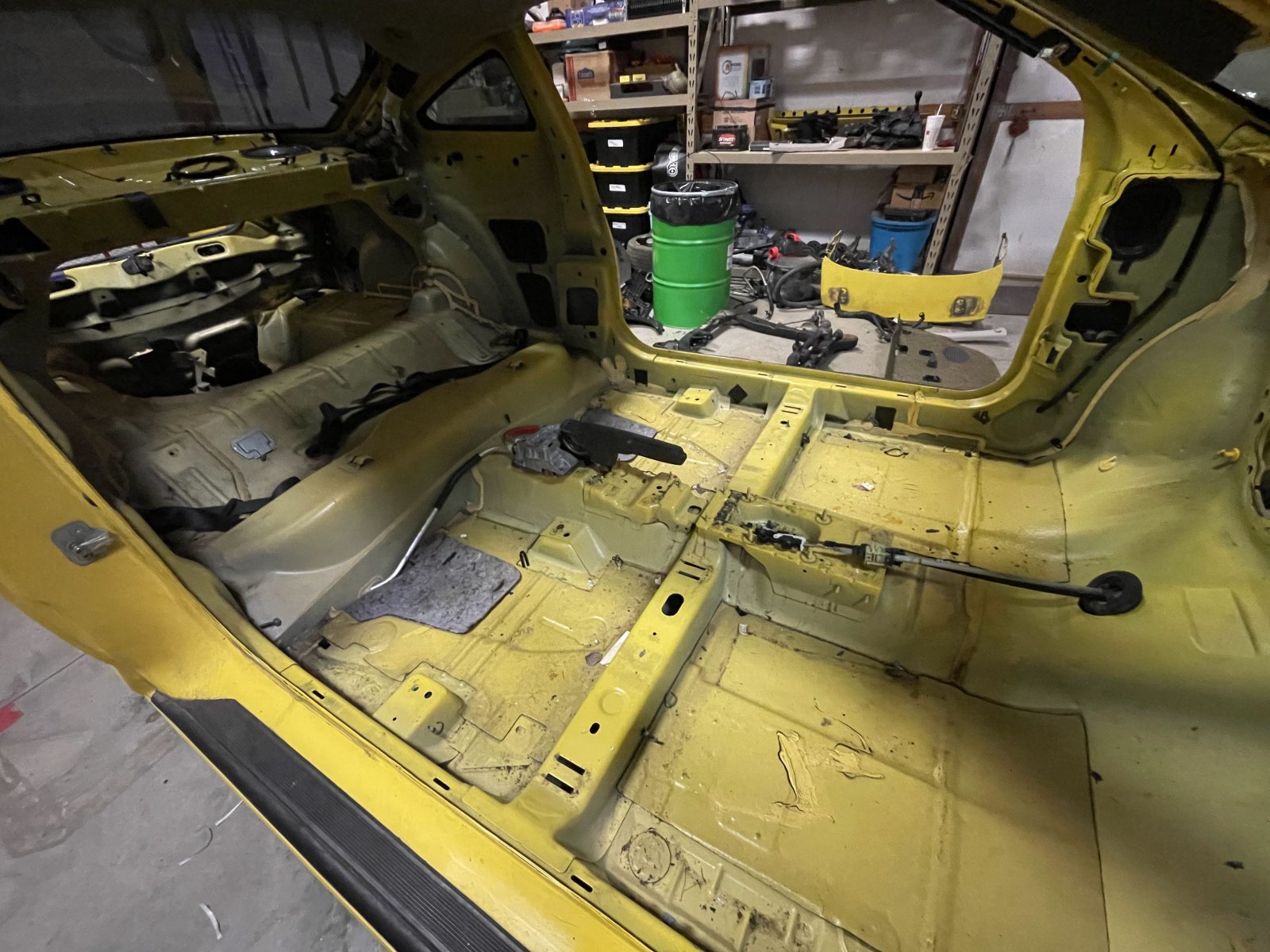

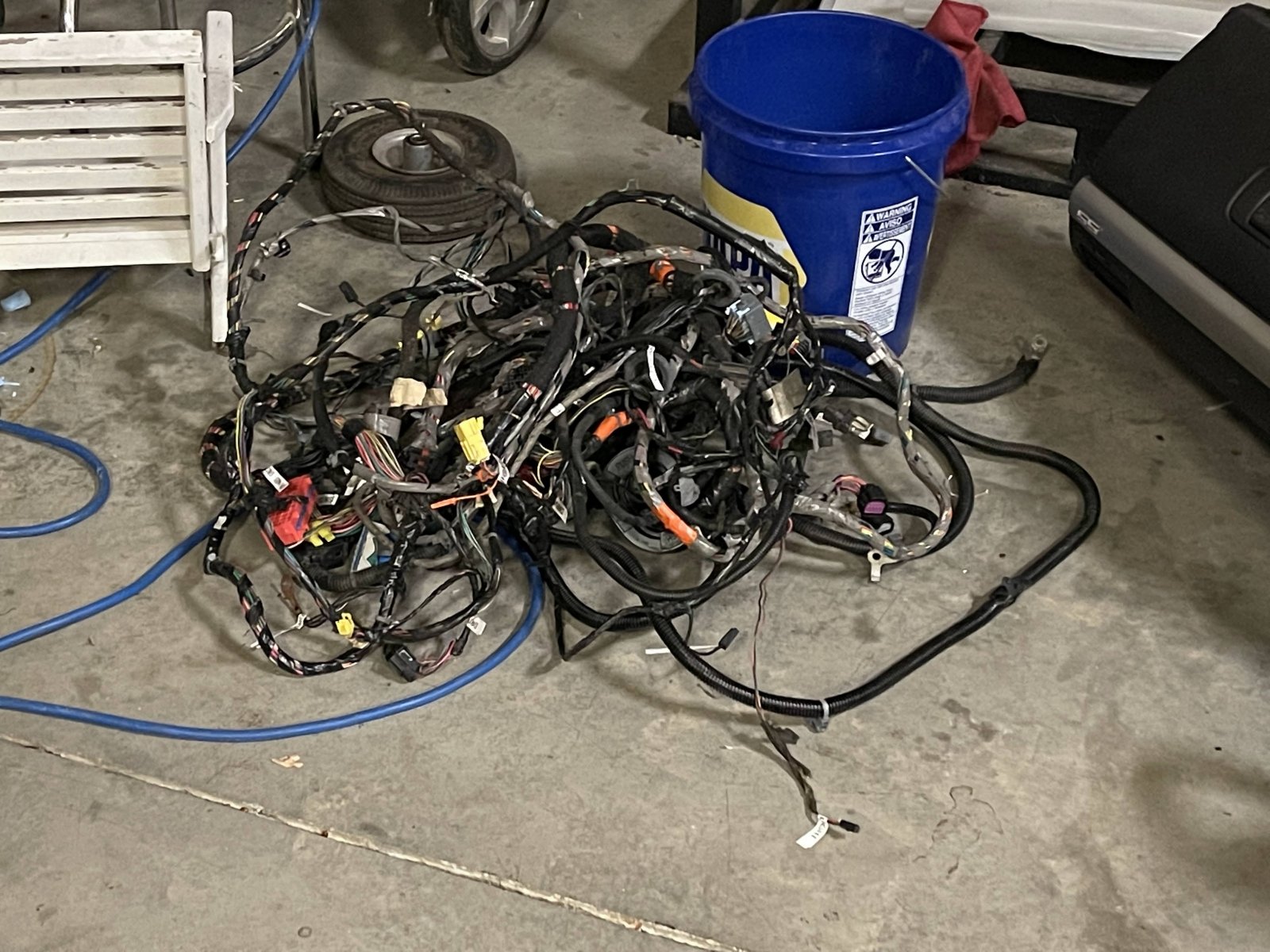

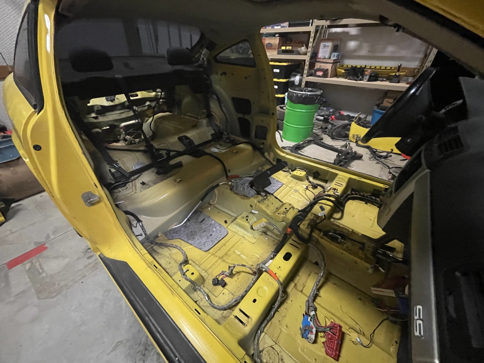

Video 6 complete. Harness has been removed, and all that's left is parking brake, shifter linkage, and fuel pump assembly. Really debating not dealing with dropping the fuel tank and instead buying a new pump and filter. I guess I'd probably still have to get the fuel filler neck out, and not sure about any wire harness down there. I'm sure I'm not the first to avoid dropping the fuel tank so I'll search the forums and see what I can find.
On track to have the donor out of my shop by Saturday, and get to stripping the dash. Might even have the harness all ready to go by end of the year. :D

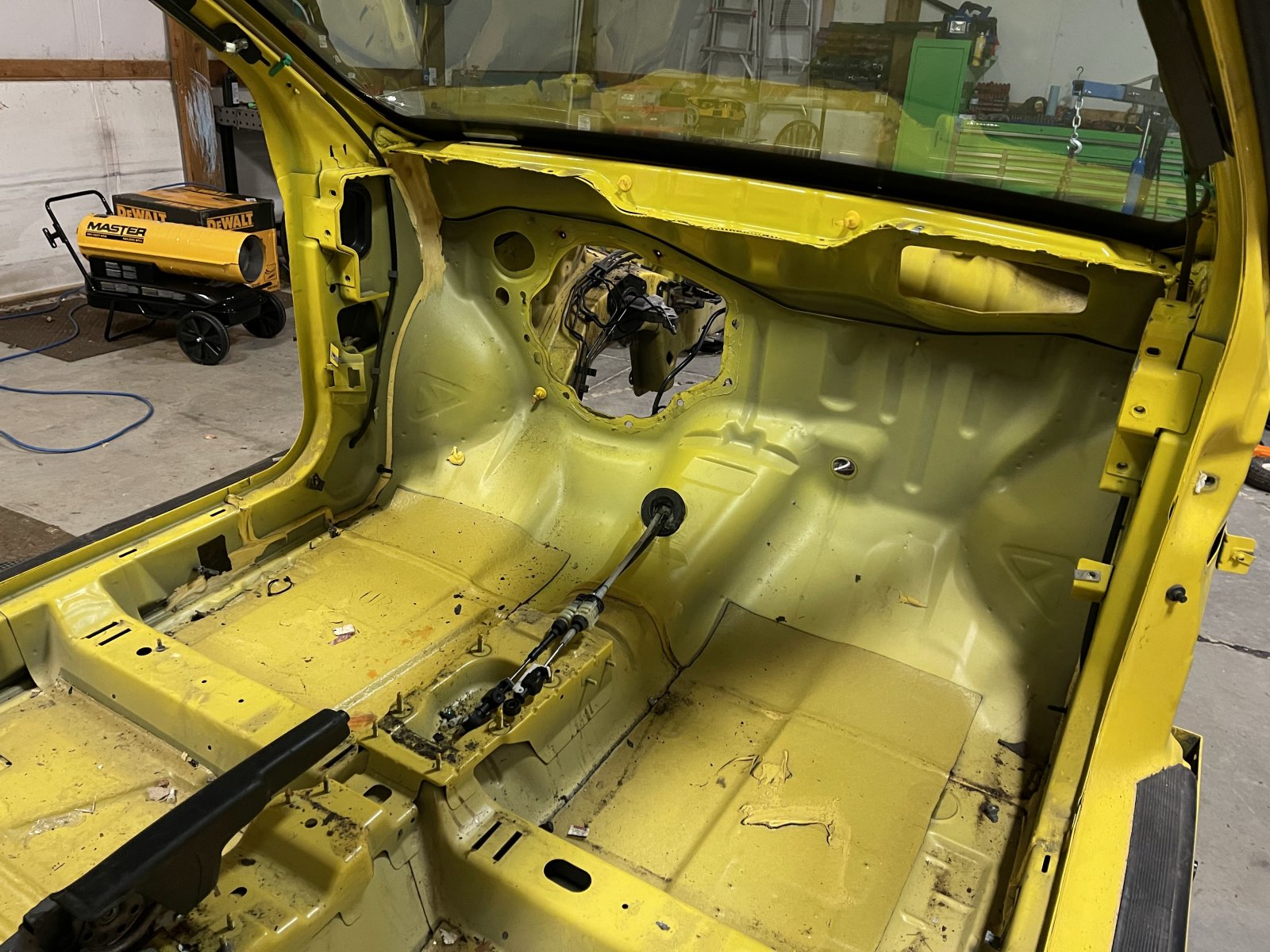

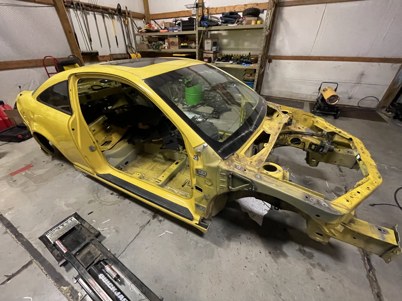

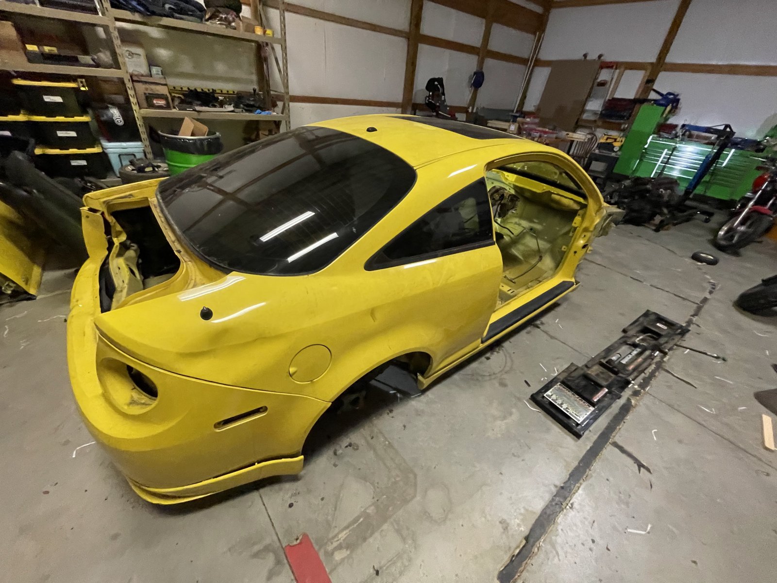

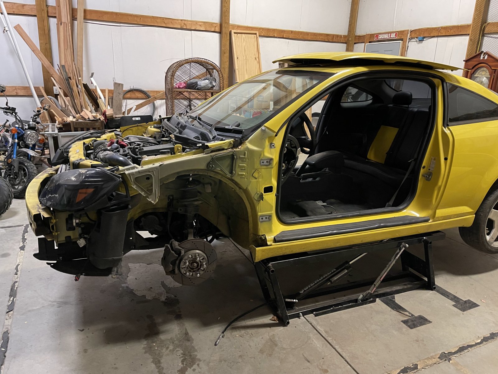

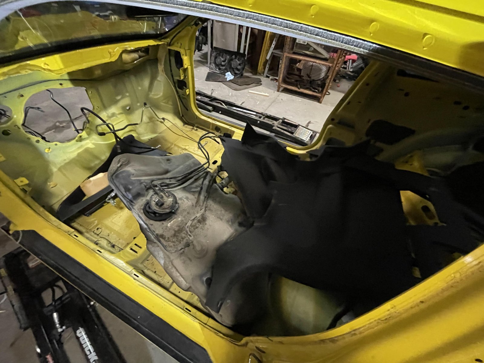

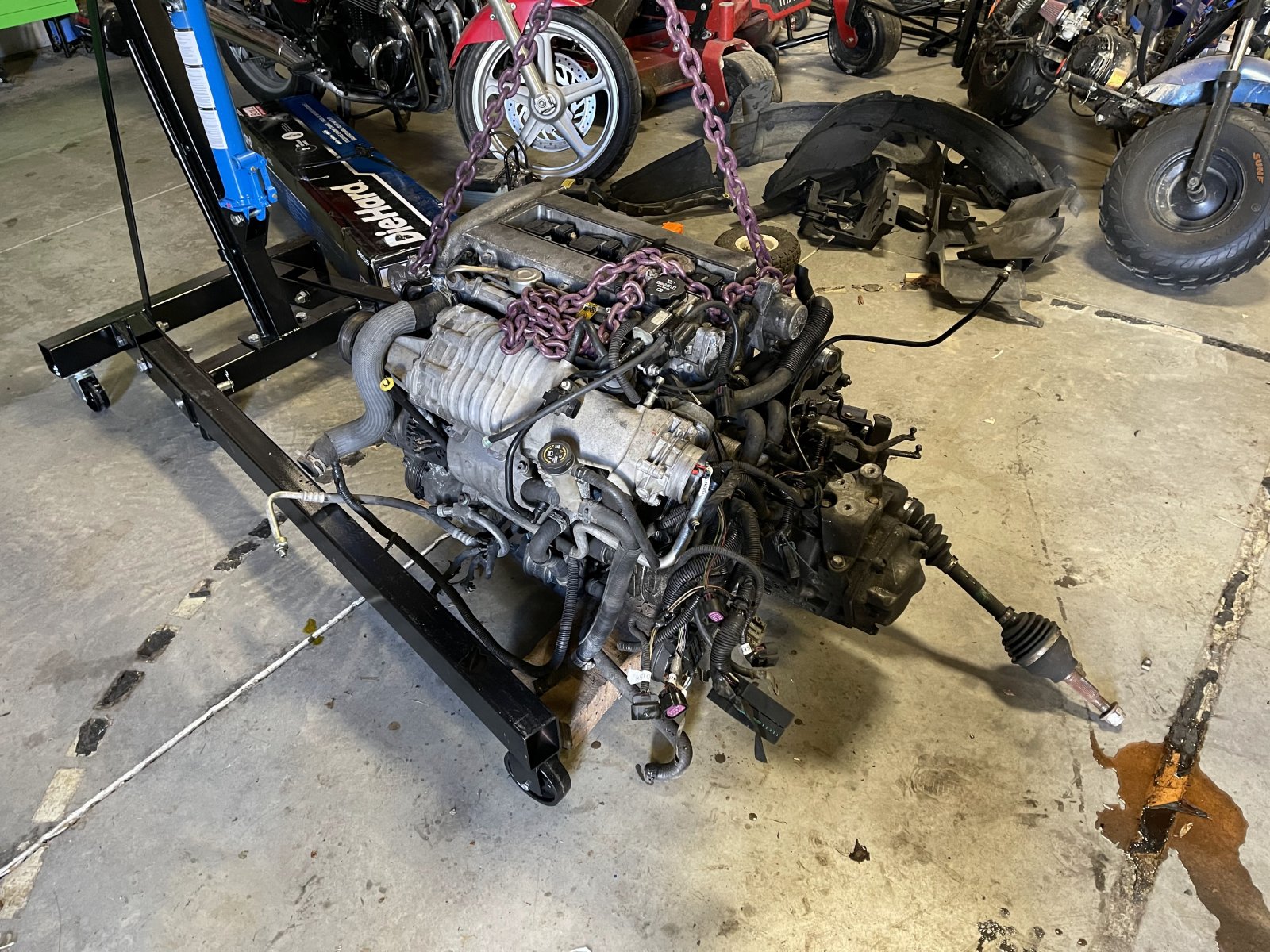

Completed video 8, and got the shell ready to leave the shop. Threw all the things inside the car I don't care about or need, and someone is coming to pick up the shell to get it out of my way. Picked up a sheet of MDF to make a 4x8 table to get ready for wire harness work, but next up will be stripping the dash and taking inventory of all my donor parts (fingers crossed I have everything, or most everything).
Car is off the lift and sitting on a pair of wheel dollies, ready to be pushed to the edge of the shop and winched onto a trailer. Good riddance!
