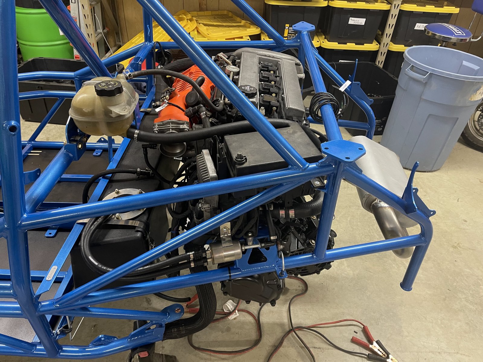

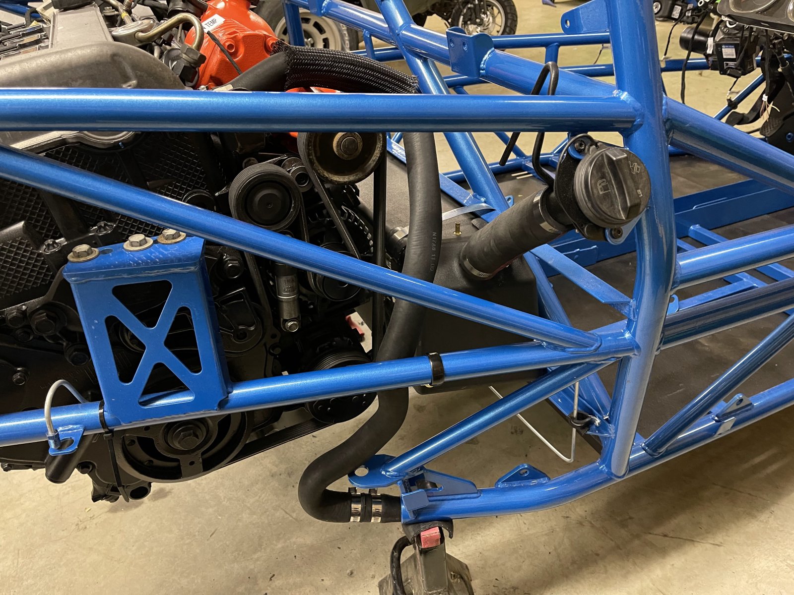

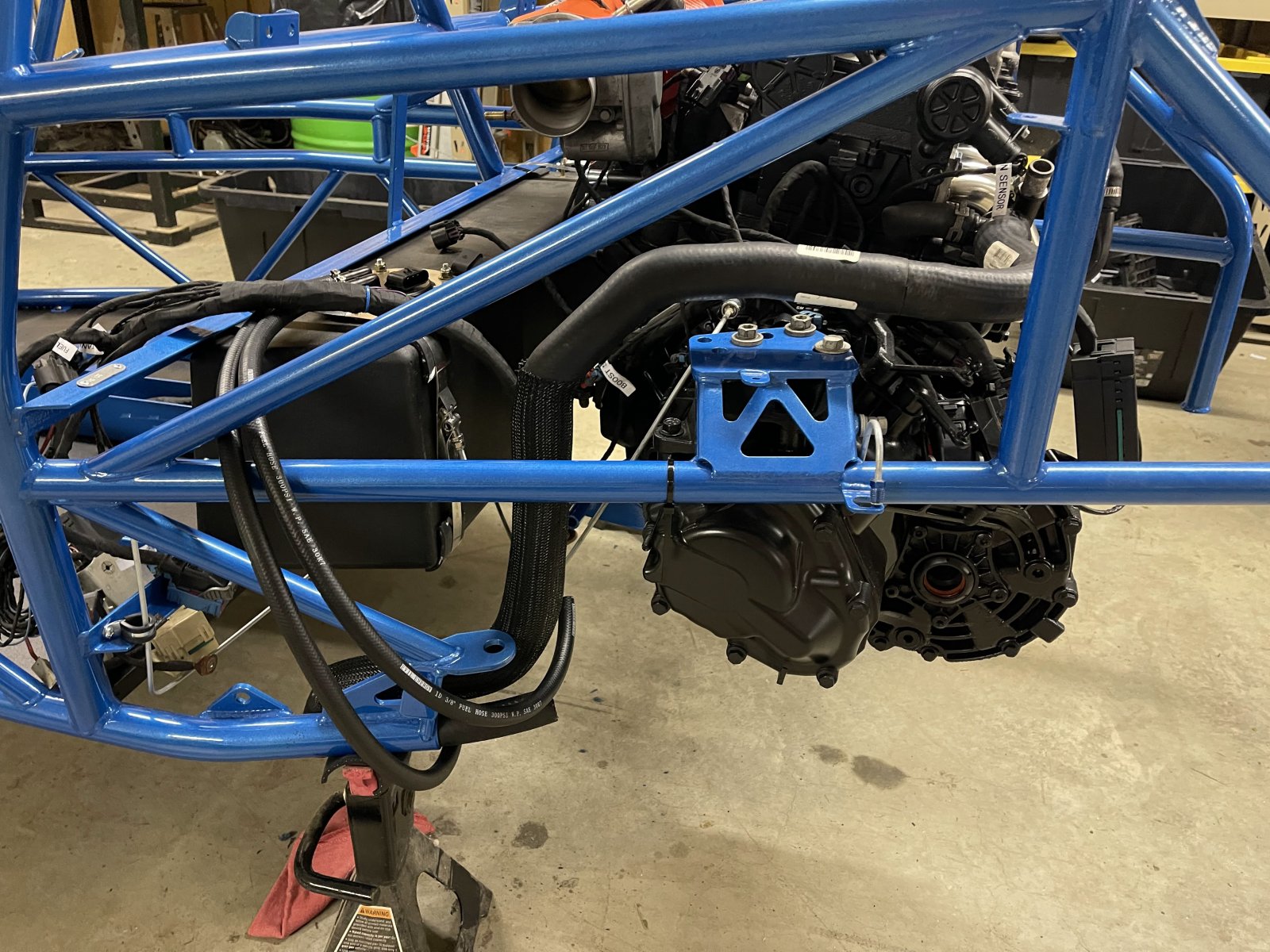

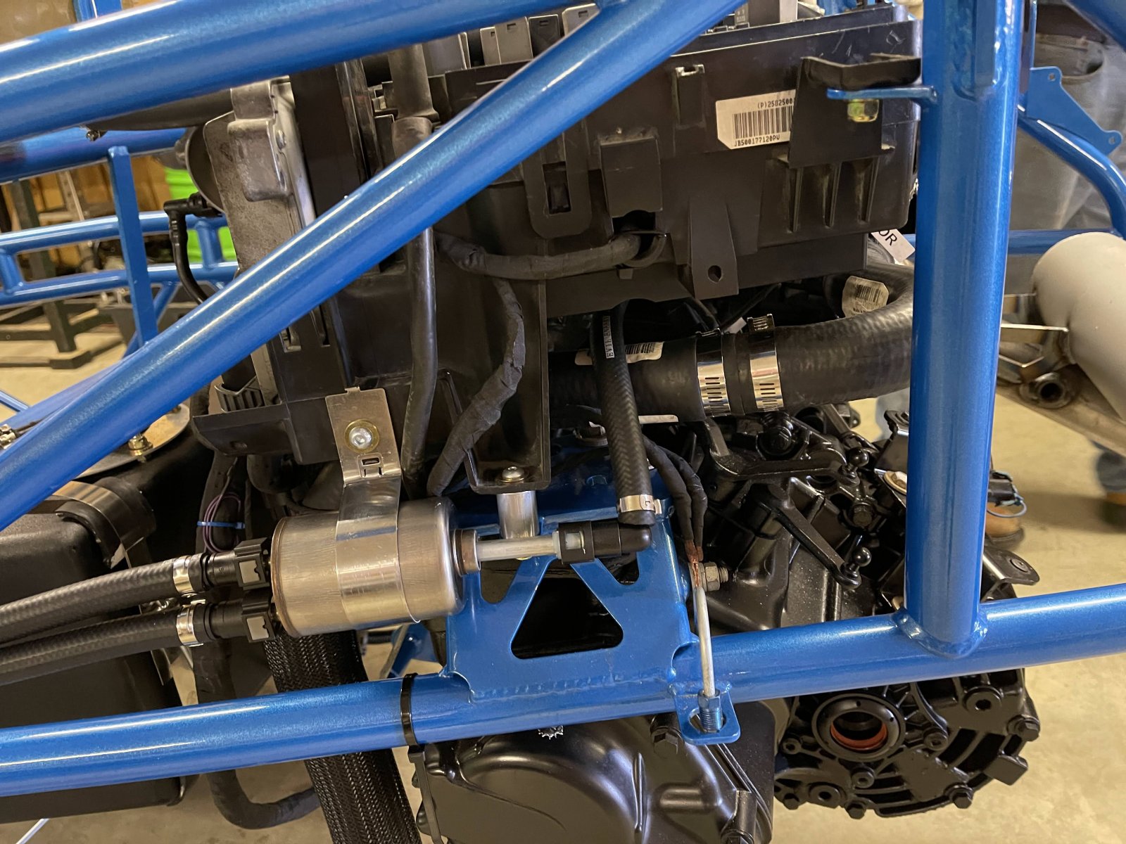

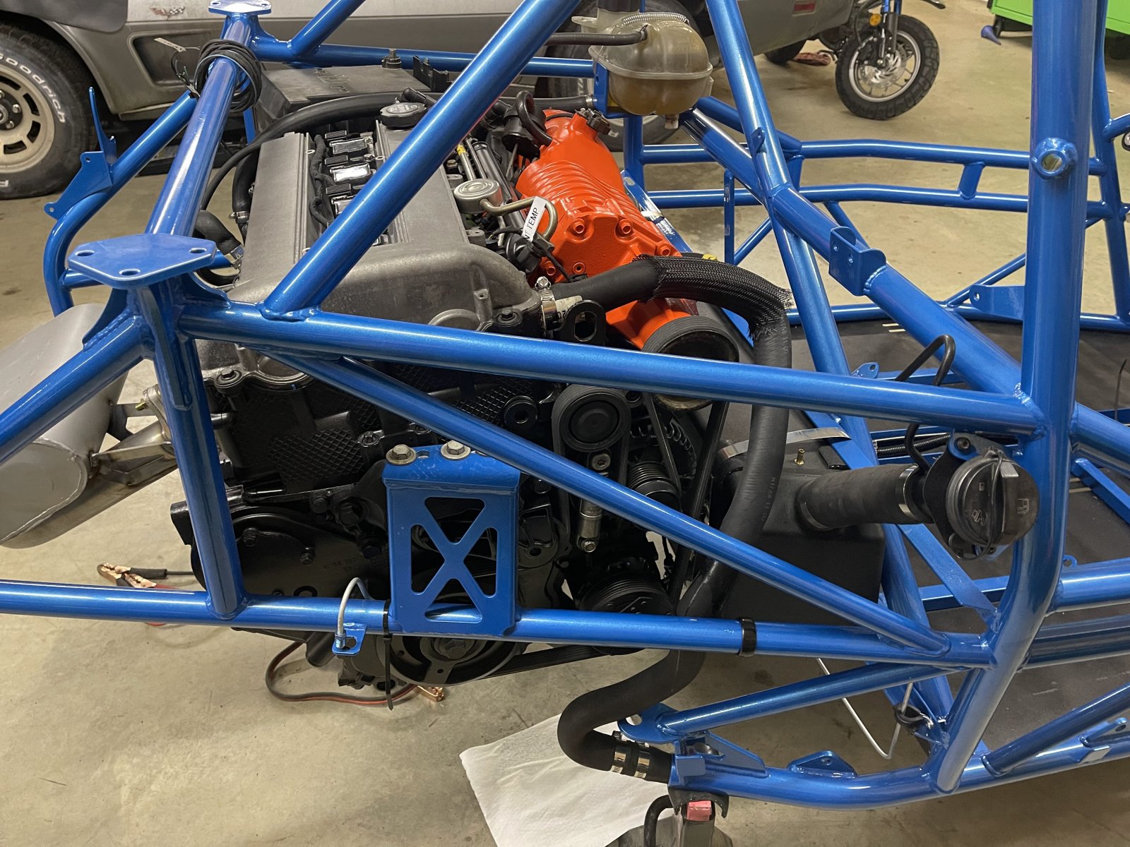

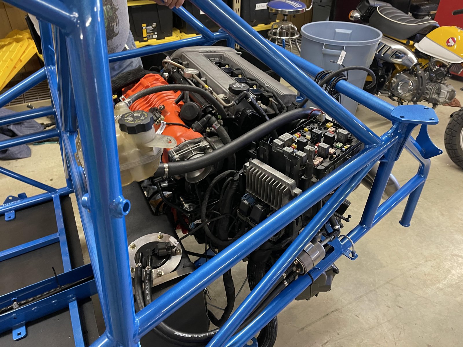

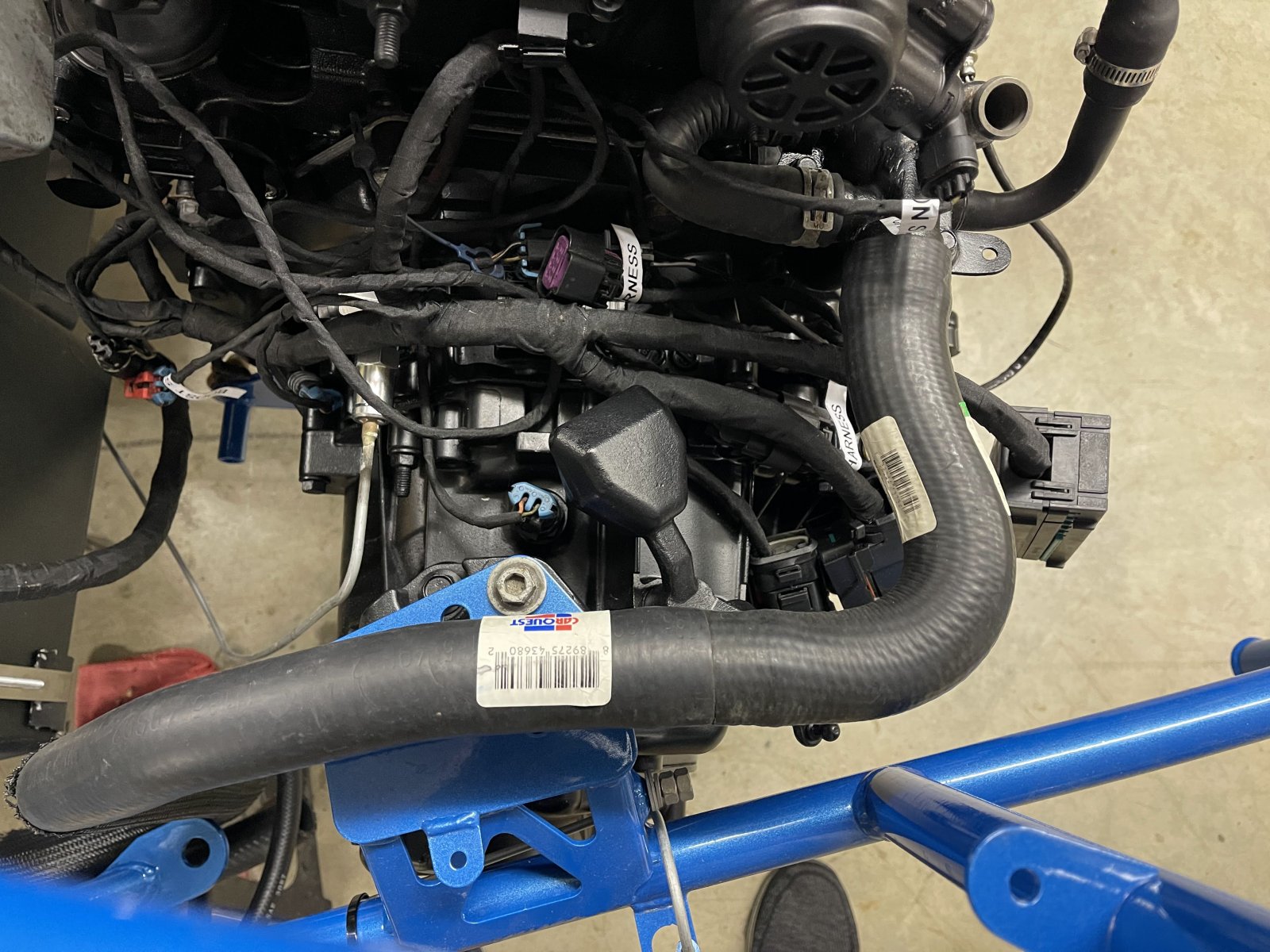

Big progress has been made, and I've successfully cranked over the engine! Fuel system connected (made some fuel lines using 3/8" ID 300 psi rubber fuel line), all coolant plumbing finished up (driver side I ended up using two pipes for a perfect fit; Dayco 70789 and a Dayco E7188 -- passenger side I used the included Dayco 72049) coolant tank mouted. Fuse box mounted and all connected up, battery cables put in. Fresh fluids (Valvoline VR1 20W-50 oil, coolant).
At this point I was ready for my first start and it went something like this:

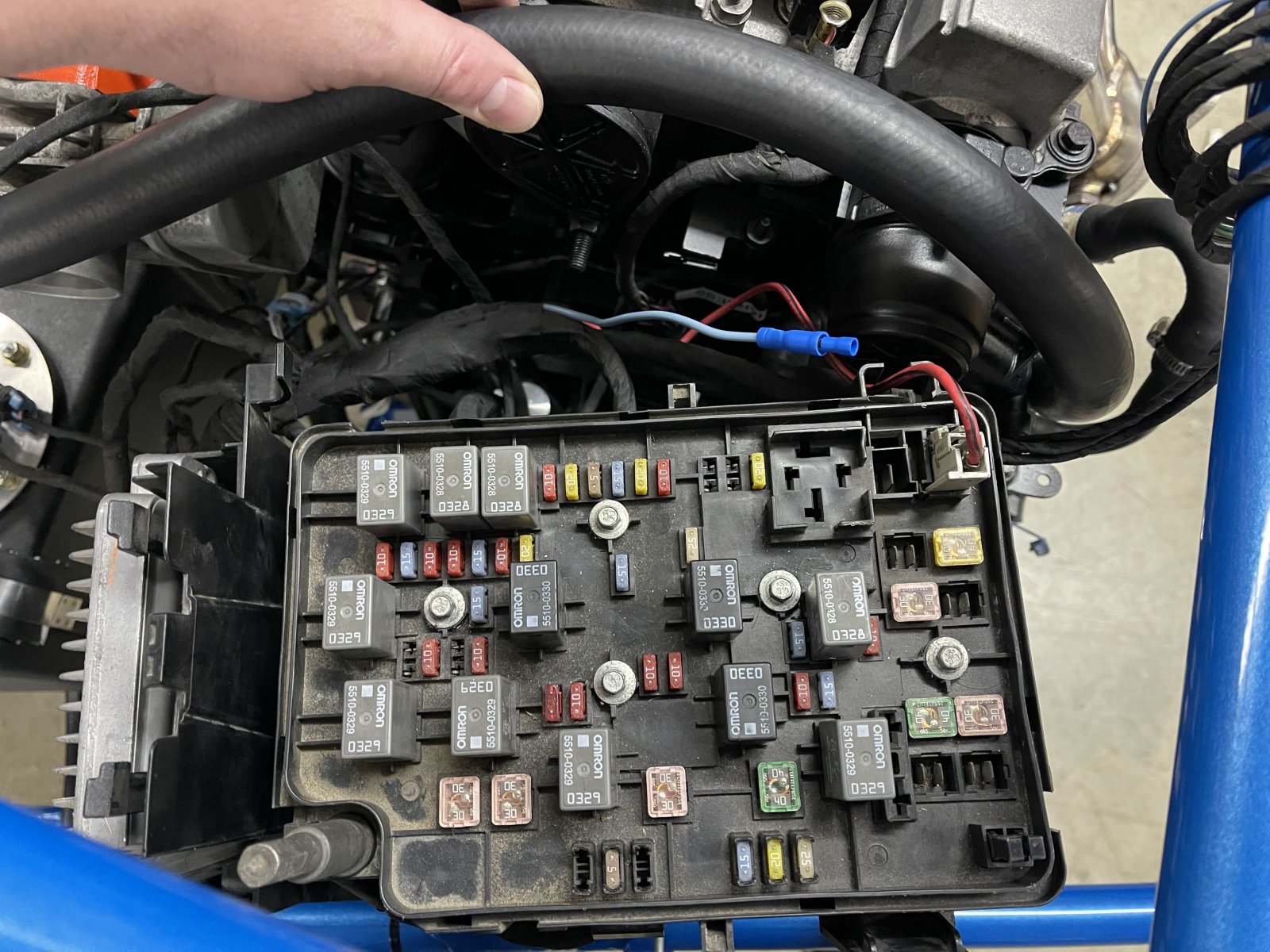

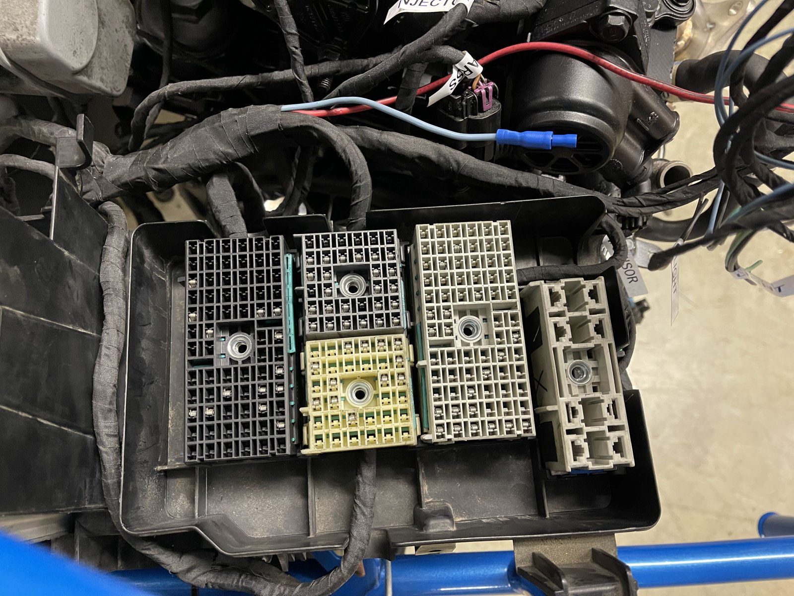

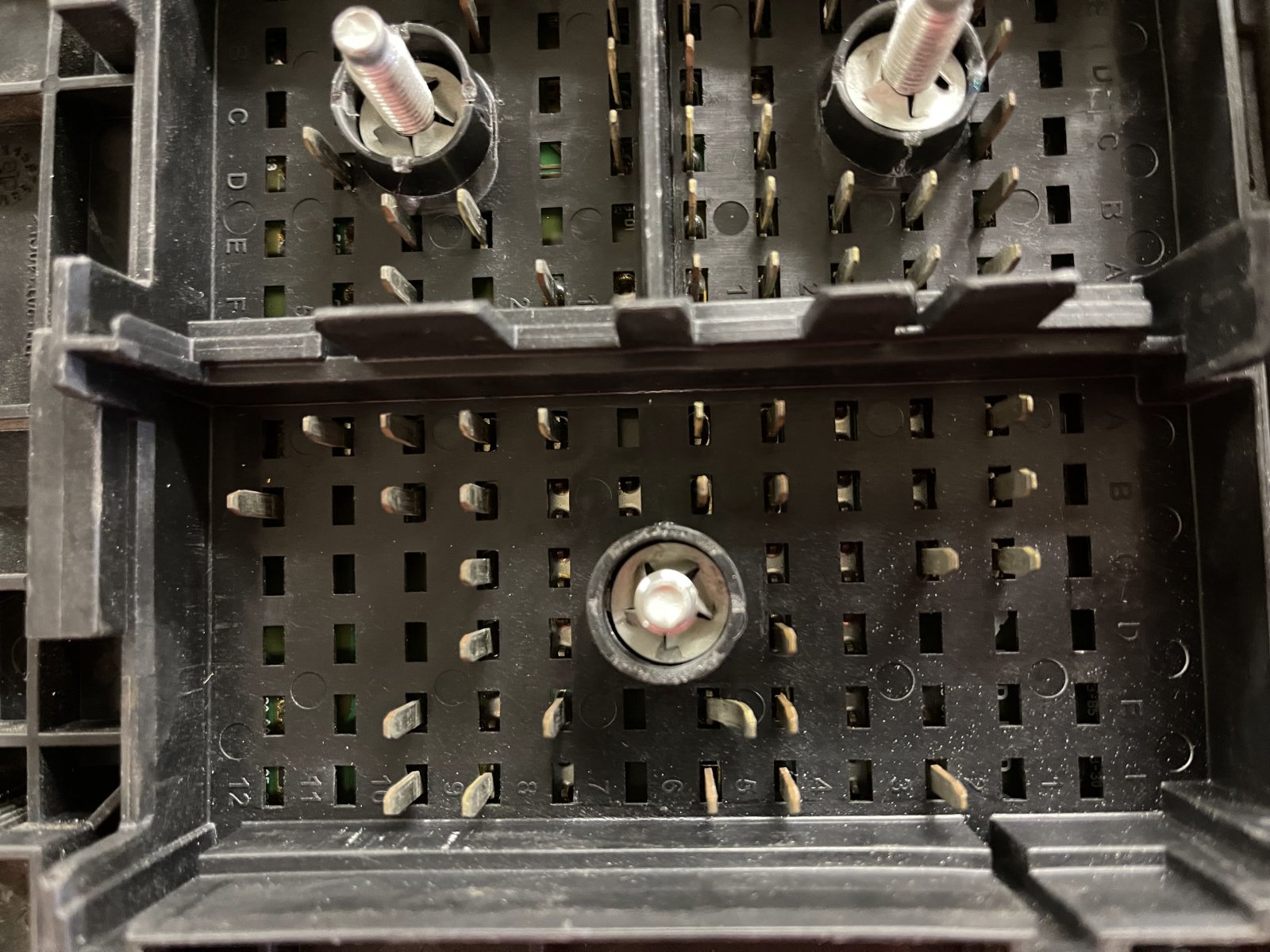

key in, turn key, dash lights up, turn key to crank...nothing. Double checked all my grounds, and a few other things then I found a bent pin on the bottom of my fuse box, and after correcting that was ready to crank again. Crank, started, runs for about a second, then dies. After reading a little, I believe this is because I do not have my MAF sensor connected (my donor's was trashed, and I have a new one on order which should be here later today).
Overall I consider this a win, and fingers crossed connecting a MAF sensor later will let it run and idle as expected.

@Ark :D, @Robinjo, @Joebob, it was definitely an issue of no MAF. Connecting a MAF still had the same issue, but putting the MAF in my donor intake pipe and hooking that to the TB, started right up and idled pretty good. If I disconnect the MAF, it would die. Have to have the MAF connected and in line or it wouldn’t stay running.

That's strange. Absent a MAF, your ECM should default to MAP sensor readings to run. It wouldn't run well, but it should have still run.
So that’s what I though, but not what I encountered. HOWEVER…I suspect my MAP sensor may be dying/dead since it’s throwing a p0107 code. Haven’t had the chance to really look into it, but I’m happy enough that I’m able to start it now. Need to get the laptop out with HPT and do some logging and look over things.
devianteng
Building off my last post, I've been spending some time on this P0107 DTC. Confirmed with HPT logging that I get no MAP reading, though I get an IAT2 reading -- this would likely explain why my car won't run at all without the MAF connected. I started another tread specifically for the P0107 here.

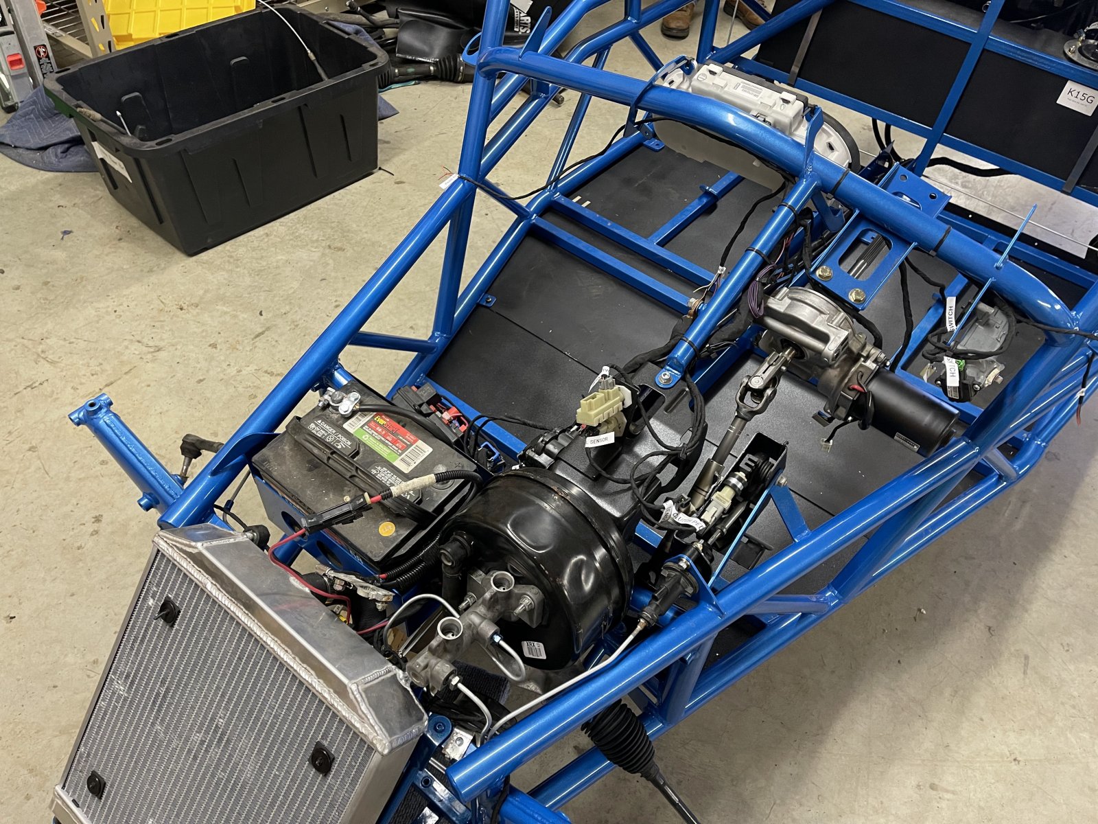

* Replace brake booster -- confirmed mine leaks; always suspected it needed to be replaced since it looks beat up
