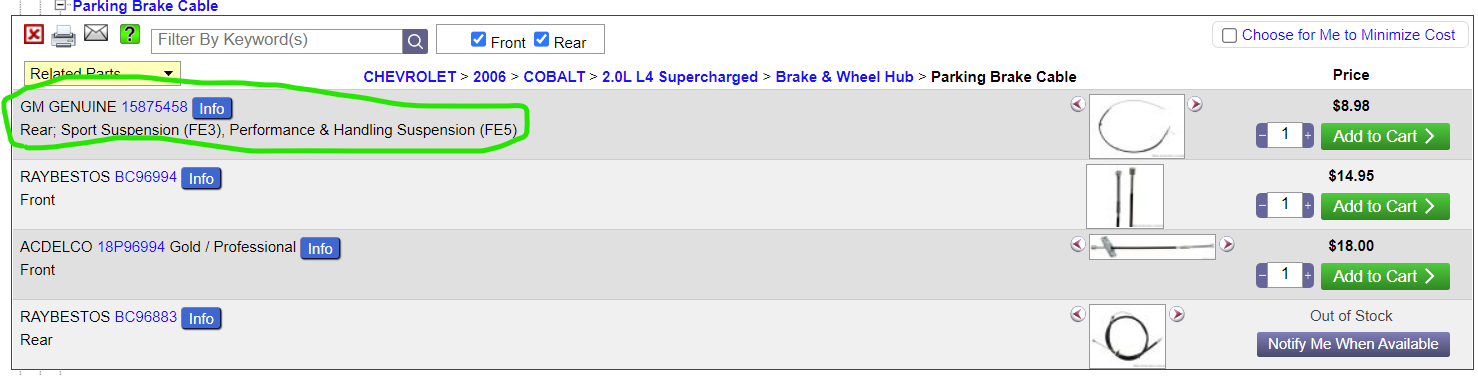

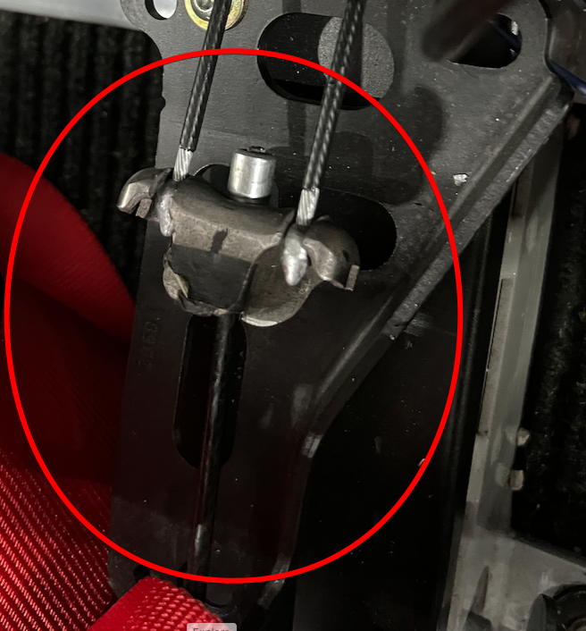

That cable should be connected to the handle directly. You don't need the longer cables that connect to the actual brakes as DF supplies new cables.
My kit didn't come with the parking brake cables. I bought replacements for the stock SS cables. Mine were rusty and one was seized.
Blue Man
They have that link to purchase the SS cables in the parts list. Is that link accurate? I followed it and it listed cable I’m assuming it’s the correct one. And then I would just buy two, right?
I purchased that number and it works. Now, how you route it in the kit car is very much open to interpretation. My part number listed in the picture is for a 2006 SS/SC. I don't know if the later models still used the same number. It was very easy to install after the car was running and driving, maybe 30-45 minutes of work. But I already had my handle mounted onto the tunnel cover.
You are correct, 2 cables are needed.
jennam
Sorry. I think you’re right that the cables don’t come in the kit. Now that I think about it, I ordered some from rock auto and I just had them would up in the box with the rest of the parking brake kit.
Apologies for the misdirection.
