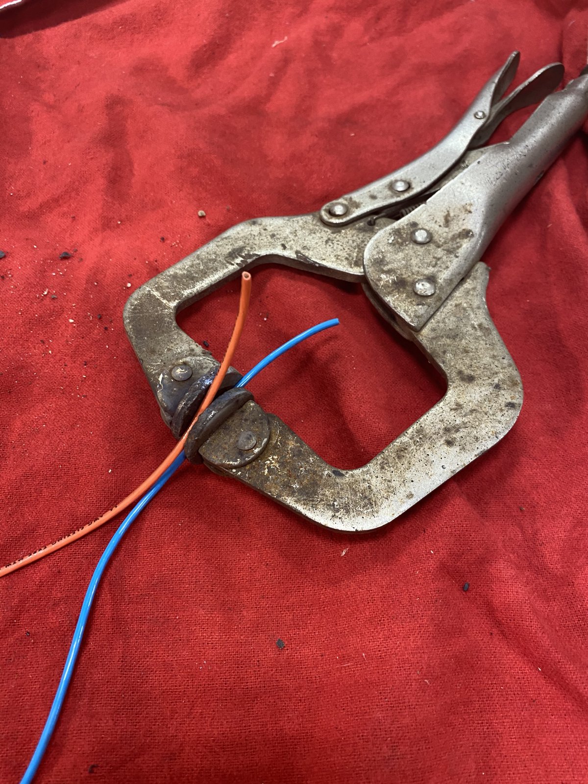

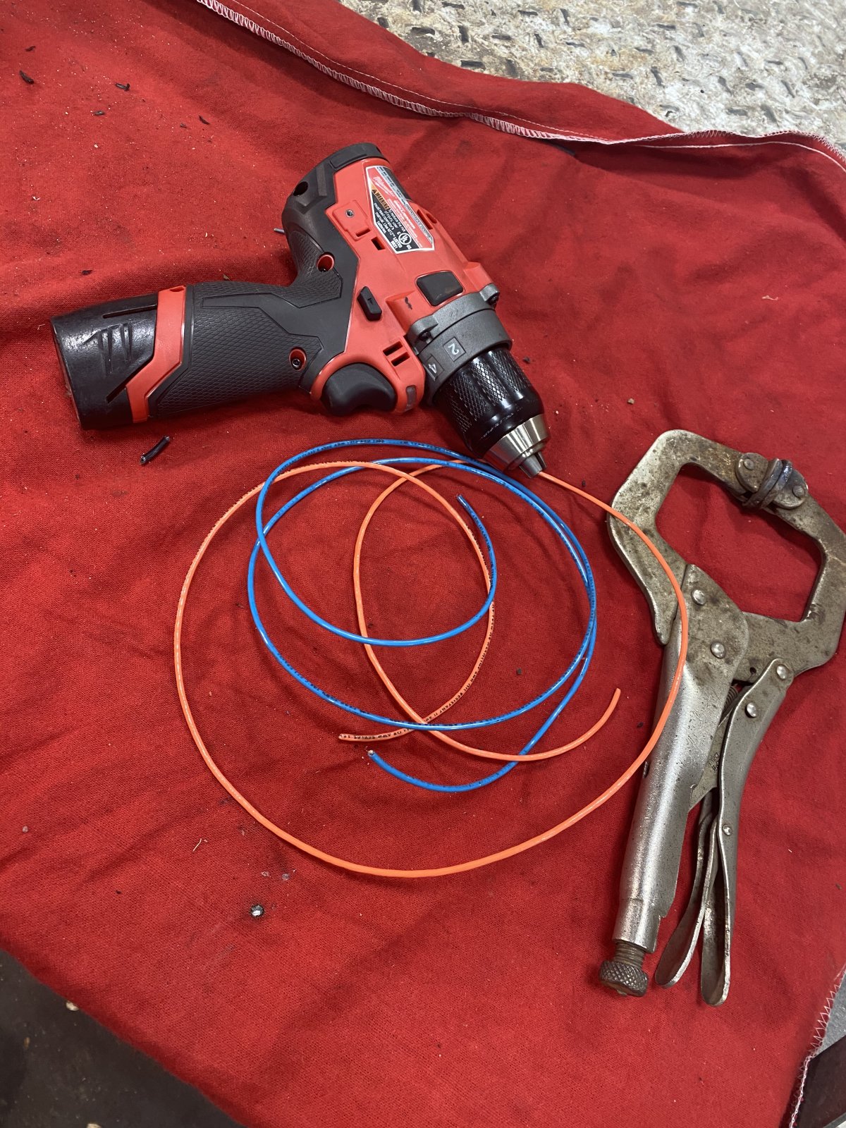

Get your wires together in a bundle

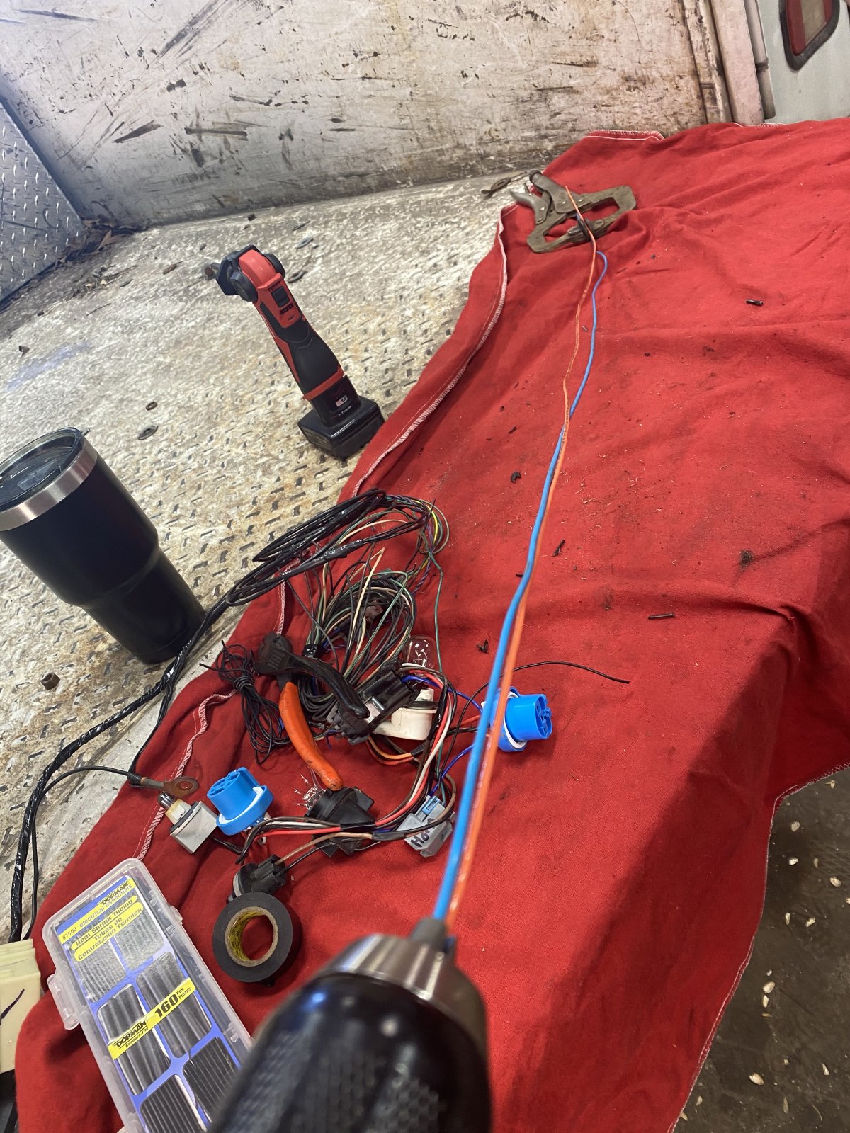

Clamp one end of the wires down (I used some of my locking pliers for the demo, but prefer using a vice)

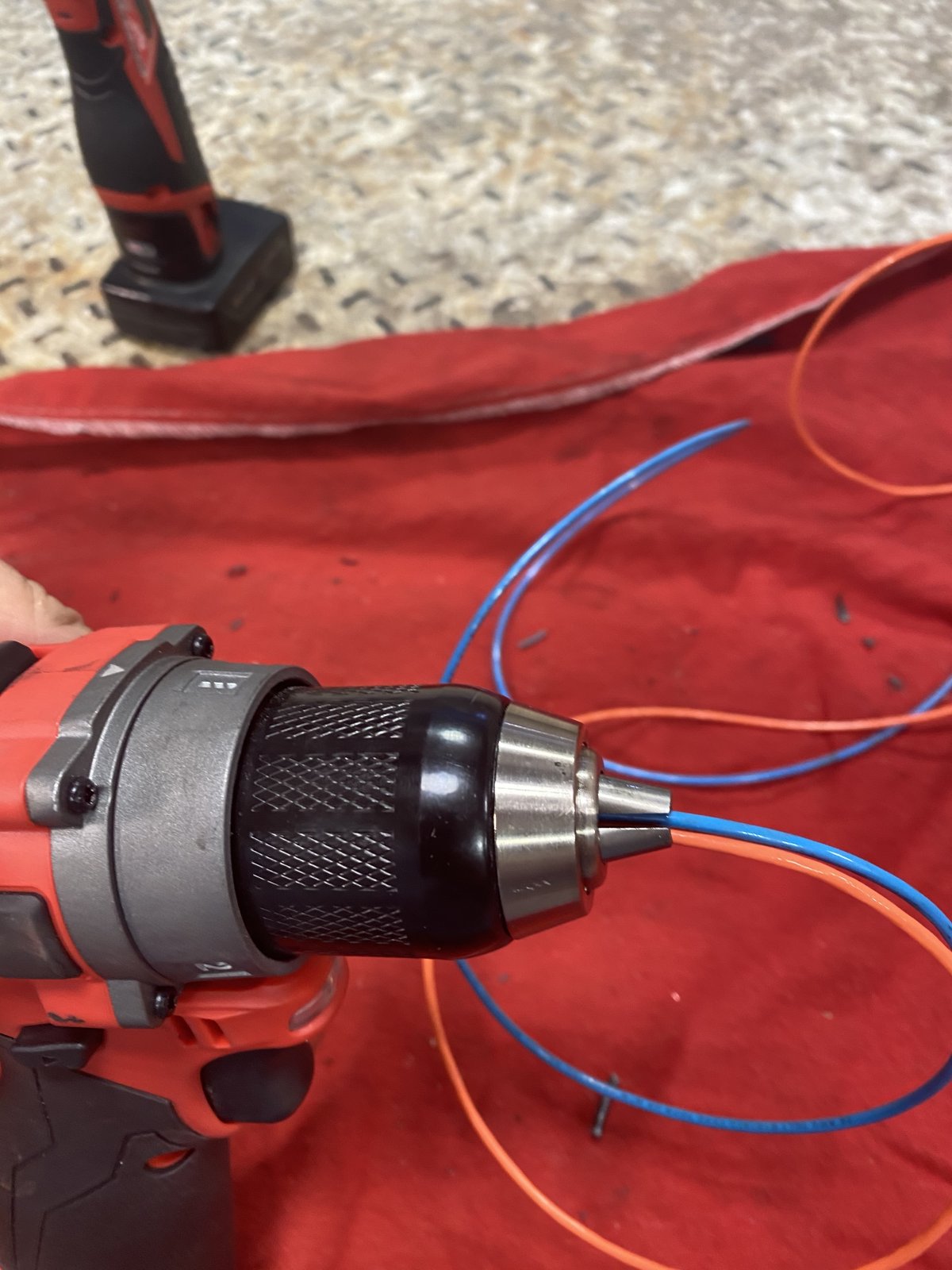

Put the other end in a drill

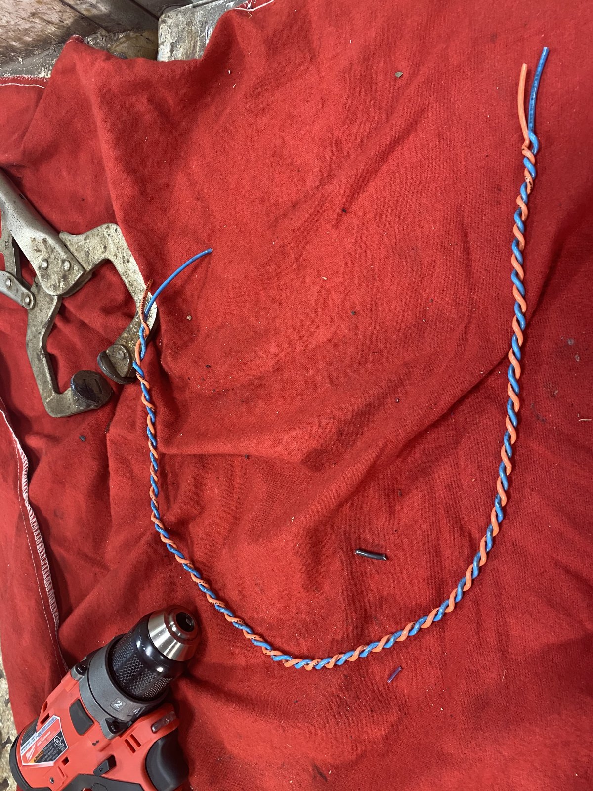

And hit the trigger.
You can make them as loose or tight as you want. Badda bing, Badda boom. Now you are a cool kid.
