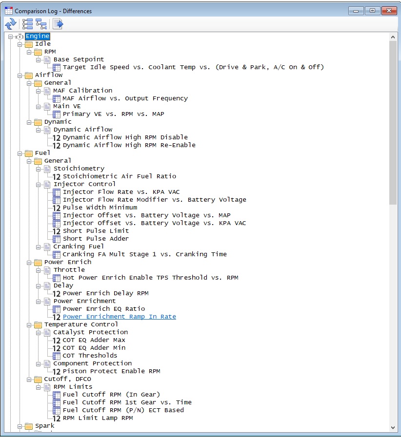

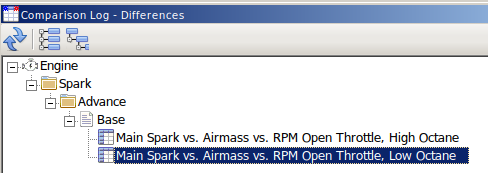

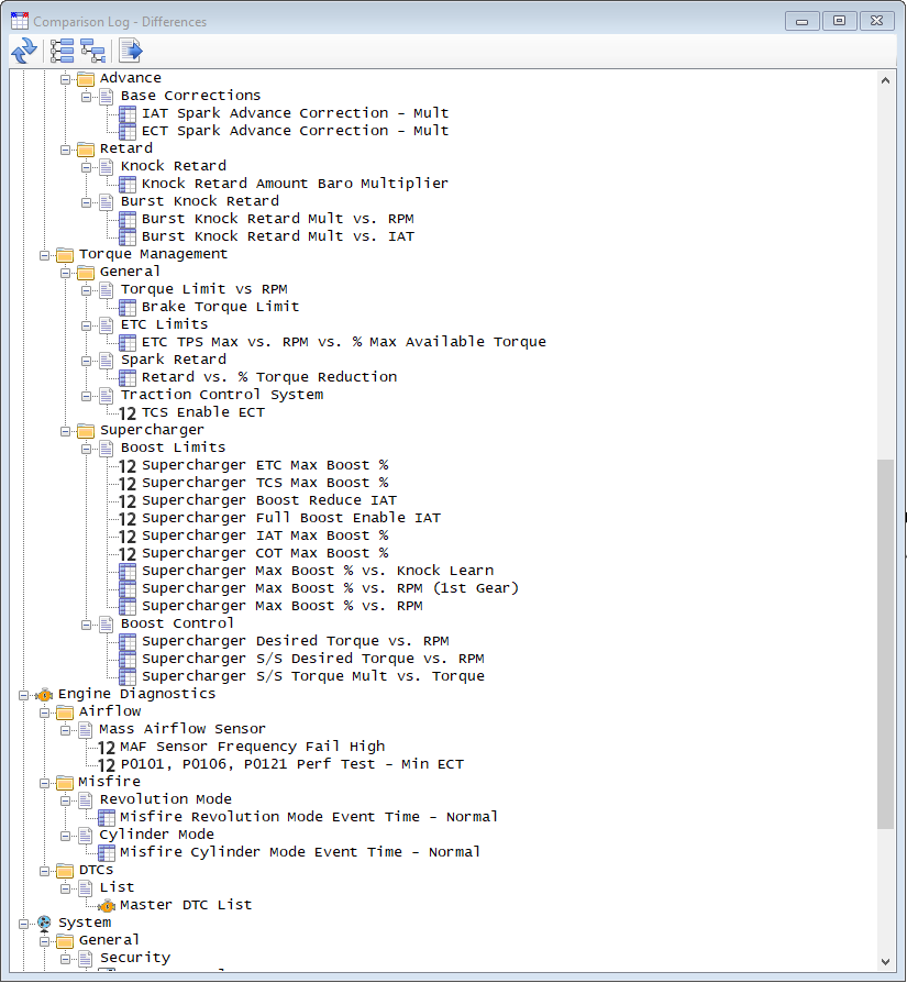

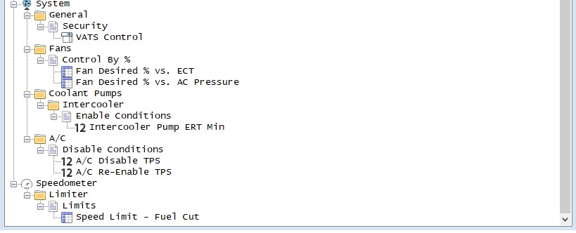

Also, when @Gtstorey says "compare", he probably means the actual compare feature in VCM Editor. You open the tune file you want then click Compare -> Open Compare file.
34512
Then you can go to the same menu and "View Comparison Log" to see a list of all the differences.
34513
34514
Helped me a lot in understanding what ZZP is changing between tunes on mine.

Next step will be to compare actual values for those differences. It looks like it could be set up to run speed density based upon some of things listed as changed as related to the MAF.

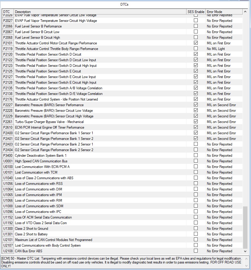

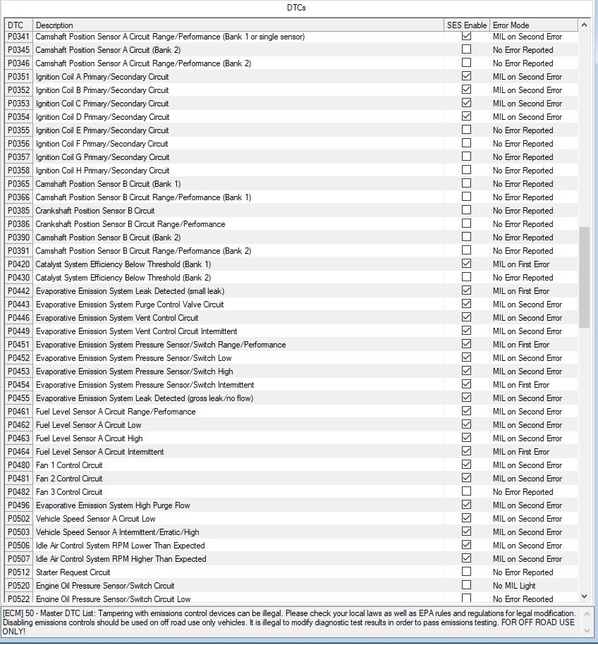

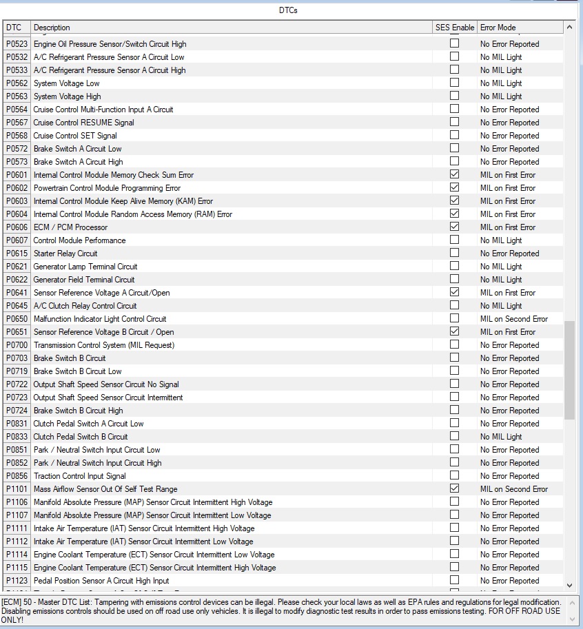

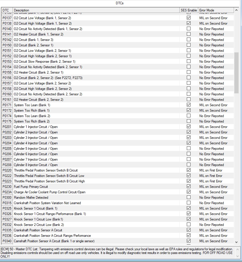

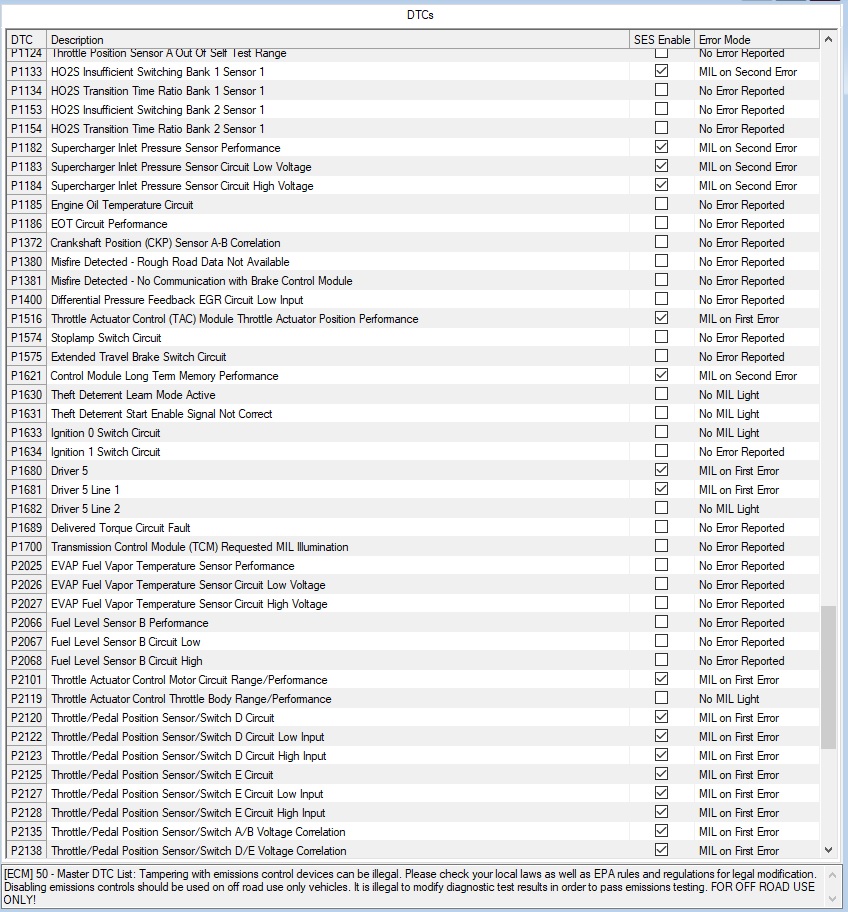

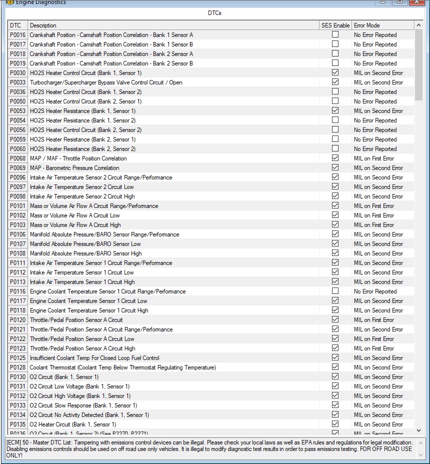

I would check to see what dtc are set to not record and which ones are set to no ses(service engine soon) if that is an option.

that is a lot of things turned off that I don’t understand why, but I have only messed with the LNF. There are a lot of codes turned off that don’t apply to an ecotec such as the bank 2 stuff and other things that have probably been deleted such as the second o2 and evap. Unless someone that knows the lsj says otherwise I would set all of the DTC settings to match the stock tune (other than the obvious ones that need to be off) and see what shows up. Depending on your modifications I might set everything back to stock and start over.

I wouldn’t think that would be enough to make major changes to the dtc list. Maybe some of the maf/map related DTC might be a problem but I would match stock on the remaining.

You may figure out what is going on by turning back on the DTC and getting an error.

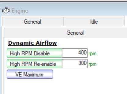

I don't know much about tuning the LSJ but the only thing that stands out to me is the fact that Dynamic Airflow is disabled. This maybe normal with tuned LSJs.
