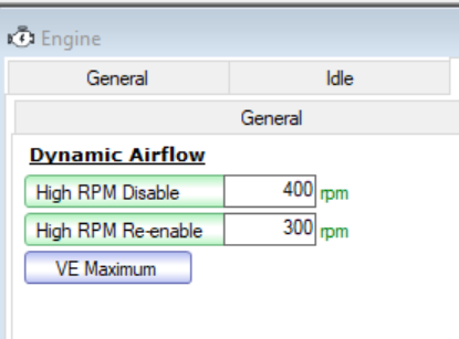

Maybe I don't know the layout quiet yet but I don't show that option, this is all I have under Engine>Airflow>General

I don't know much about tuning the LSJ but the only thing that stands out to me is the fact that Dynamic Airflow is disabled. This maybe normal with tuned LSJs.
For what it's worth, mine is set to 4000 RPM disabled, and 3900 re-enable. For the most part, you want the MAF to do the work at higher RPM. Below that, the MAP sensor takes over with the VE table, which works better for transient conditions.
I'm not sure if my numbers are "right". My tune was based off a ZZP tune, so that's what they decided was right.

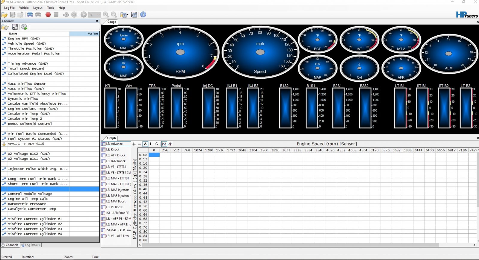

I got the new layout and channels loaded from a post I found on the HP tuners site, specific to the LSJ. Will run a test run in the AM to see how it goes. Here is a screenshot.

Something is causing it to run part of the time in open loop-fault mode. From what I can tell from researching, that is usually a problem with the o2 sensors but It's not something I know anything about. Your misfires on cylinders 1 & 4 go up when that happens.
I agree that you likely need to reset as close to stock as possible. Take your file and change everything but the fuel injector data back to stock. It should be able to run with the different pully that way. You need to stay out of WOT until this is figured out anyway. And until you get a wideband.
I guess it's normal for the LSJ to show an accelerator pedal position of way over 100%?
If this was an LNF, I would say that your MAF needs more adjustment based upon your STFT but the LSJ may be different.
