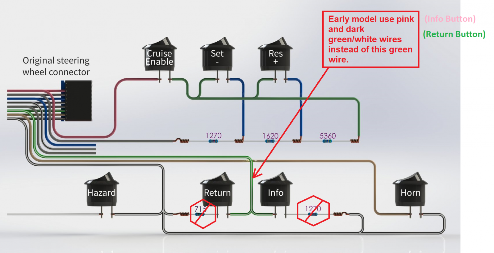

Does anyone have an updated wiring schematic for the button panels, mine just came in today. The one I see floating around doesn’t have the same color wiring. I have the 7 main wires hooked up but the ones for the buttons themselves are different.
Lonny explains the difference between the early model and late model button panels here.
Early model wiring sheet
AllDataDIY wiring diagram for the cruise controls is here. The parallel resistors used by Chevy (8250, 4420, 1500) are the same total resistance as DF's series resistors (1270, 1620, 5360) . I used this calculator to verify this. Up to you which diagram you want to use.
This post talks about where the wires come from.
Horn wiring diagram.
Mounting pictures. More mounting pics.
Early model button panel has these 2 resistors removed. Late model button panel keeps those 2 resistors.

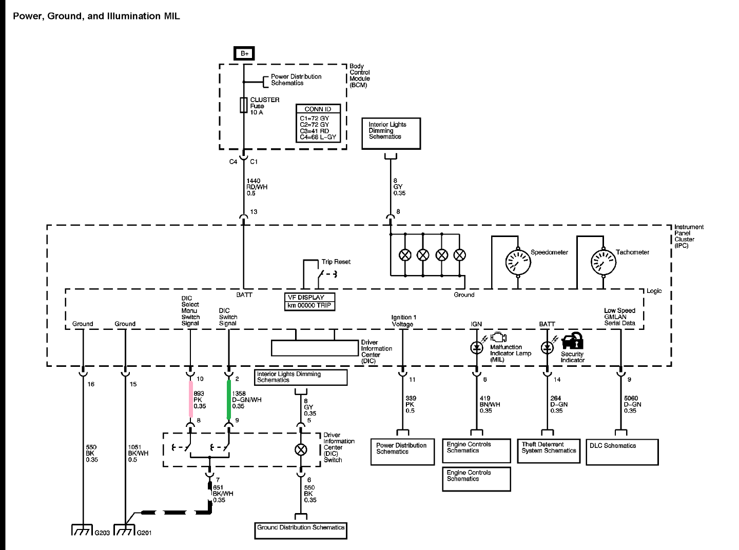

Early model Info/Return (DIC Select menu switch signal/DIC switch signal) from AllDataDIY
34790
You need to find the info return buttons on your wiring harness.
