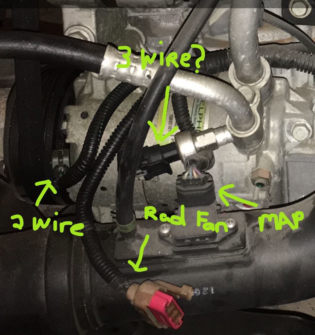

Think I found it from this picture........gray with blue seal and the one I labeled AC look to both be AC related.

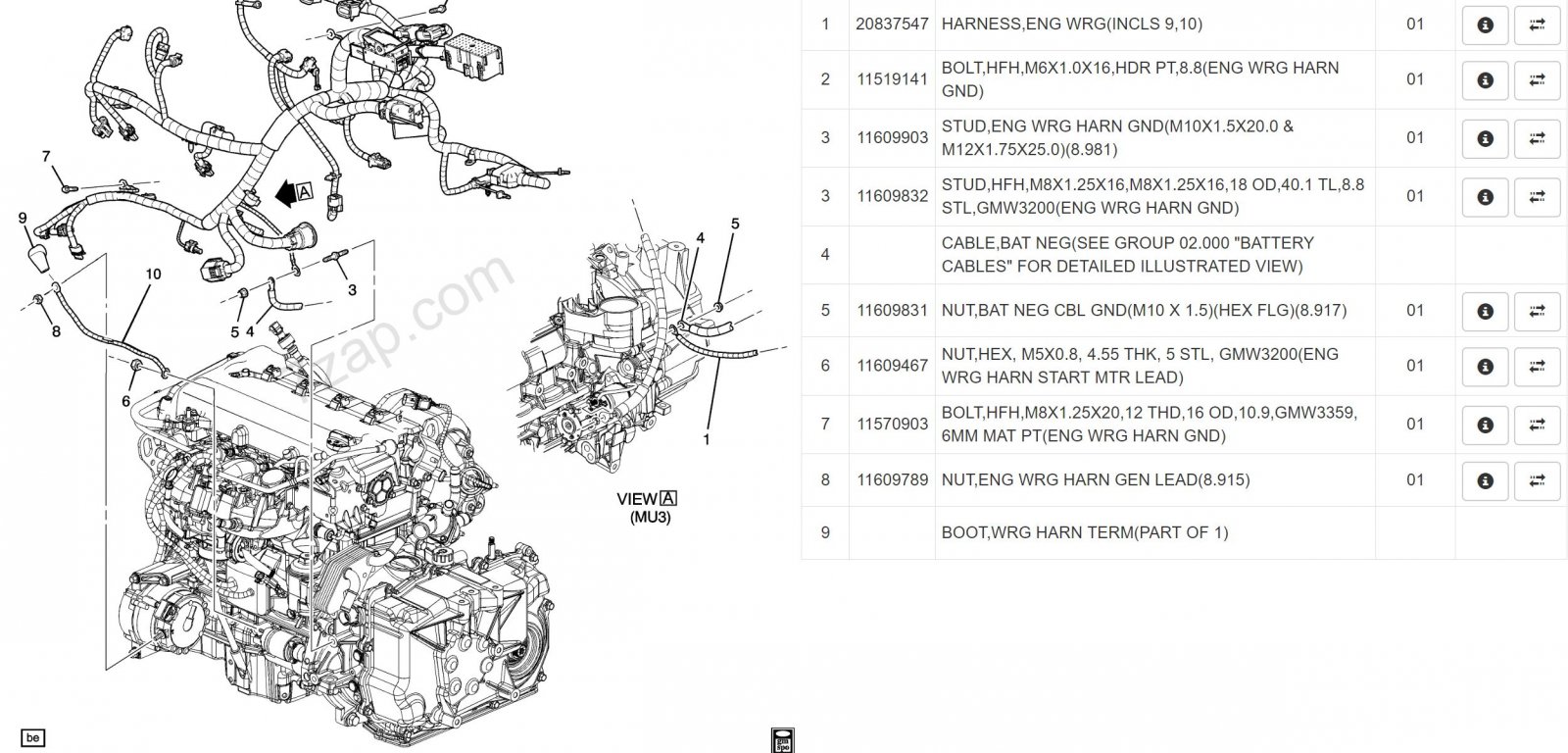

Finally found a great diagram for the ground wires........along with using Toms picture from above I should be good to go. 2 connectors go to the AC.

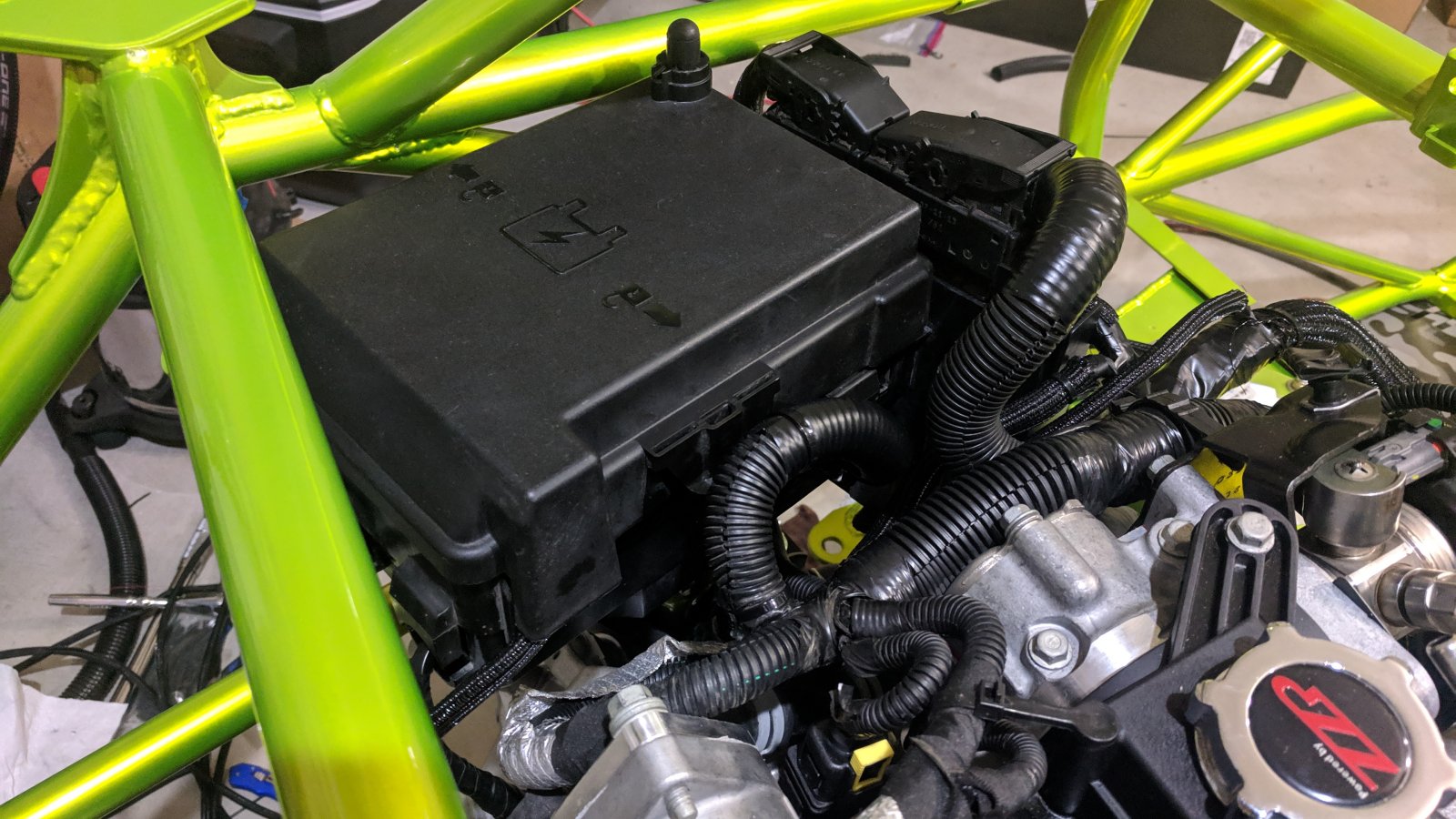

Fuse box in place.
