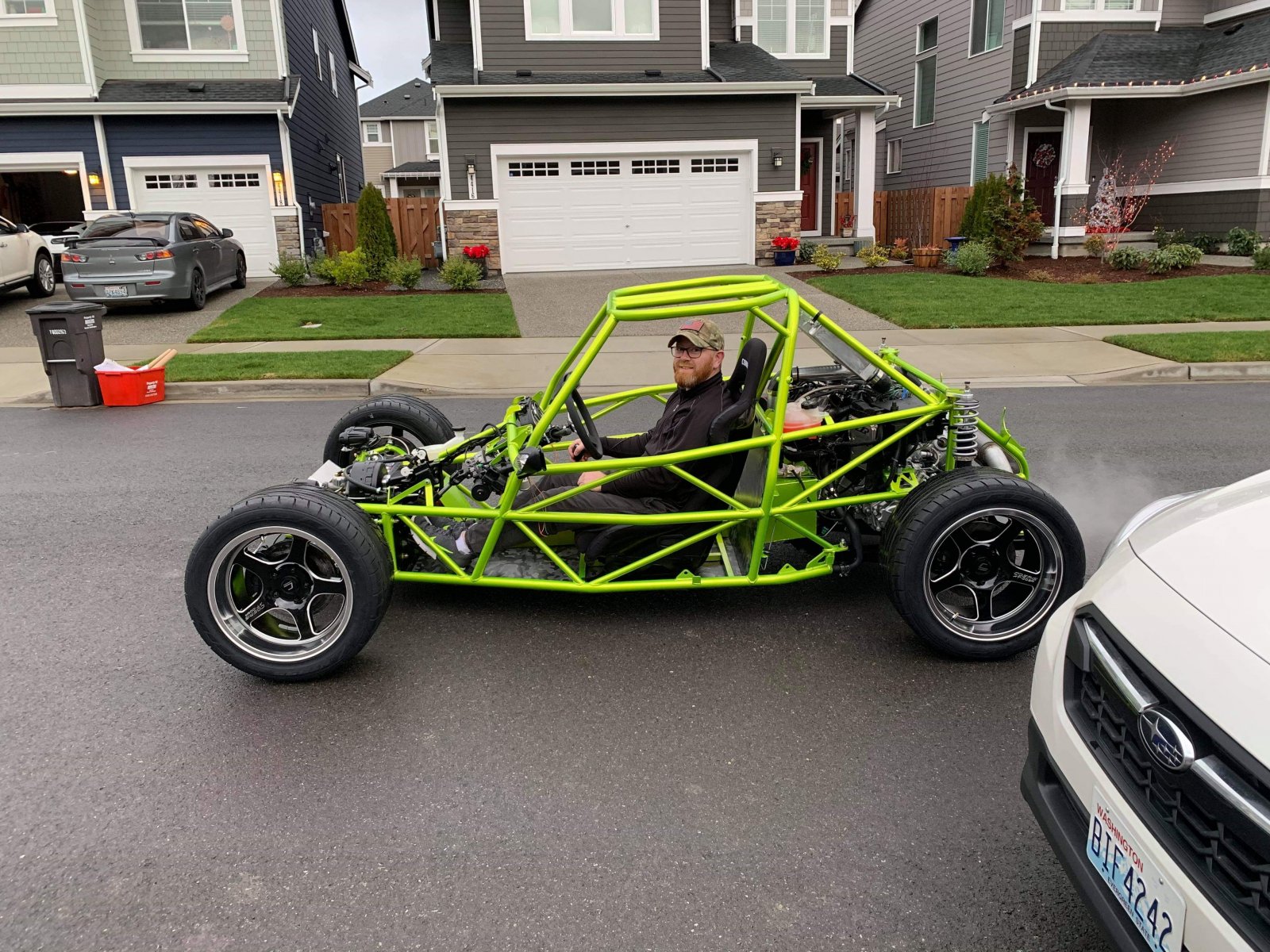

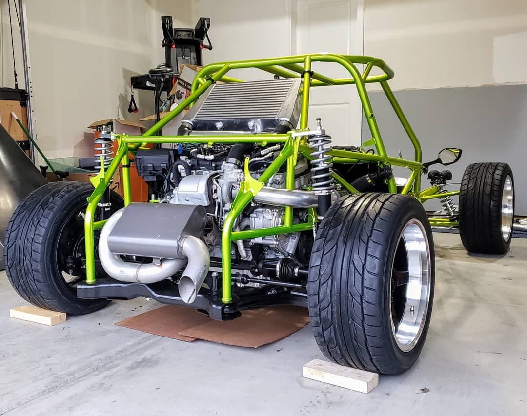

Also! FIRST DRIVE! I can tell this thing is going to be nuts. It was a bit wet out and the brakes still need fine tuned(specifically the rears). I was going to do this on the 25th due to weather but we had a nice break and I couldnt resist!
My neighbor cracks me up "WWwwooooowww, that sounds good!" Yes it does!
N
Did it feel REALLY small when you started driving? That was my first reaction. I twisted around to look while i was driving in reverse. Hand could almost touch the rear bumper and foot was almost at front..... weird feeling
Are you doing a hood? Curious what your color scheme will be.
IDRVSLO
Felt super tiny! I have the hood and side panels. Along with a different solution for the wing. See my wrap on the floor? Same color with a satin black center on the hood.
Christopher Sanchez

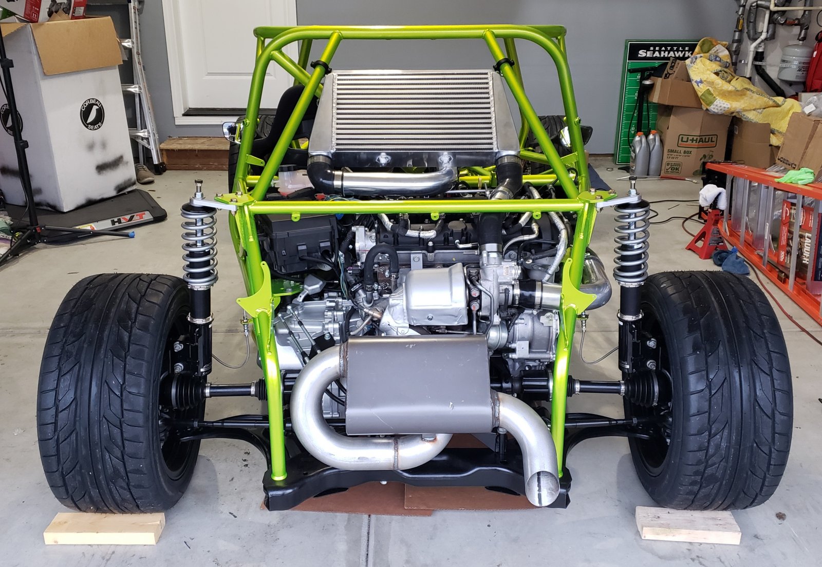

So sweet! I wish I was that far already, NM weather is Beautiful right now!! Haha What is your ride height? As I am running stock cut springs (cringe) at the moment my 6.5 ish inches ride height puts my axels at a slight angle.. yours looks on the money.
IDRVSLO
Thanks, I will take a look and get some measurements. Just have to keep in mind the sidewall/wheel combo will cause these numbers to vary a bit.

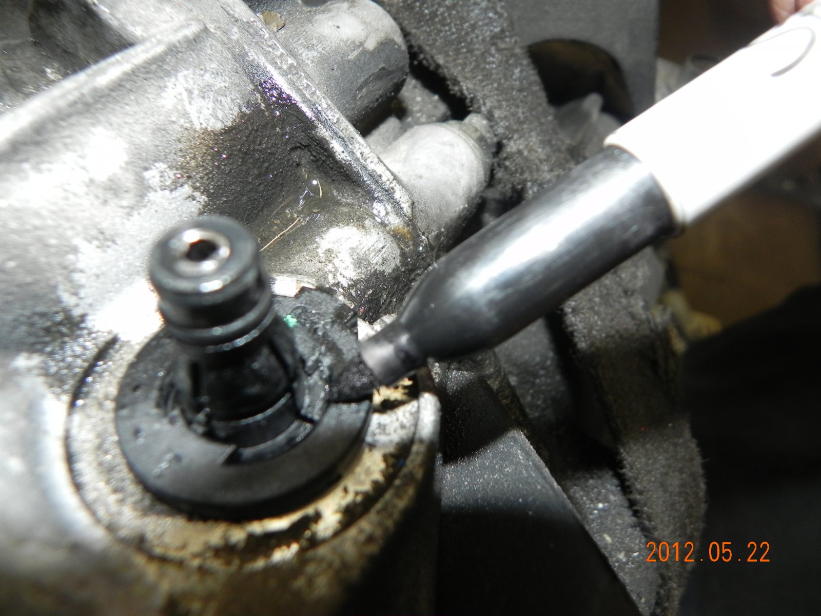

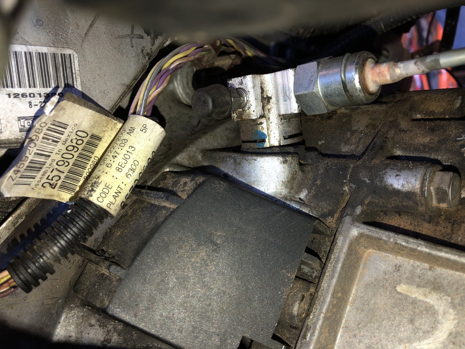

It is not an oring from what I remember. I think is has square edges.View attachment 6621

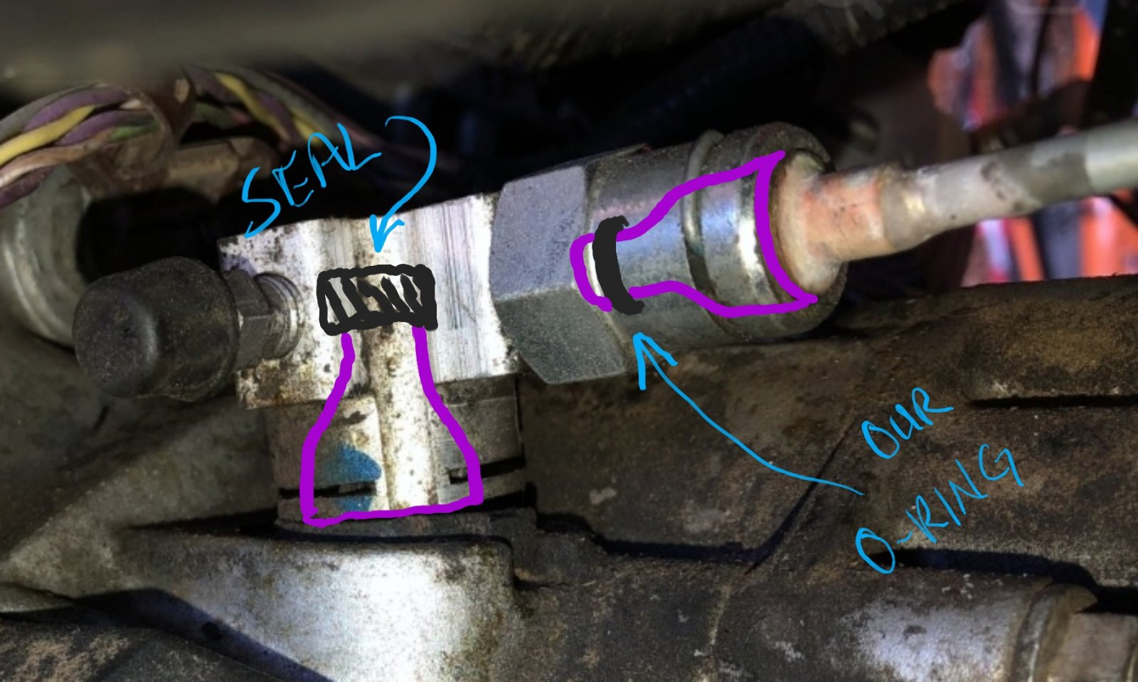

Blurry pic from off the web. I will see if I can find a better one.View attachment 6622

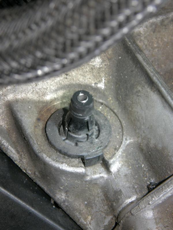

Another image, not quite as blurry.
Is this a different part than you are referring to? Or do I have something installed incorrectly the hard line from the kit fit right into the factory location for the clutch. I haven’t attempted to bleed it yet to see if it holds pressure
No need for a pressure bleeder, vacuum bleeder, buddy system or whatever. All you have to do is route a vinyl hose that has a radius that goes above the bleeder screw and then down into a empty bottle. After that you can crack the bleeder screw and pump away on the pedal all by yourself.
