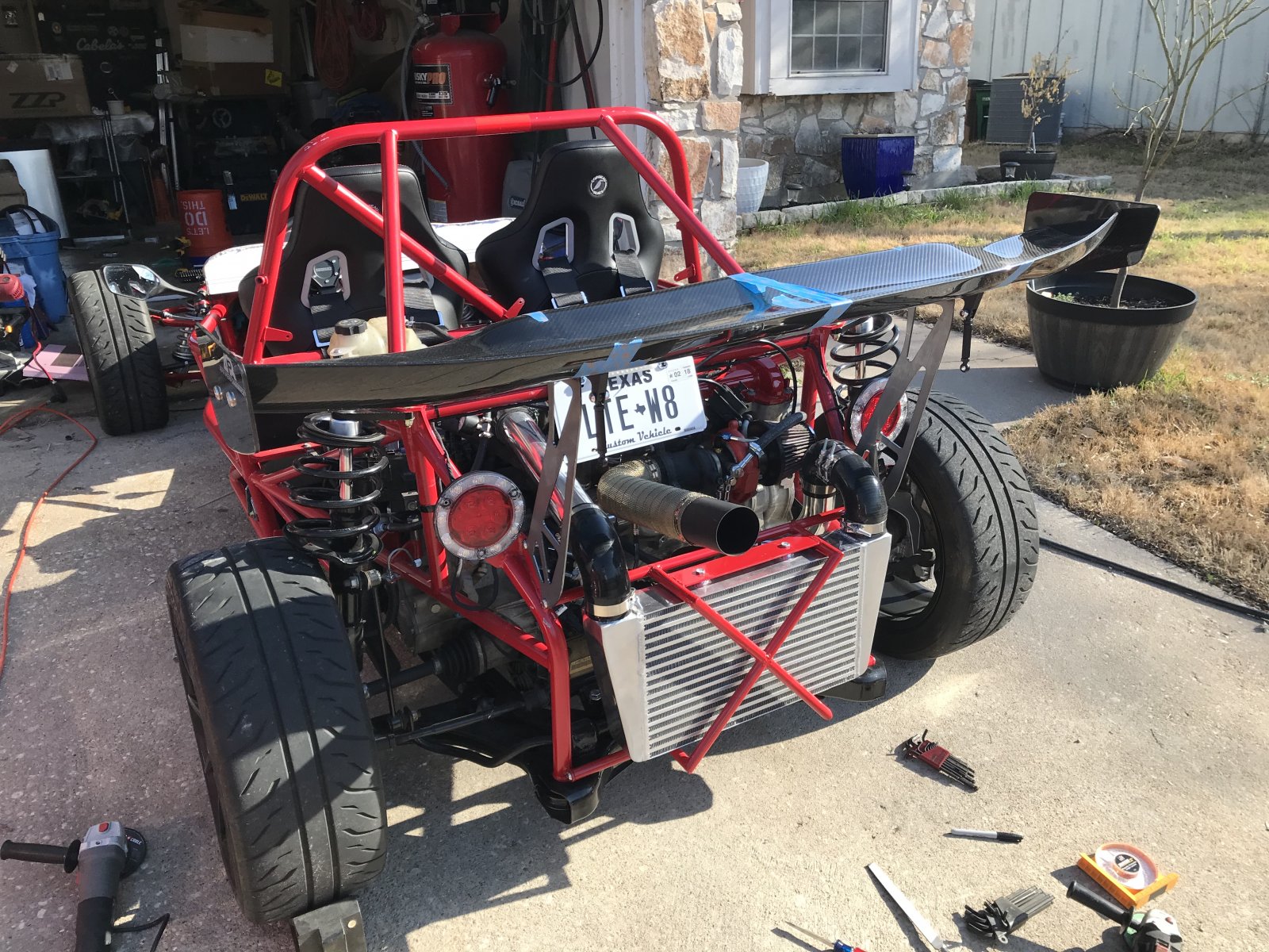

Setup is now on the car! I ended up using the thrust washers right against the machined strut tower pieces and the clearance was close on the mounting hardware, but it worked nicely.
I used camber bolts on both upper and lower bolt holes and got a LOT of negative camber available, this picture has them set with as much camber as possible.

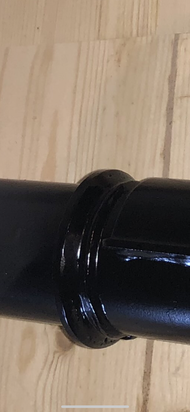

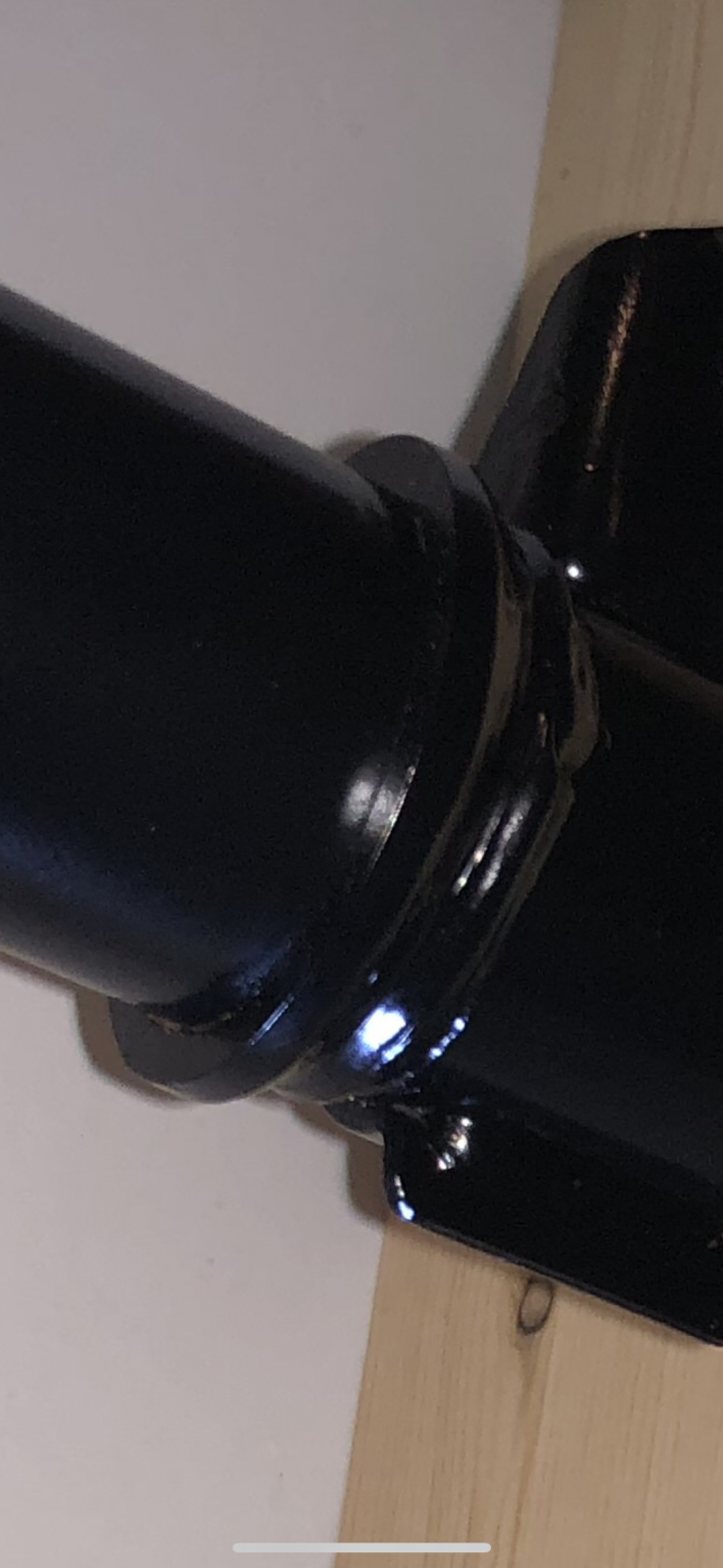

My welding is really functional at best so I knocked the welds down to a chamfer under the collars. The factory perch weld bead is actually large enough to keep the sleeves from sliding down. I just added these because I had already bought them, and the flat surface is better for the sleeves (as opposed to the rounded OG welded bead that could spread / mushroom the bottom of the sleeve)
If I was going cheap route, I would just grind down the original perch weld kinda flat and call it good enough for ebay coilovers. You wouldn't want to weld on the struts anyway unless you were gutting them for the insert style shocks like the Konis. The heat would likely kill the OE sealed type shocks

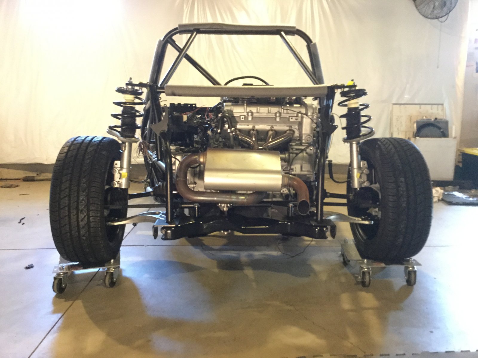

I am on the other side of the fence on this one. The coilovers just look clean and if done to resemble the fronts they look like they belong on the car. The stock ones look okay but not as good. Almost like it was a hurry up to finish look. Just my 2 cents.
