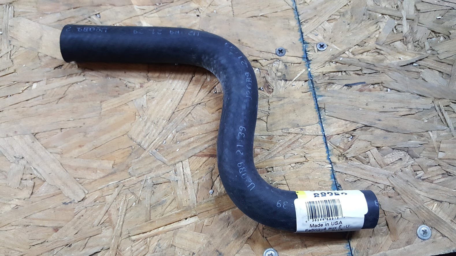

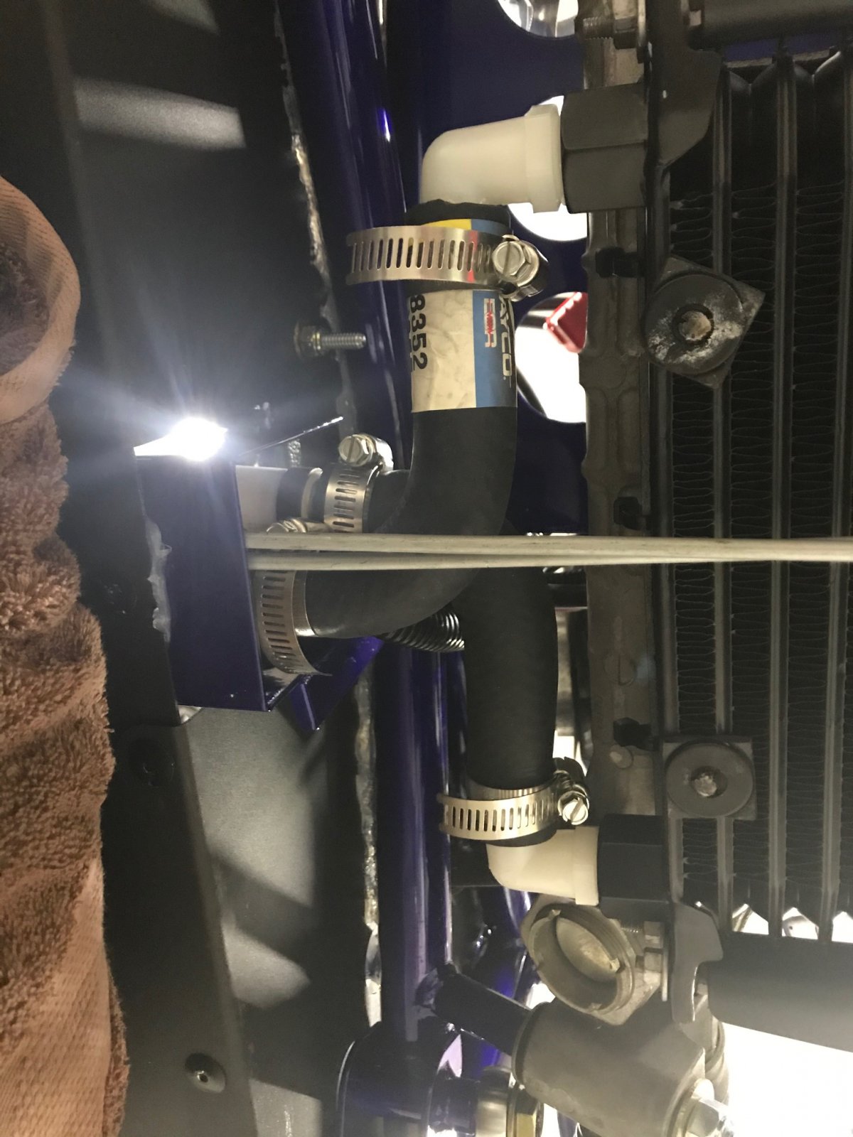

This is the hose we supply for the heat exchanger, it gets cut in half.

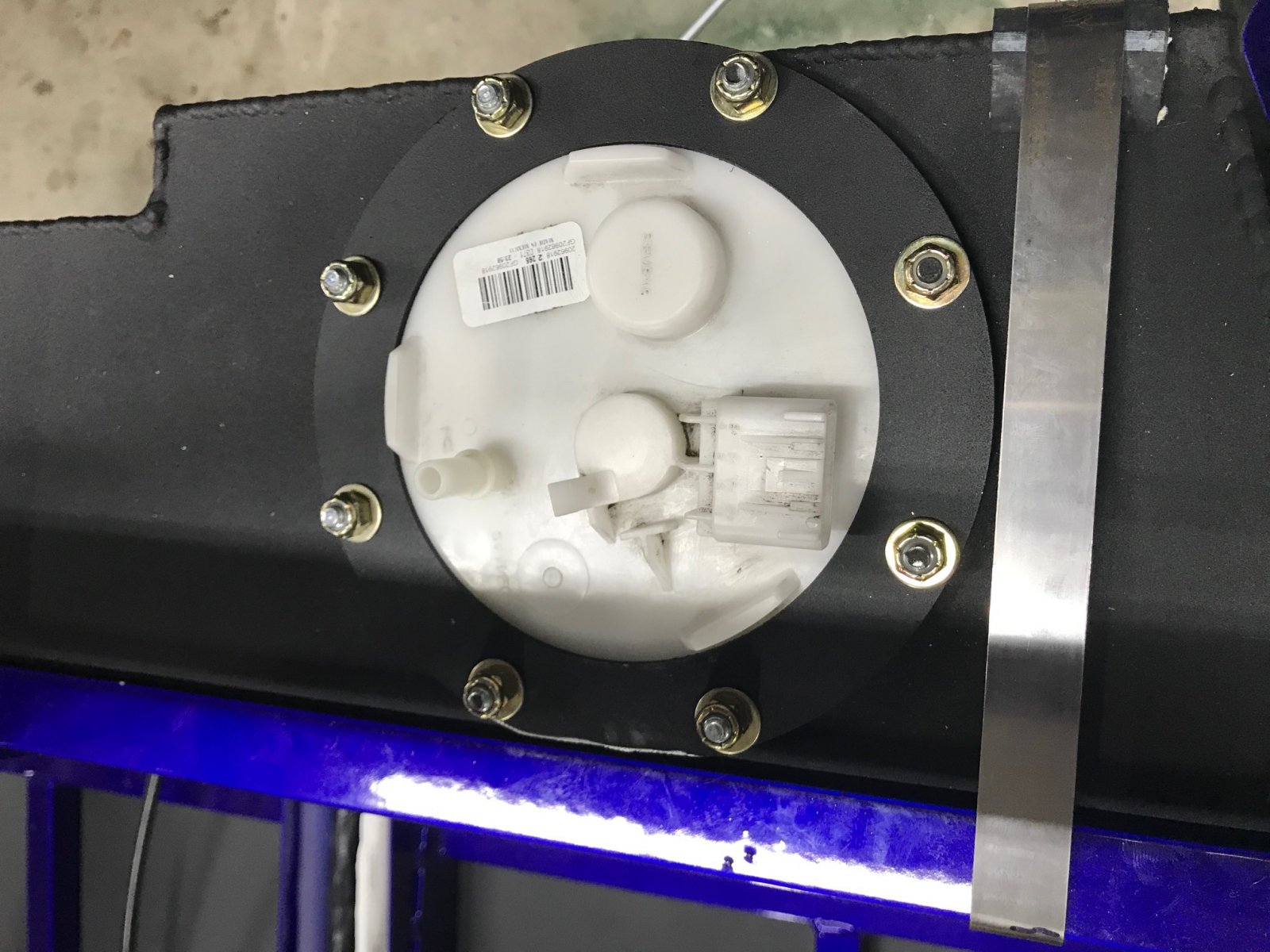

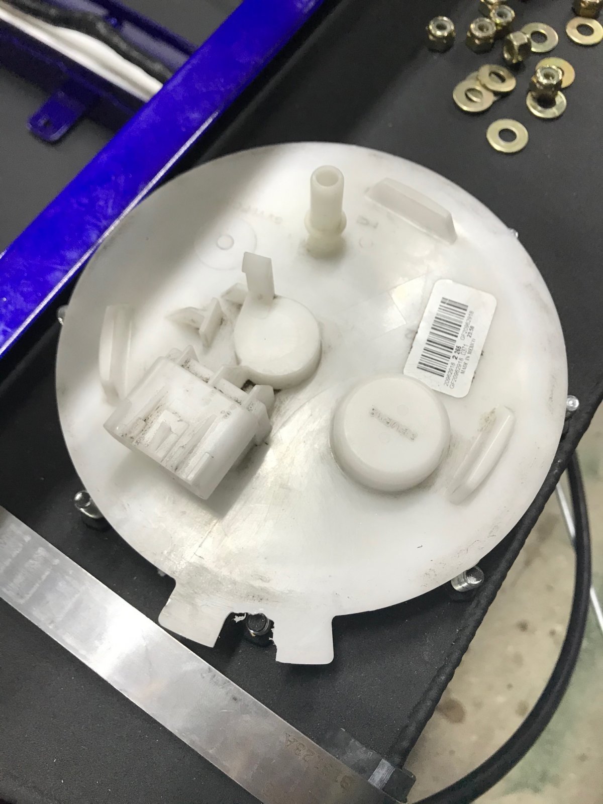

Installed the fuel pump AFTER vacuuming out the tank very well (thanks Desert Sasquatch!). Had to trim the bolt ring just a little to clear the tank mounting angle. And had to trim the pump plastic flange a little to clear one of the bolts. Some of these little details did not make it into the first build video.

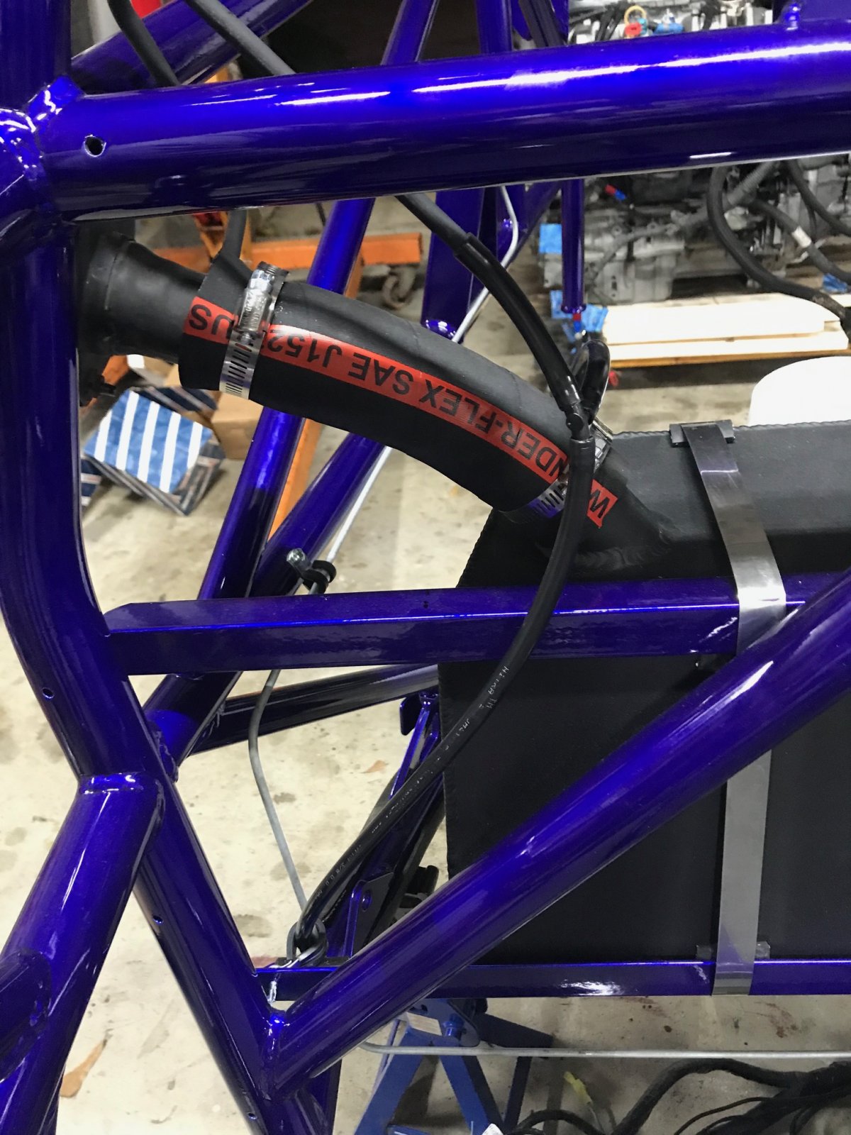

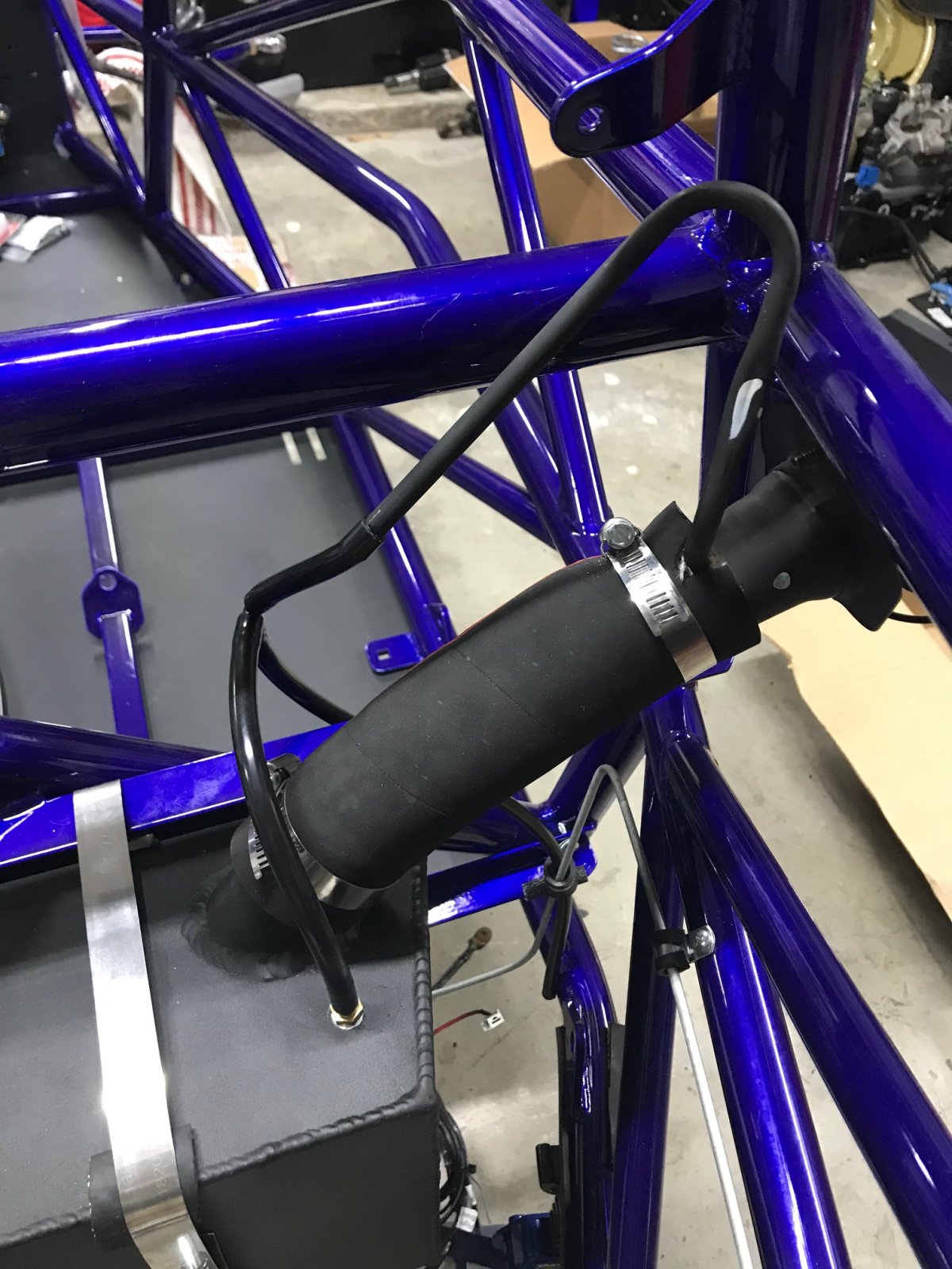

Fuel filler neck with vent hoses.

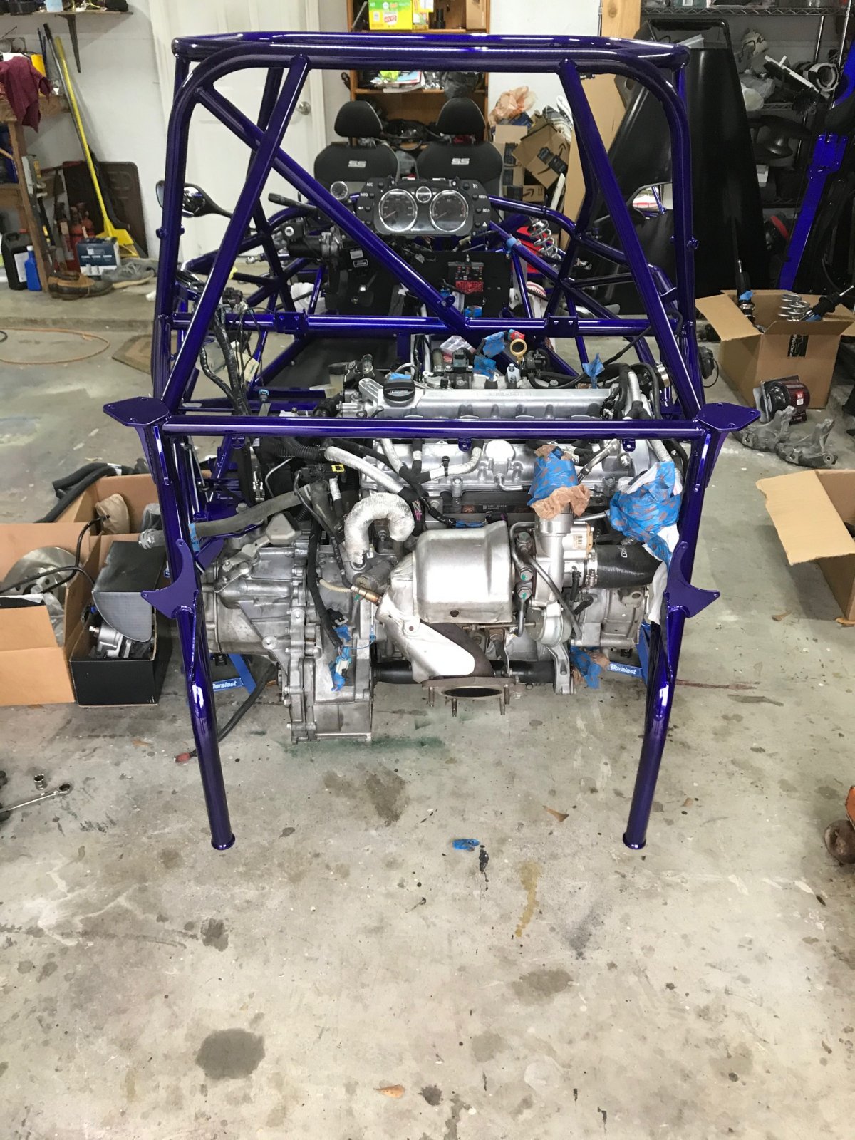

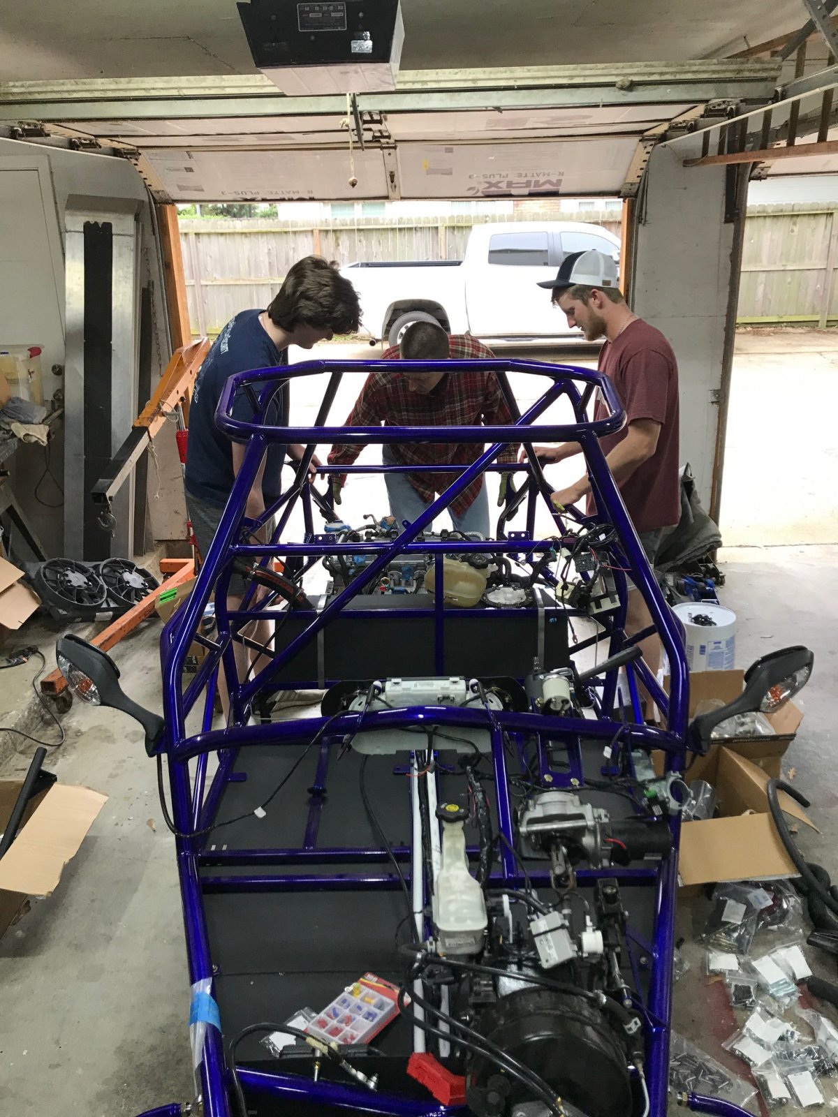

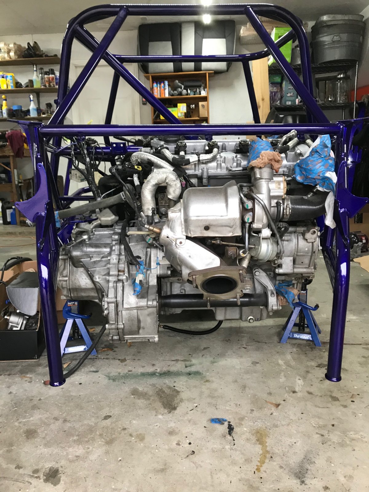

Do you Ecotec take this Goblin to be.......................Got a marriage here today!
Plenty of help from the sons - and dog. And thanks to Lonny for a few quick texts answered on a Saturday! Goblin tech support at its best! :)

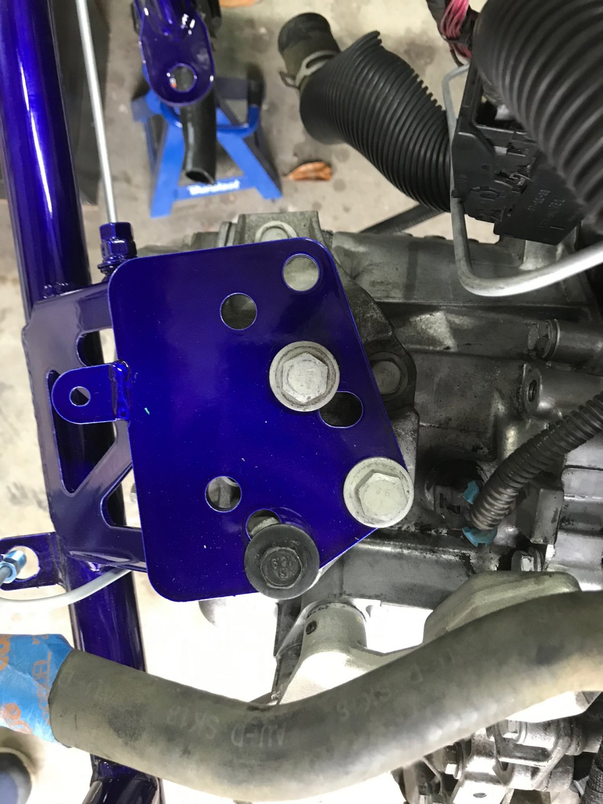

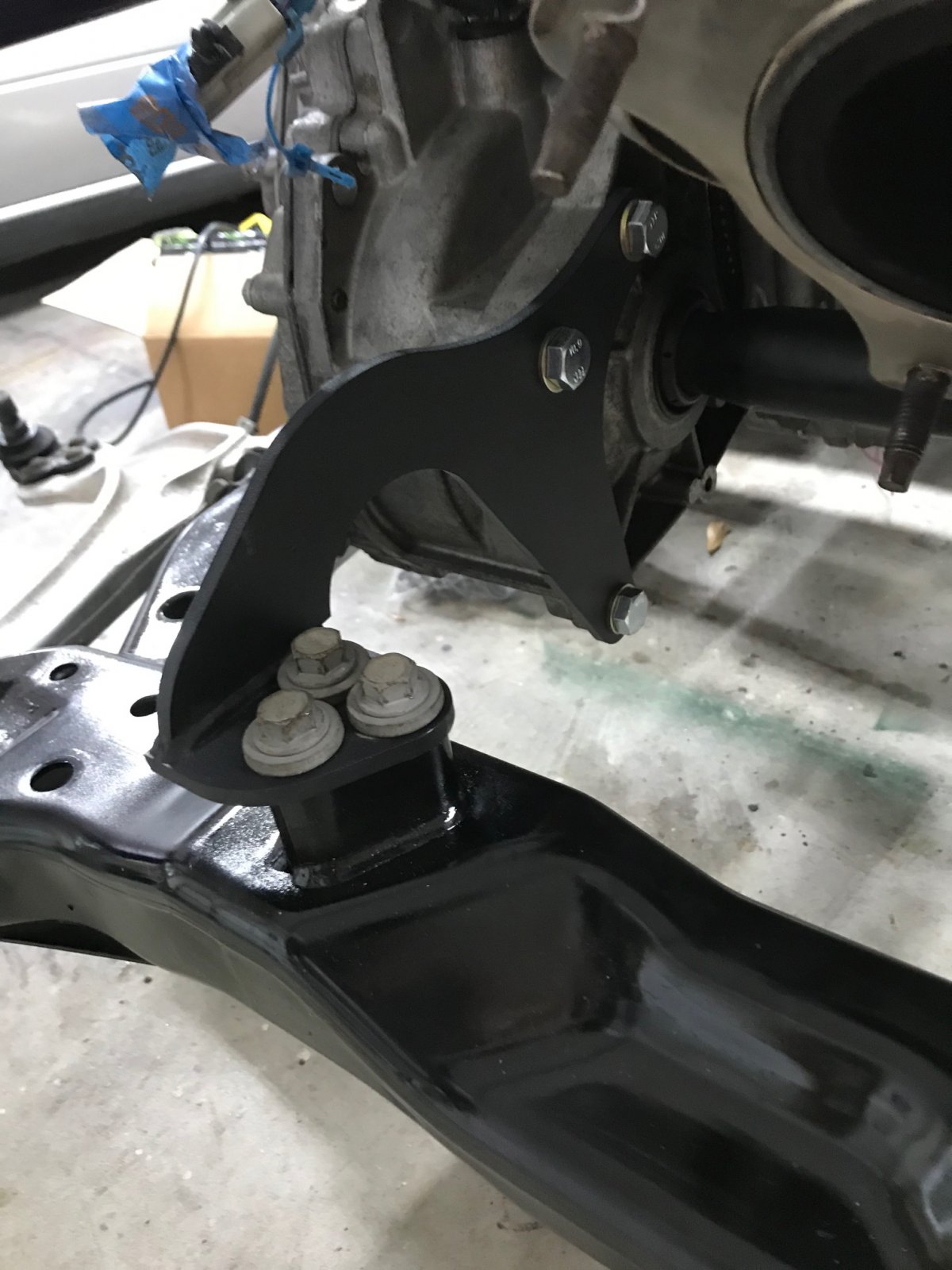

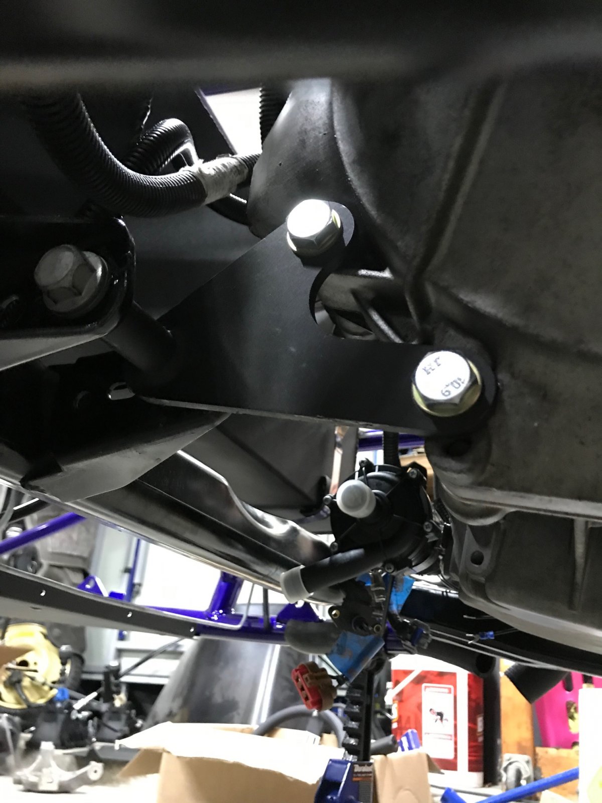

The turbo mounts in the back hole set on both sides. On the driver side there are two spacers (K21E) where two original transmission mounting bolts are used. The remaining four black bolts are from the donor seats.

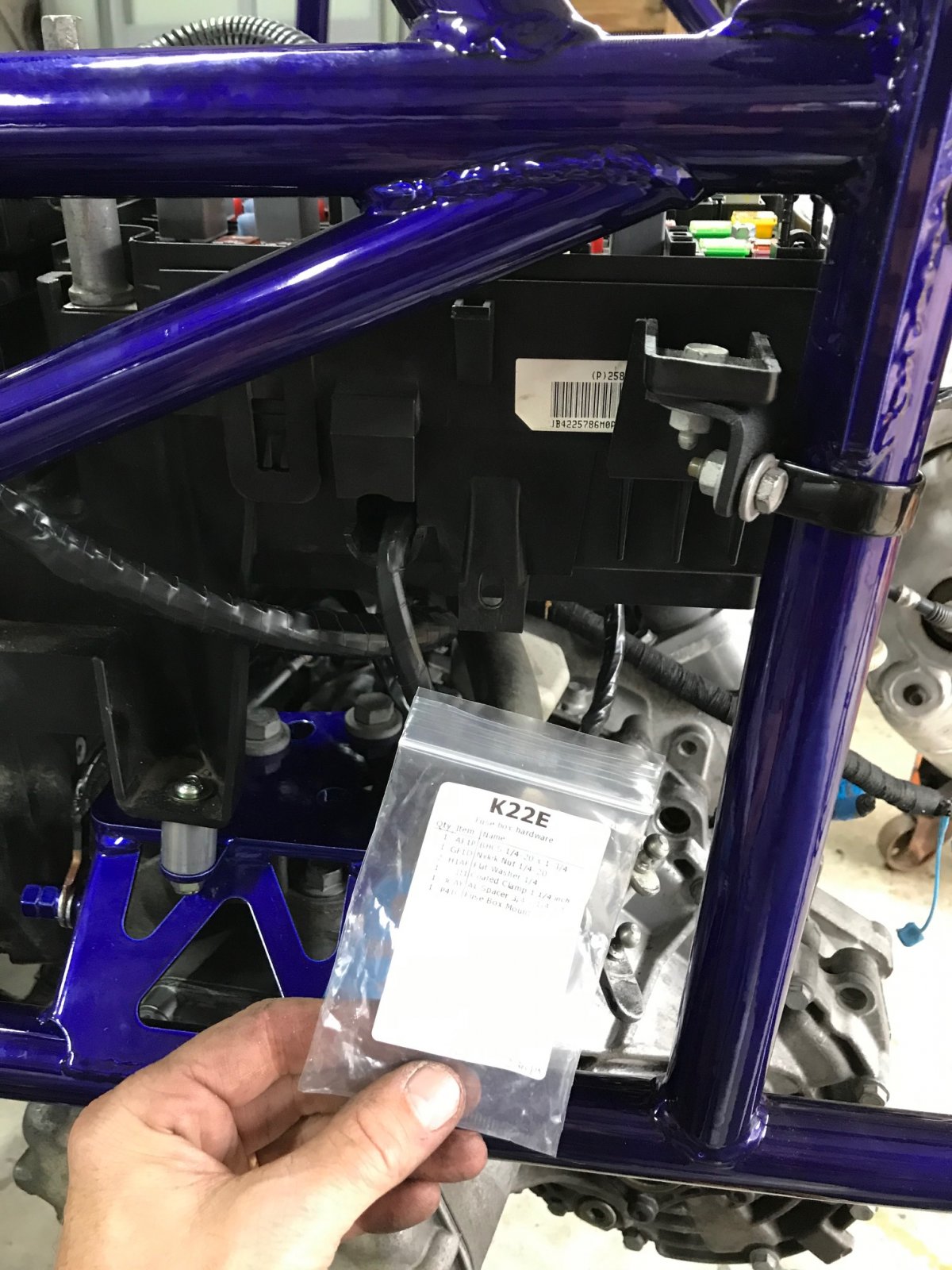

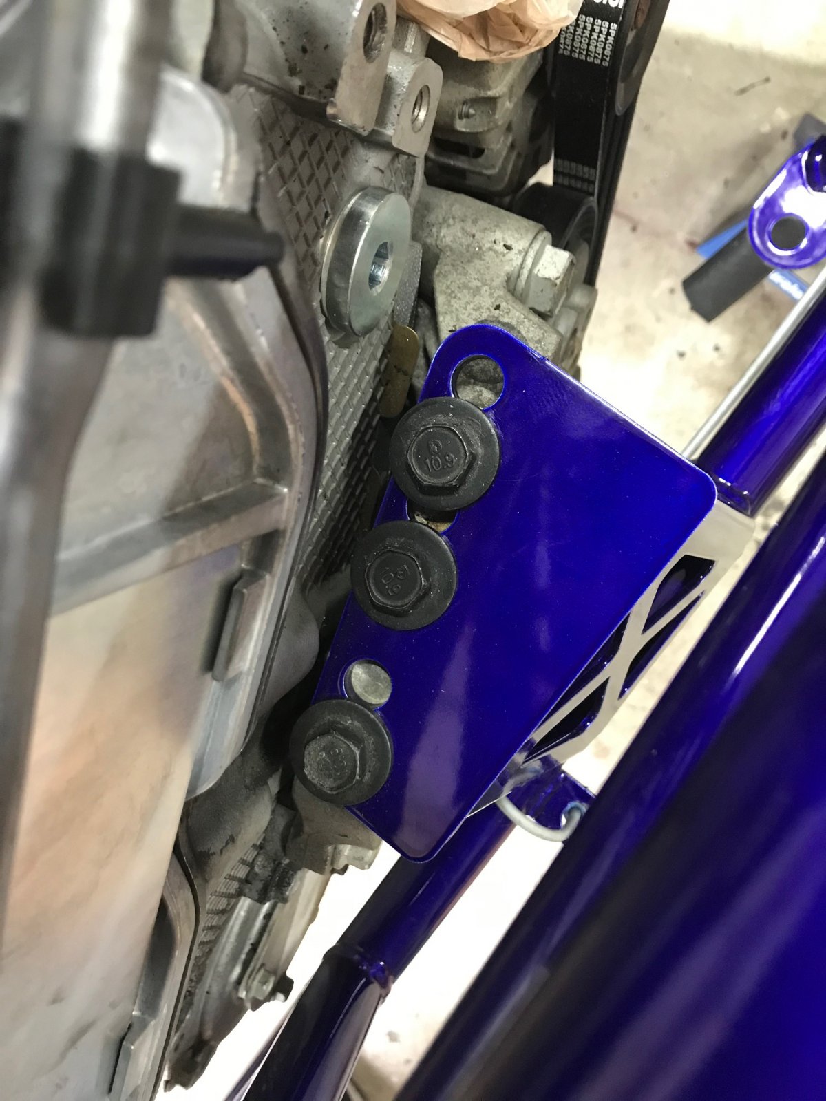

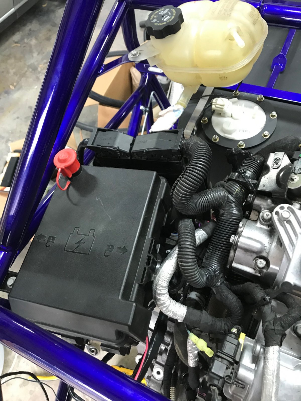

Took a good pic of the mounting hardware under the fuse box. This little spacer change is not in the part 20 video.

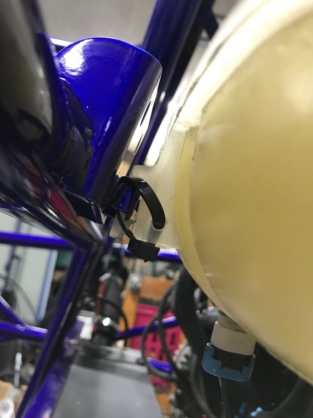

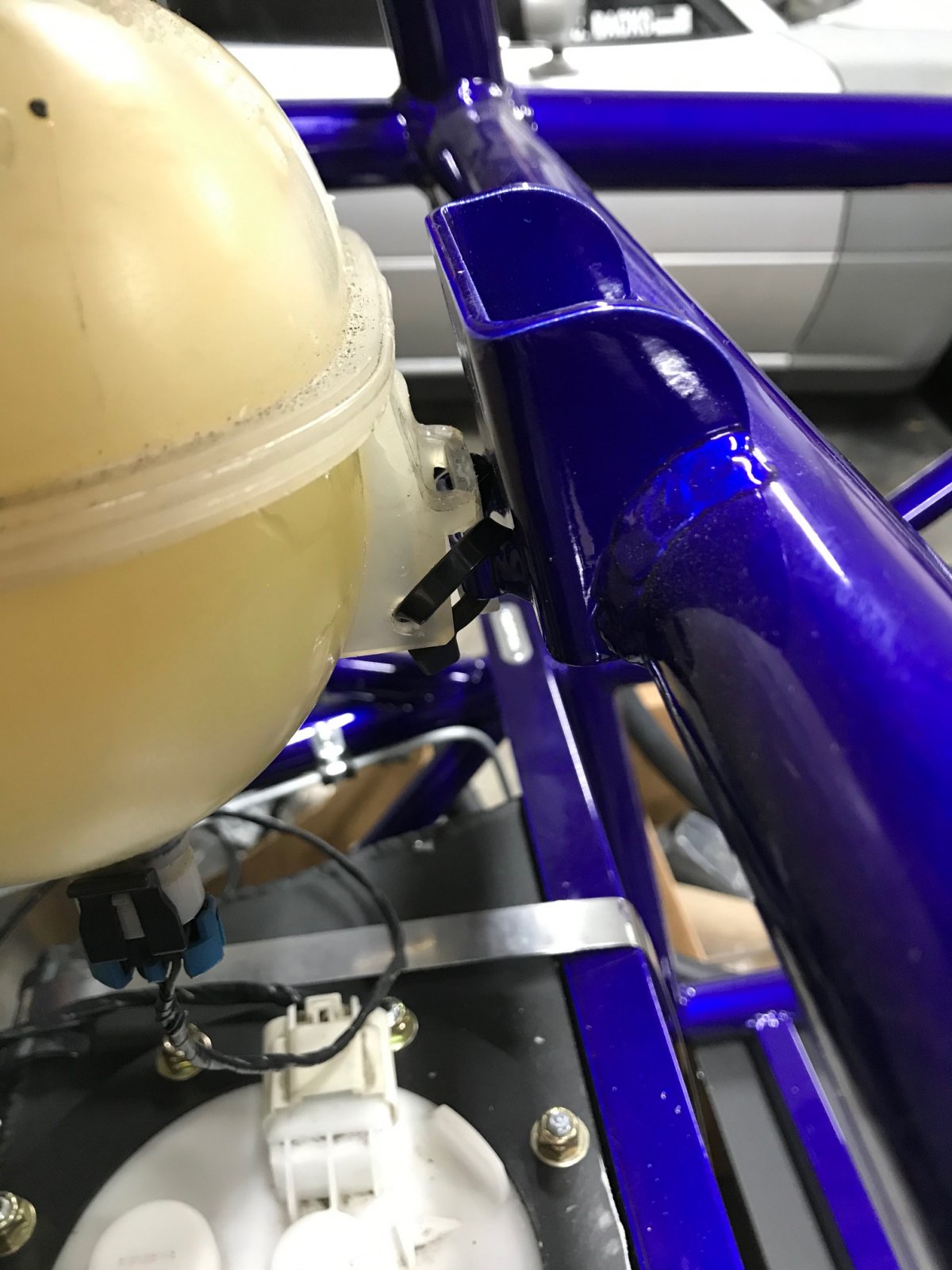

Not sure if anyone else was a bonehead like me and tore the little tab connector on the back of the plastic expansion tank. I tried reinforcing it with a metal strap and two part epoxy. The epoxy did not stick to the plastic tank. So, I just drilled two small holes on the underside of the tab bracket and used two zip ties. A little crude, but will do the job.

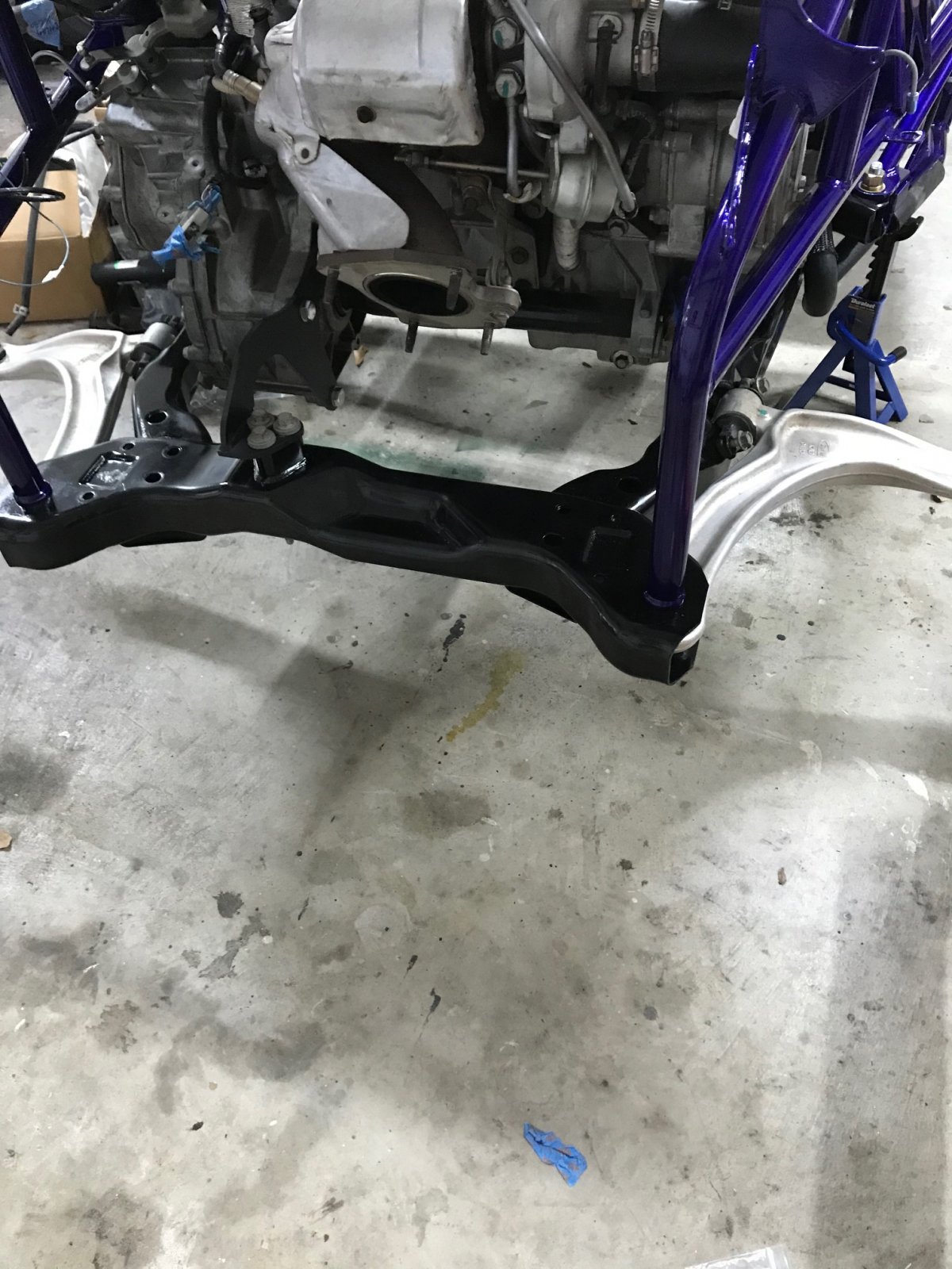

Subframe installed today. Moderately easy. I kind of followed some old instructions here:
https://dfkitcar.com/forum/index.php?threads/first-stage-assembly-instructions.58/
You will have to scroll about half way down.

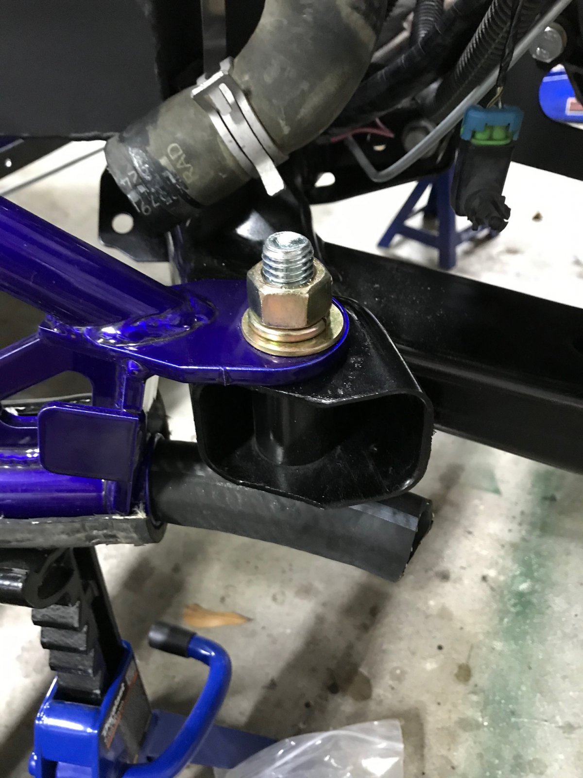

The solid engine mounts fit well. I started with the front two carriage bolts to the frame at the corners. Then installed the rear middle solid mount. Next, I put in the control arms and the rear corner bolts. I left all of the above loose. My last bolt was on the front mount where it goes through the subframe ears. Wrestled getting it exactly lined up, but it finally went. All worked, but a different order may yield an easier install.

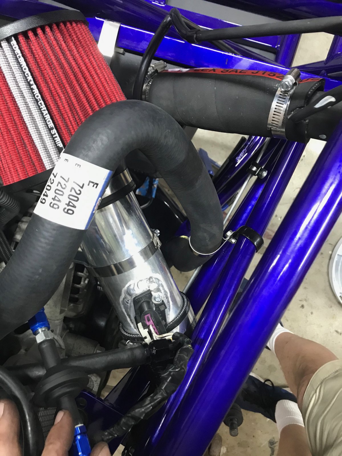

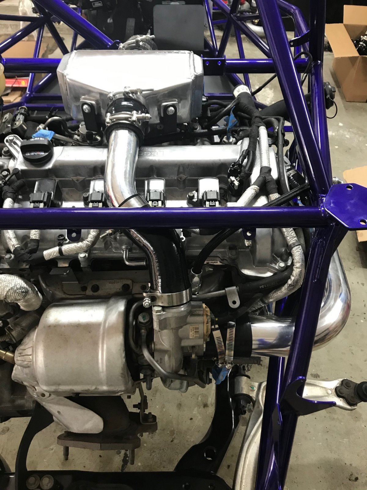

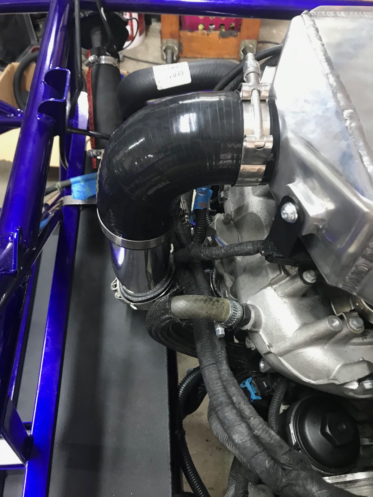

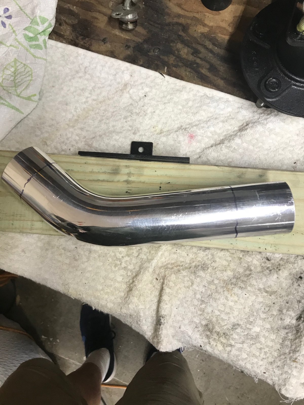

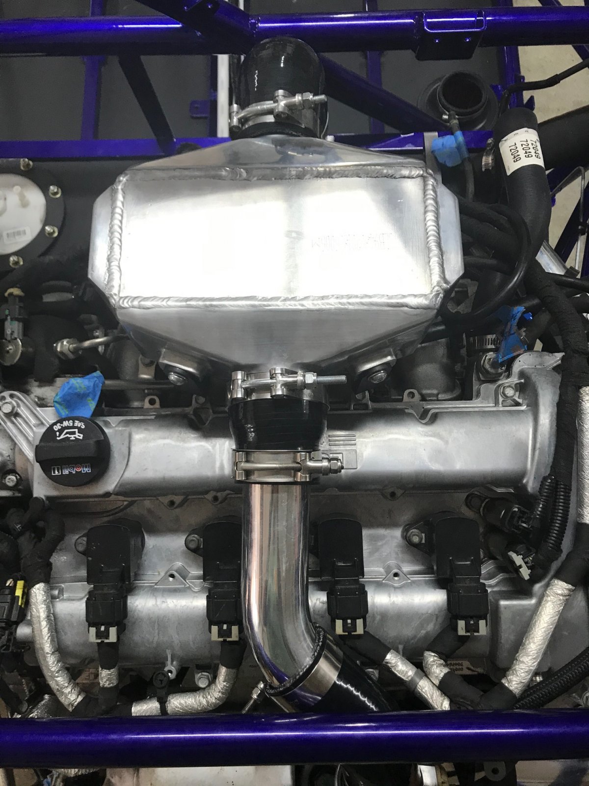

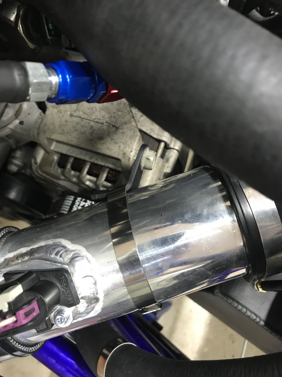

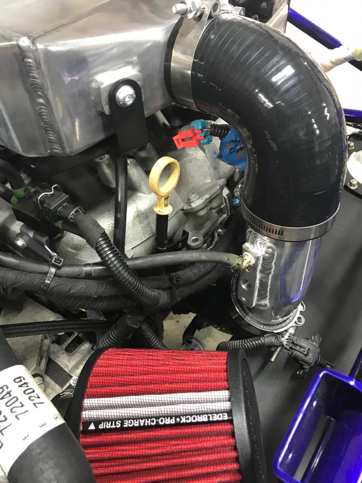

Fit up all the intake and intercooler piping. Had to cut one metal tube a little shorter. Trimmed the rubber pipes a little here and there. It is a tight fit everywhere. I did have to move the little vacuum junction box on top to make room for the aluminum inter-cooler. Just moved it to the side over a few inches.
I did find a missing port that was supposed to be next to the MAF sensor. The factory has a replacement coming tomorrow.
Using Tire Wet helps the install of the rubber pipes.

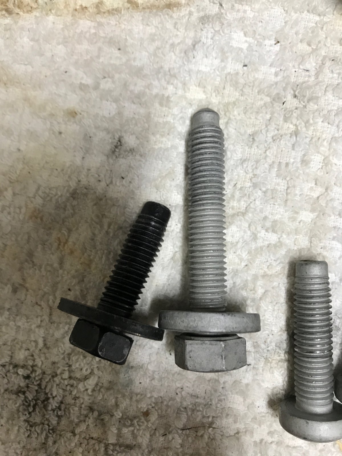

For the first time, I was unable to find the correct donor bolts. The ones that hold in the sensor right before the intake (it is loose in the pics). Bonehead move - I put them back in the holes when I removed the sensor, then sold the intake piping. Doh!!@#**

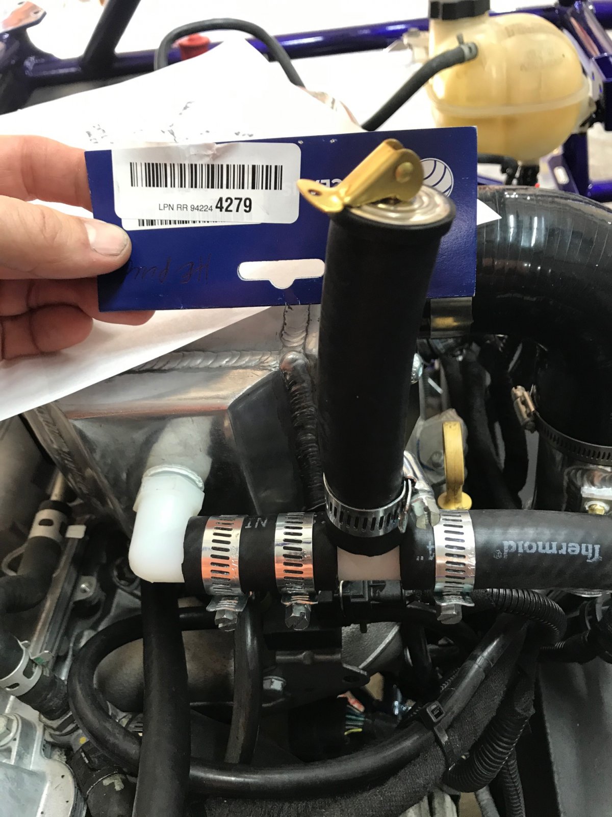

I finished up all the water lines on my intercooler. I saw a few different plugs and solutions that others have done for the fill port. I found a clean cheap solution on Amazon. See pic below.

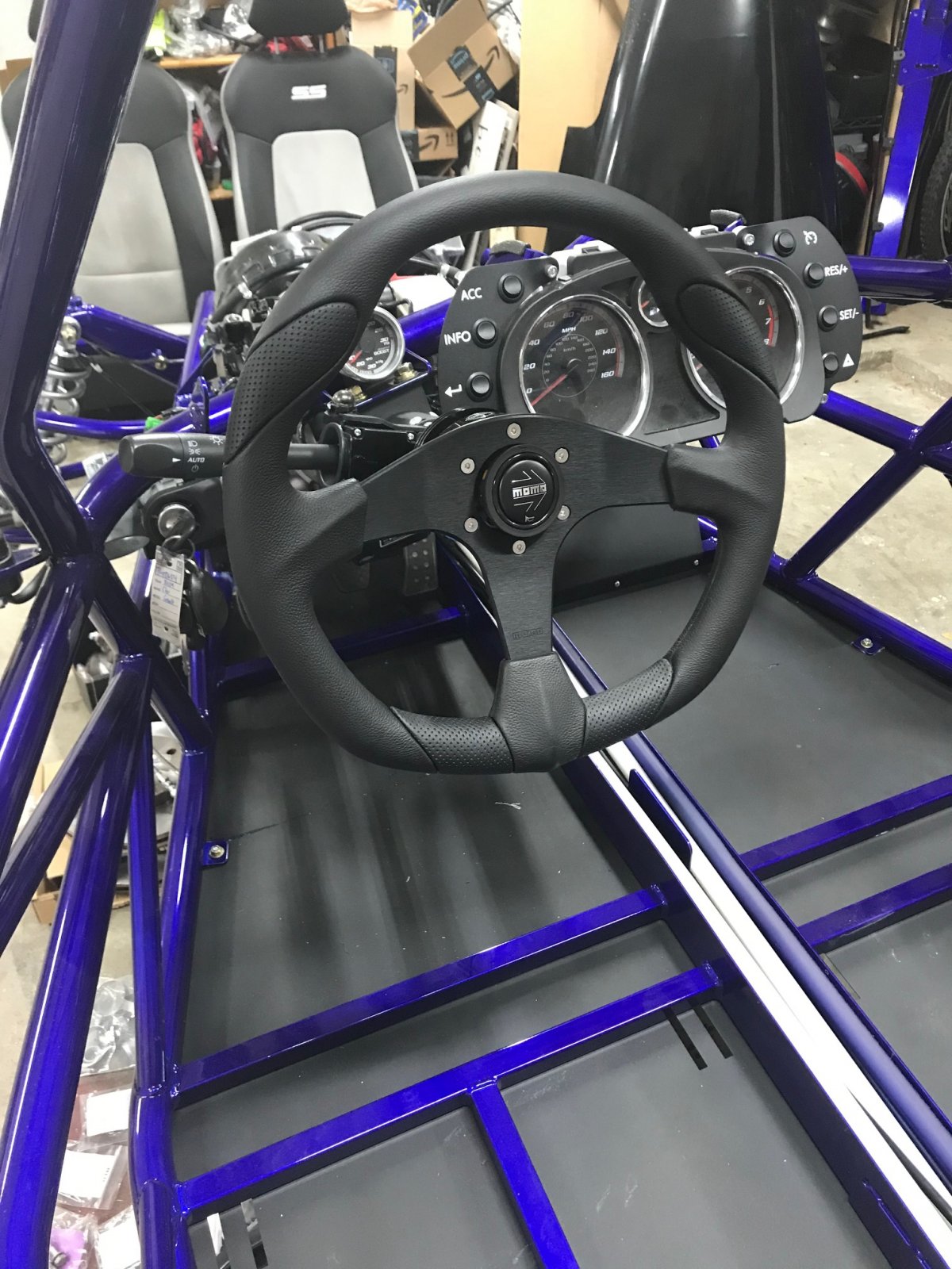

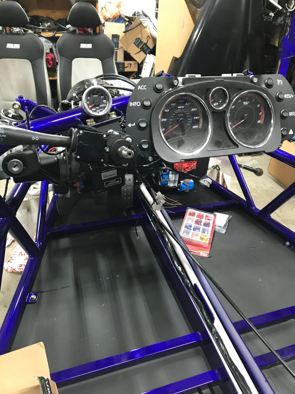

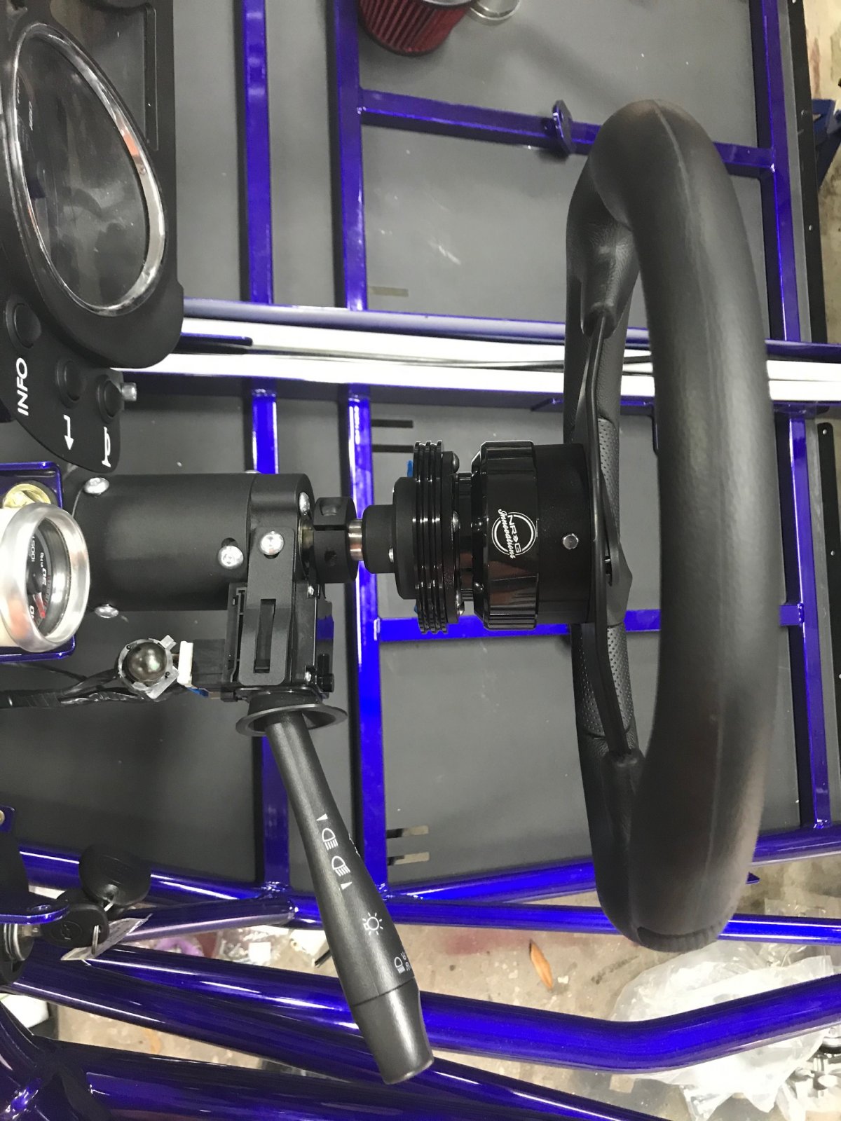

Steering wheel and quick release done.

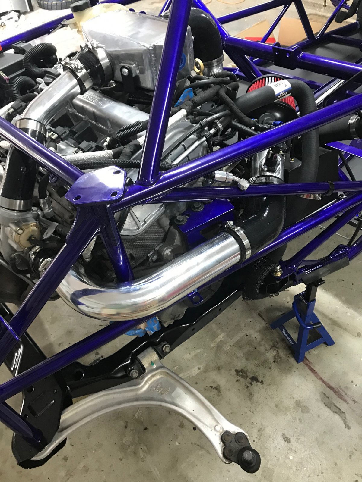

Rear toe link hardware installed, not tightened.

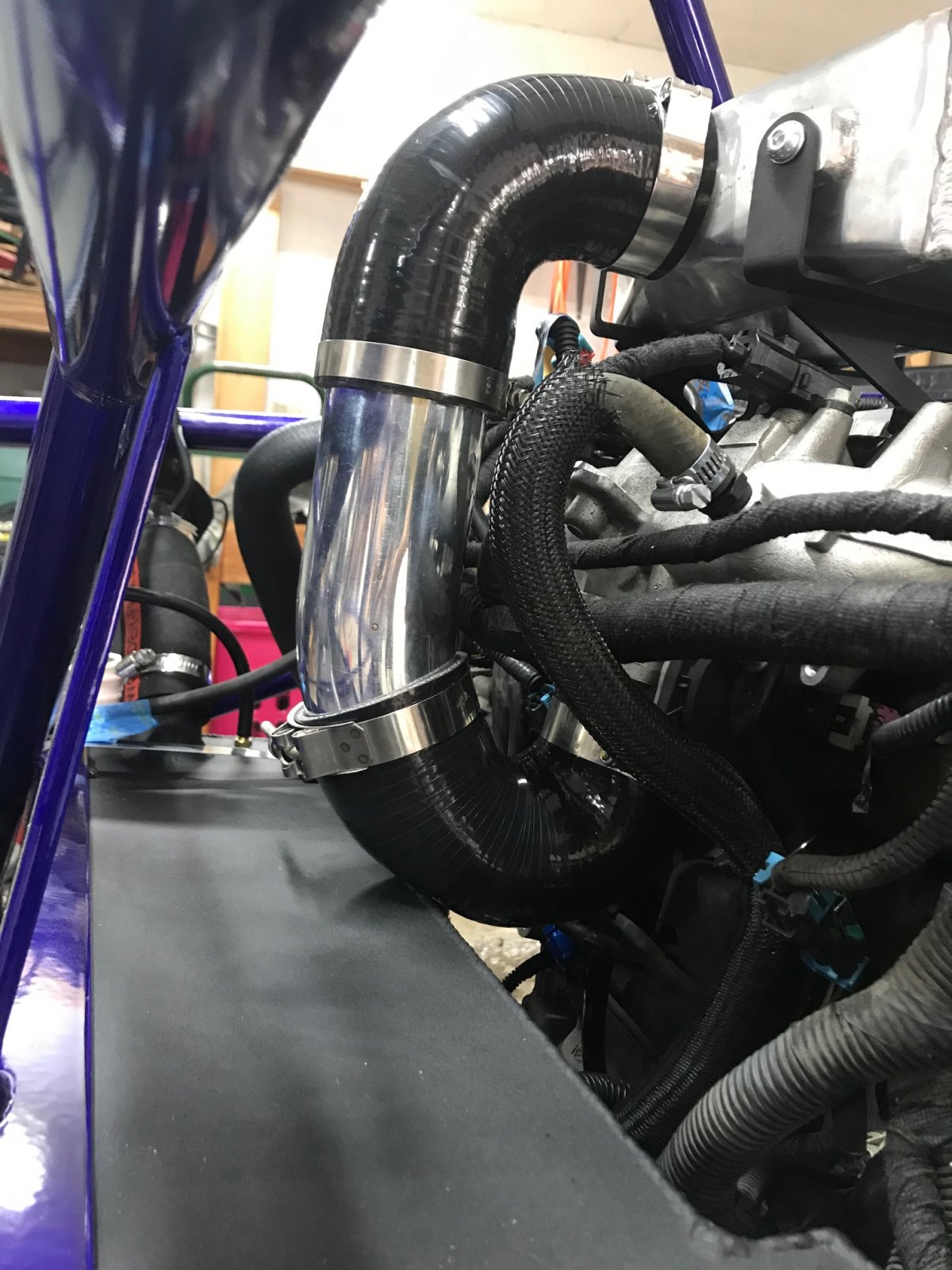

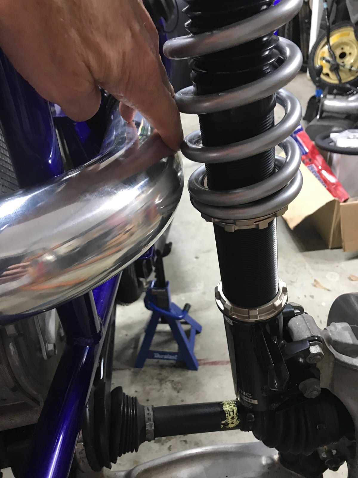

Rear suspension installed, not tightened. Man the clearance with the inlet pipe on the driver side is TIGHT! I may try to cut the pipe and move it in another 1/4".

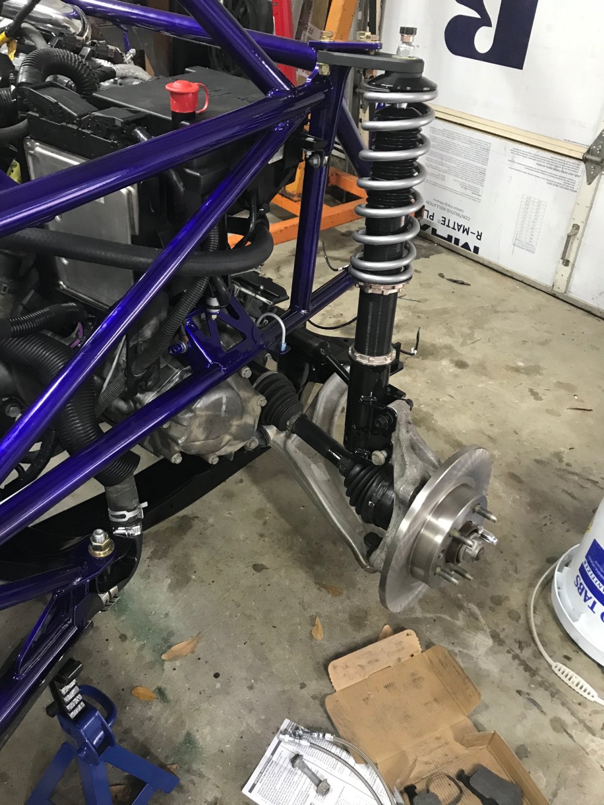

View attachment 12399View attachment 12400View attachment 12401View attachment 12402View attachment 12403View attachment 12404

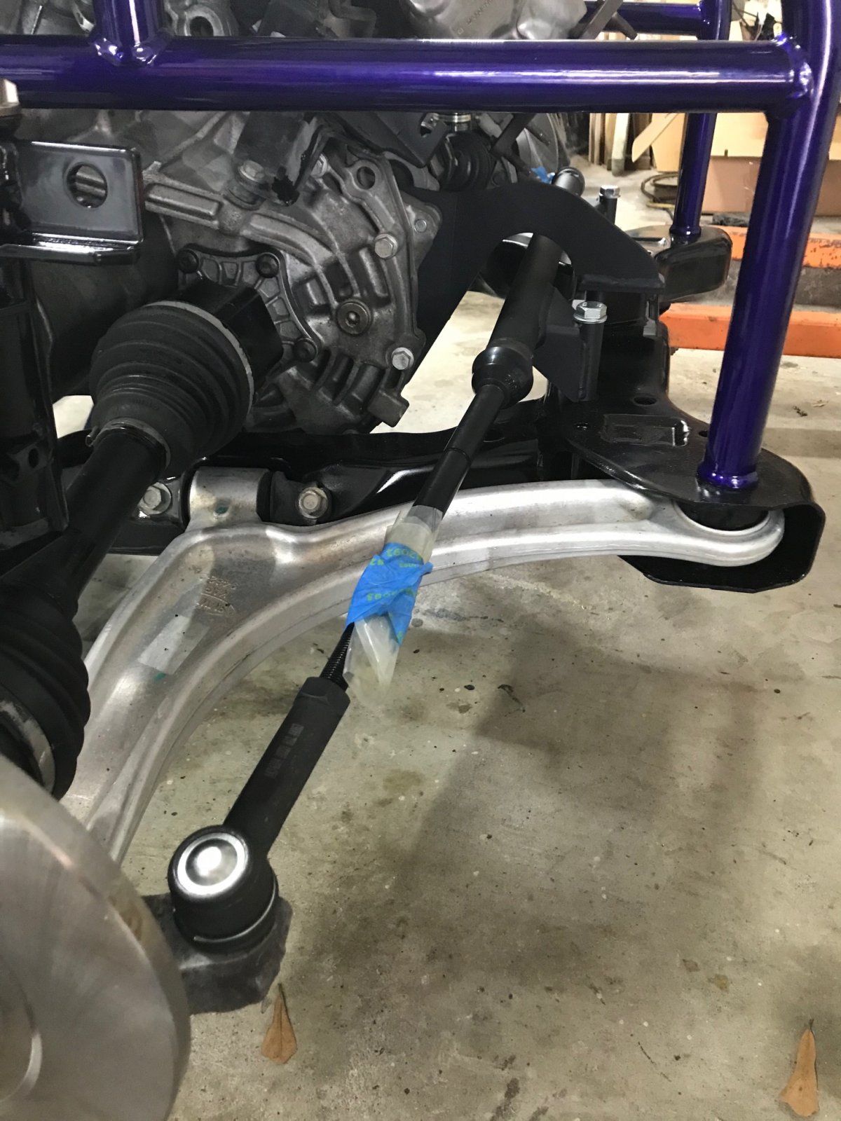

Just a reminder, the new tie rods from DFG go on the front and the old ones from the donor go on the rear. It looks like your rears are the new ones.
Your build is looking great!
Zoom Zoom

View attachment 12296View attachment 12297View attachment 12298View attachment 12299View attachment 12300View attachment 12301View attachment 12302
That’s nice real nice!!!!
So I thought about this mistake some more. And, I started thinking if there was anything else that I may have missed on the build that was not included in the instructional build video series.
I did receive several links to picture groups that were supposed to "fill in the gap" in the absence of details not in the final videos. They were helpful. But maybe they were not quite as dummy-proof for me as the video series.
How did everyone else (Jeff, DCMoney, ...) know this tie rod end swap and not me? What did I miss? Where was this info? Am I just a bonehead???? Is it "common knowledge" and I am stupidly uncommon? Input from all is welcome here. No pride will get hurt.
Thankfully I posted a picture that Jeff just happen to waste time perusing - and was astute enough to point out to me. Thank you, sir.
Sorry all for whining and venting. I will swap the tie rod ends and call it a lesson learned.
