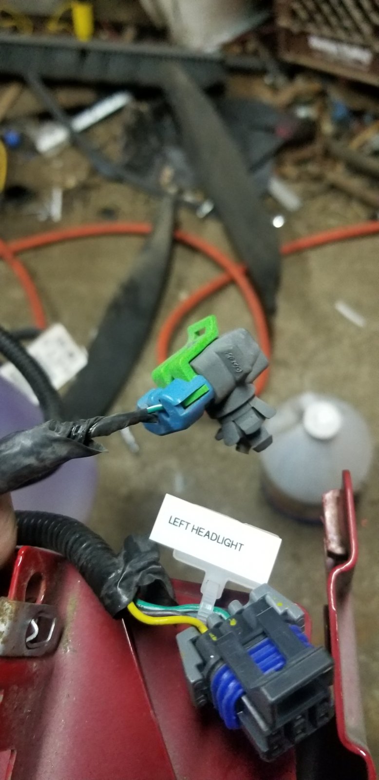

Ok here is my first question? What is this? This is in the left front head light area
JeffsGoblin
Looks like the temperature sensor, so you can see what degrees it is outside and it will be displayed on the dash readout.
Also mentioned here:
in Video 22 at 3:12 min. mark.
Jcas
Thank you. I thought it was that but was not sure. It still works but looks like it has been through heck as it was in the badly damaged section of the nose headlight area.

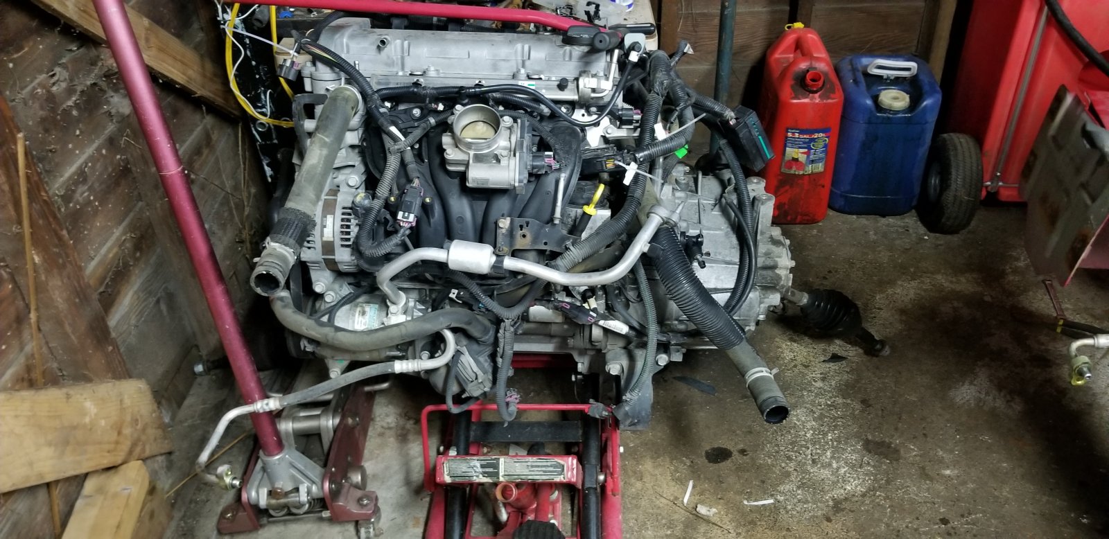

So day two engine is out. Dash mostly removed. Now almost done with step 5. I have been hopefully labeling everything

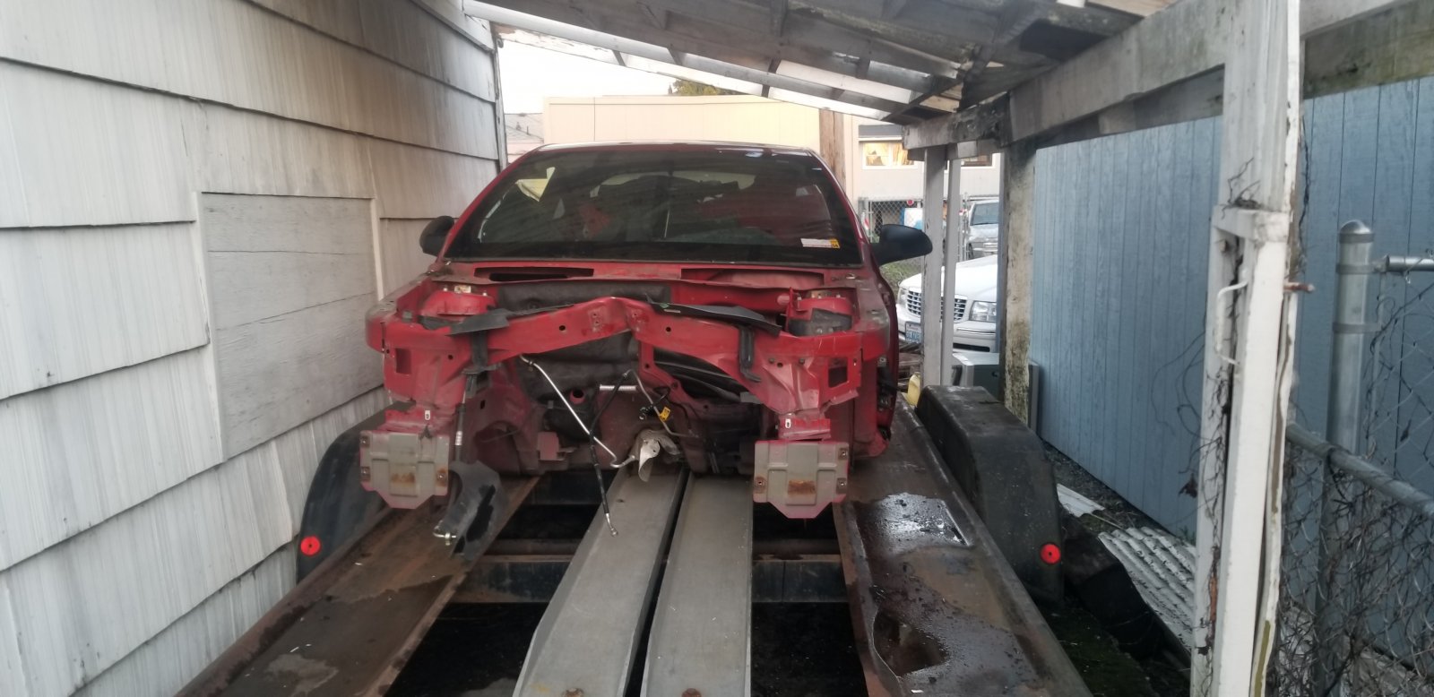

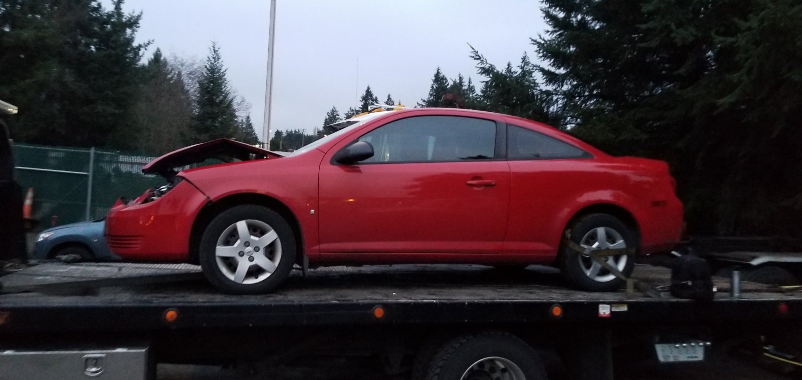

Well what a weekend. Donor is stripped of all usable parts, shifter and all parts emergancy brake and aluminum tubes and moved donor out to do the dash as I did not have room to work on it with donor in garage.
Listed parts online and sold stock steel rims to a guy with a G5
The bad is once tank was dropped found that I have the one model that the pump is mounted to the bottom of the tank so now have to sorce pump and related parts.
So now it is loaded on trailer ready to go to car heaven and become a toaster on Walmarts shelf next week.

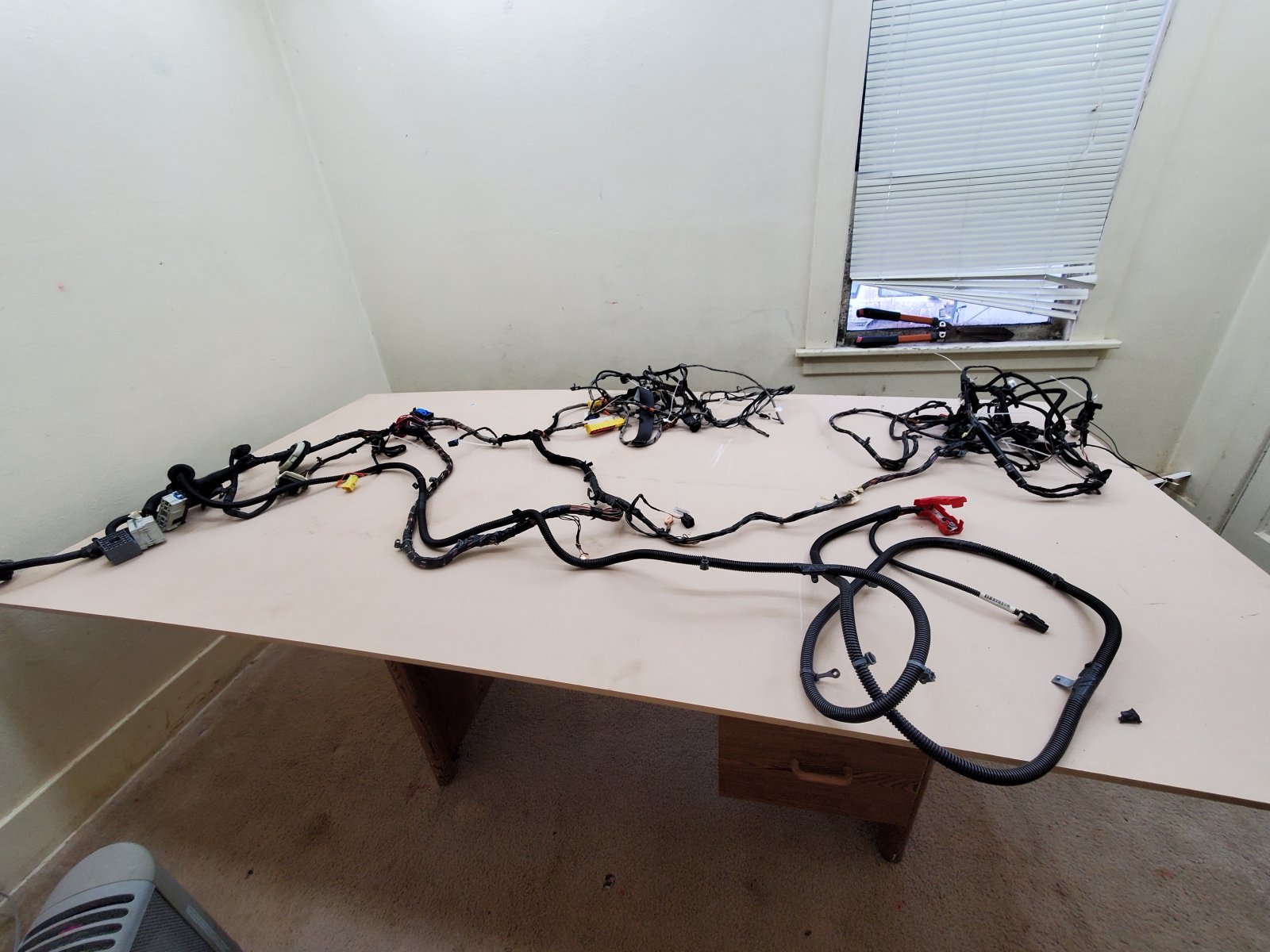

Now starts the fun. This is most likely the most nerving part of the build to me. Although I have it easy as I only had two wires going to each door for speakers no on star no abs.

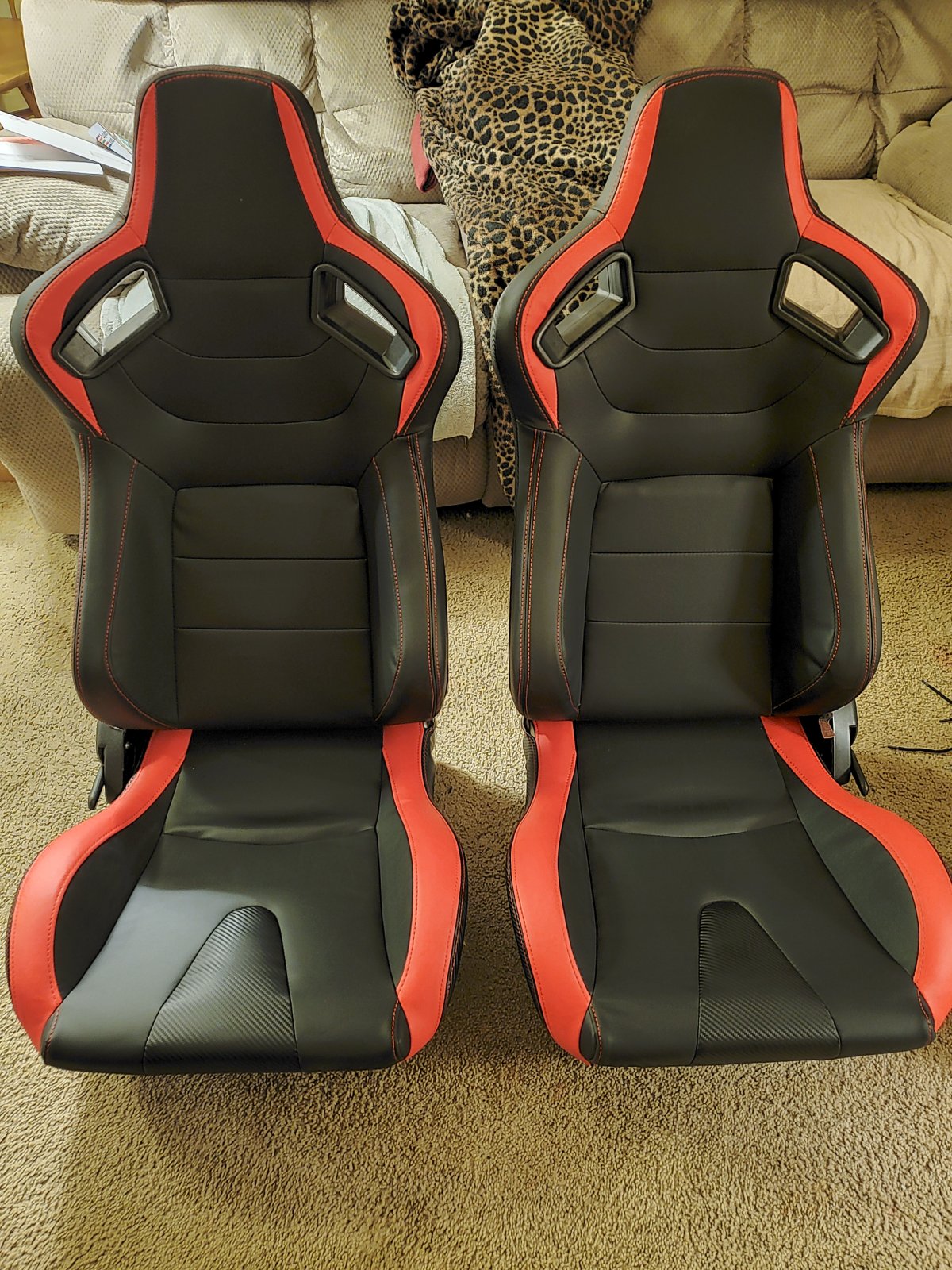

New parts are on the way so things are starting to get exciting. Picked up some wheels from work that will get us on wheels. Seats and mounts ordered and have 28 hours logged in on build so far.
Murcielago311
I got those same zip-tie labels, which were clutch.
The wiring harnesses have been my favorite part so far except for pulling off the wet, sticky electrical tape. It's been my quiet, alone time for awhile now. The new videos honestly make it really easy, it's just time-consuming.
