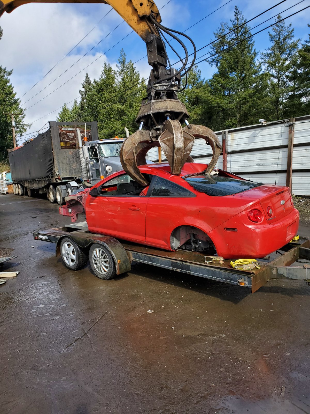

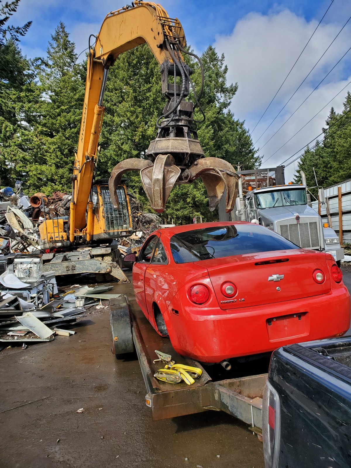

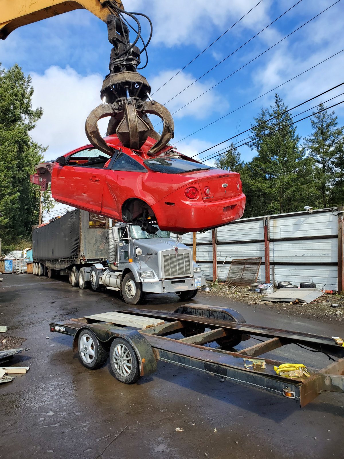

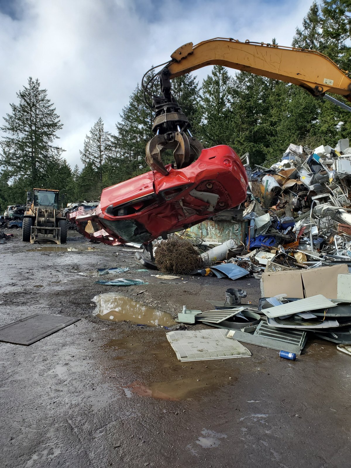

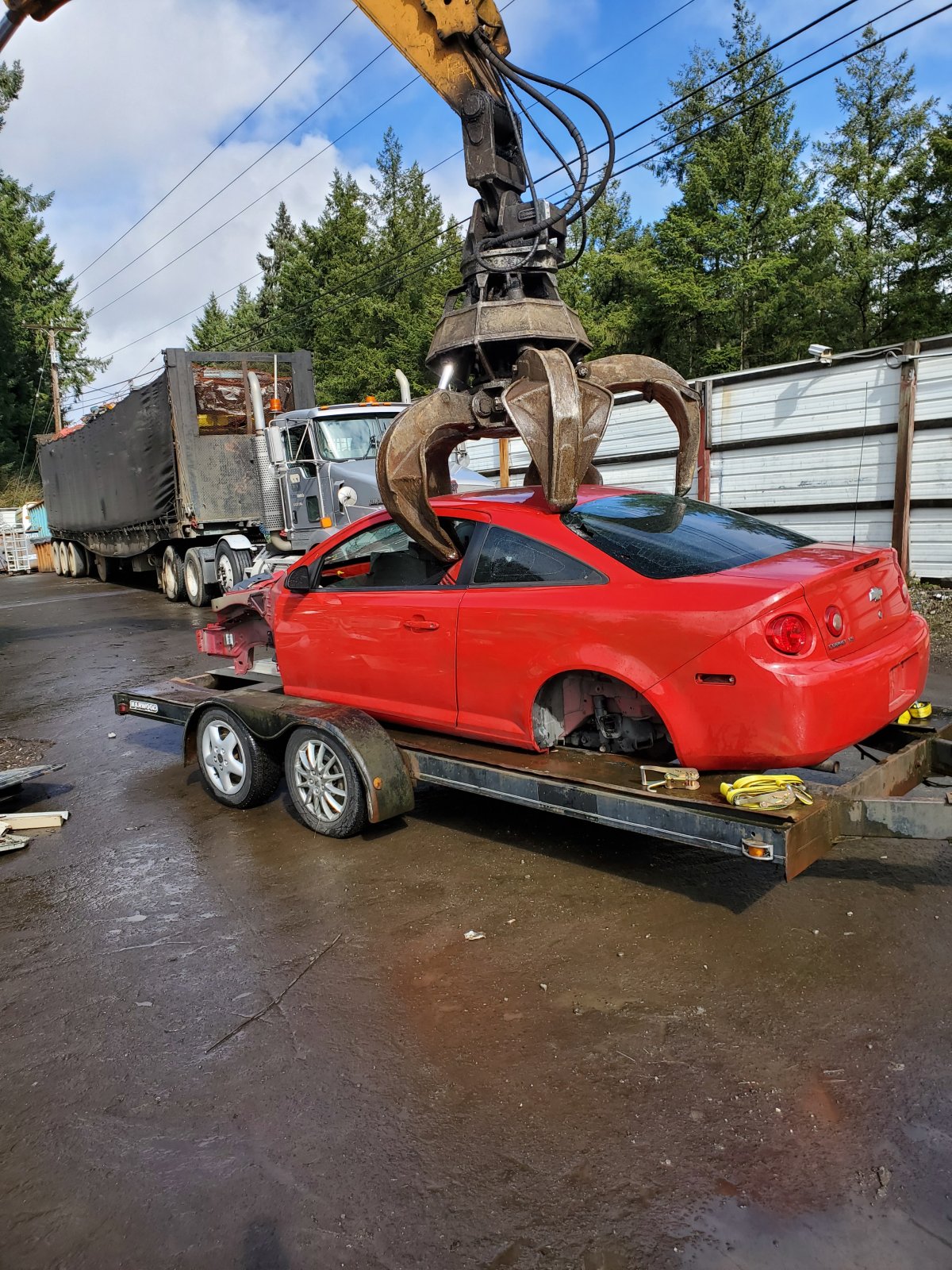

I guess when you work for the scrap yard and they know you. You get to see men turn to boys as this poor Cobalt was tossed around like a dog playing with his toy
So much gratification to see. The operator tossed and play and crushed for 5 minutes giving my wife a nice show. If I would have known I would taken video and shown that.
Remember to keep your radiator and catalytic converters separate as they bring a fair chunk of change

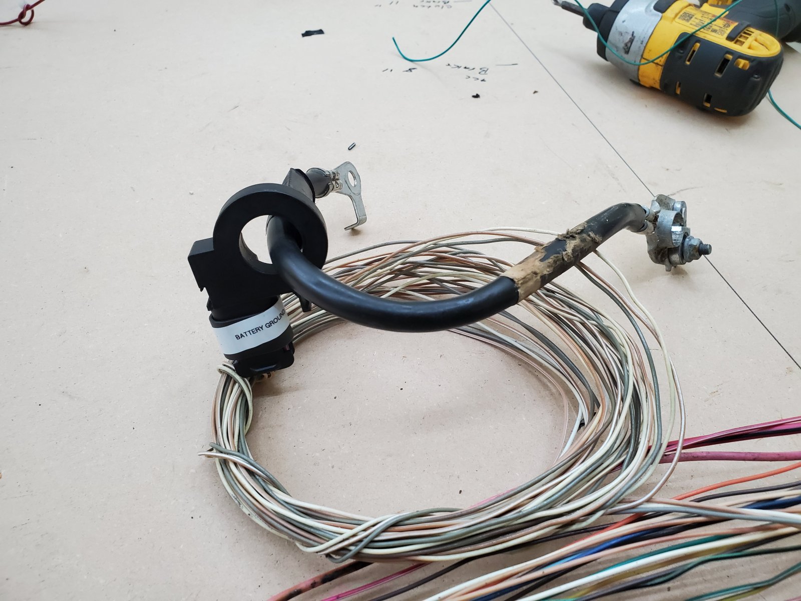

Well the wiring is not as intimidating as I thought. The only problem I have is wasting so much time looking for things that a base base model just doesn't have. However I did find this and not sure what it is. All wires run to BCM and come from the ground on the battery. It appears to be a voltage sensor
Now do all these wires get stripped or do I just leave it there.

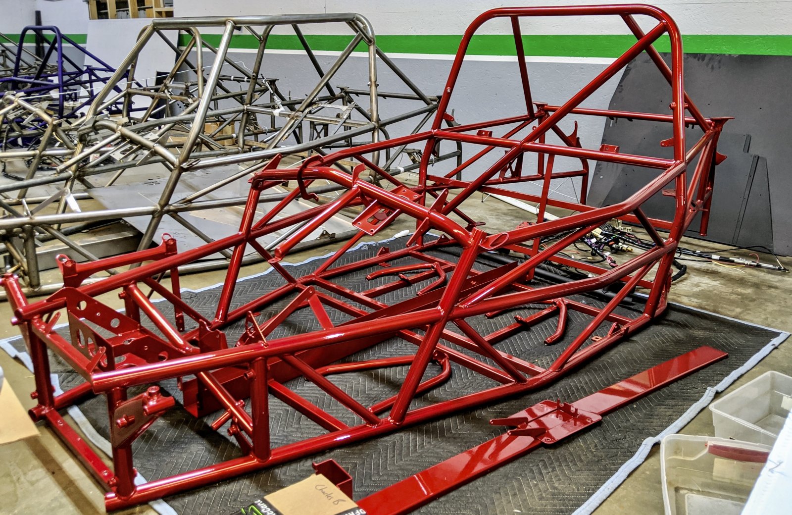

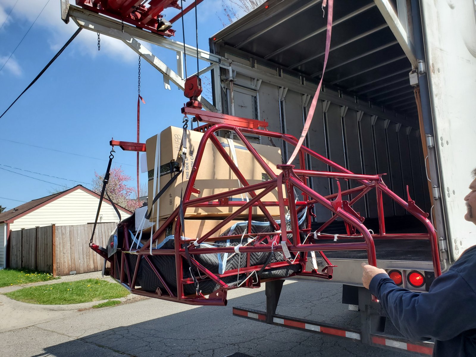

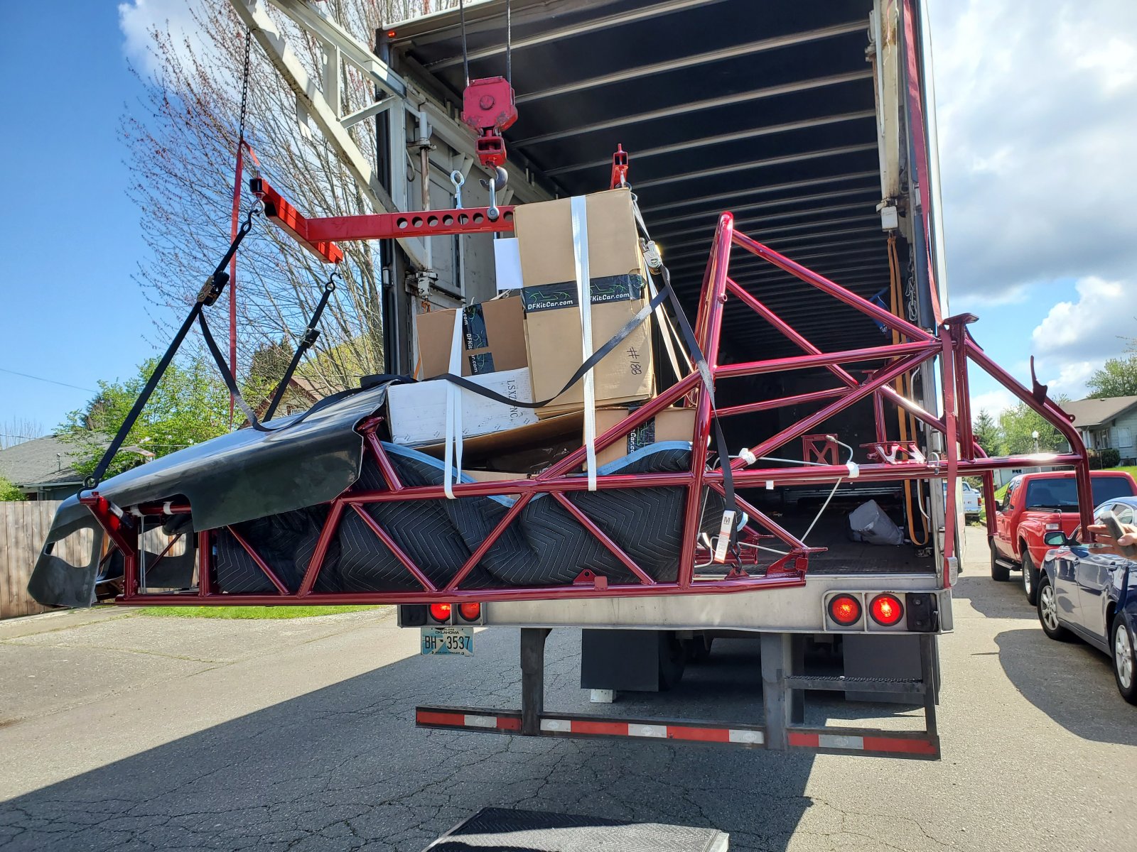

Well here it is Christmas in April. I feel like a ten year old with a tree full of goodies all for me. So much to touch and feel and smell. Most parts I can name and some I sit and wonder where does this go lol. Also had to see how some things that I ordered a couple of months back would look.
So I do need to first apologized for the last month of not keeping you all in the loop of how my build was going but I lost my Dad last month in a surprisingly fast turn of events and so that has kept me some what busy making sure my mother was all right.
So I will try my level best with what ever time I have to keep up on my posts. I have gotten all my wiring done so that is ready to go (I hope it is right and when I turn on the headlights that the horn doesn't honk or that my neighbors garage door open or some weird thing like that.
As for the shipper our driver was the typical truck driver but all arrived in great shape so I would give them a 4.99 star out of 5.

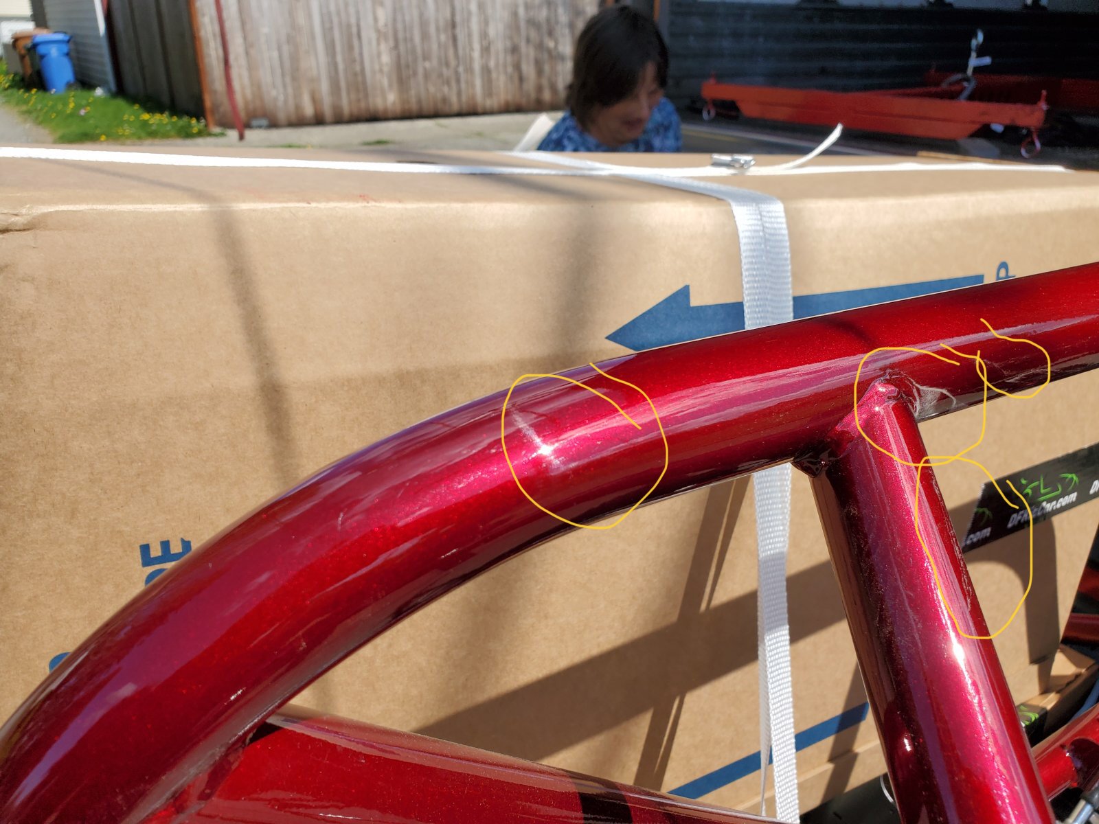

So it seems that I am not a photographer as it has been brought to my attention that I had damage on my chassis from the shipping. Totally not true.
The sun was out we are in the midst of a covid shut down and a Factory five truck blocking a street in front of my house tends to draw a small crowd. Really hard to practice social distancing with that going on.
What we see in this picture is a reflection of the white crane system that is letting my car down from the truck. I first took this photo to send to my wife to show her the color as she did not like its color in the only photo I had before.

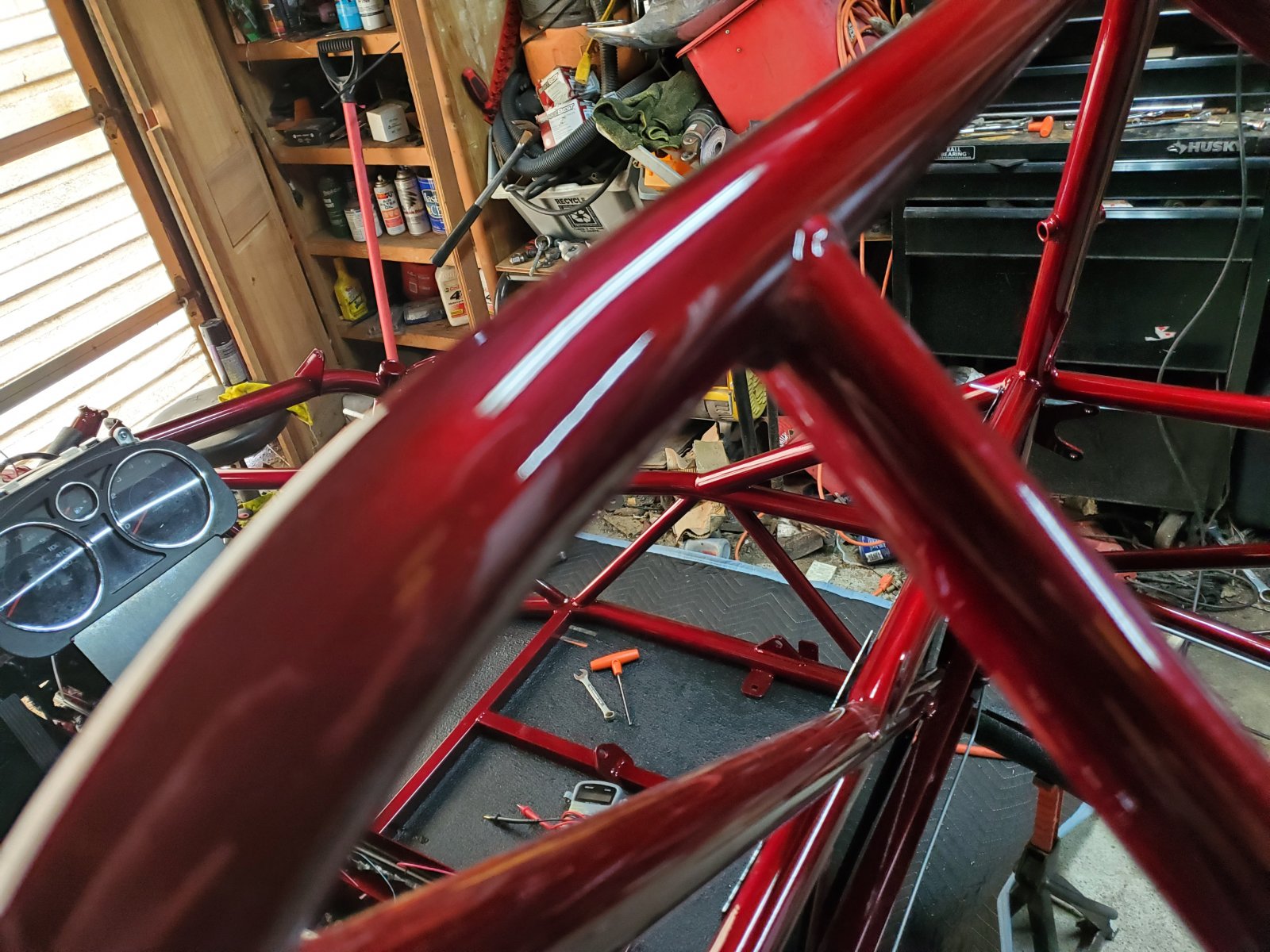

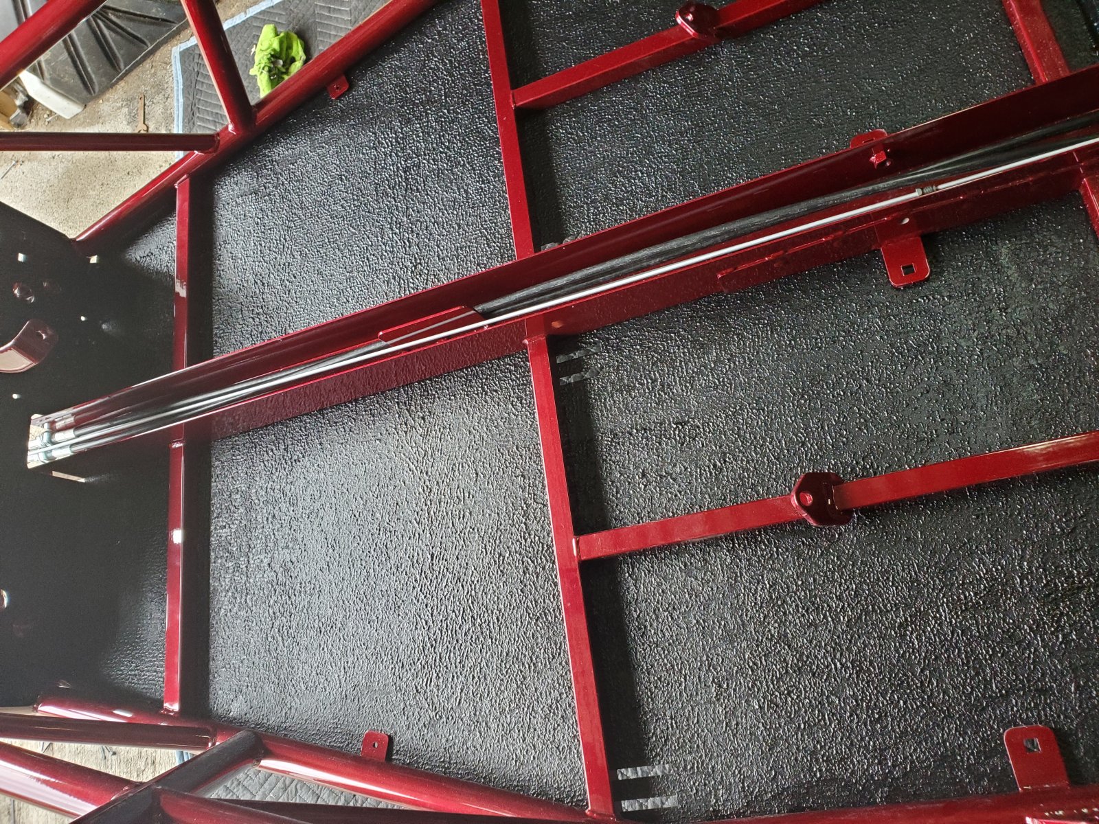

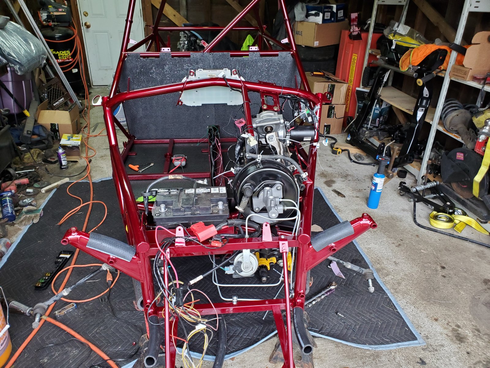

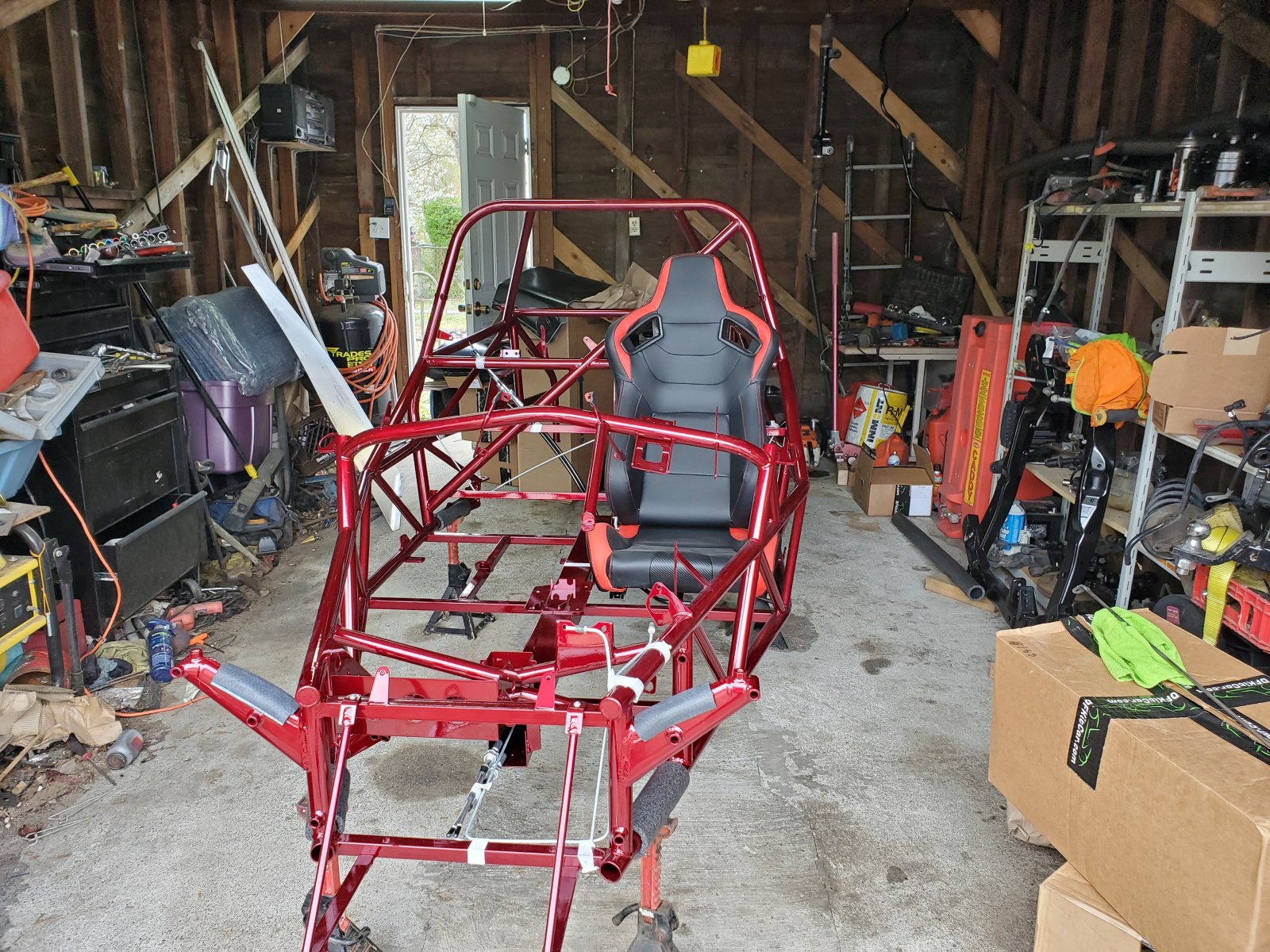

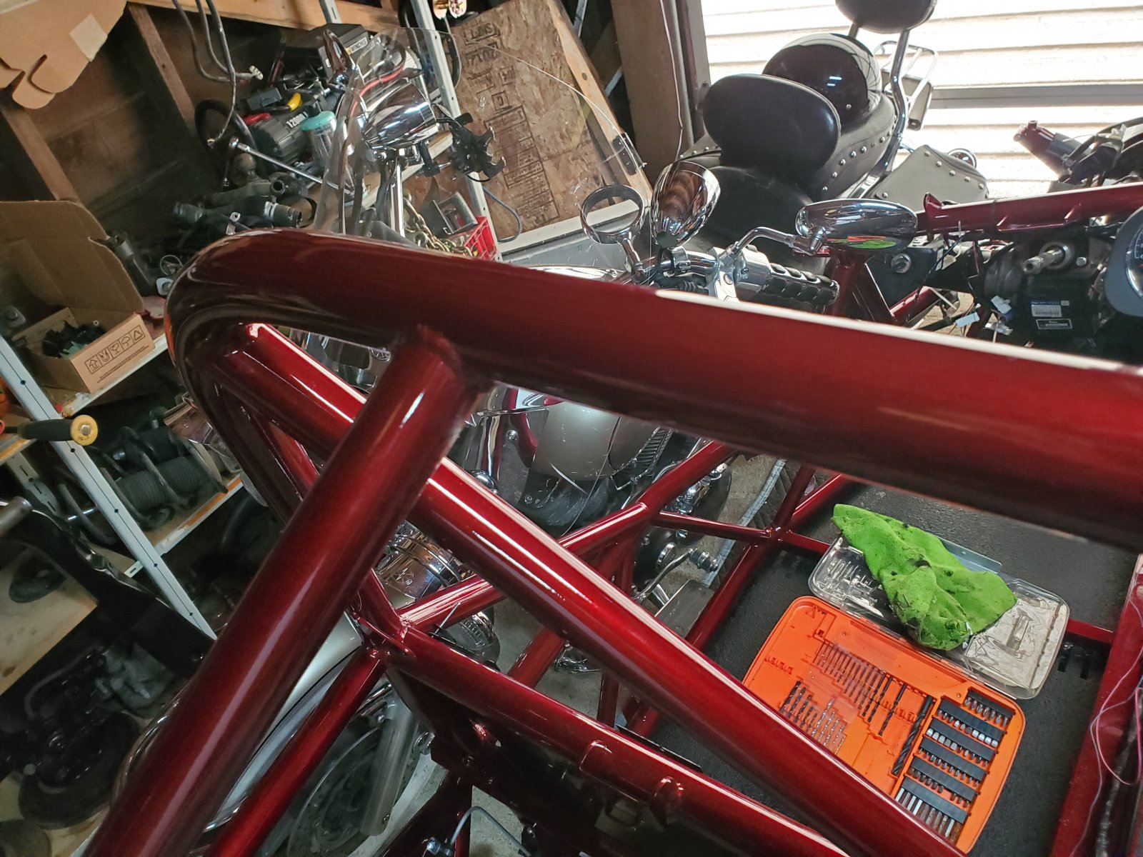

Yesterdays progress was good. I took this morning off to deal with other issues but back out to my toy room thought I would share some of my progress with you now that the motorcycle is out of the way.
I was in hopes to have first start today but that most likely will not happen but looks good for the books tomorrow.
