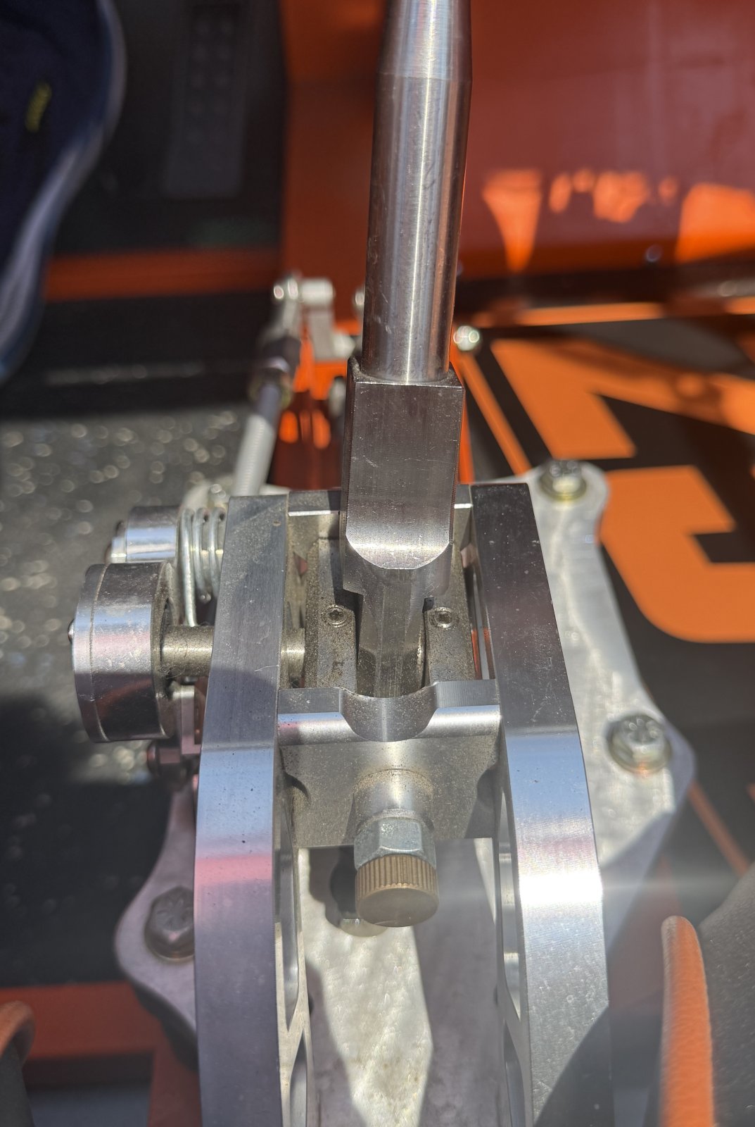

Possibly. I just looked at Mike Sno's old for sale post and saw what they looked like for the first time. I feel like I would eventually break the reversers or something in that mechanism.
How is the travel left to right? Is there enough for one more gear?
I wonder if I would need longer cables. I feel like the F40 shifter atop the trans sits higher and that takes up some length.
I would say pretty good. I can push past 5th gear pretty easily

Here’s a picture of it in 5th gear
When I get outside, I can grab the shifter and see how far it cycles and such. Being on the bench, it should make it easier to see how far left, right, up, down it goes.

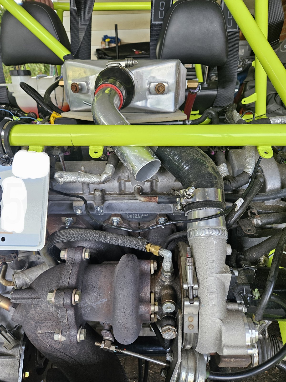

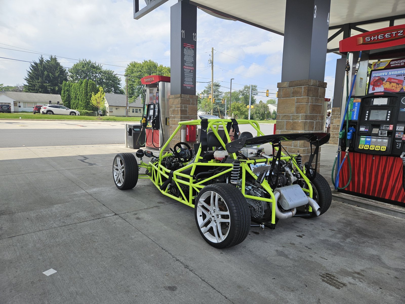

#2 - see picture. Yup. It did a thing. Probably because I didnt tighten the clamp. It did that in the parking lot before the drive and I didnt notice it right away.
#3 - First trip to the gas station. Have to make a maiden voyage at some point. Right?

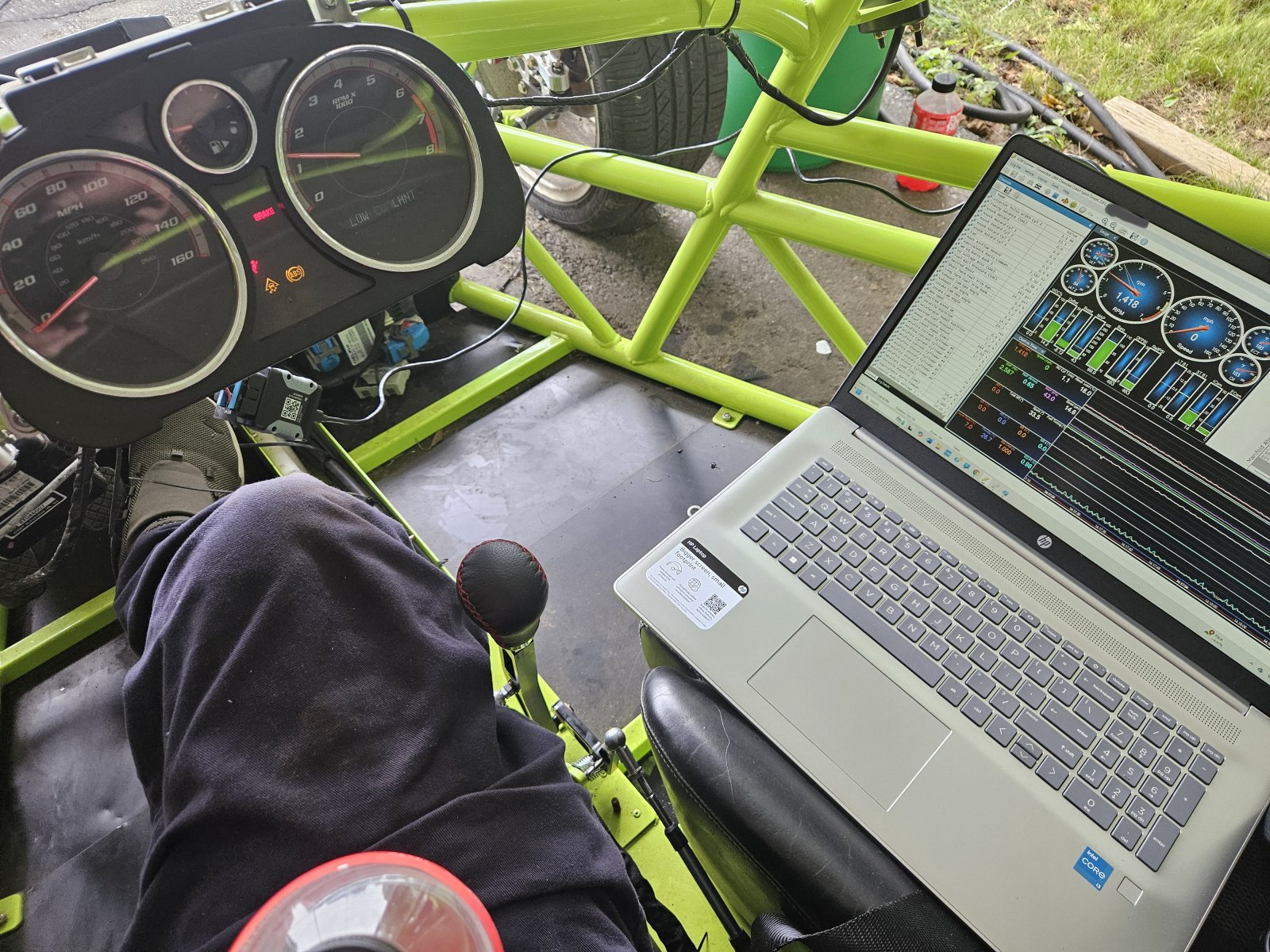

#8 you need a passenger for tuning, or you risk losing the laptop. Scott volunteered.

#2- air filters are for wusses :D
Oh snap, I didnt notice it when I got gas. I literally took a picture of it and didnt notice it disconnected.
SS/SC guys be like A2W? Outside of your intake manifold?
Blew off the charge pipe before I even got to data log. I wondered why the car was a turd for the entire drive, came home and had a good laugh.
Also forgot to connect the speed sensor, so I just followed traffic. (I was probably going 10 under)

#8 I used a bungee around my laptop to hold it in while driving be careful not to put too much pressure on the usb port though I broke a cable luckily not the laptop replaced with a 90° usb from a night vision riflescope and it sits against the seat much better

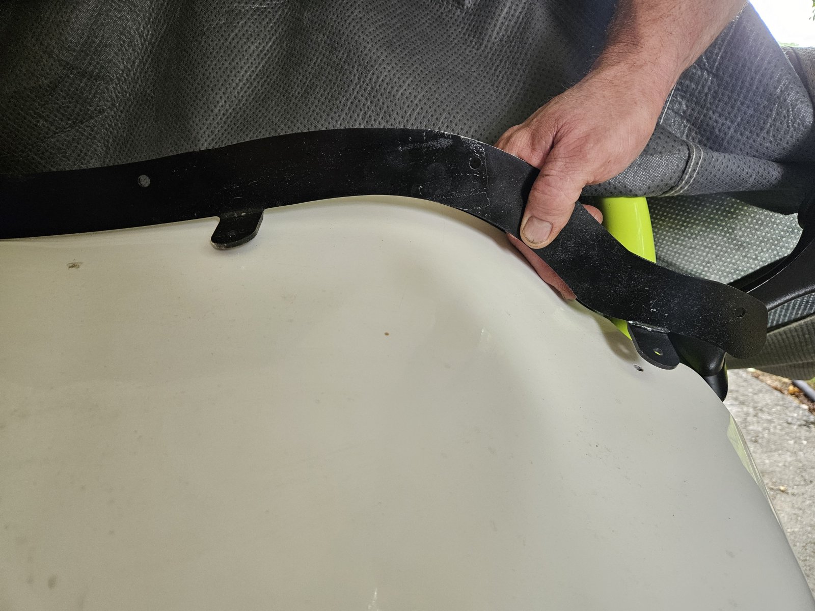

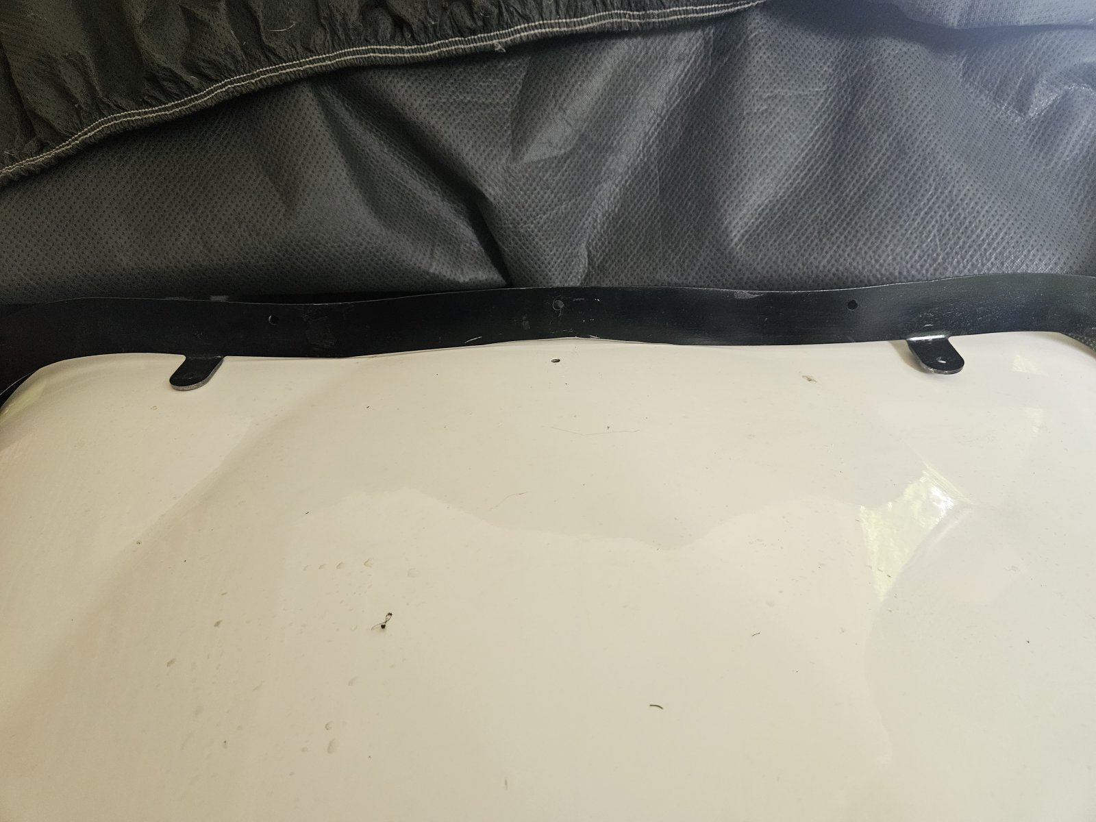

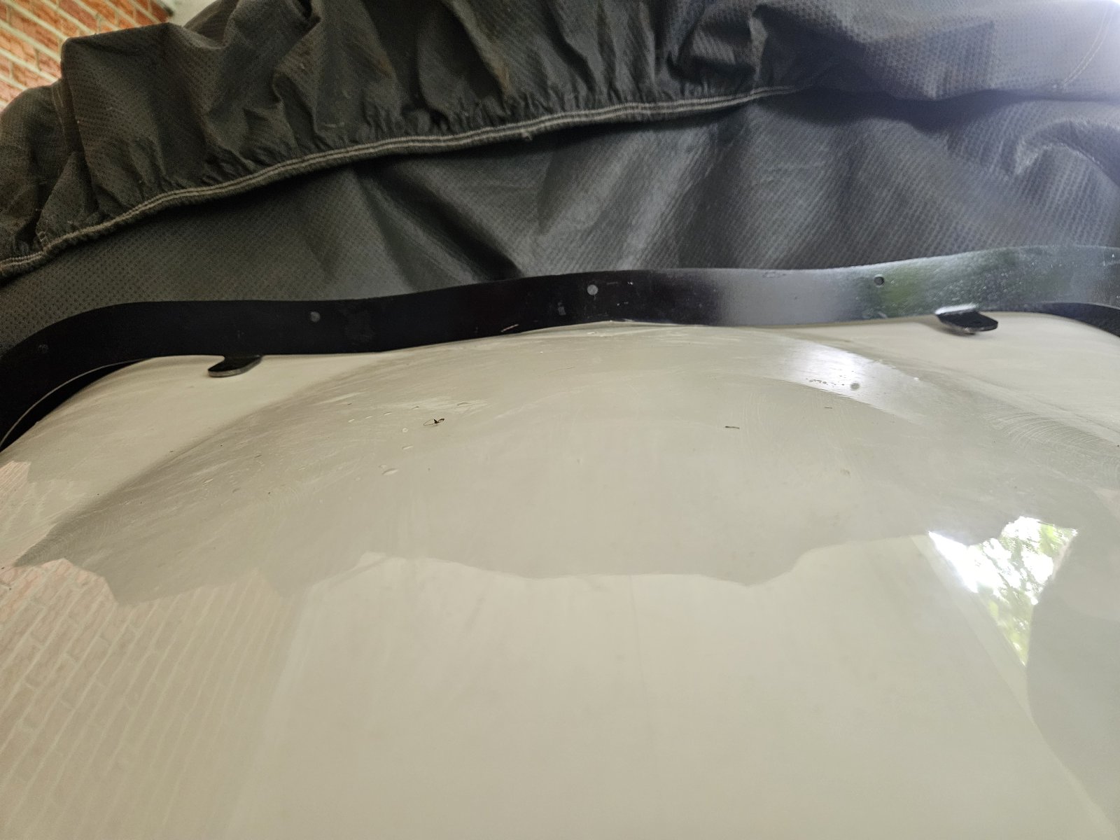

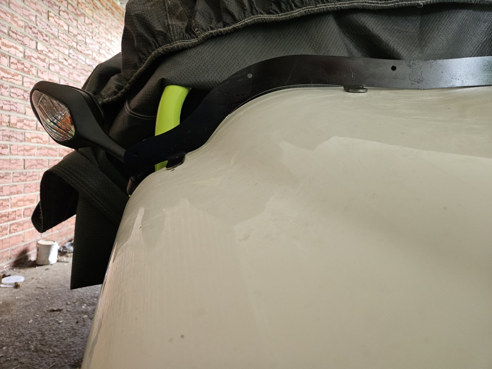

Whats up with this windshield bracket? Its not close to fitting, high sides in the center.
Figured I'd try and fix it by cutting the center tab off because it looked like that was the problem. Didn't help. The bracket just looks like its not cut right.
Im going to email DF and see what the deal is because this is making me grumpy.
Lol, email, yeah right.
It's more likely the fiberglass hood isn't right since it's tough get fiberglass just right once it leaves the mold. Not that it changes your problem. Easiest fix would probably be some spacers shaped like the mounting points (or larger) to raise it up so it doesn't hit.
comegetjoe
It's more likely the fiberglass hood isn't right since it's to get fiberglass just right once it leaves the mold. Not that it changes your problem. Easiest fix would probably be some spacers shaped like the mounting points (or larger) to raise it up so it doesn't hit.
Ill try out some stacked washers and different hardware.
