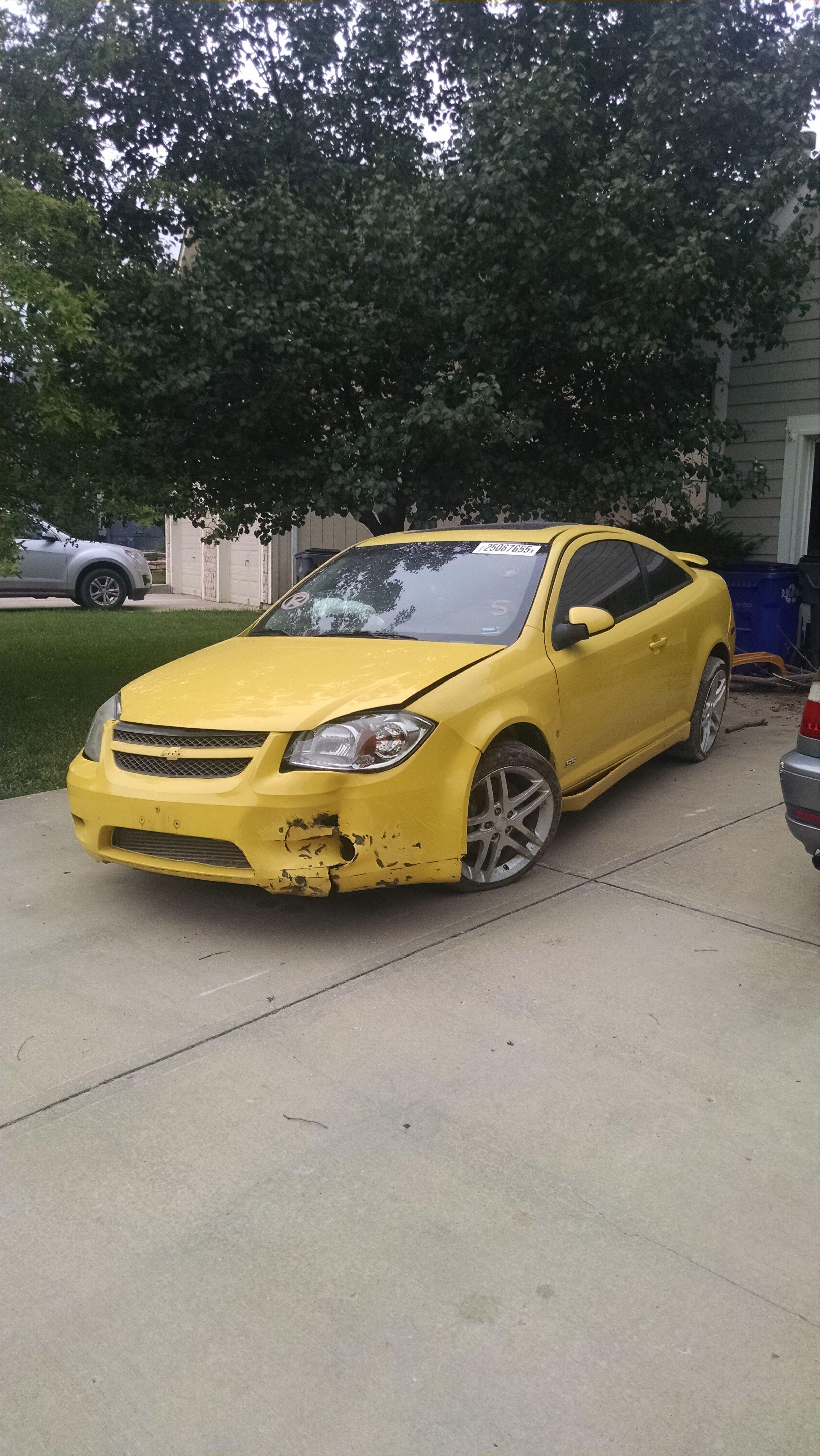

So, this is my present? ??? (there's a backstory)
Hello builders, I'm John and I'm looking forward to a lot of work and questioning my sanity.
I know I have other photos, need to start keeping just one repository though. When buying your donor, keep in mind that color can affect the ability to resell body panels. :-[

Is that an 08, 09 or 10? [EDIT] I saw your other post that says its an 08.
How many miles does it have on it?
BTW, I bet that when you give people rides in your turbo Goblin, you won't be the only one questioning your sanity. It's going to be wild.

Adam, mine is an SS '08 donor with roughly 98k miles. The previous owner apparently mis-judged the tire performance in a muddy situation damaging the left front, but didn't seem to get to the heart.

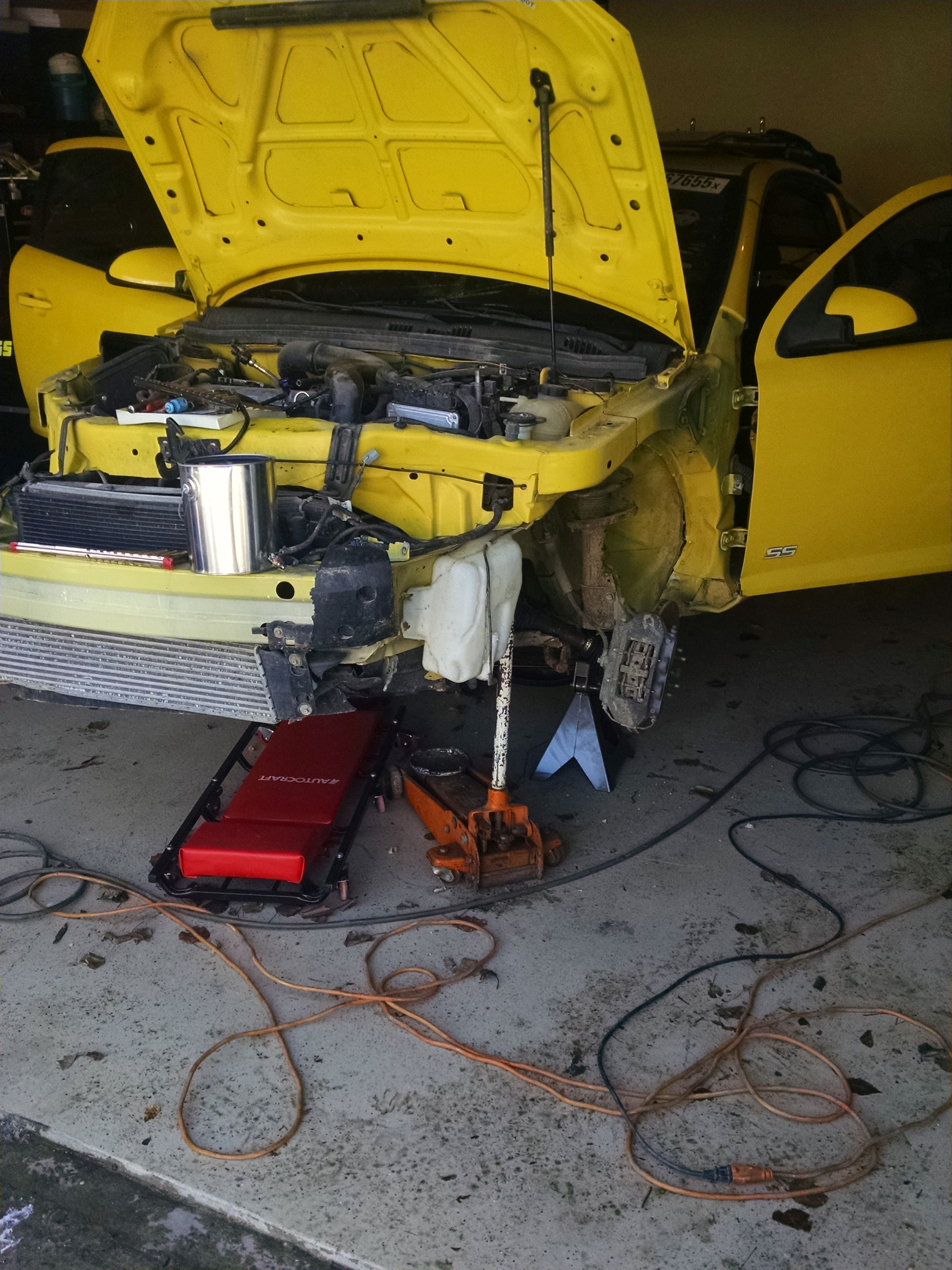

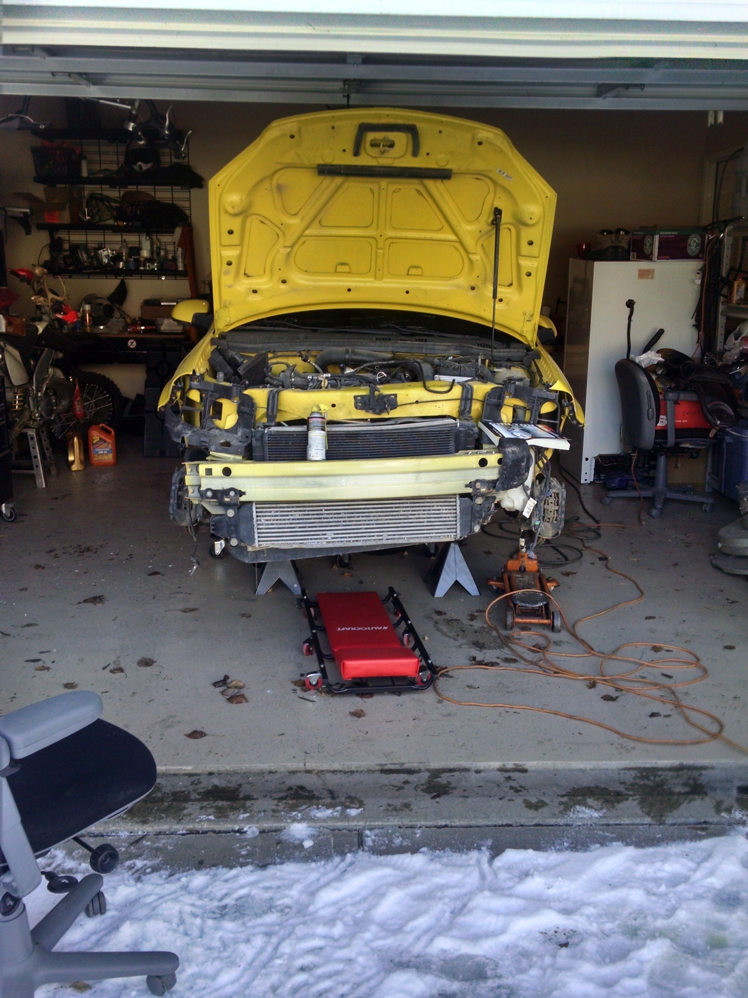

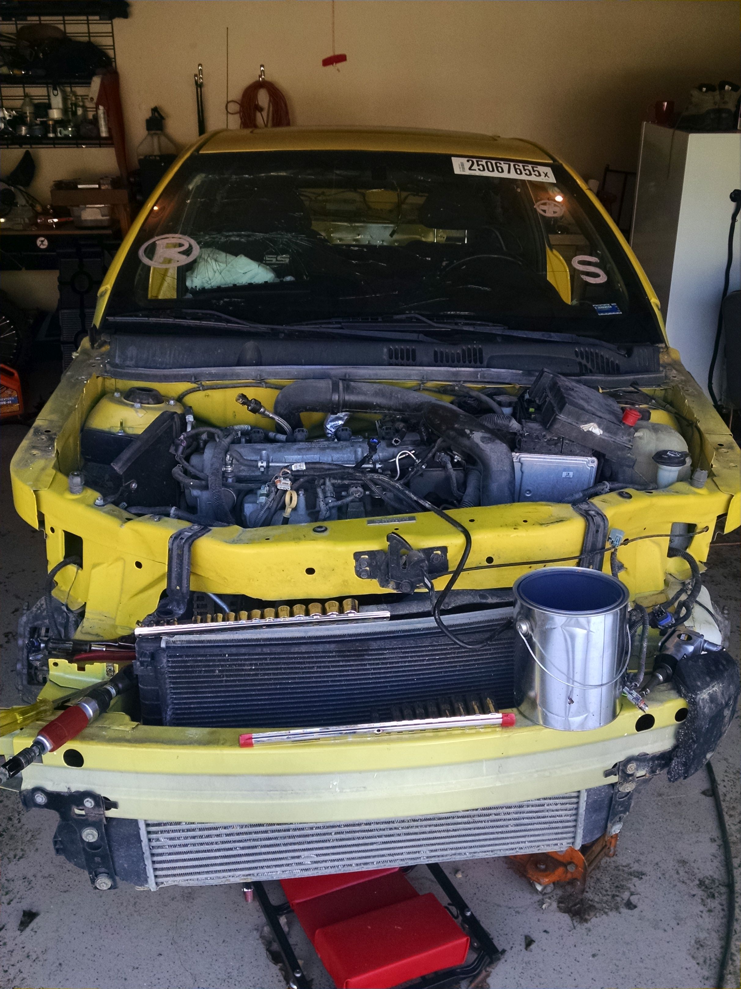

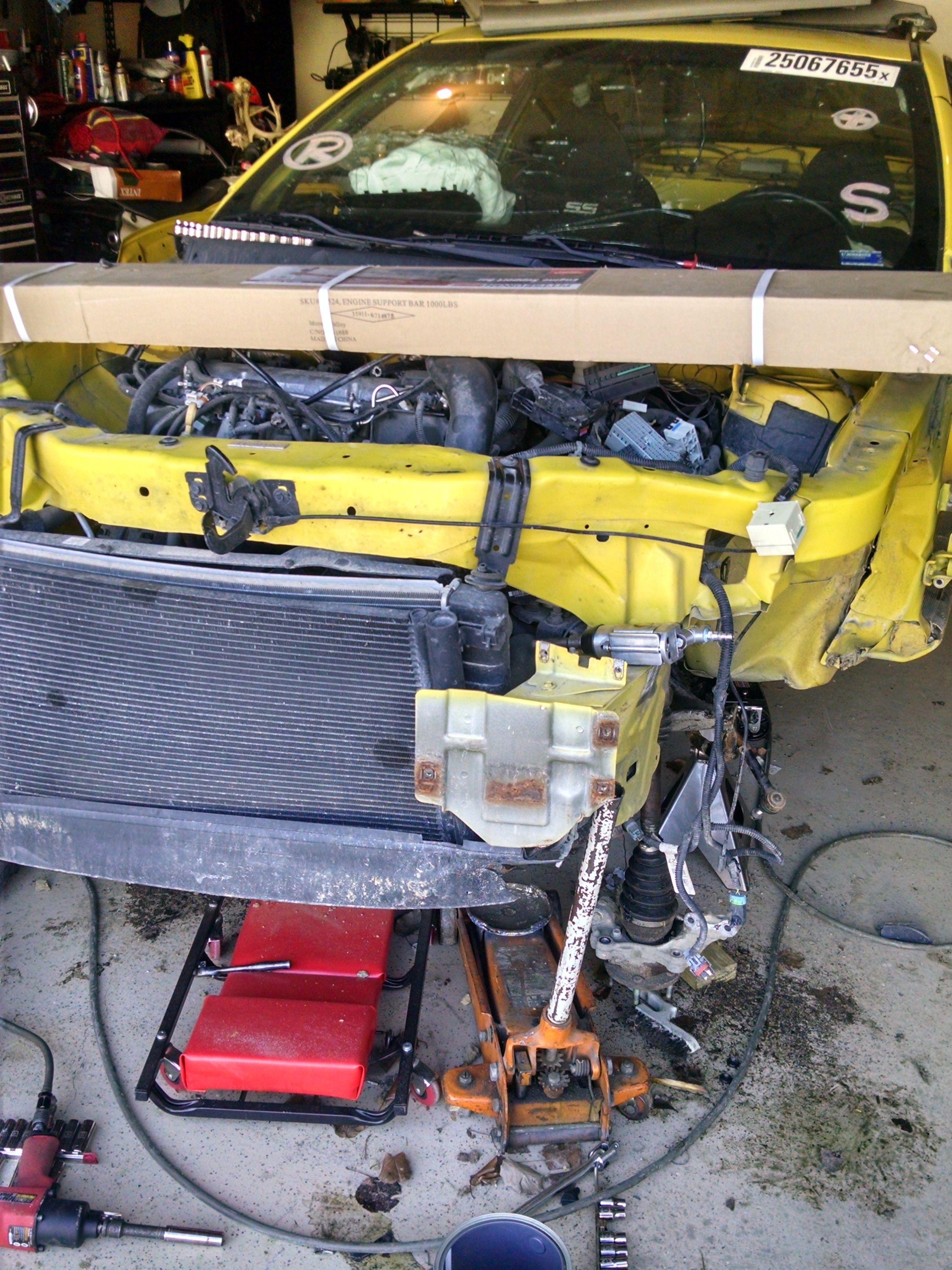

Here are some of the photos from the disassembly...with only one uh-oh moment.

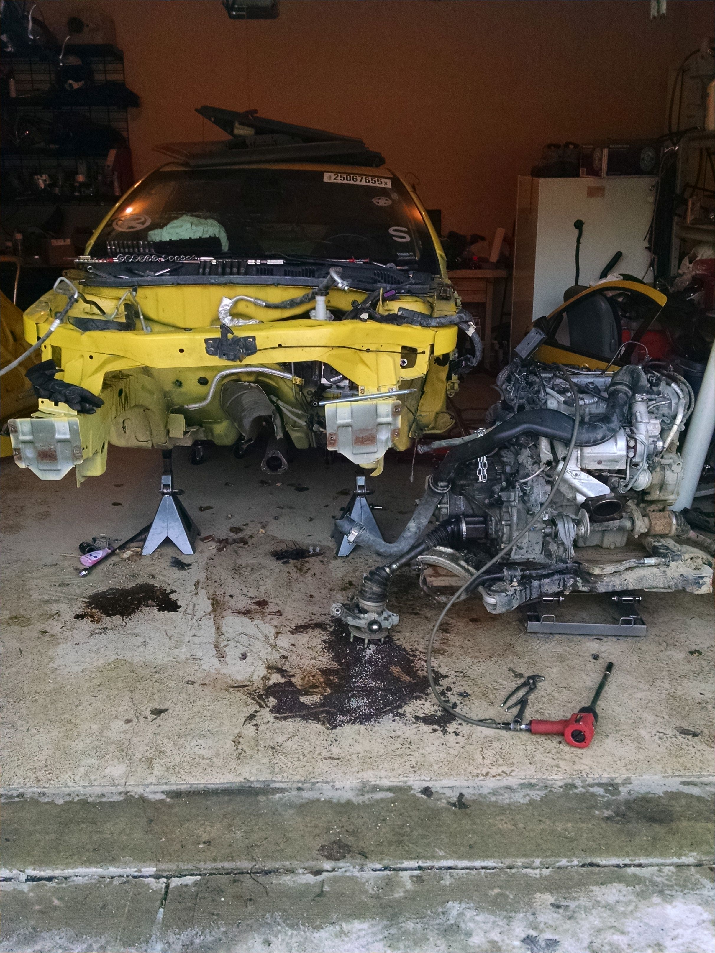

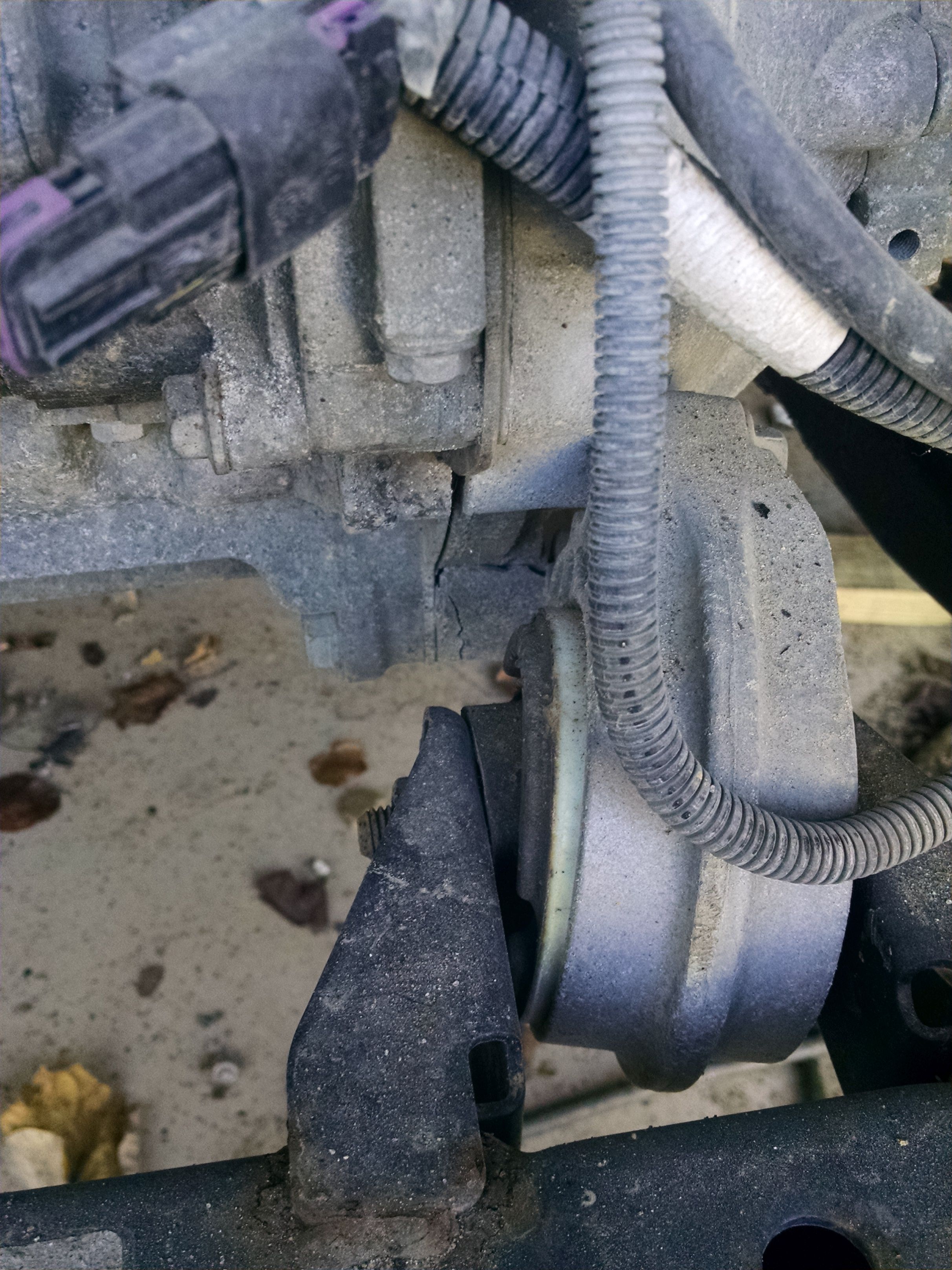

After pulling the cooling assembly off, I noticed this...well, I wanted to take this apart anyways... :-[
Justinreed7
Hopefully it only broke the mount and not the tabs on the transmission. Those stock mounts need to go anyways. I recommend Powell Hard Core race mounts. John powell worked with GM to build the cobalt time attack track car back in 2005.
Jkean949
Adam, minor complaint...the system logged me out halfway through my initial reply and lost what I had written. I have now changed my account to leave me logged in. May want to have a pop-up that declares you are close to logout or something?
Justin, I'll keep them in mind for the build up. The stock mount in the '08 SS was more than just a rubber/poly mount (at least on the passenger side) it actually has a hydraulic component with an expansion chamber. That's a new one on me.
No such luck with the mount being the only damage...the tranny tab is cracked too. With where the impact was the transmission has felt suspect to me anyhow. Good excuse for upgrades though! :-X

Justinreed7
You can always weld up the crack though. I bought my saturn wrecked 3 years ago and the whole front transmission tab was broke off. Since my aluminum welding skills are limited at best, i paid my buddy $50 to weld it back on
Jkean949
Hmm...TBD on how I'll approach it. To be honest, I'm a bit skittish on having that welded. I'm a hack at best so I'd be paying someone and I just don't know about the integrity of the area around the weld...anyone feel free to weigh in.

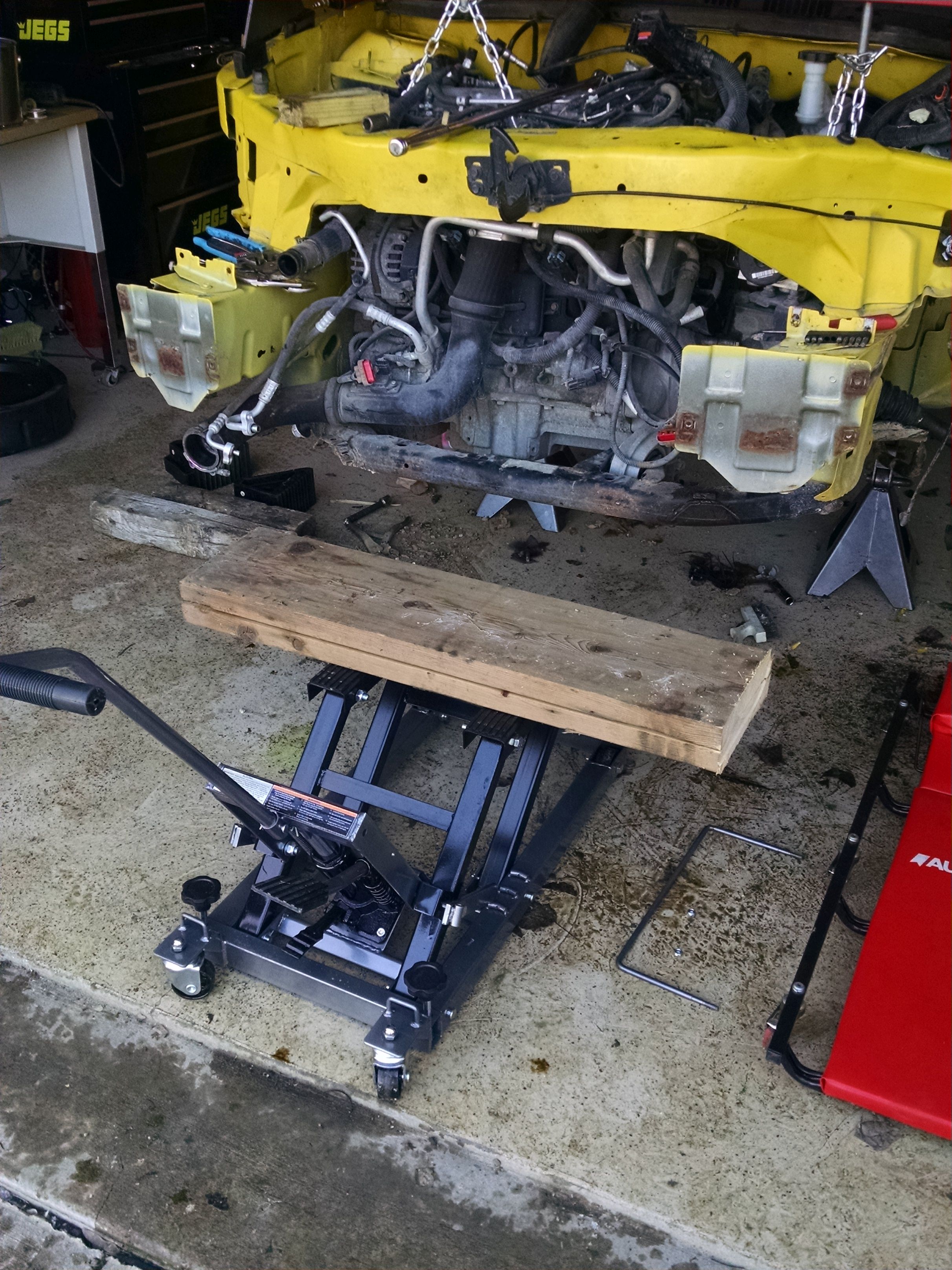

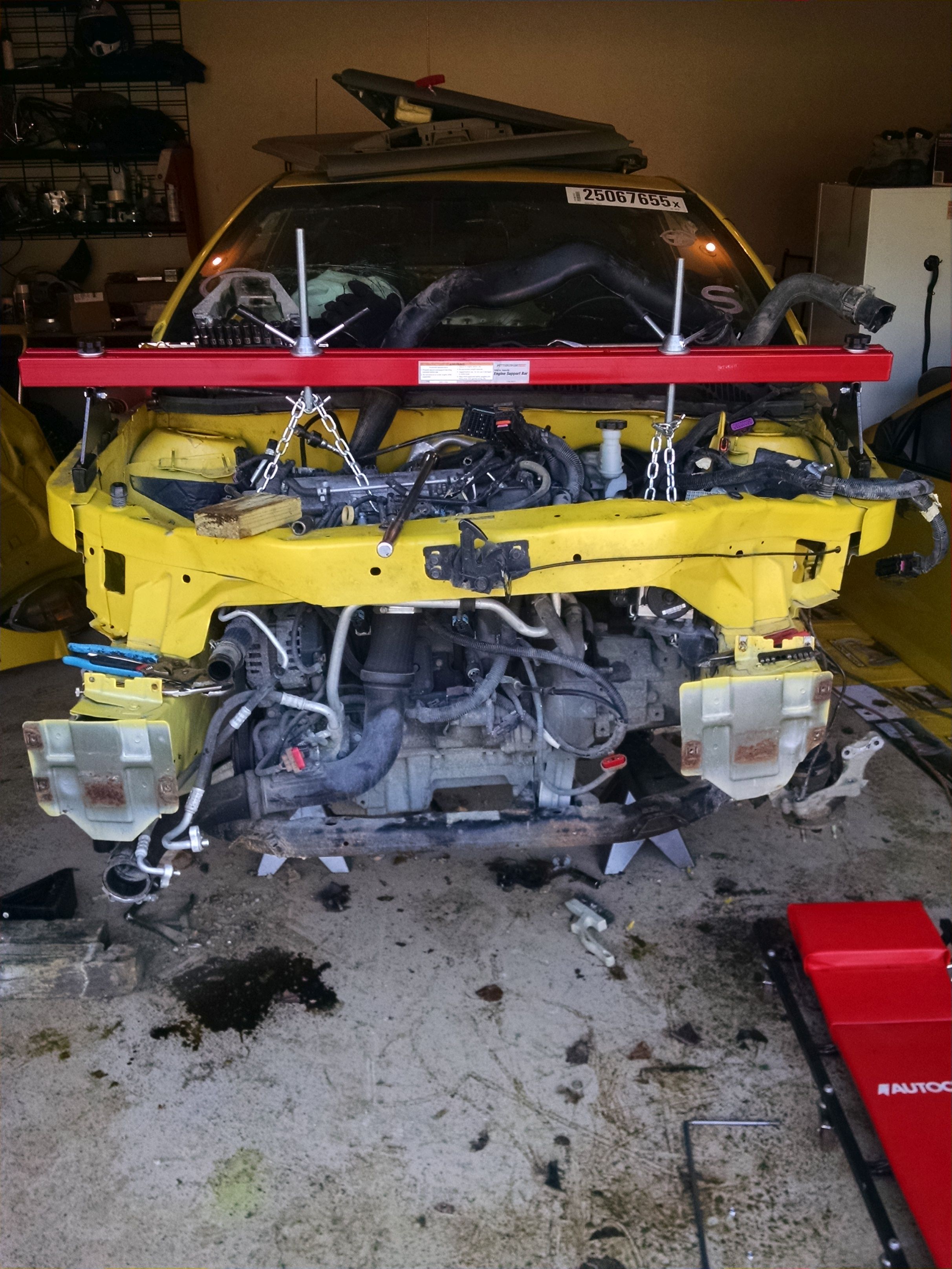

Forgot a couple of photos...

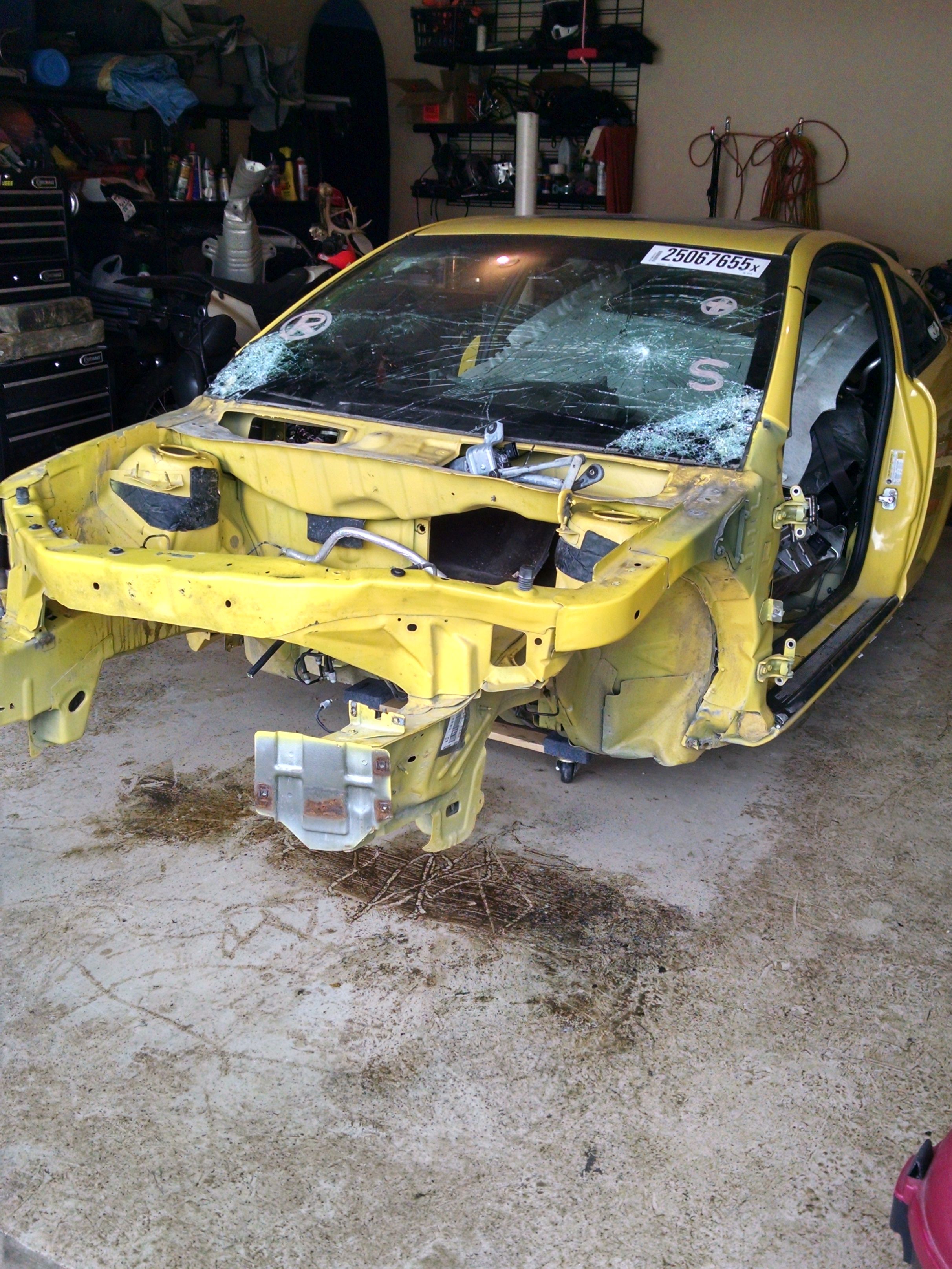

Finally wrapped up stripping the donor, the hull is setting on dollies and I am waiting for a return call from the scrapper. Note to future builders, sell anything you can individually as scrap metal prices are pretty bad right now. None of the salvage yards in my area will buy parts...hopefully others have better luck.
Jkean949
The other pic I tried loading of the hull didn't load correctly I guess, so here it is again awaiting the scrapper. I have it in the garage on wheel dollies in the rear and a furniture dolly in the front.

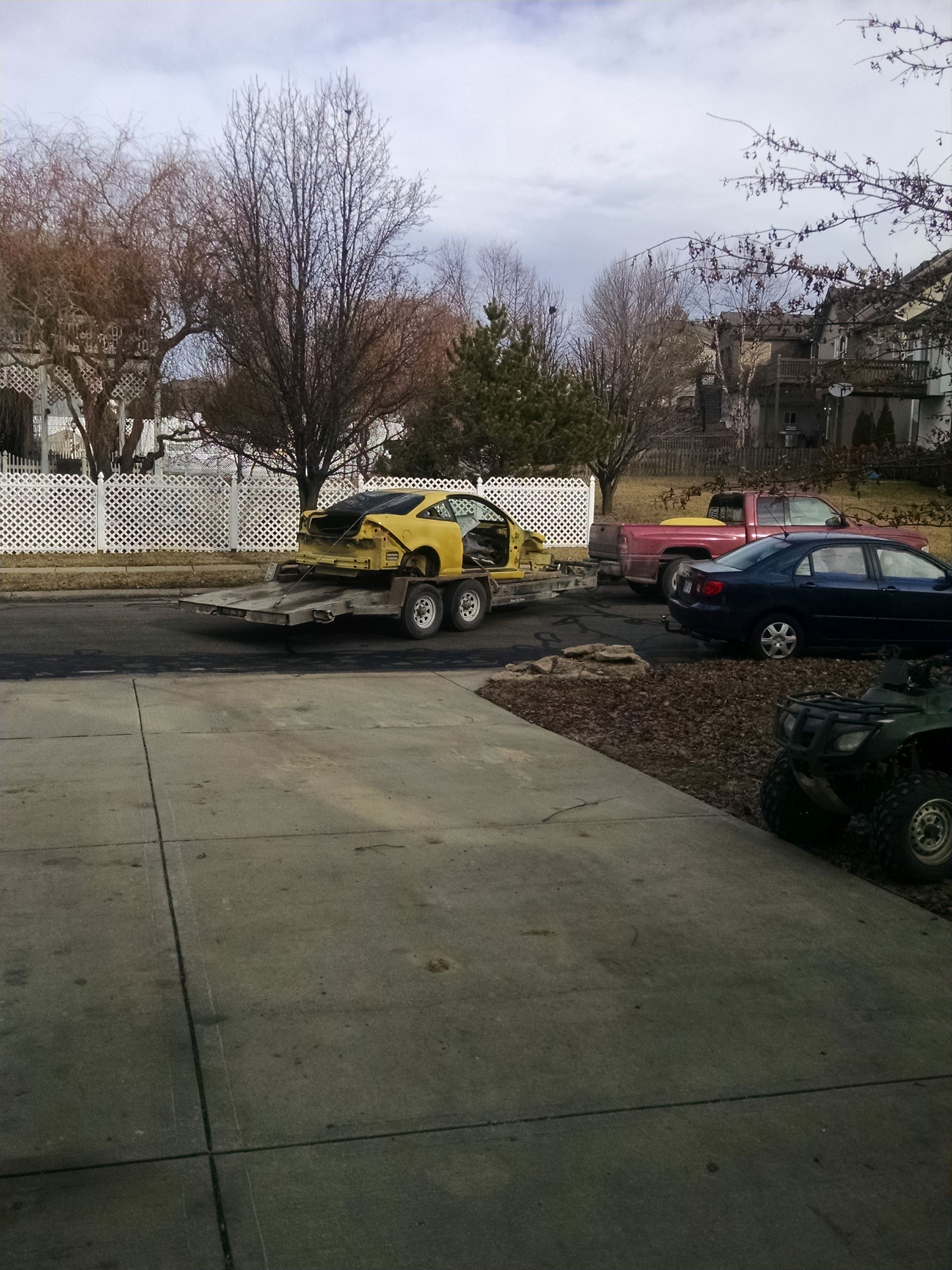

Jkean949
Bye-bye! The scrapper made it on Saturday...I am glad to have my garage space to start building the Goblin.
Others will have different experiences I am sure, but I ended up just giving the hull away. He said $40/ton and once you take into consideration his fuel cost and that there wan't a full ton of material, it wasn't worth debating with him. I am sure some of the other builders will have different pre-existing relationships and will be able to get more out of their hull, but this has been my experience.

P
John,
The best of the news is, it is GONE!!! No more worries about what to do with it. I believe where I am going to be building my Goblin, all I have to do in place a free ad on Craigslist and it will disappear. ;)
In Texas, all I had to do is place it at the curb and it would disappear by the next day.
