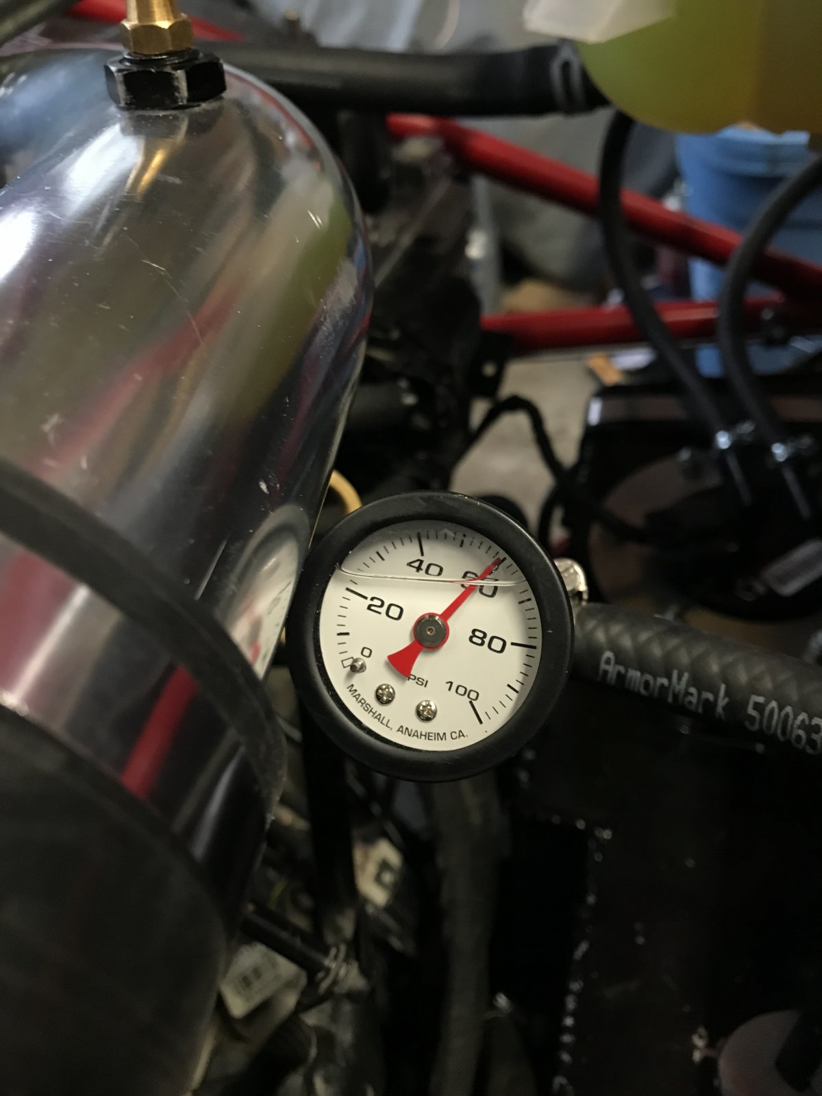

Pressure at pump right at 14 volts.
Well I fixed it....I think.

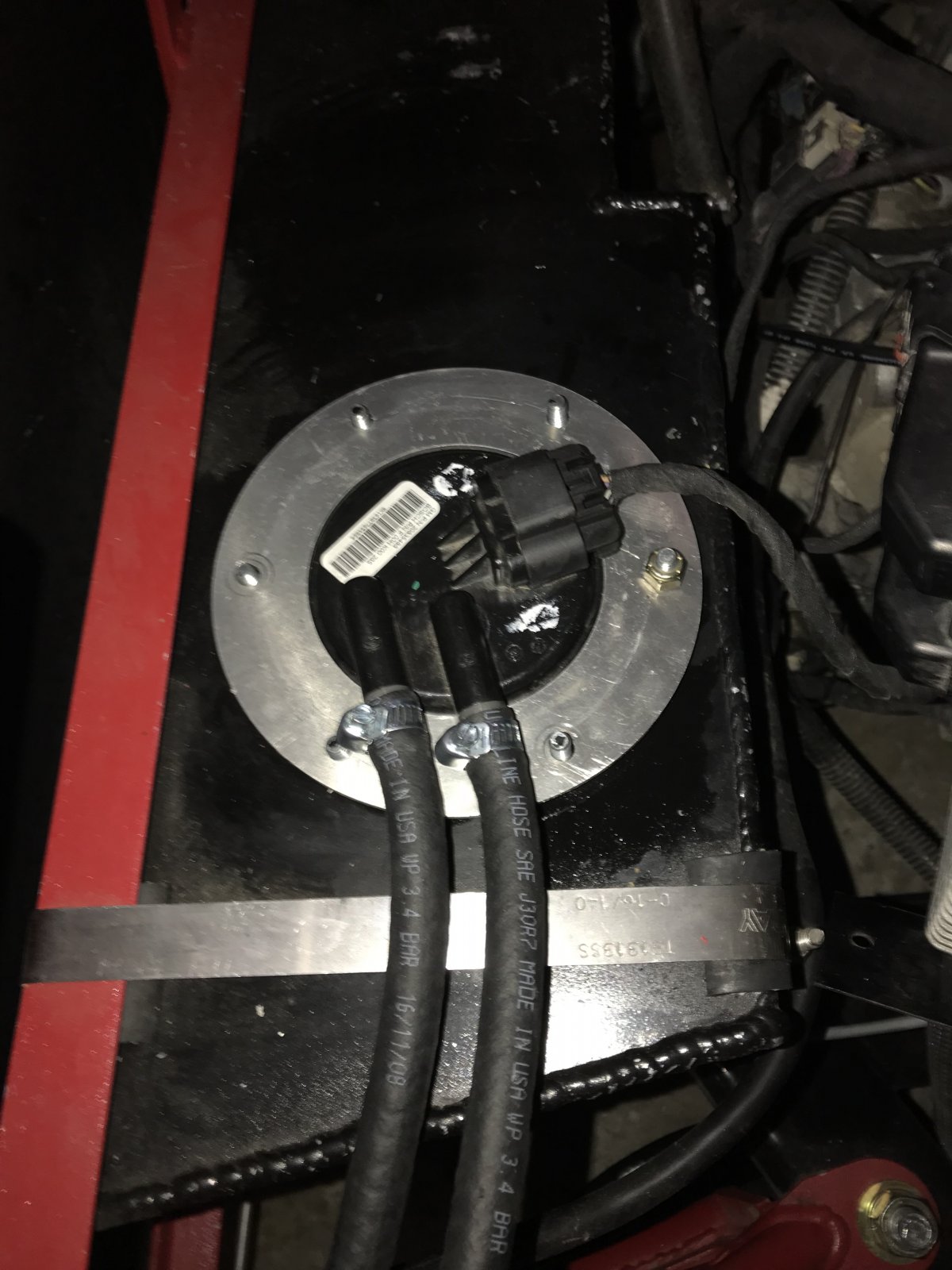

I cut off the factory fuel line. I never have liked it anyway as it is bent to a certain shape and doesn’t conform well. It was very easy to cut off. I replaced it with standard rubber fuel line and I like that so much better.

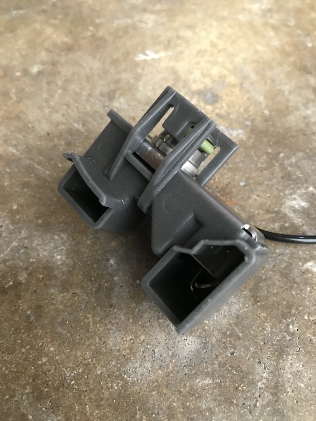

I bent the “flapper valve” out some so it would open under a lighter pressure....

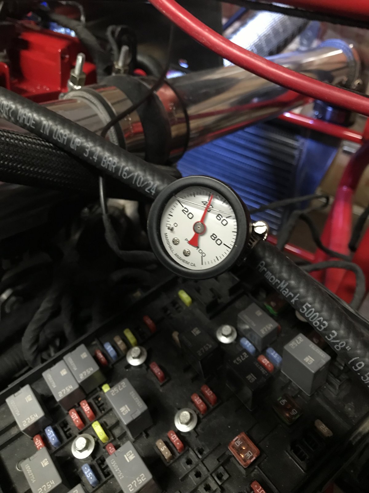

And it worked. Maybe a little too well. Stays dead on at 42 psi now.
The main question still remains....why? What could have happened in the last few months to make the pressure control valve not function properly. I took the pump completely apart. I removed every little screen filter and every housing there is. All of it was very clean and nothing visually wrong.
I hope I didn’t create a bandaid solution. But hey, if the pressure is there and remains there throughout the rev range there’s really nothing else to worry about I suppose.

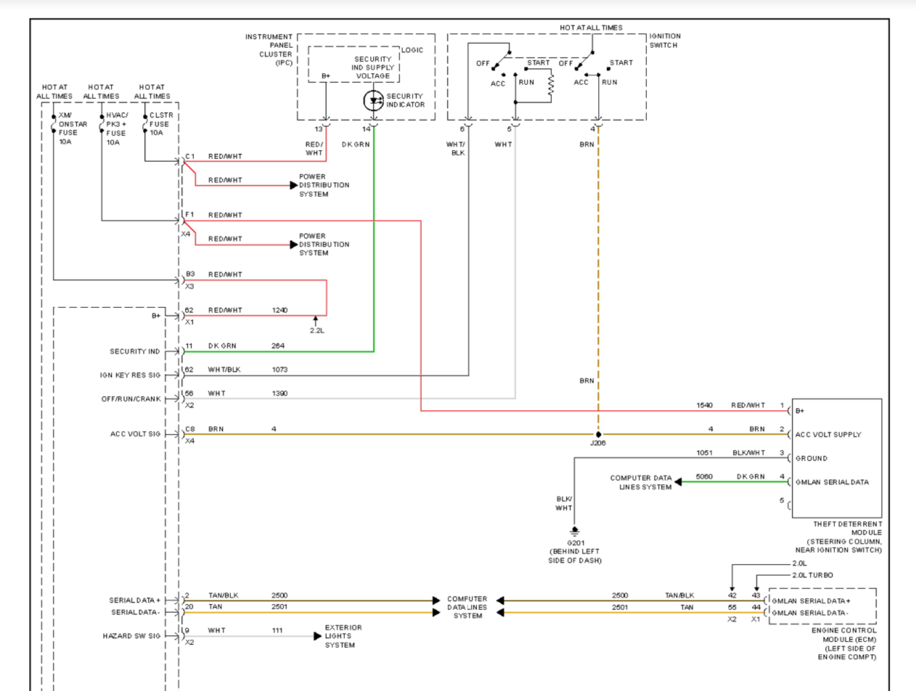

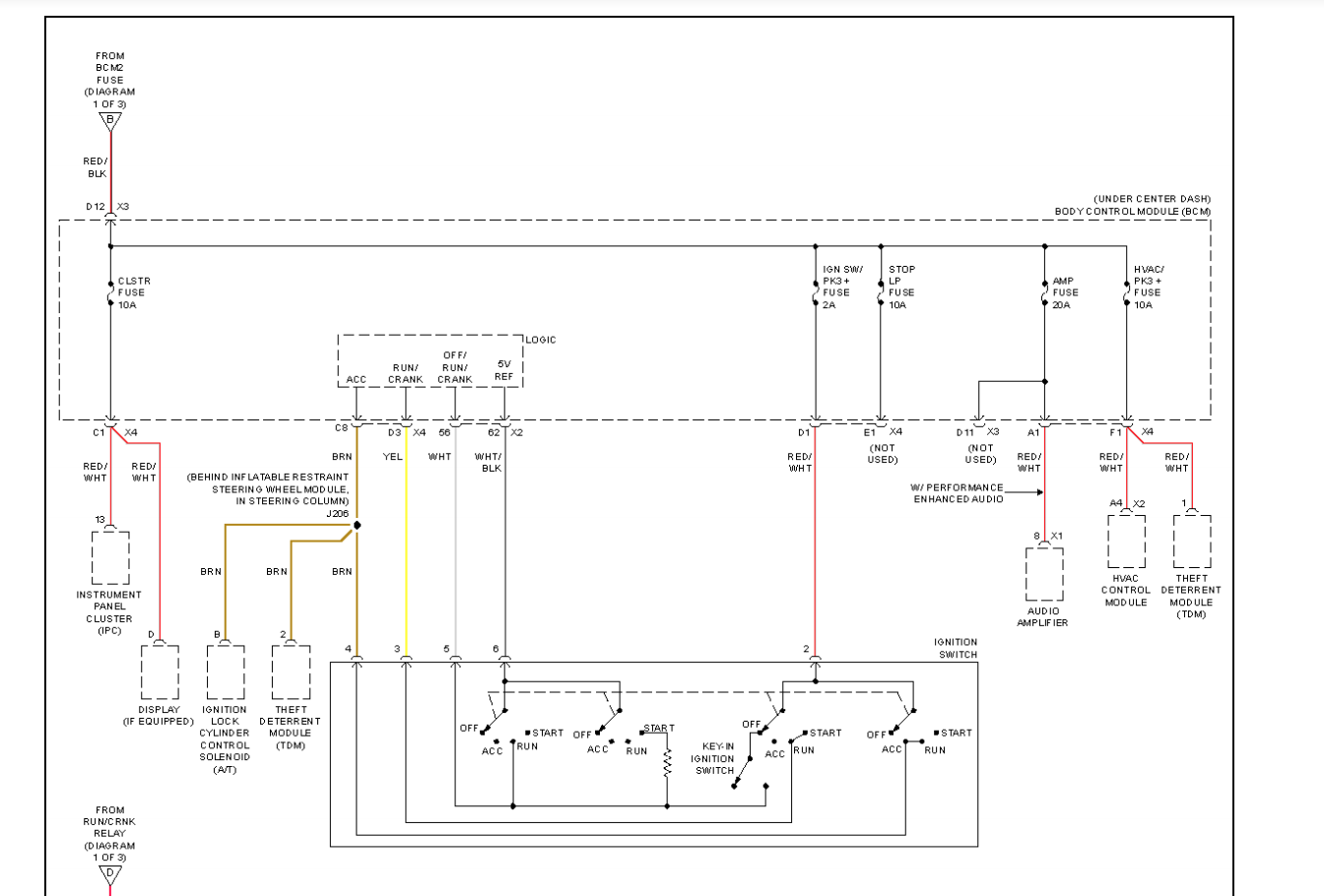

Can anyone with access to the factory manual help me out with the ignition wiring? Since Im making a full dash, I plan to attach the RFID key chip to the antitheft device and remove the ignition and install an ignition switch and push button start. Just need details on the wires going into the ignition/lock cylinder itself.
JSATX

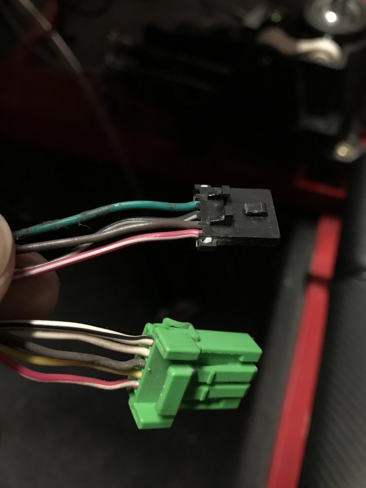

Here are the plugs. Top goes to the anti theft device, bottom to ignition
Theft= green. Black/white. Brown. Red white.
Ignition = white/black. White. Brown. Yellow. Red/white.
EDIT:
Found Antitheft and ignition. Coulda guessed what the wires were for. It would be interesting to see what the green wire signal looks like on an oscilloscope.
JSATX
My service manual says the key doesn't transmit unless it's in the ignition. I guess there is something in the lock cylinder that turns it on.
Well the anti theft device is powered by accessory power. So I think it’s more to do with that than actually being in the ignition. But thanks I’ll keep that in mind
