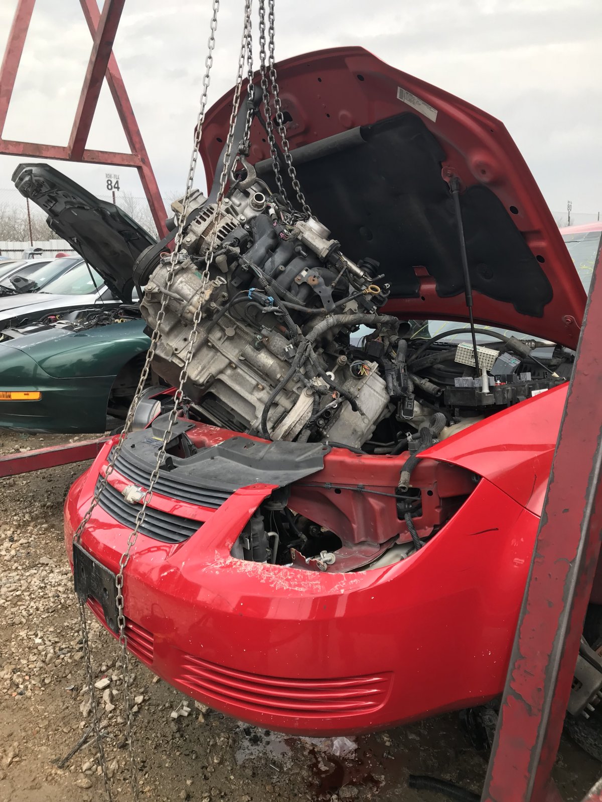

I tried so hard to find a good engine for Tiffany's car a while back and couldn't find one for months. At least not something reasonable and somewhat local. And look at you, you just pluck them off of trees!
Well I did have to pull it...
The local yard was running an engine special. $149+core
Took about 2 hours. Harness is intact too

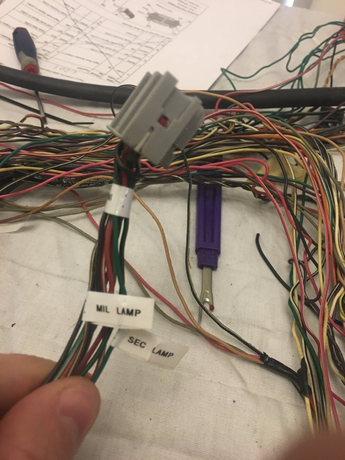

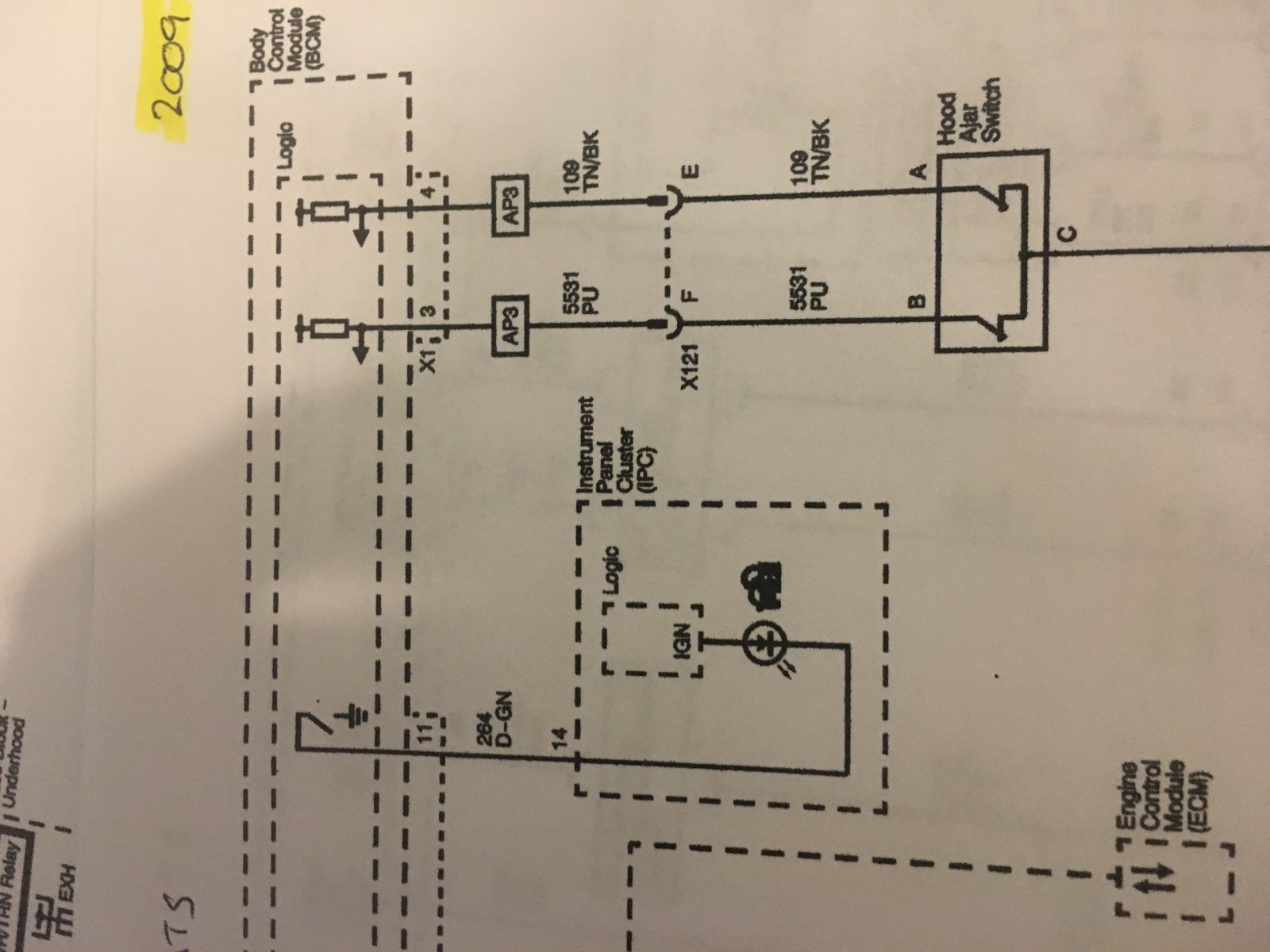

Ok so the car started and ran fine with the anti theft device completely unplugged.
However the theft icon was illuminated on the dash and didn’t go away.
So yes it appears to work, however I think I’ll still just attach the chip to it and tuck it away under the dash to keep the light off.
In going through my dash harness, I found that the security light is driven by one of the green wires at the instrument panel plug. Its turned on and off by a switched ground in the BCM. You could simply depin that wire and the light should go away. Just be careful to ID the proper wire because the other green wires are for the low speed data bus.
JSATX
Thank you for that. I’ve currently got the theft stuff all hooked up. But I’ll try unplugging it again and run it for longer to see if there’s any other side effects.
Sounds like you can remove it all together and then just unground that lamp.

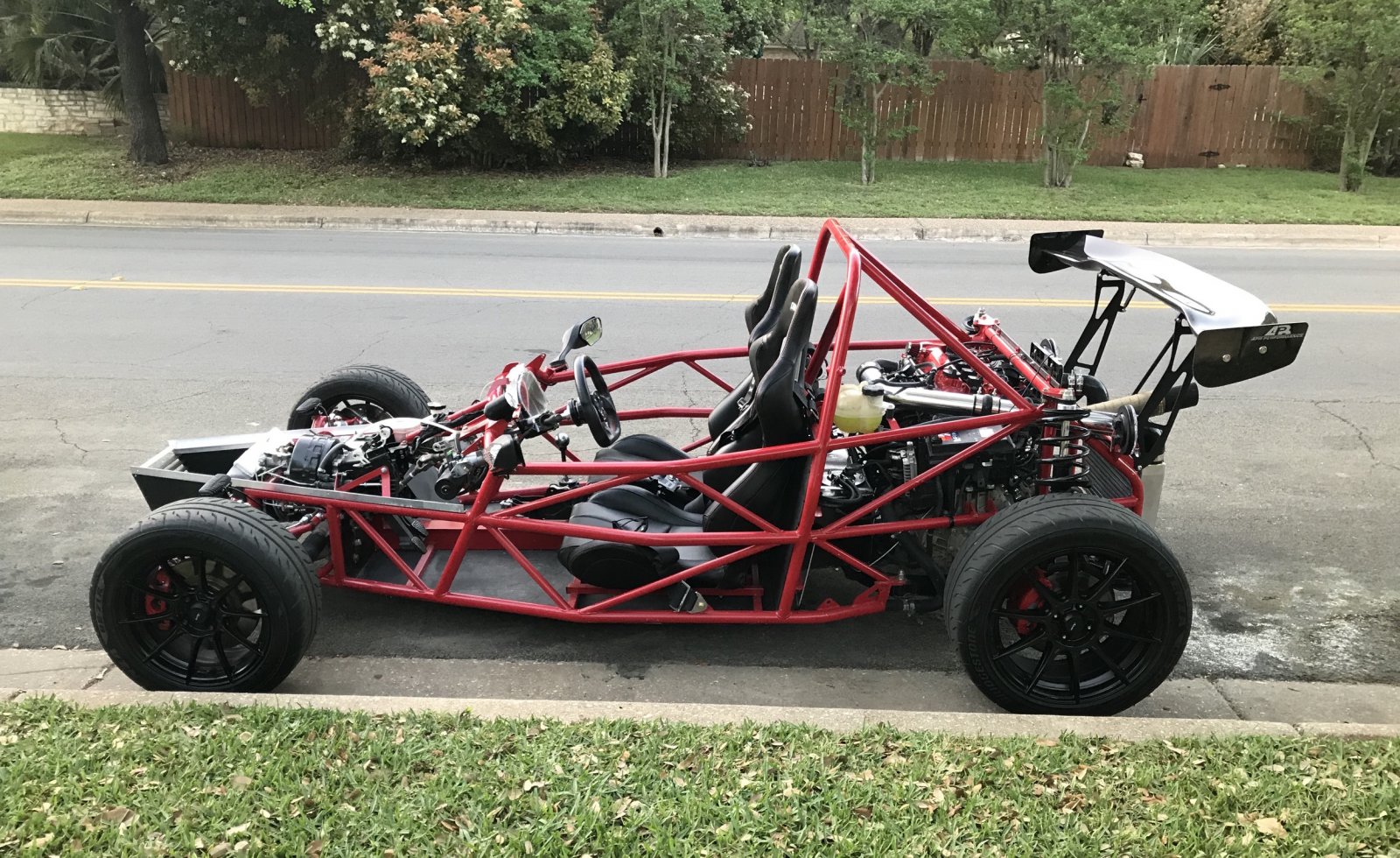

Any progress lately? How is the body components coming along?
Well I’ve been out of town for the whole month so haven’t done too much. I took the nose cone off to add one last layer of fiberglass to the underside for additional stiffness. Now back to body filler. Since I started it I’ve found so many ways to do things differently. I may not keep this one too long. I need a better latching system so it can be removed. Right now it relies on rivits which is just a bad solution.
I spent some time with a friends Exocet this weekend and really like their body design. They use Aerocatch latching system which works really well and is easily adjustable.
