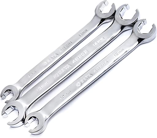

also are you using a flare nut wrench? it is a huge help.

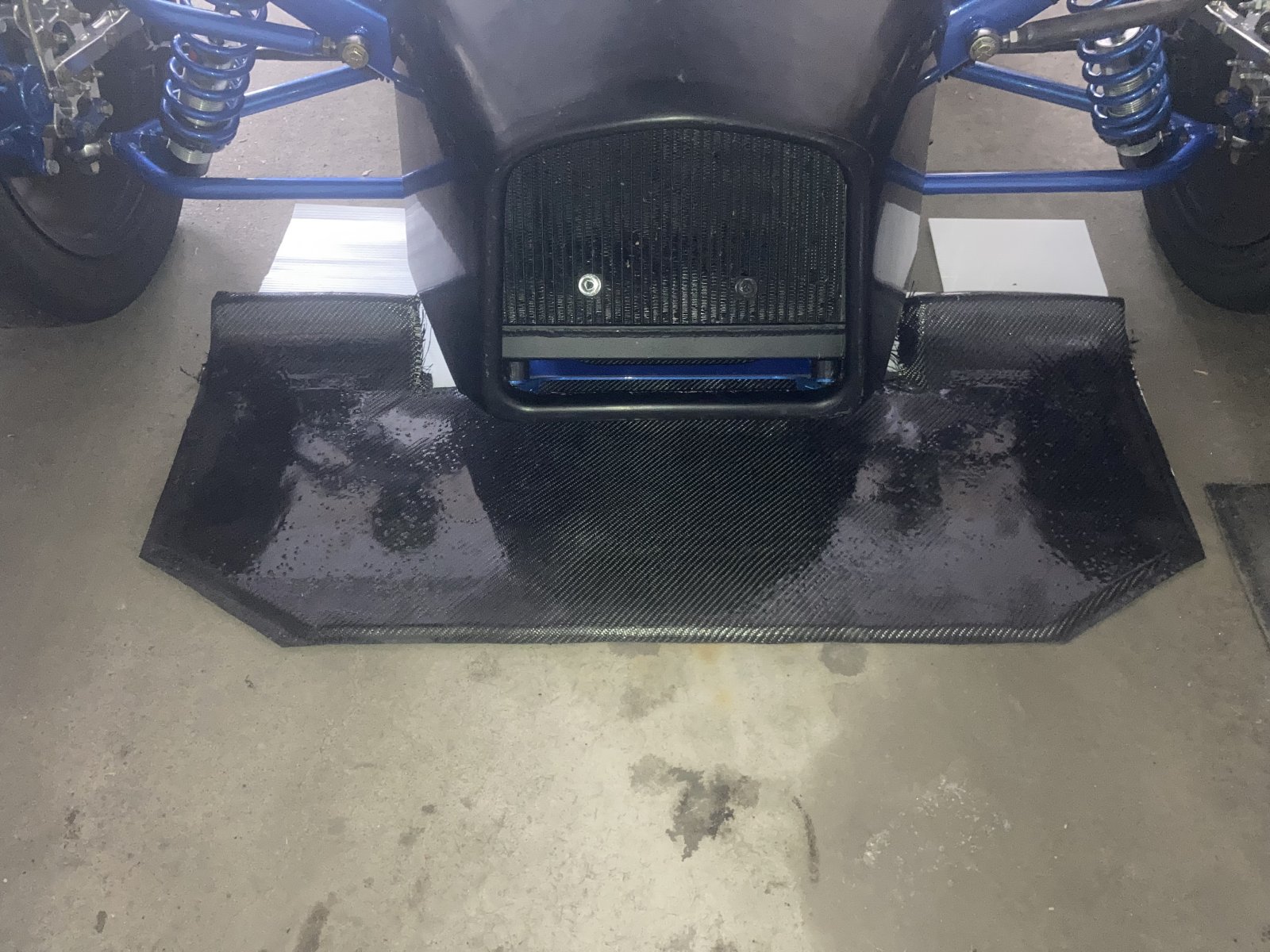

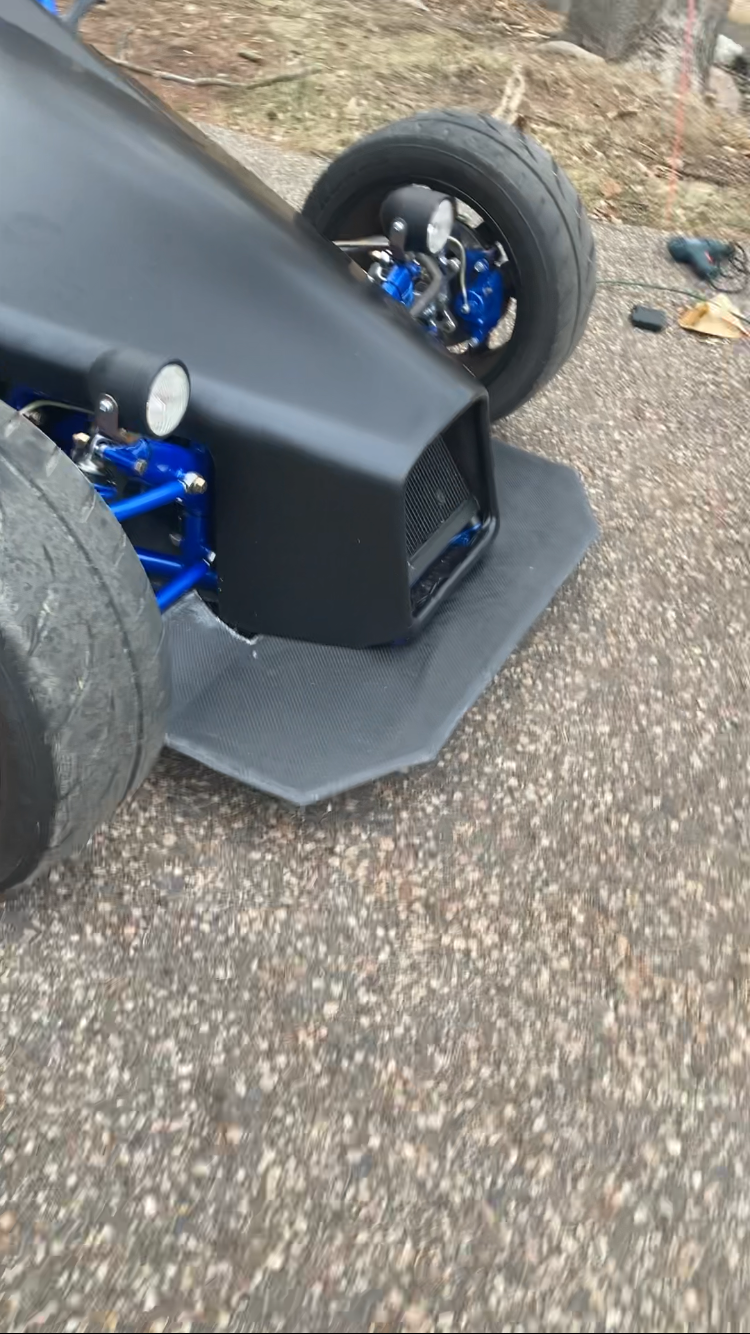

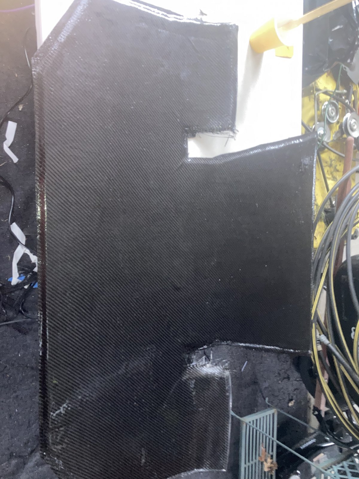

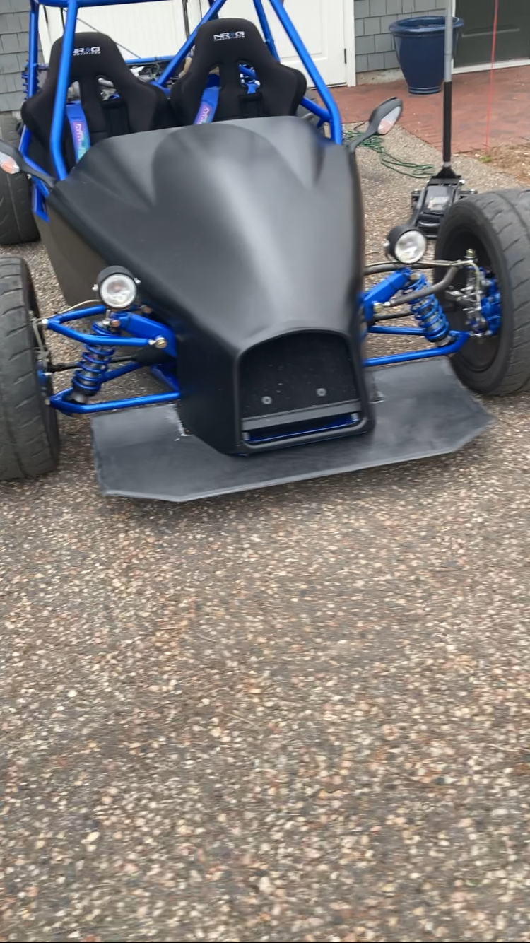

I am almost done with my carbon fiber front splitter project. I learned working through my schools FSAE team about how easy it actually is to get started building parts so I gave it a try. First drive I didn’t realize how much support it needed so it kept flexing down and scraping against the road. I won’t be able to work on the car again until May so I’ll have time to think of solutions.
If anyone has questions about then splitter or wants to solid works files I can happily provide them for you. I also ran some rough CFD and it makes about 60 pounds of down force at 100 mph which I am happy with judging by the fact it is fully flat.

I didn’t get many great photos of it while it was still on the car but here they are.
some of the photos are from before I sanded and polished and I still need to do more especially with the splitter in its current state.

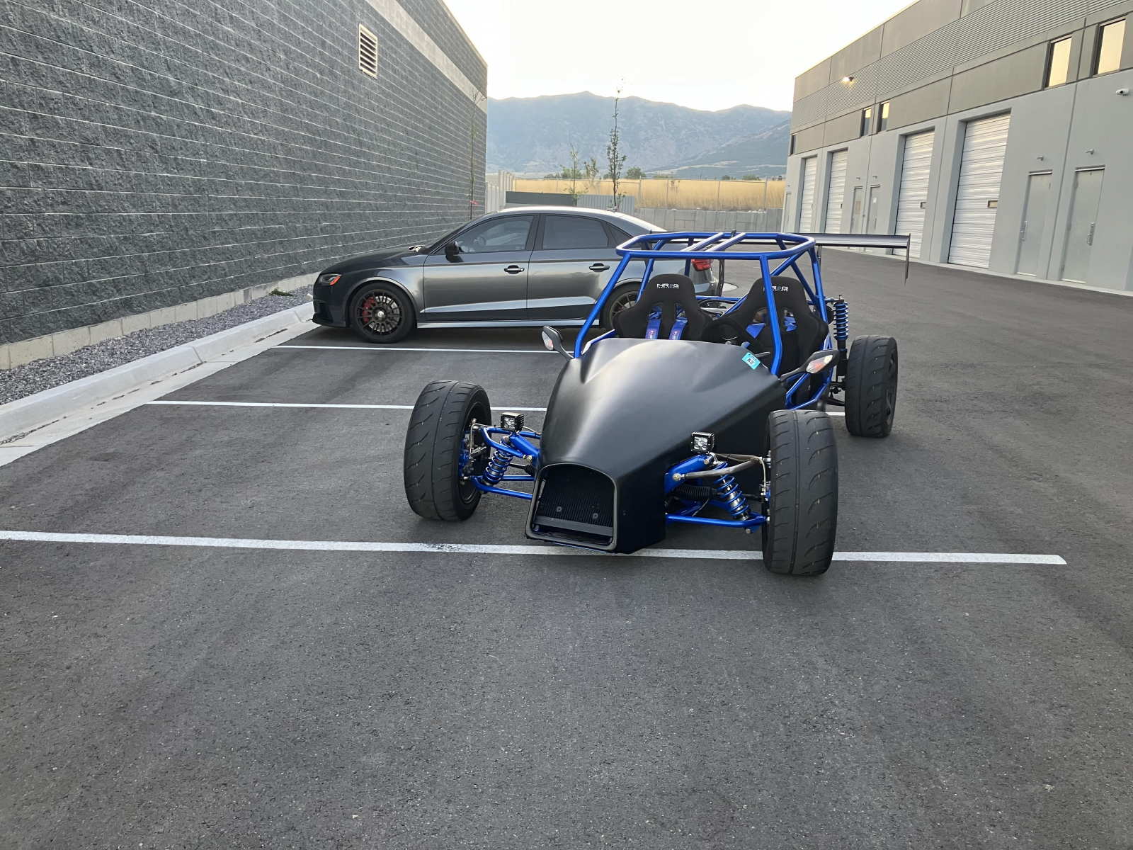

I got it down to Utah! Its great because I am keeping it about 10 minutes from Utah Motorsports campus which does amateur track days on Wednesday nights along with autocross. They aren't that expensive so I have gone twice now and have another 2 more track days in October. Not to mention all the canyon roads here which are so much fun. Hoping to get some videos of this car cruising with some of my friends down here. It was keeping up with my friend in a 500 hp lotus Elise and my other friend in a 600 hp Miata which was pretty cool. They were definitely able to get away in the straights but around the corners the Goblin was faster.
Here is probably one of my favorite photos I have ever gotten of the car:

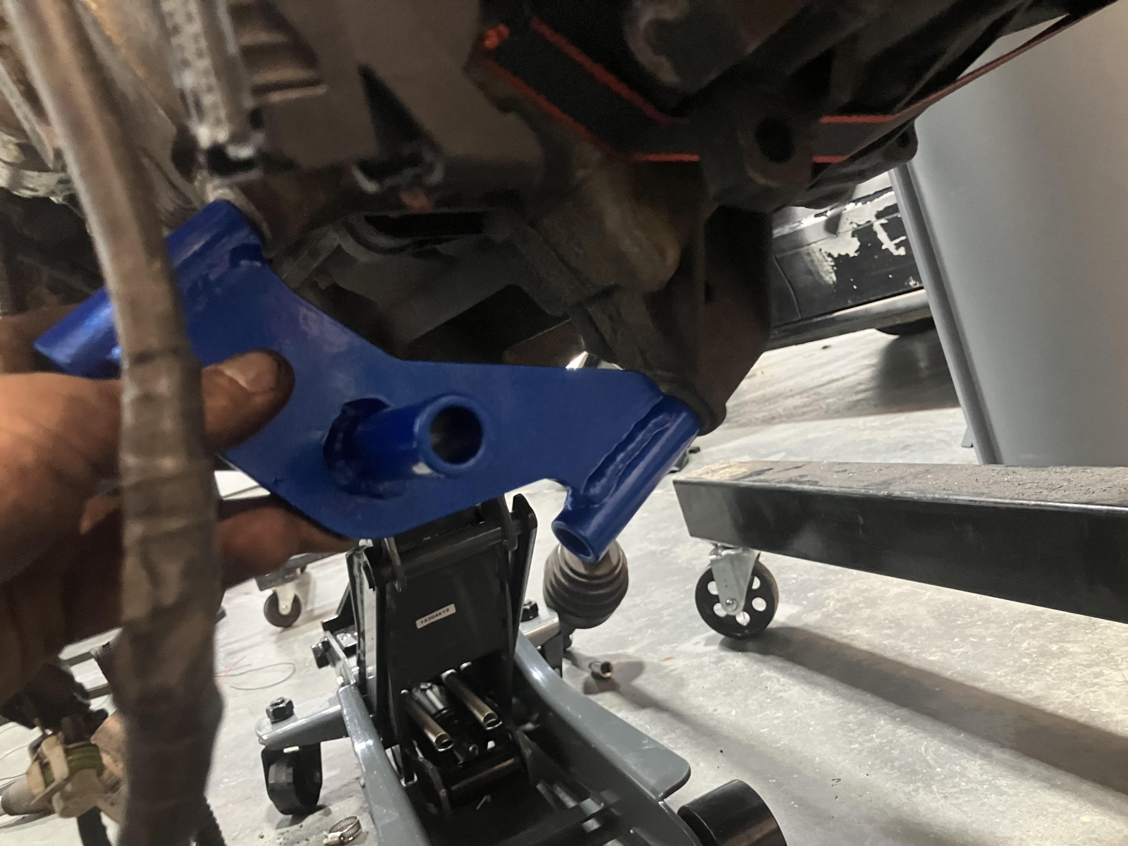

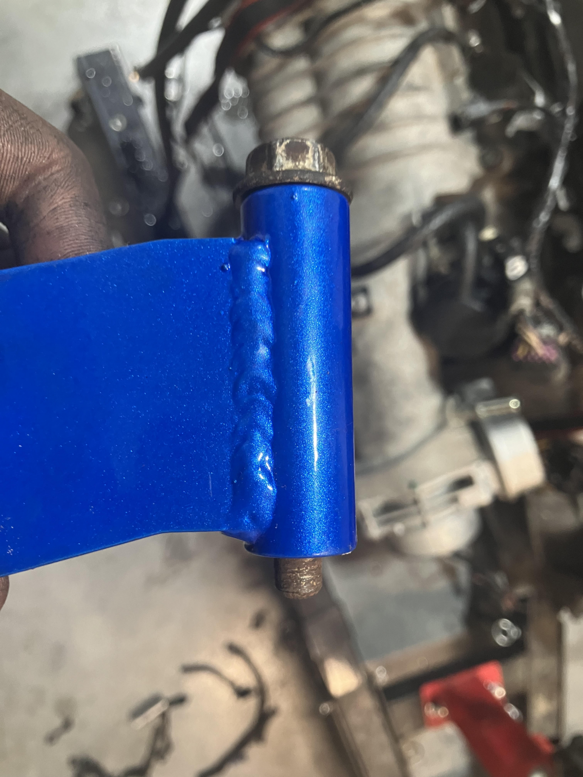

I also realized I never installed the upgraded engine to subframe mount that came with the kit so I tried to put that on but realized that the two mounting bolts are way to short. These are the exact ones that came out of the original engine mount. Anyone know what the proper bolts to use here are?
