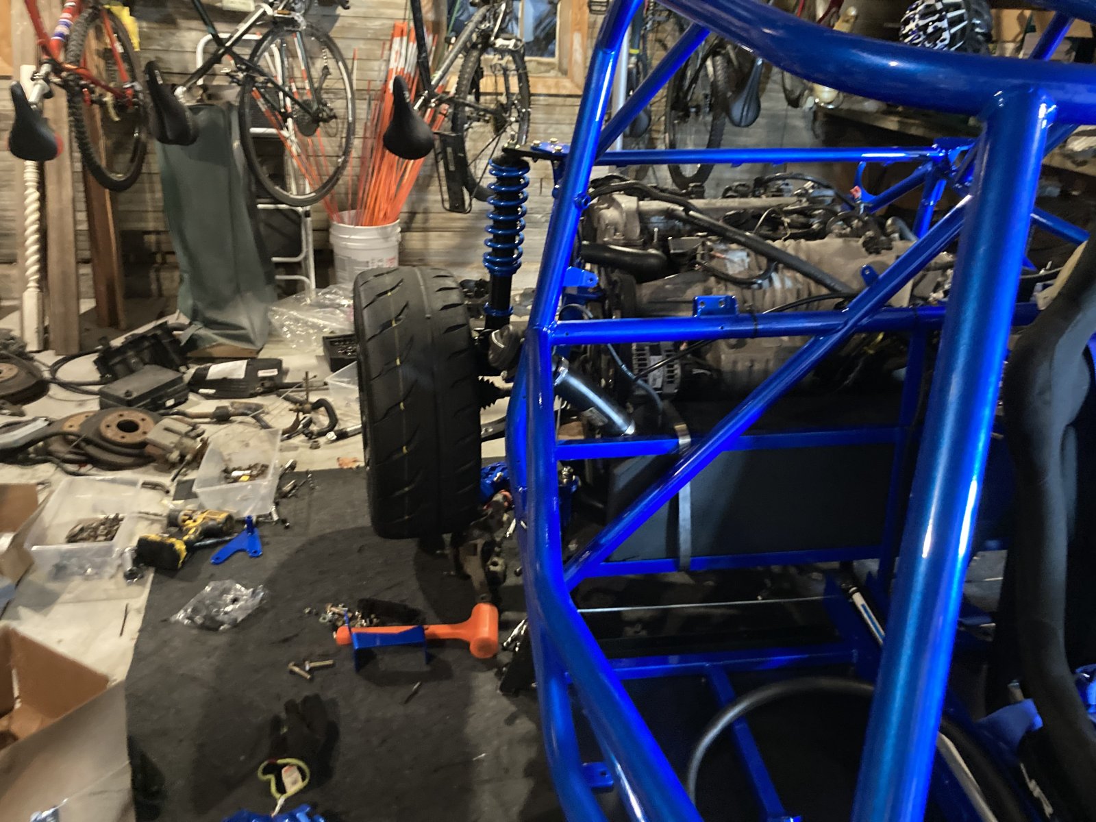

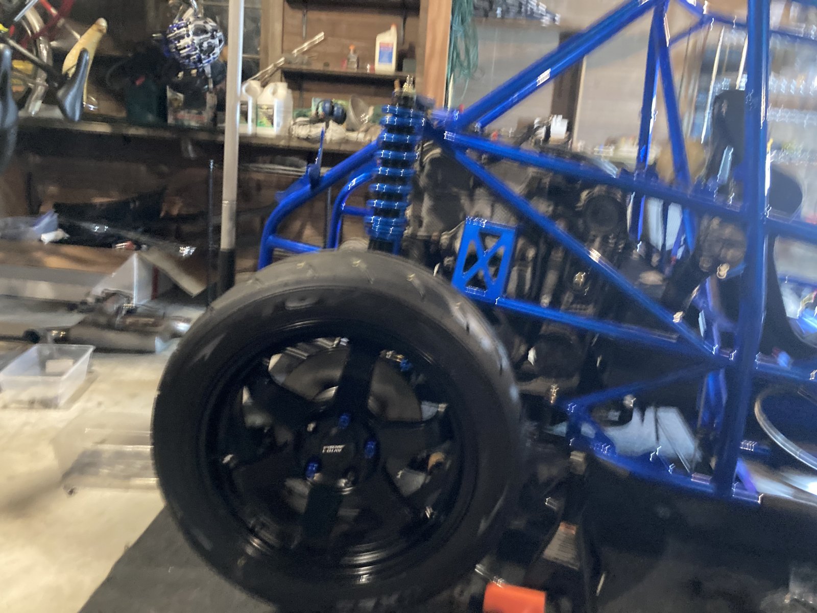

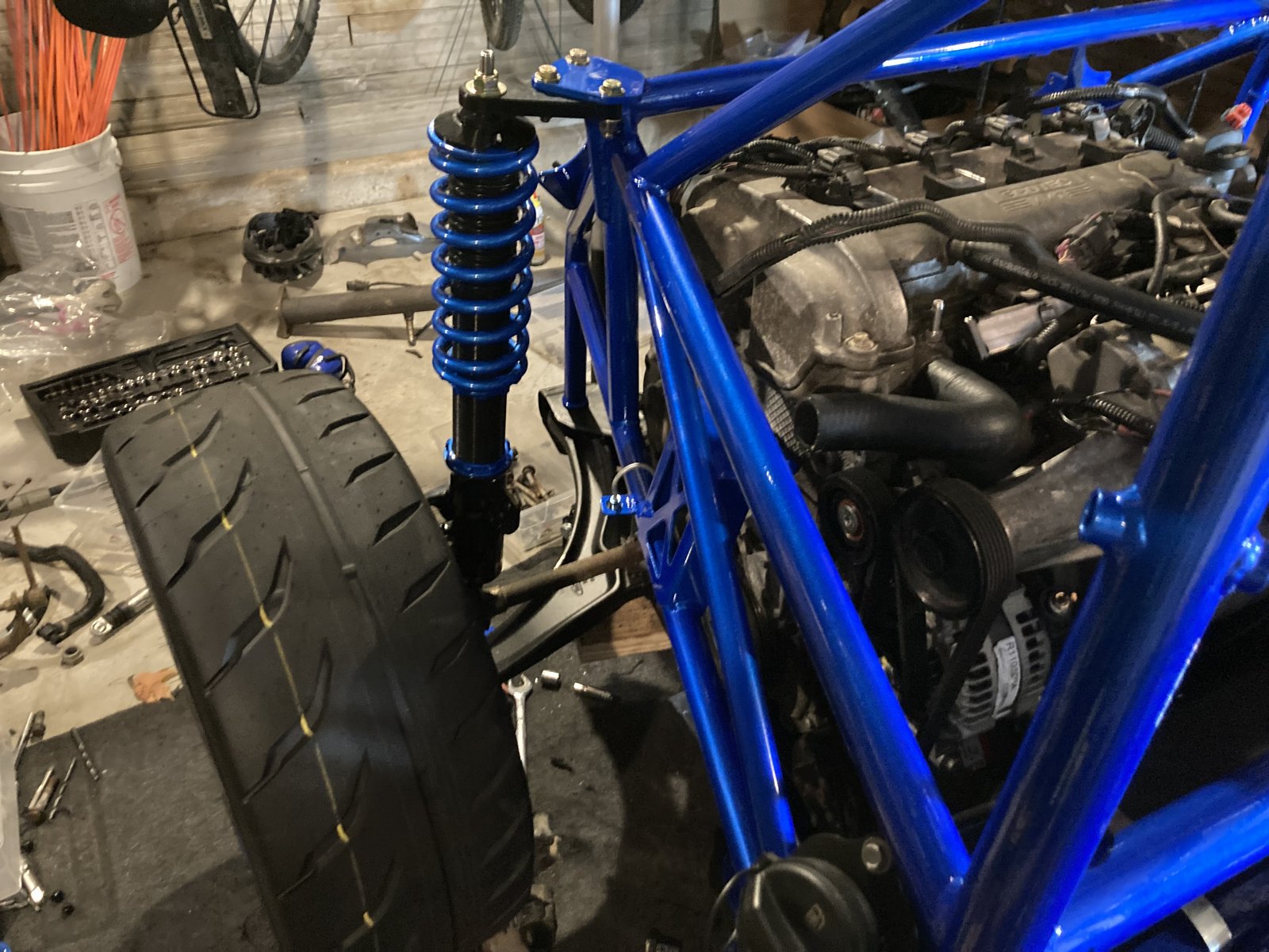

Lot's of work was done yesterday! First off we decided to connect the coolant lines and heat exchanger lines to the engine. The driver side main coolant line went great and so did one of the heat exchanger hoses but I will describe my issues with the other two in the questions. We also got the intake installed which was pretty easy. Still not sure if they MAS is the correct direction but I will post that in quesitons as well. After that me and another friend lifted the subframe and bolted it into place. We figured out we were missing one of the rear subframe mounting bolts so I will have to order a new one of those. I was a little worried about the subframe bolts getting stuck like the control arms but everything has so far gone ok. Only one side left to do. After that it was around 11 but we were on a roll so we kept going and installed the rear passenger side suspension system minus the tie rod which I am confused about as well as the sway bar. We had a little troubled figuring out how to mount the caliper but once we figured out there was an adapter we were able to install it but loosely as we are pretty sure it will need to be removed. We then tried to put on the wheel adapter hubs that we bought but then realized that the inner diameter of the adapter seemed to be a little too small so we will need to sand that out a little so it can fit. We got the wheel mocked up and it just looks amazing. I am absolutely loving the color scheme we decided to go with!

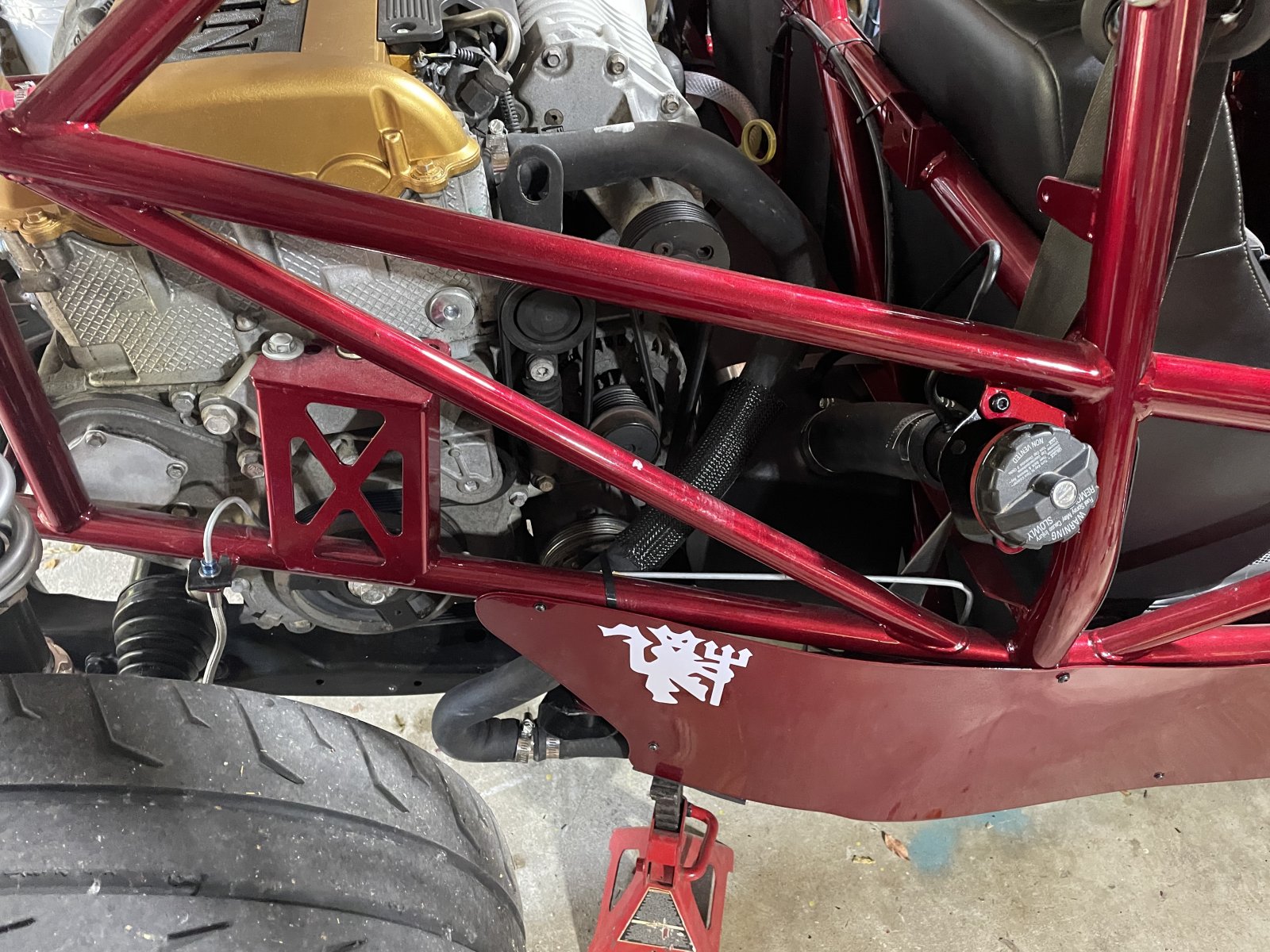

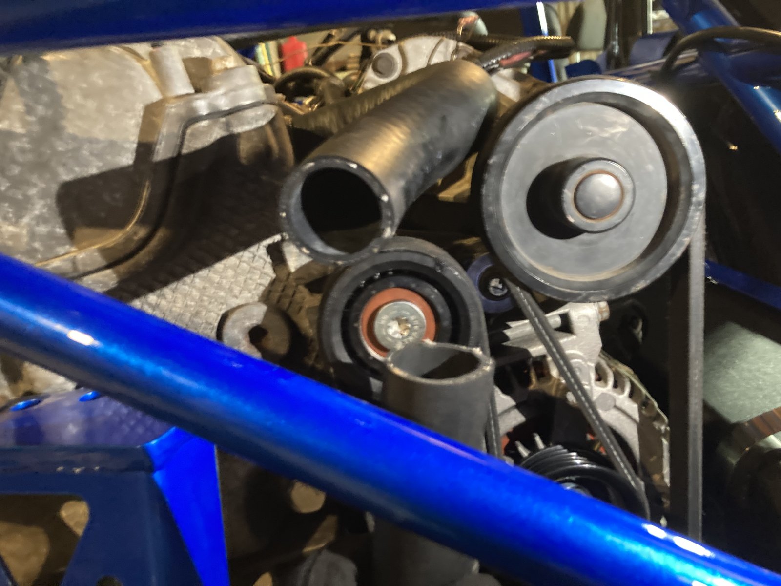

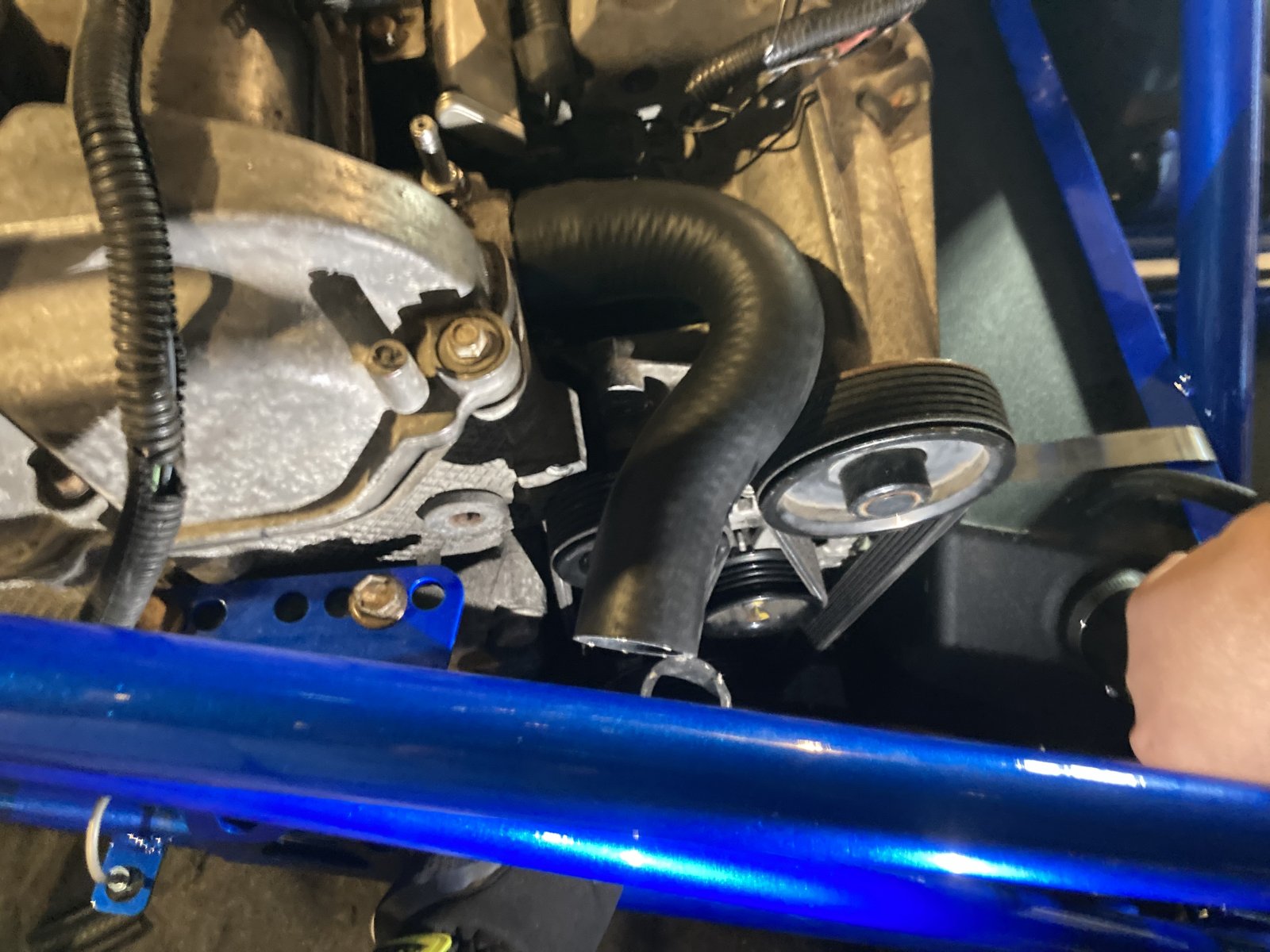

Passenger side main coolant hose:
36409
36410
I do not understand how these meet up, am I not using the correct hose or what? If I try to connect them they will contact the belt.

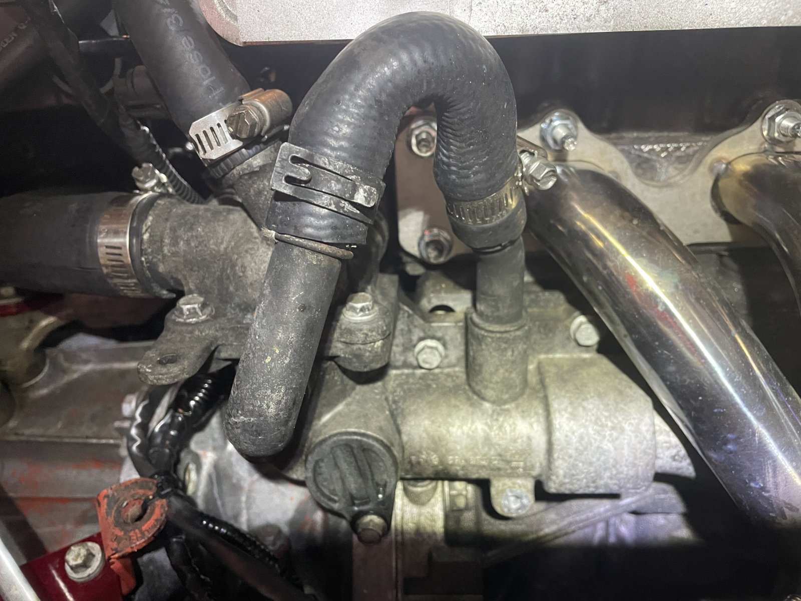

Heat exchanger hoses:

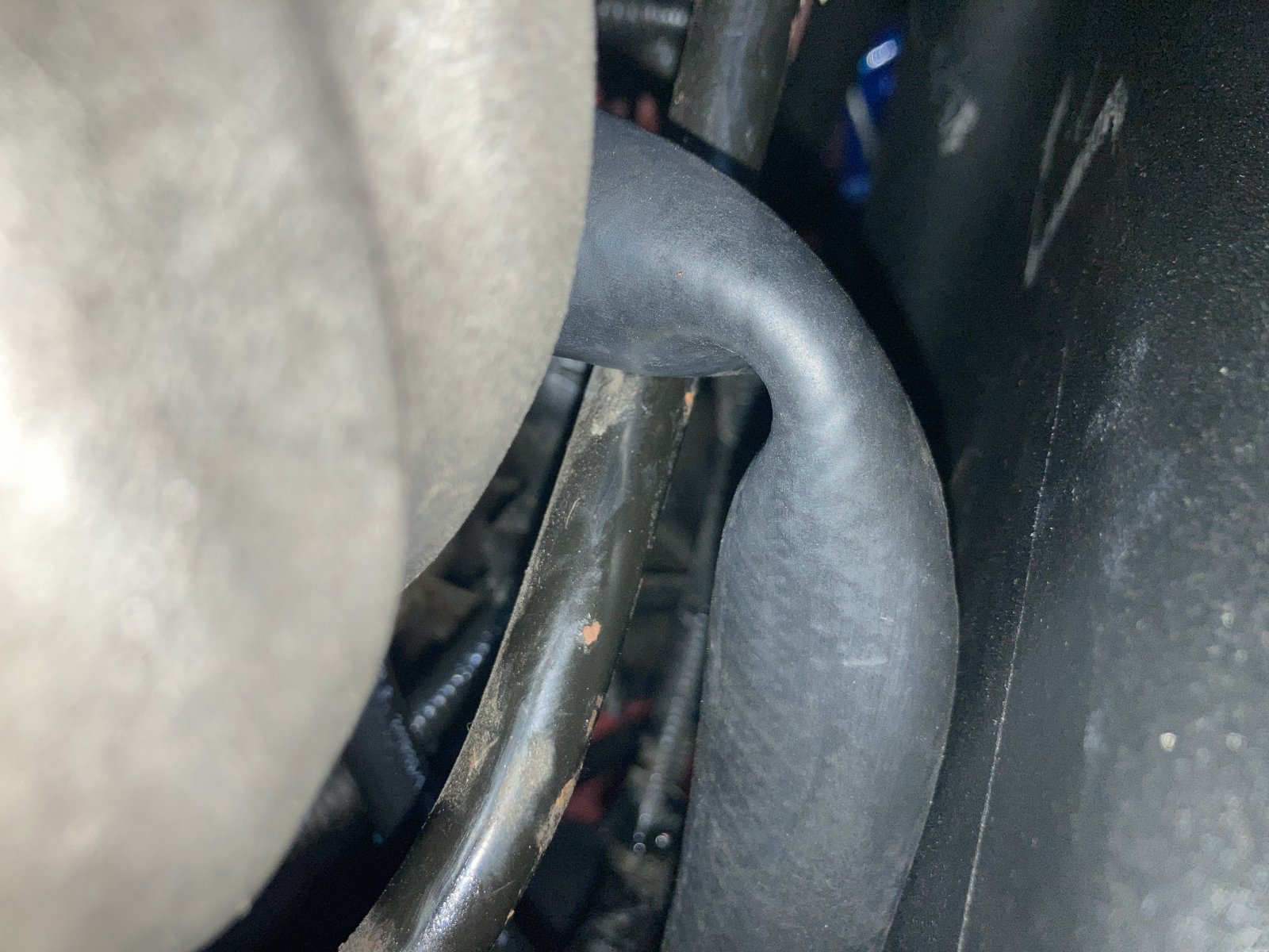

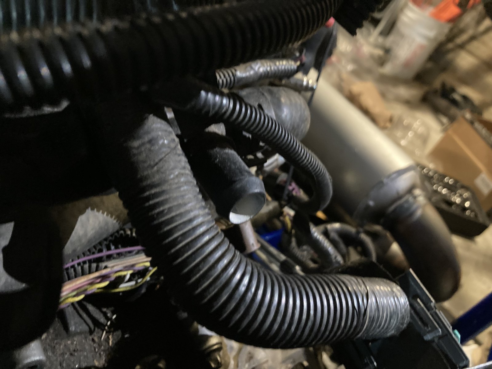

36411
This is the hose that comes out of the port right next to the intake manifold under the turbo. The hoses provided don't seem to have a bend to facilitate the one above. It is pressing up against the fuel tank, do I need to buy a different piece or how does this actually fit in?

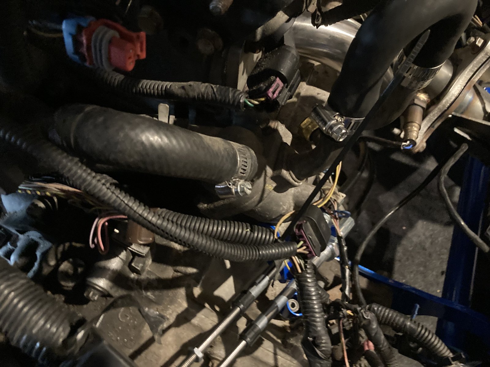

What do these plugs go to:
36412

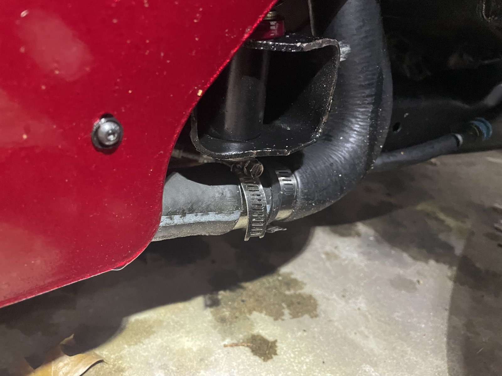

I'd use an elbow for that spot. This one for example.
My dual pass plumbing has so many different splices and clamps it's hard to count. When I pull my engine during the off-season I plan to take detailed pictures of my setup in case anyone needs to reference them. I have the elbow mentioned above, along with splices and tees in my system.

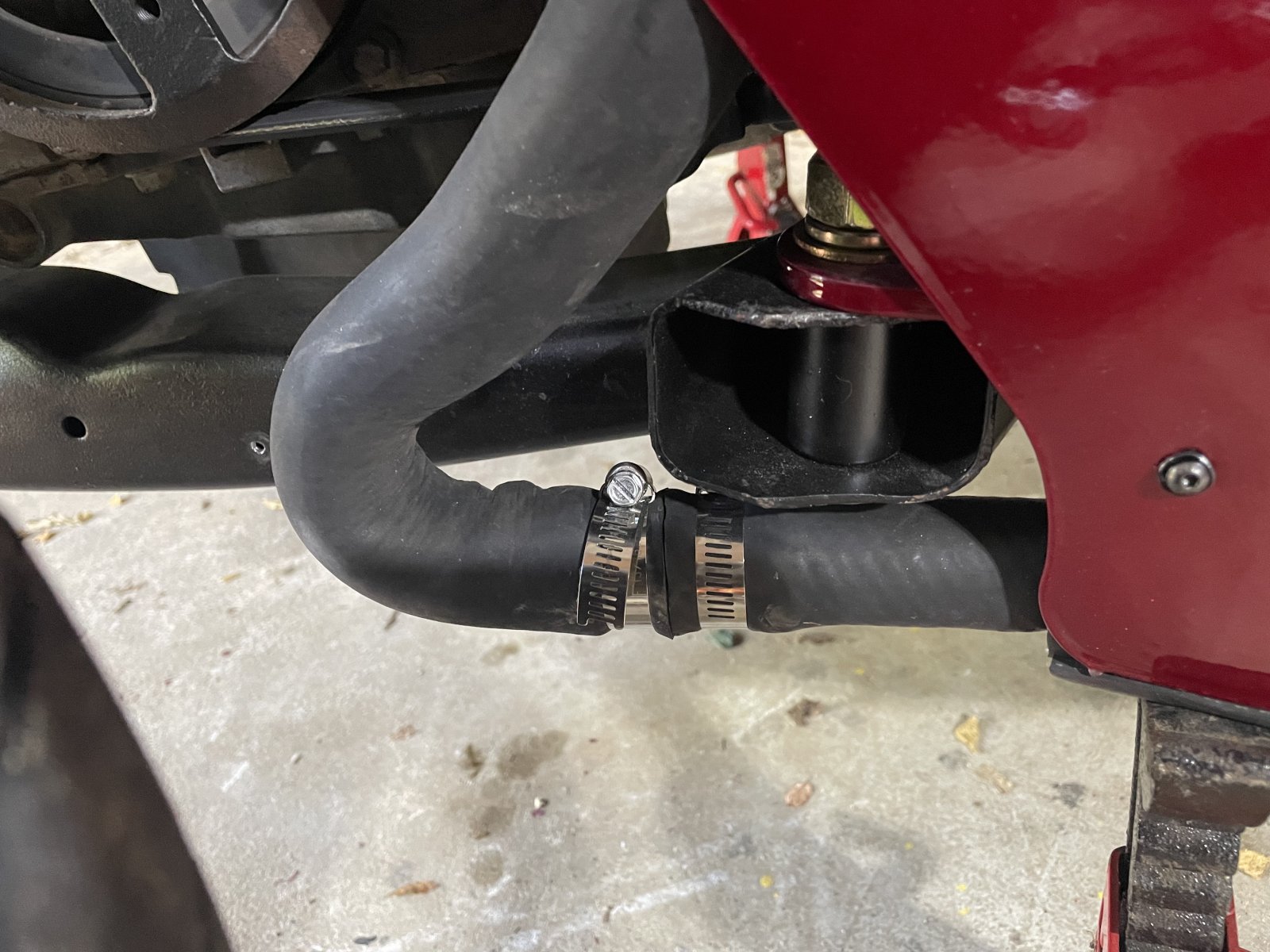

Strange. My passenger side hose goes all the way from the head to the hose in the frame. I didn't have to have a second joint in mine like EscapePilot did. Now, the drivers side has two couplers. I have the hose coming out of the frame to a 90 degree bend section that connects to the stock hose going to the thermostat housing.

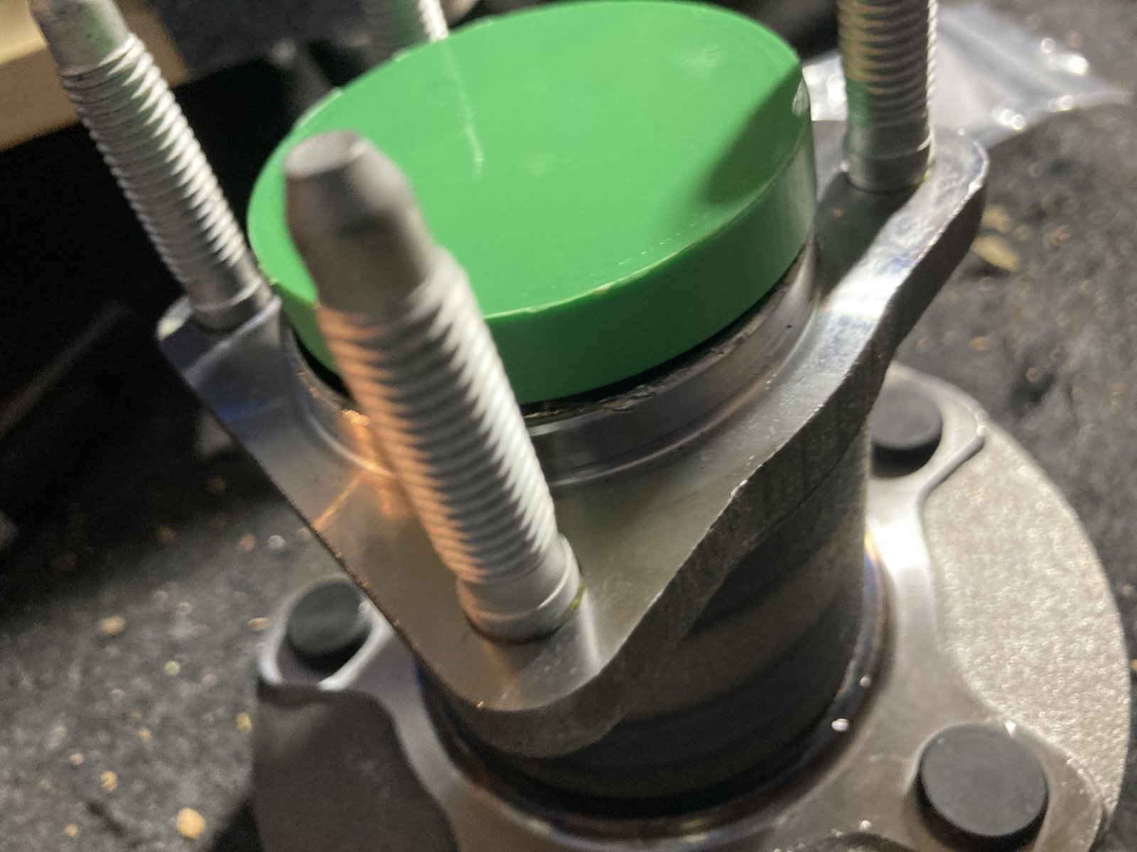

I printed out the bearing hub ABS caps and they don't fit, do they only fit on certain model of hubs or did I just print it wrong?

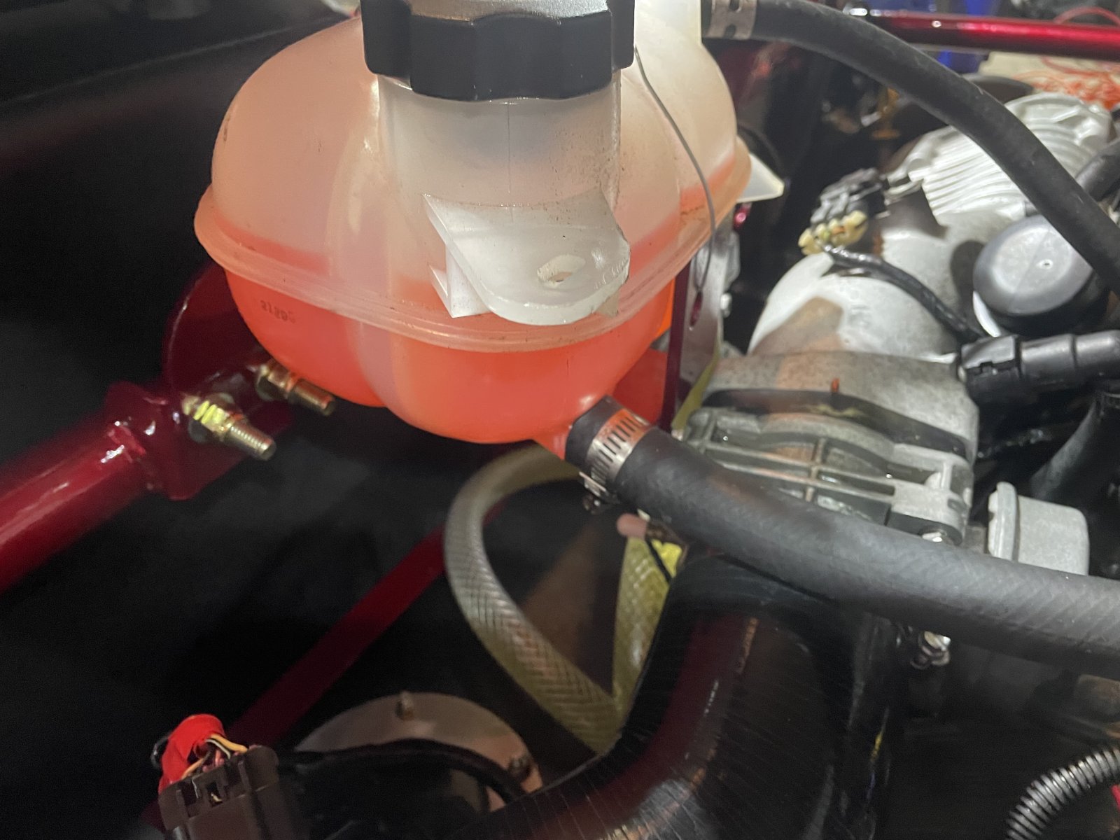

There is this t intersection from what I beleive to be the main coolant feed line or whatever it is. It is on the transmission side and I can't figure out what it might go to. Any ideas?

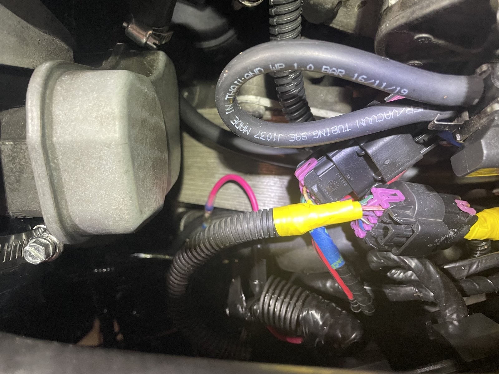

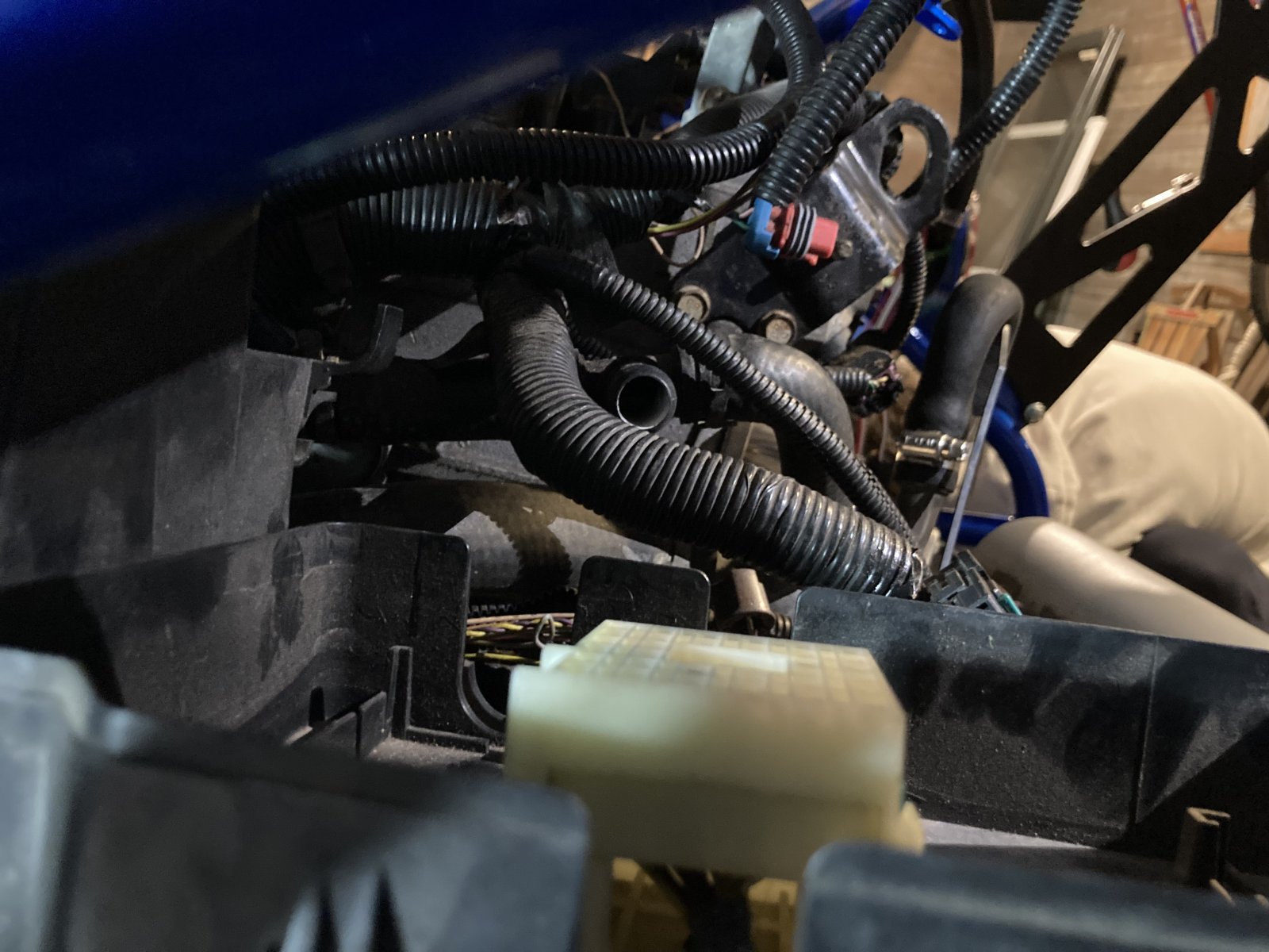

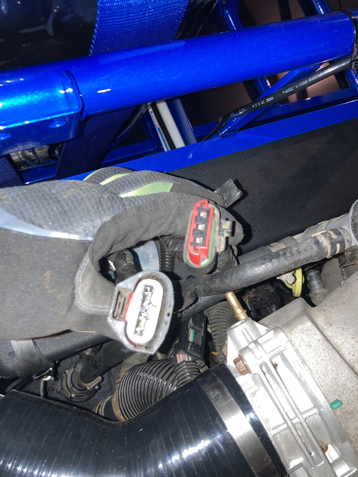

The plug that goes to the top of the supercharger does not seem to be long enough for me, did anyone else experience this?
The postivitve stud that goes from the engine to the fusebox also seems to be way to short. Has anyone experienced this?

The power cable should run from the battery to the starter. Then another wire runs from the starter to the B+ terminal on the fuse box.
I’ll snap you photos of my coolant hose scheme….

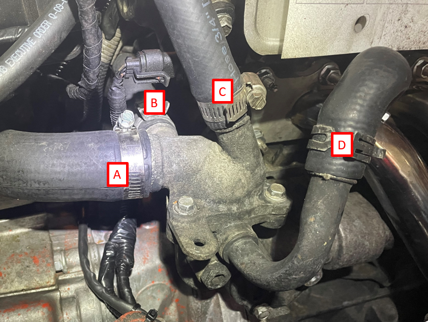

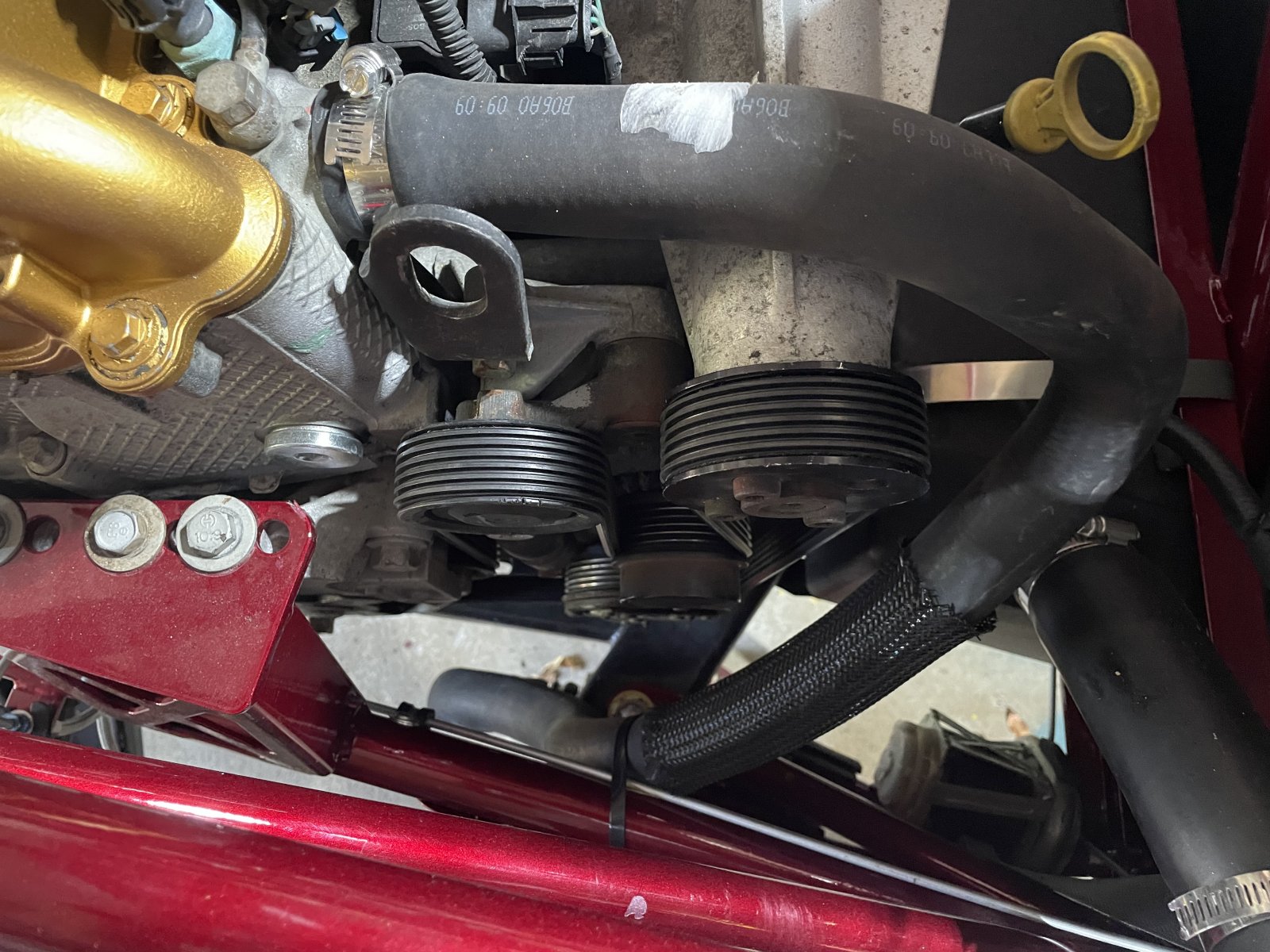

Thermostat housing junction. I have 4 ports coming off mine
A- Connects to the hose coming out of the drivers frame rail. You have to get creative here. I have a 90 degree bend connecting the frame hose to the stock cobalt hose.
B- Connects to a place under the throttle body to this finned cooling thing (technical term). If someone knows the real name, let me know. This is on the front side above the transmission towards the fuel tank region.
C- Connects to the coolant overflow bottle.
D- Connects to the other port right next to it. Makes a U-shape to get there. This one was tricky, it's not as easy as the video for the LSJ as mine was at a funky angle.
K
Ok got it. My c connects to something that I have no idea what it is but it is right below my super charger. That t connection likely hooks into the coolant overflow but multiple forum members told me my coolant overflow leads to the nipple above the passenger side main coolant connection. This is all a little confusing but I think I am starting to get it figured out.

Got a lot done since the last update. Wiring harness got installed which came with some issues that were only my own fault. First I accidently installed the main positive cable to the crank case ground which caused the whole thing to short out. After that was fixed I was missing the ground cable that runs from the engine to the frame. That took about 2 weeks to figure out which is pretty unfortunate. Fired it up for the first time and it was running pretty rough at idle. Figured out the MAF sensor was the wrong way around so I fixed that and it runs better but still a little rough. Got some fluids in it and found some leaks that have been fixed so coolant and heat exchanger are pretty much good to go. Got the brakes fully installed and got all the lines ran and tried to bleed them but I am having a lot of trouble with that so I am going through and resealing all of the brake line connections with teflon paste. Got the shifter mechanism installed but not mounted, up and down moment is smooth but side to side is not.
