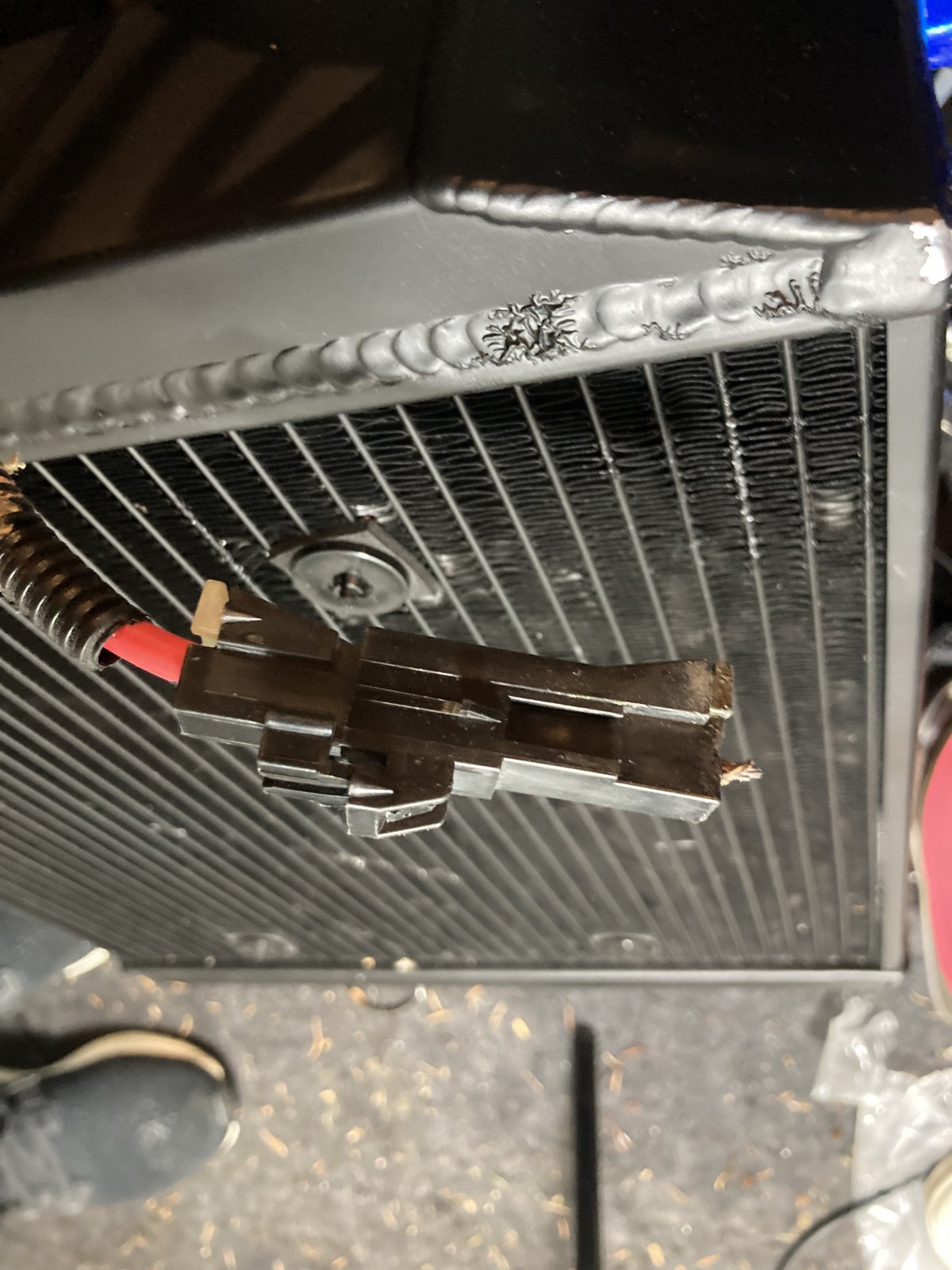

Rewire the BCM power plug (an electrical fire burned the connector unfortunately) Quick question here the connector says its a PEC 2 connector but I have looked on rock auto and just the open internet and have found nothing similar, I need to replace the female side of it. Here is a picture of what I am talking about.
39563

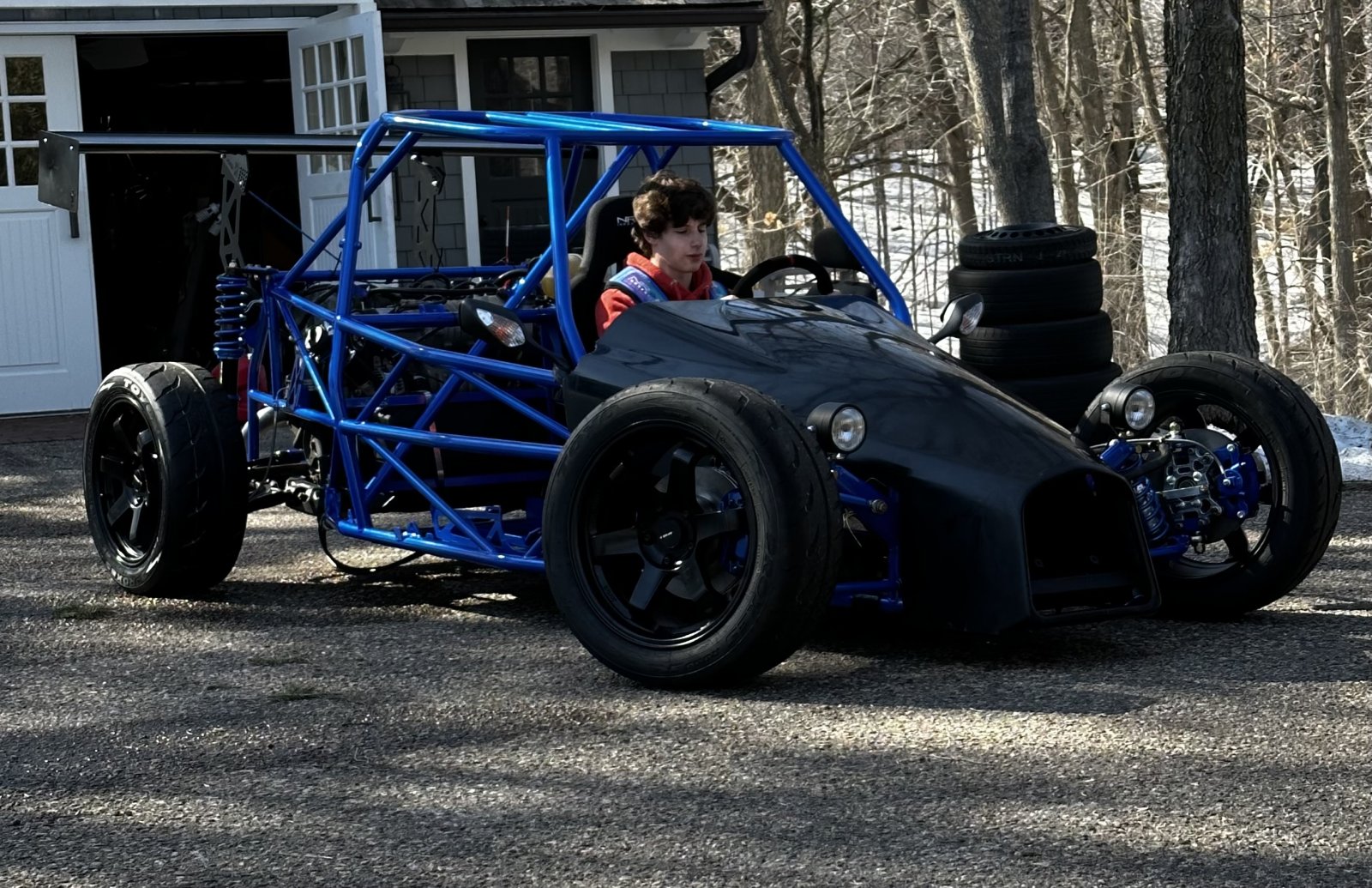

Here is a photo of the car out in the sun with the hood mocked up on it:
39564

It might be possible to reuse it, I would have to do a pretty good job soldering it on and make sure its all good but I can try. To me it looks like a normal connector with nothing special so could I just swap it for a different general type of connector. My other idea was just hard-wiring it but then I wouldn't be able to disconnect it.
comegetjoe
Yeah...dont hardwire it. Random connector could work if youve got both sides as long as it matches up the wires right.
