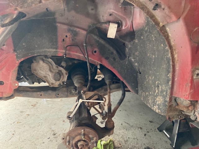

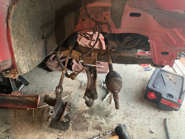

Got the front suspension off today with some persuasion with the angle grinder! We weren't able to remove the nut on top of the strut but we figured out that you don't have to do that to remove it from the donor so instead we just kept it on both of them. The sway bar end link nuts were also not coming off and we got annoyed and decided to cut. The final thing we ran into (and where we stopped) was that the axle nut kept spinning while we were trying to get it off (more detailed thread here: https://dfkitcar.com/forum/index.php?threads/axle-nut-spinning-with-axle-and-cant-get-off.3730/).

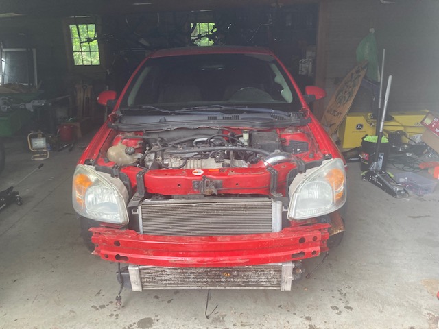

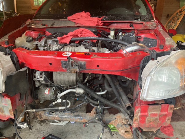

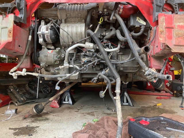

Today was a good day as the axle nut came off using a technique from rttoys. We also were able to remove the surrounding bolts but not able to slip the bearing hub off of the axle and will leave that for tomorrow. We drained the coolant and some of the transmission fluid from the donor and were able to completely take off the front radiator and intercooler which leaves the front of the car looking very bare!

Break out the Sawzall and remove the front radiator support across the front of the engine bay. Makes for better access to everything and easier to remove the drivetrain. Unless you plan to sell the Cobalt body?

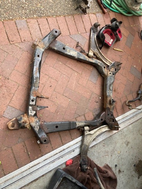

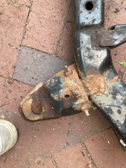

Yesterday went fairly well and we were able to finish up the 3rd video which has so far taken us the longest. The subframe came out but only after cutting one of the front bolts due to the fact that the square piece of metal that acts as a nut for it was rusted and spun with the bolt. We will hopefully be dropping the engine this week sometime but were waiting for a friend that is much more knowable than us has time because we would rather not get hurt or drop the engine doing something stupid. If anyone knows the exact bolt that is used for the mounting of the subframe in the front that would be appreciated as we will have to order one. We also ended up deciding that the front suspension was to rusted and was not worth keeping so we added the coil overs to our order.

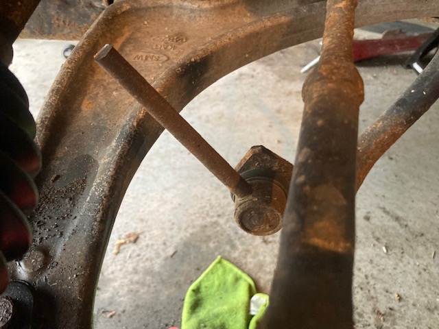

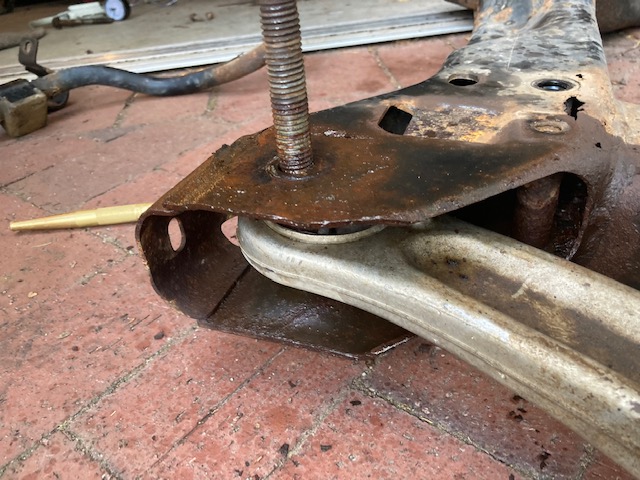

Does anyone know how to push this bolt out? It is stuck on both sides.
34266

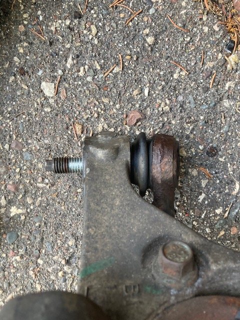

Same thing with this one.

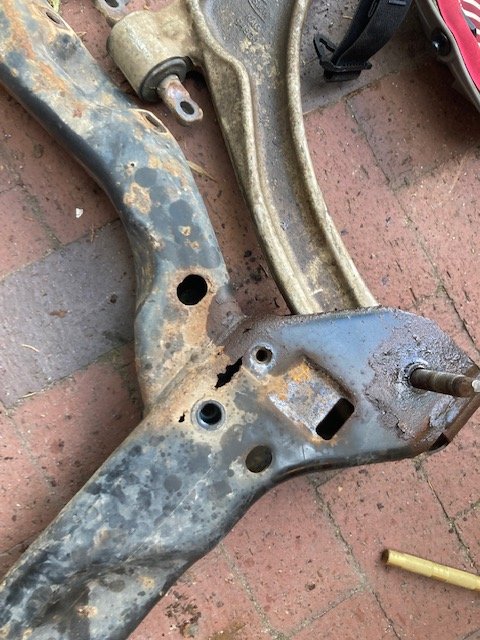

Is this rust of any hazard to the integrity of the subframe? If so what should we do?

The radiator/core support tab on the front of the subframe comes off, and the tabs that remain on the subframe aren't needed except possibly to secure the parking brake cable guide tubes. There's other places to attach them if you need.
The hardware for the front of the subframe is new and comes with the kit. It's a carriage bolt that goes in from the bottom.
The rear bolts can get bound up by the rear control arm bushings. See if manipulating the control arm helps you get them loose. They're pretty beefy so I wouldn't mind banging them a bit. You will almost certainly need new rear control arm bushings, the MOOG K201285 is highly recommended.
I don't have a lot of experience with rust so I really can't speculate there. If you need to pick up a replacement, as far as I know, every Cobalt subframe is the same.

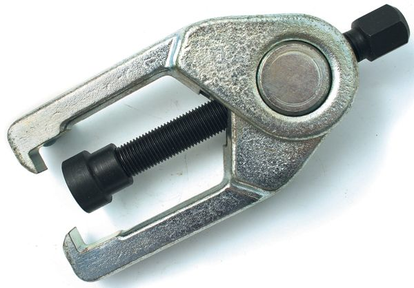

To get the tie rod end out of the knuckle, try heating the knuckle, penetrating oil, and/or a tie rod separator like pictured below. That tool can typically be picked up from a parts store as a loaner. You can also use a pickle fork if you're willing to replace the tie rod end (and why not, they're cheap).

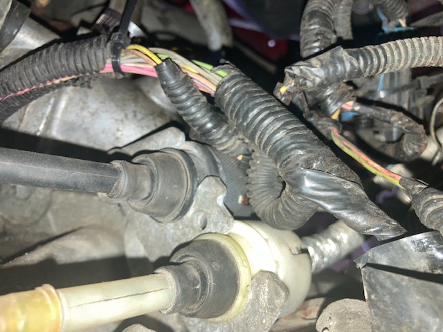

Today we started working on video 4 which is removing everything off of the engine and dropping it. We got through the entire video besides removing the transmission cable housing and the exhaust. Starting off with the transmission cable housing we could not find the exact thing as in the video (maybe because it is a manual transmission?) so we just decided to leave it until we got some guidance from the forum.
Here is a photo of what we think is the cable housing:
34283
We tried pulling them out but didn't use that much force or try very long because we weren't sure if those are the right ones.

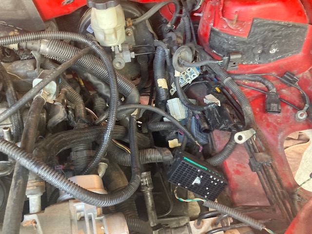

Here is a picture of what the wire harness looks like still in the engine bay. We are pretty confident we got everything but we will triple check before we drop the engine:

The shifter cables do just pop out of the bracket. You're right, I think in their video series for disassembly they were working with an auto trans donor, so that's why you don't see that there.
The only reason I can remember to treat the cables gingerly is that they have decent resale. I sold mine for $60 in just a couple days. I think the new kits come with all new hardware for shifter cables other than the base of that bracket and perhaps the shifter side cable ends. I know DF sells new cable ends but I'm not sure they're included in the new kits as standard. I also know the stock ones aren't reused if you get the upgraded DF shifter (which I recommend).
