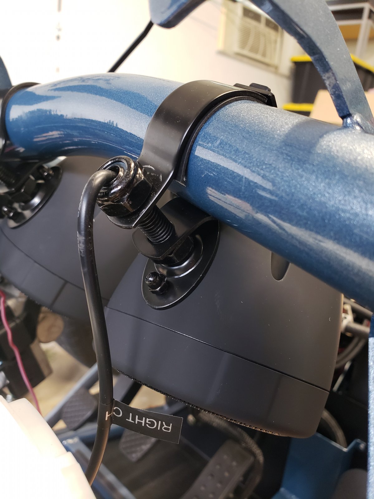

If you order this kit you'll have to put the clamp over 1 1/2" pipe or a socket and squeeze the tabs down so they're able to go over the shaft. You'll also have to remove the extra nut and all washers for it to fit. It was only meant for 1" bars I think.

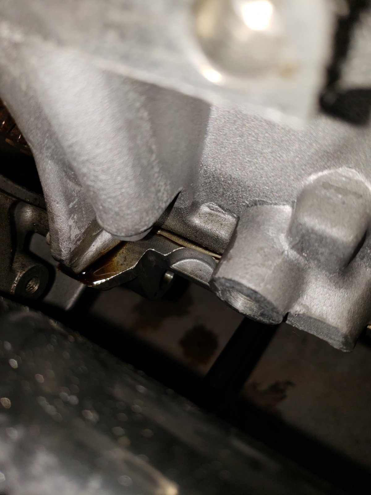

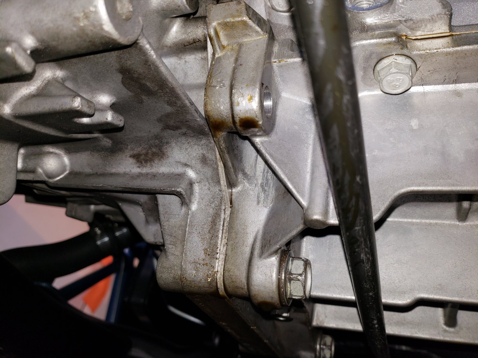

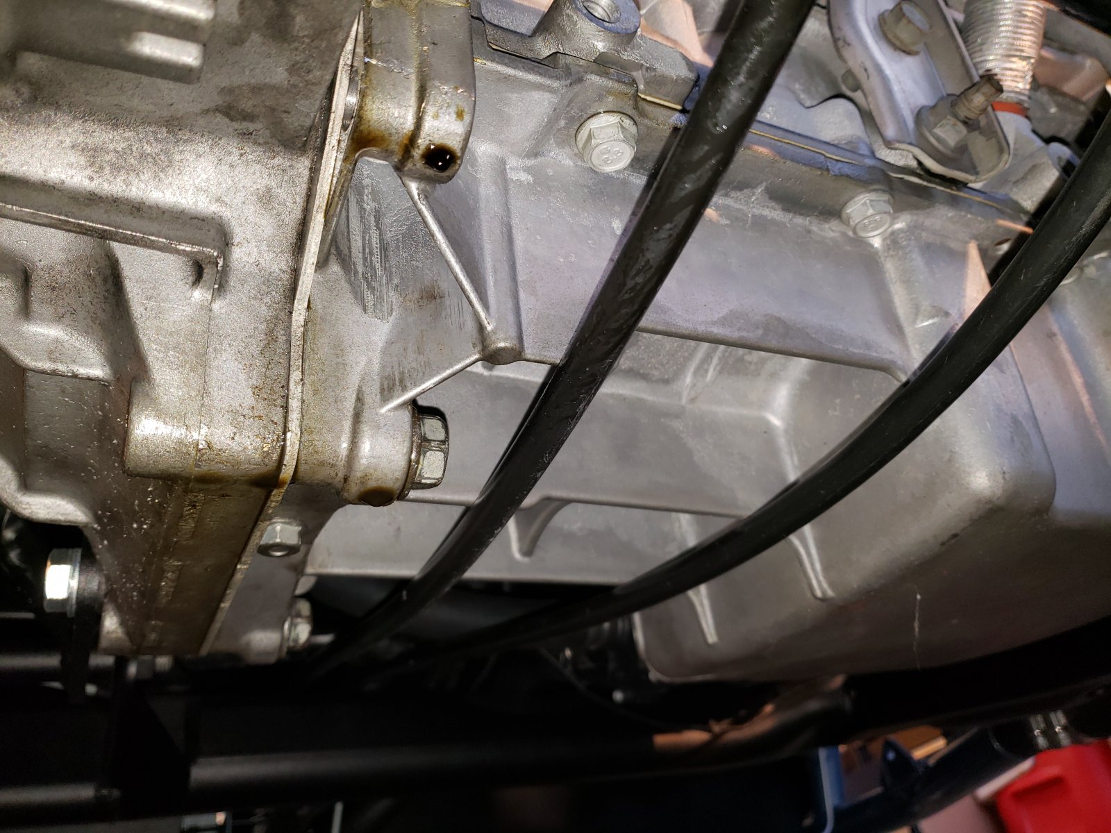

Ugh! If it is the main deal, you don’t want it getting on your clutch plates (assuming a manual here).
It may be too late for that. I would look around the oil pan. The one oil pan bolt looks damp around the base. Could be residual run off. Brake clean the hell out of it. Start it and let it idle and watch from underneath.
Did it have an oil leak while in the donor? If not it could be residue that was trapped in the bell housing while cleaning. If it is not terribly bad I would drive it for a while and see if it gets better or worse.
Also make sure it is not brake fluid, that would indicate if it could possibly be a leak in your clutch system.
Lethalcast
Thnx for all the input guys! I pulled the oil pan and it looks like that's what is because the flywheel is totally clean and the seal doesnt look great. It never had any oil leaks when I pulled it from the donor.

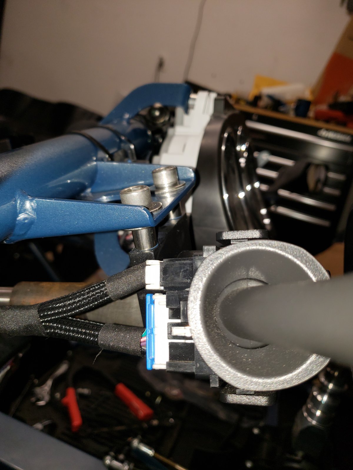

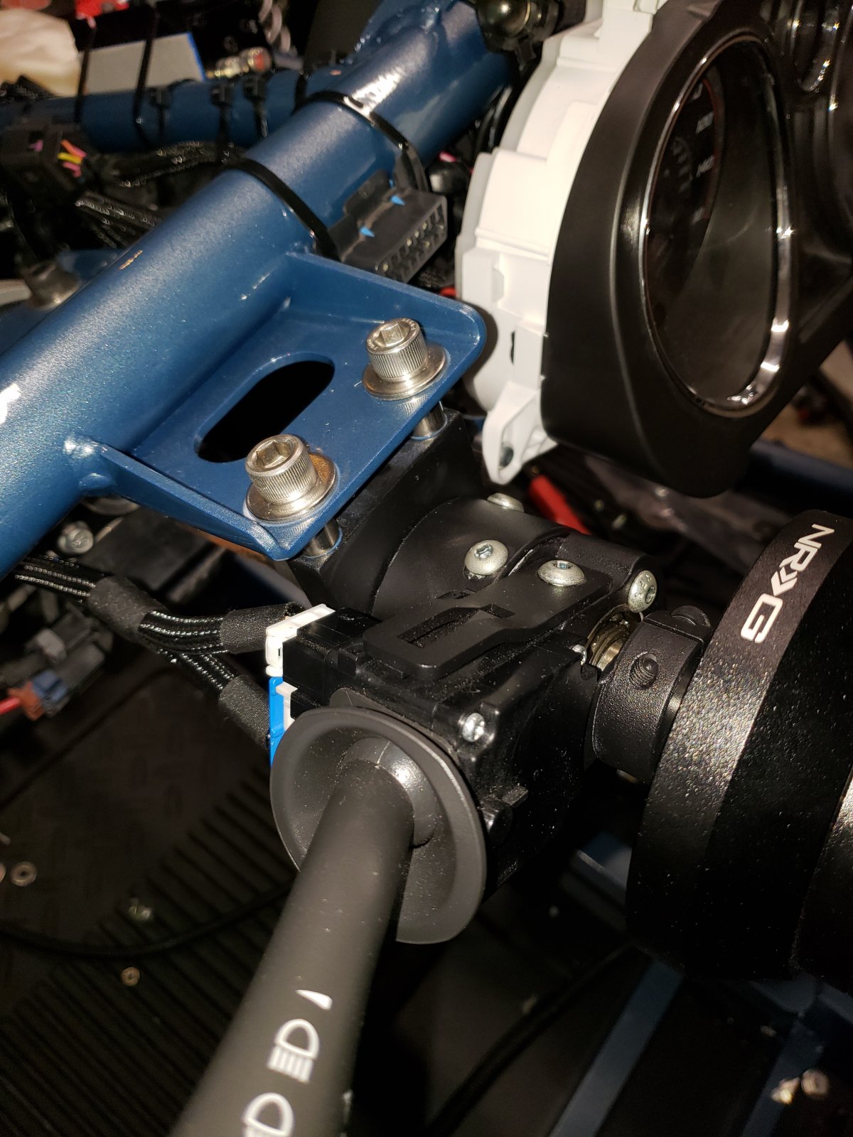

After getting my seats and everything in I found my steering wheel to be too high and too close. I cut some pieces from a stainless rod to act as spacers and also cut the cylinder down that connects the column. It worked great and it's a perfect distance for me now. I imagine it will be different for everyone because of height but also from seat and wheel combinations.

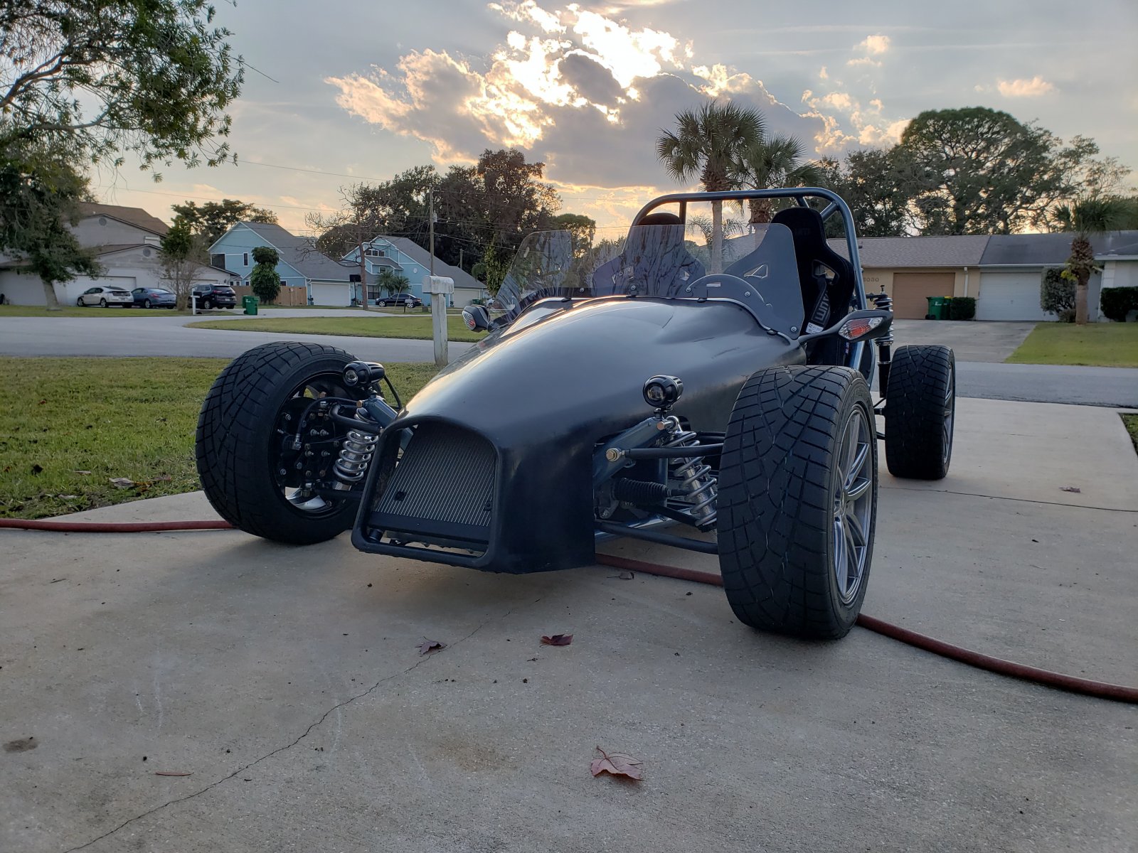

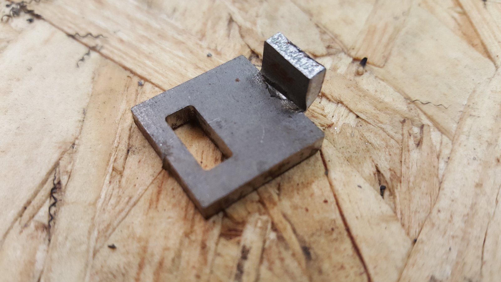

Dominator 1.5 haha. I loved the headlights IDRVSLO used but I wanted to use just one on each side. They come apart easily and you can use just a single mount that comes with the kit. I did use two button head Allen bolt and had to shave the edge down on one so it could slide over the bolt that mounts to the frame. I ordered two sets so I could use one from each set since they have a cutoff. After using them last night I'll be removing the cutoff plate. It cuts off so low that you have to have the headlights facing at an upward angle to get any distance before the cutoff. I did take them apart to adjust them and it's just a simple plate that's used for a cutoff. I would imagine if you wanted to go with the same setup you could just buy one set and remove the cutoff from one and then it would save money. I'm still looking for an led setup small enough to fit inside.
