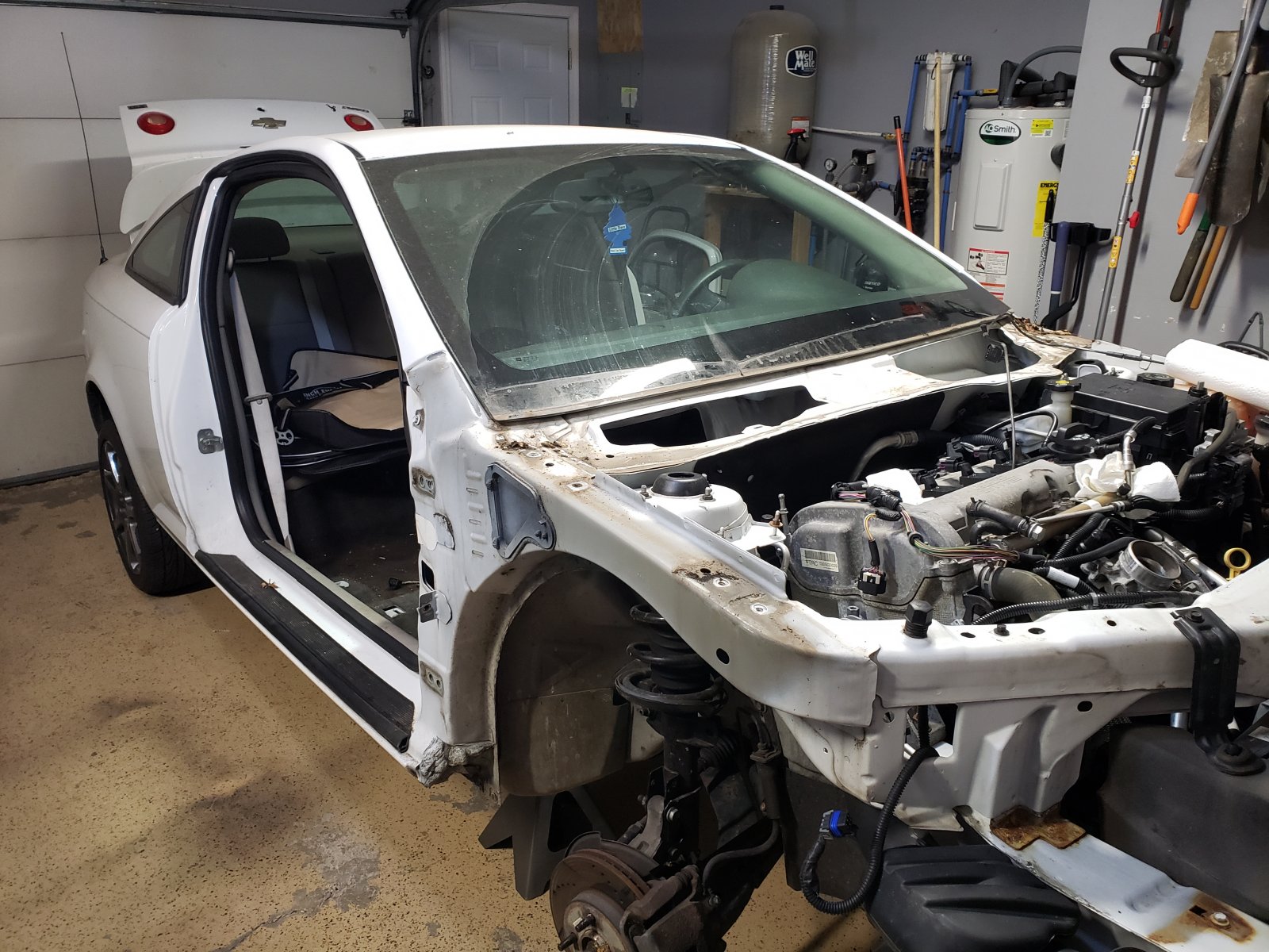

Got the initial tear apart going. So far seeing some things that will need replacing... and pondering more ways to spend monies :cool::oops:. I made a You tube vid to decide if I want to video log the build. It's a few minutes of my hobbling around on a bum leg but if interested ... Video - Phase 1
The finished product after phase 1.
18341
Goblin Graber
That’s one clean looking donor! If you’re not reusing the hubs from your donor switch to the back and get the fuel tank out now. It will be way easier with the front end still on. Checkout my post in my build log.
List the things you want to replace so we can let you know if you need to or not. Some things you won’t need and some will be replace, that’s in the kit. Just trying to keep you from spending money if you don’t need too.
L

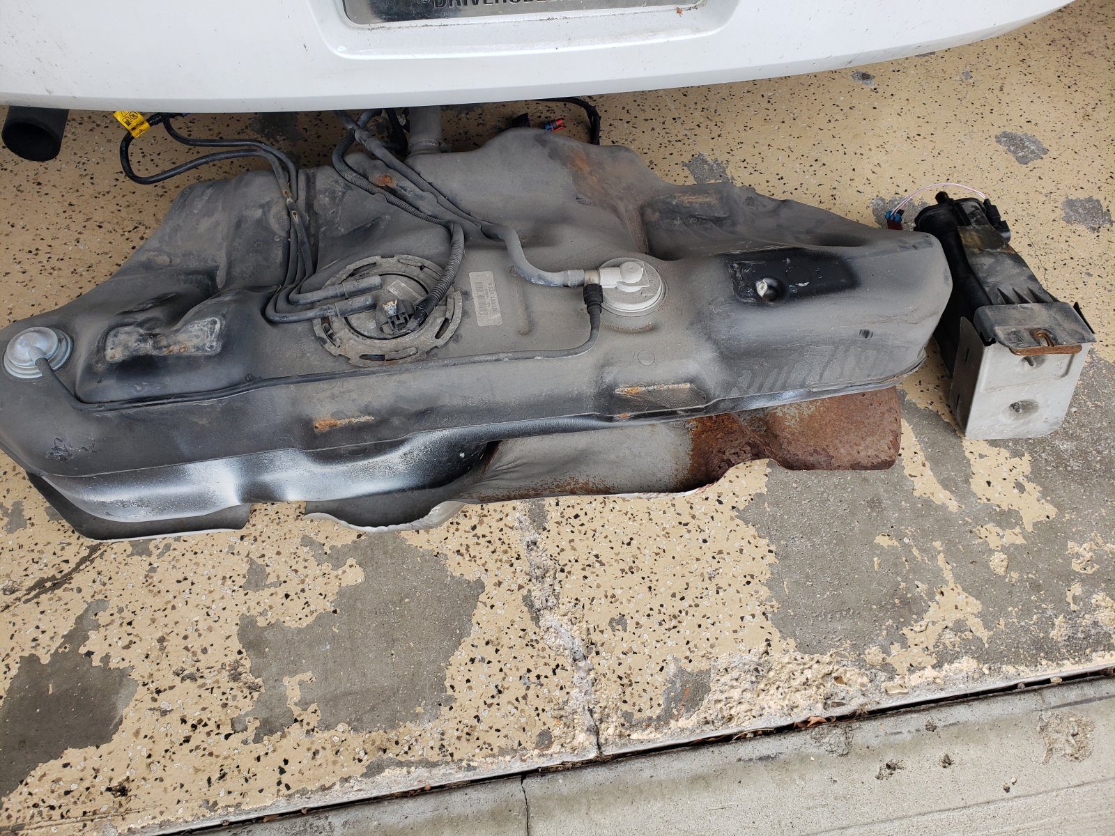

Got the fuel tank out and ready to be worked on.
Also got fenders, doors, seats, off. So far need to add a fuel filter to the list... and what looks like all new hubs.

Making good progress! Don’t forget the filler neck. I took my fuel tank out last and it was super sketchy with the front on the ground and the back in jack stands.

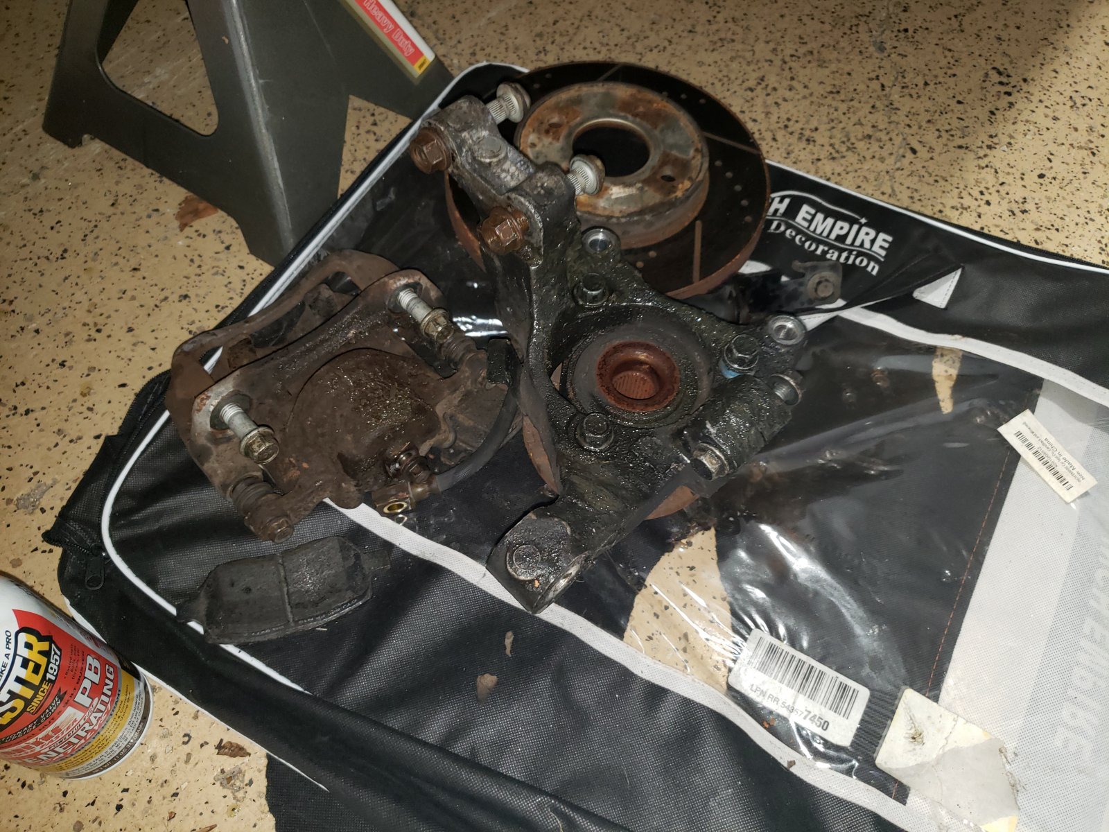

Not sure if this has been carried through completely as proof, but we have reason to believe that rear hubs off of a non-ABS mid-2000s Malibu are a direct fit. They should obviate the need to mod the hub to remove the wheel speed sensor connector to clear the front steering arm and seal the inboard side of the bearing. My car came with 12 wheel studs, 11 lug nuts, and growled like a mad cat going down the road so I'm planning to order all new wheel bearings and will attempt the Malibu rears in the front of my kit.

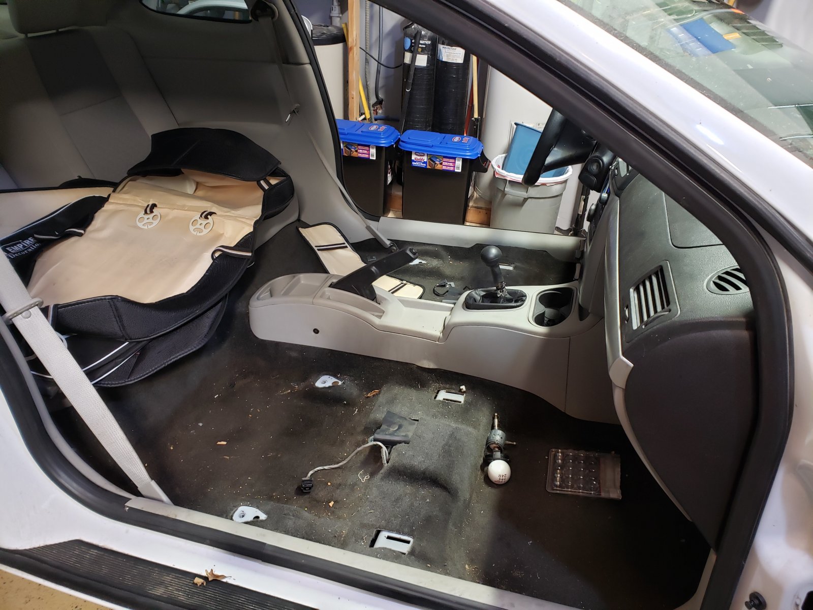

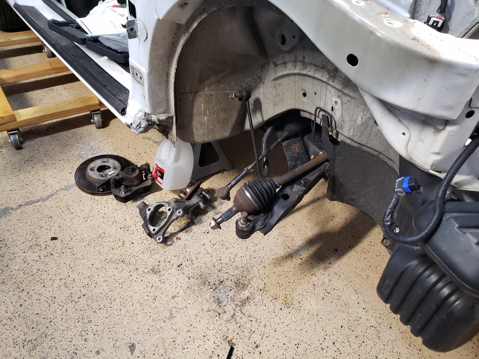

Started taking the front apart more. So I have a few questions.
1. What brake part comes with the kit? I'm thinking about getting the parking brake add on as well. I will need the following.
  • Calipers
  • Rotors
  • Hubs (currently running 4 x 110's)
  • axles
  • bushings
  • tie rod ends
  • sway bar link and possible sway bar...
  • odds and ends needed to complete the parking brake kit.
2. Dropping the motor. Did any of you do it without an engine hoist? I have a tractor with front loader but that will be a tough fit in the garage. Any insight?
Thanks as always guys :)
18409
18410
  • Calipers (My SC kit came with 4 new calipers, I also had the parking brake option)
  • Rotors (came with 4 new rotors)
  • Hubs (Keep the 4 Cobalt parts)
  • axles (The front hubs are the axles, you don't need the rear axle, just the hubs)
  • bushings (What bushings?)
  • tie rod ends (You need the Cobalt ones)
  • sway bar link and possible sway bar... (The Goblin doesn't need the sway bar in the rear, so skip it. Just my opinion, others keep it)
  • odds and ends needed to complete the parking brake kit. (You need the SS cables, aluminum tubes for the cables, & handle,
2. Dropping the motor. (I used a come-along attached to the ceiling. Have done this many times. If you can access the ceiling joists, just span 5 of them with some lumber and attach the come-along to it)
Drop the front of the donor to the floor, remove the 4 bolts holding the subframe to the chassis (along with all of the wiring, hoses and all other items keeping the engine and transmission in the car), and lift the rest of the car off the drivetrain assembly. Hint, you can cut the front sheet metal cross members off the front end and push the rest of the car away.:)

Bushings I mean all the control arm rubbers and ball joints. Thank you.
L

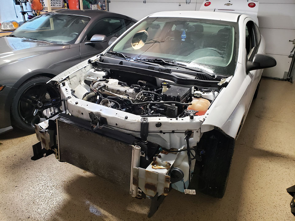

That is a great idea for cutting the front off. Also like the ceiling and come along idea... might try a combo of both :)
Makes it real easy to get the drivetrain out of the chassis.
Oh. I put in the MOOG problem solvers (Control Arm Bushing MOOG K201285). The stock ones were too soft, and causing rear steer problems. Still have the stock front bushings, as they weren't bad.
