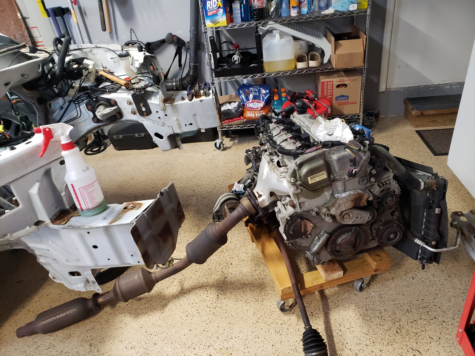

I removed the three nuts from the strut mounts in the engine bay and disconnected the brake lines. I was fortunate the steering shaft was easy to split. Then I put a tire dolly under cradle and lowered the car down on top of it, then removed the four subframe bolts and both side motor/trans mounts and then lifted the body off of the powertrain. The heater core lines got sliced close to the firewall as the body started pulling away. The last thing I forgot was the clutch line but that was not hard to disconnect with a little extra clearance, well before there was any tension.

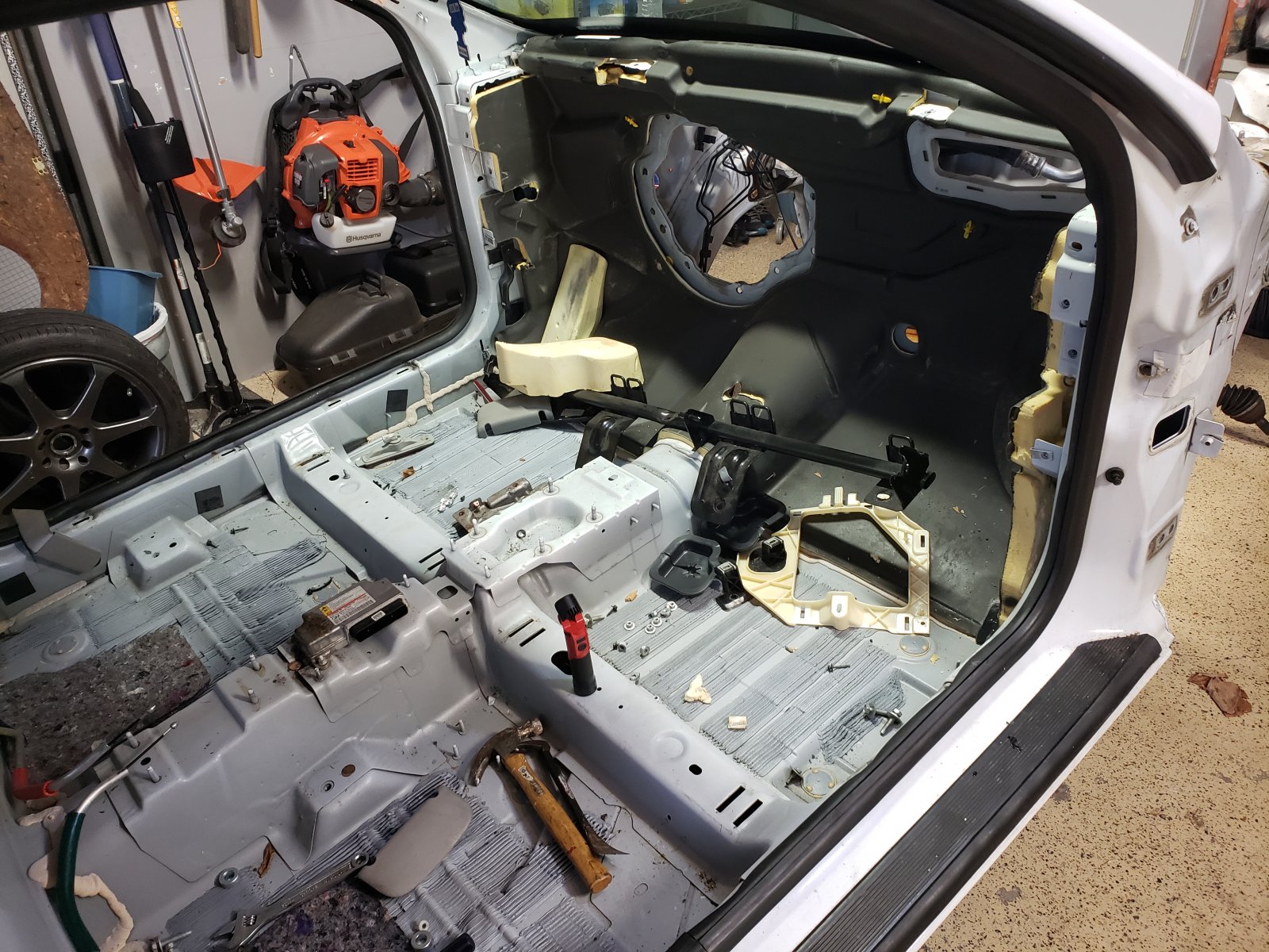

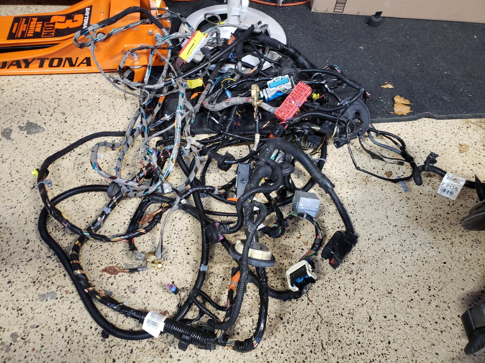

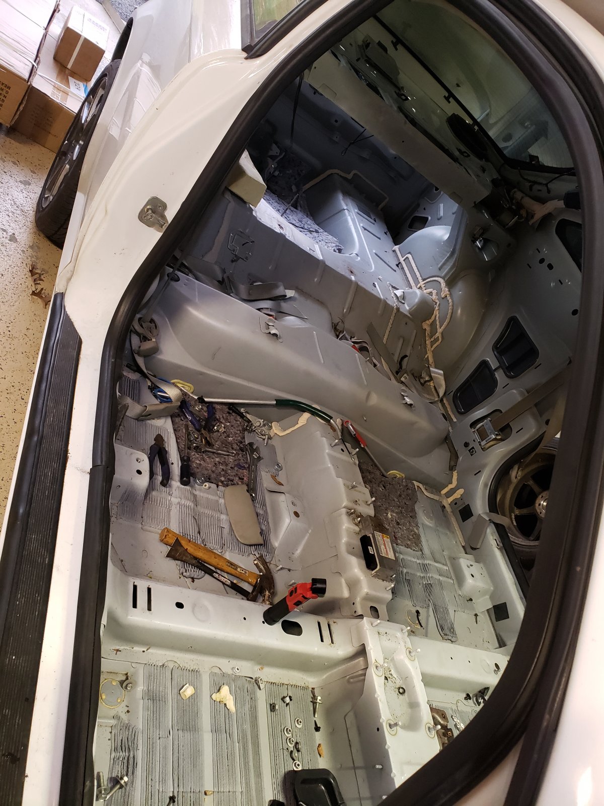

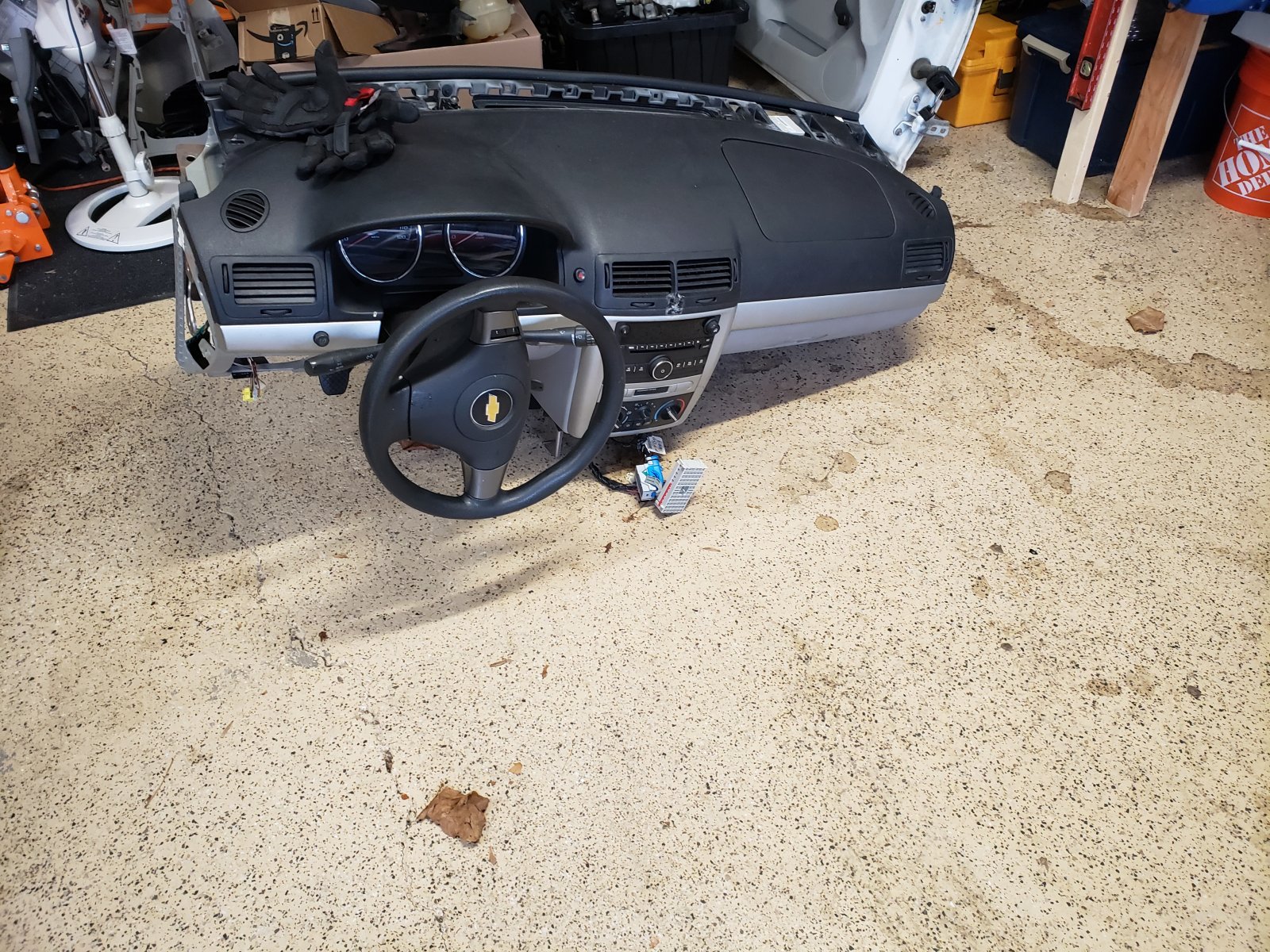

Made some more progress.
Car is basically a shell now. Started stripping the dash. Next decision I need to make is lug pattern and wheel/tires. Getting all new hardware from DF and im buying new hubs. Don't want to deal with drilling in case I ever need to source parts locally. What do you guys think... 4x100 or 5 x 100?

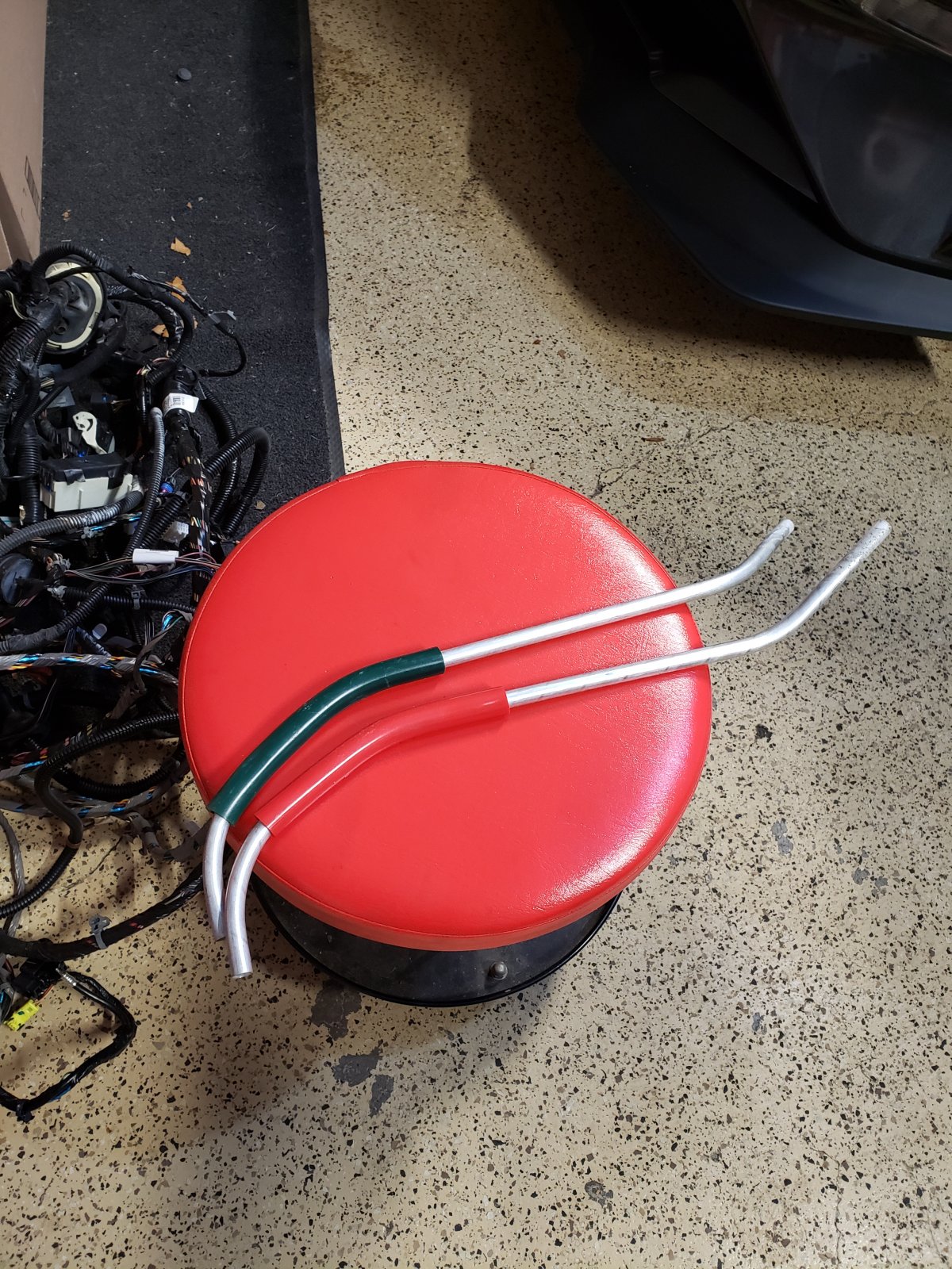

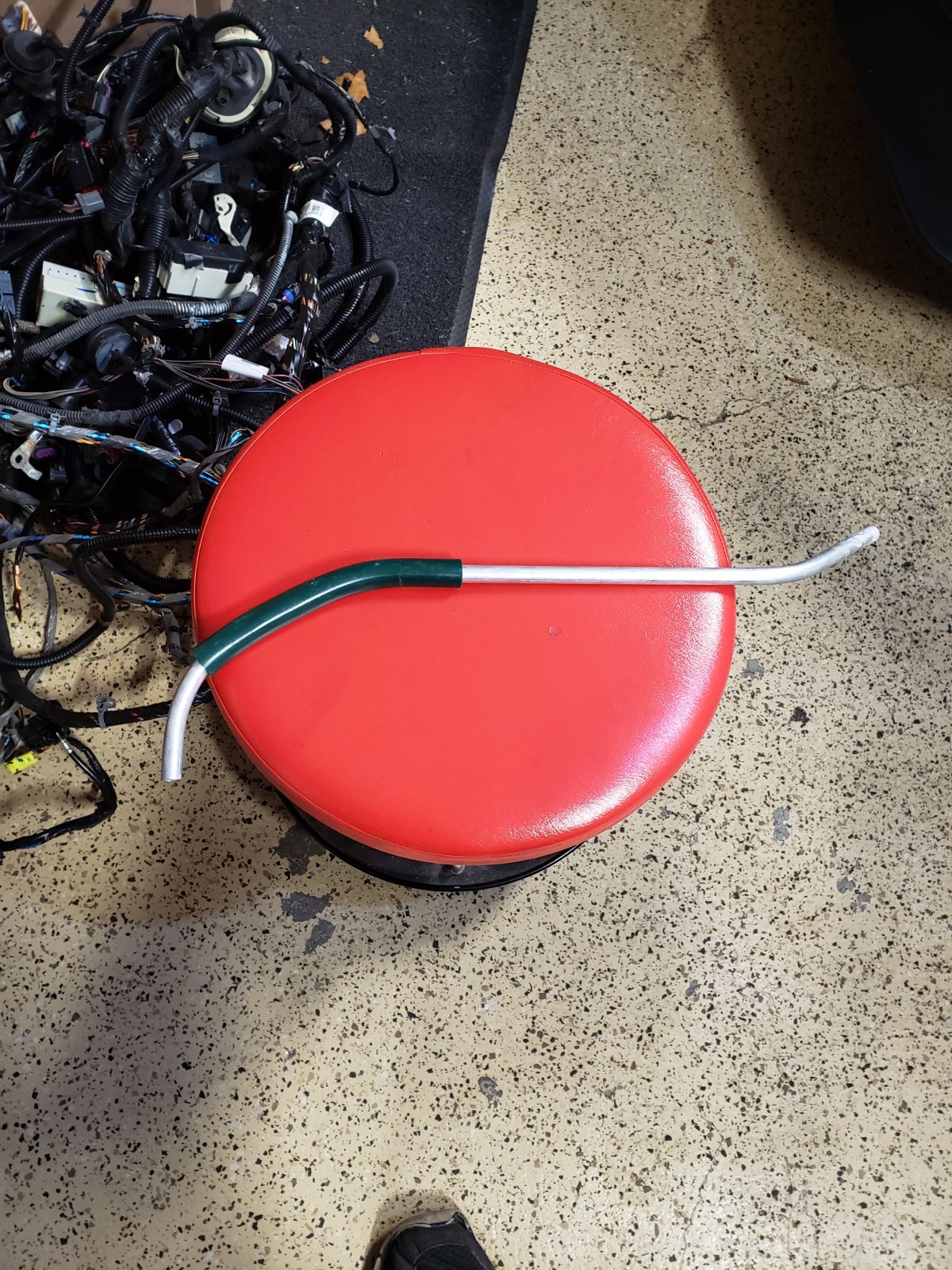

Lokian, you'll need the aluminum tubes, the green- and red-sleeved ones, if you intend to install a parking brake.
trying to see if i can find a replacement for one or both. The passanger side looks like it got hit with something and flattened.
as long as the cables still slide inside of the tubes, their shape does not really matter. You will not see much of them since they are under the engine.

  • parking brake
    • parking brake tubes
    • ss parking brake cables
  • Rims and tires
    • tires - r888 or N05
And the pull handle for the parking brake. And the handle pulls with one short cable, then has a bar that pulls 2 cables.

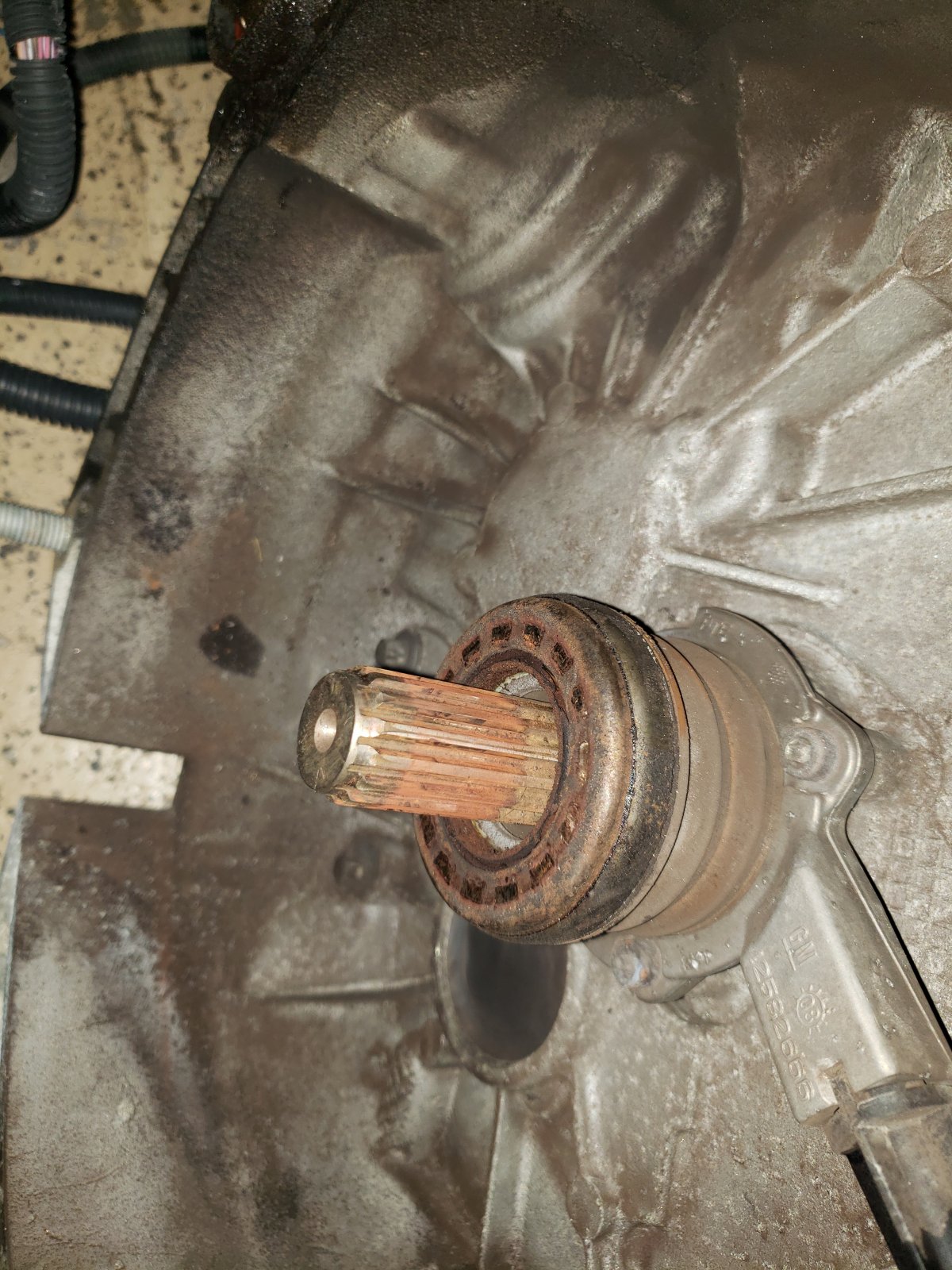

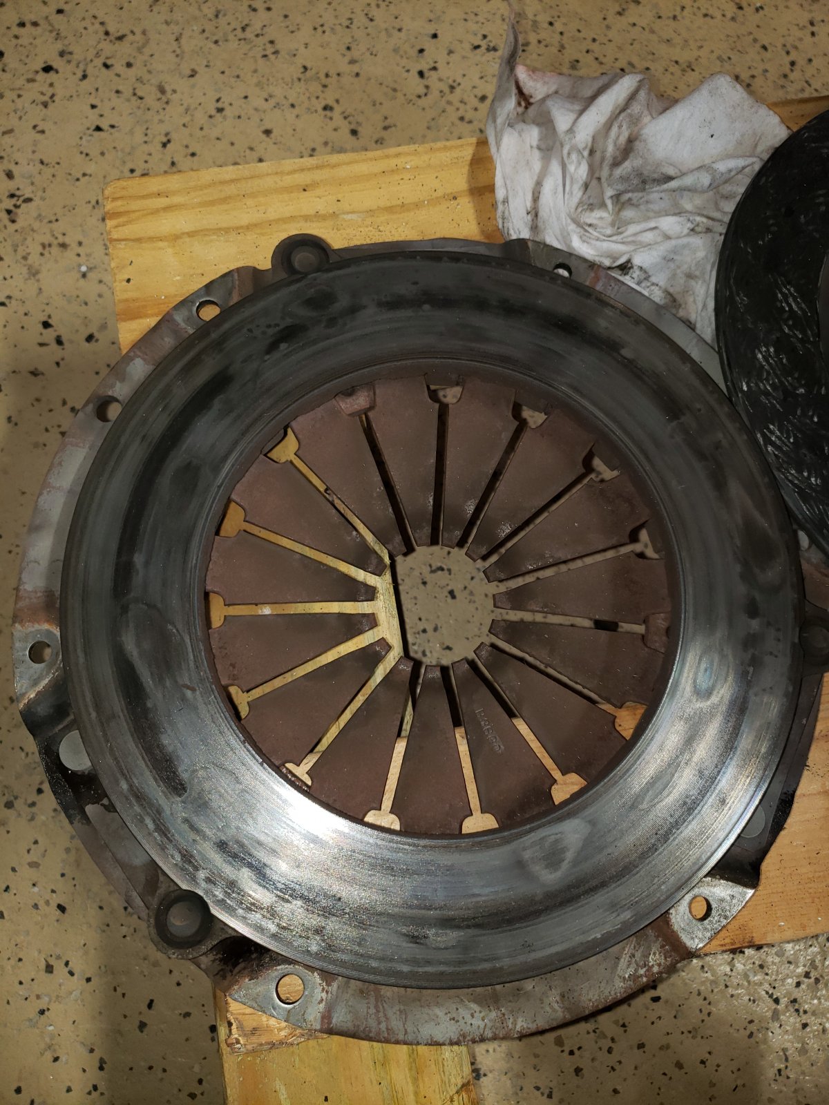

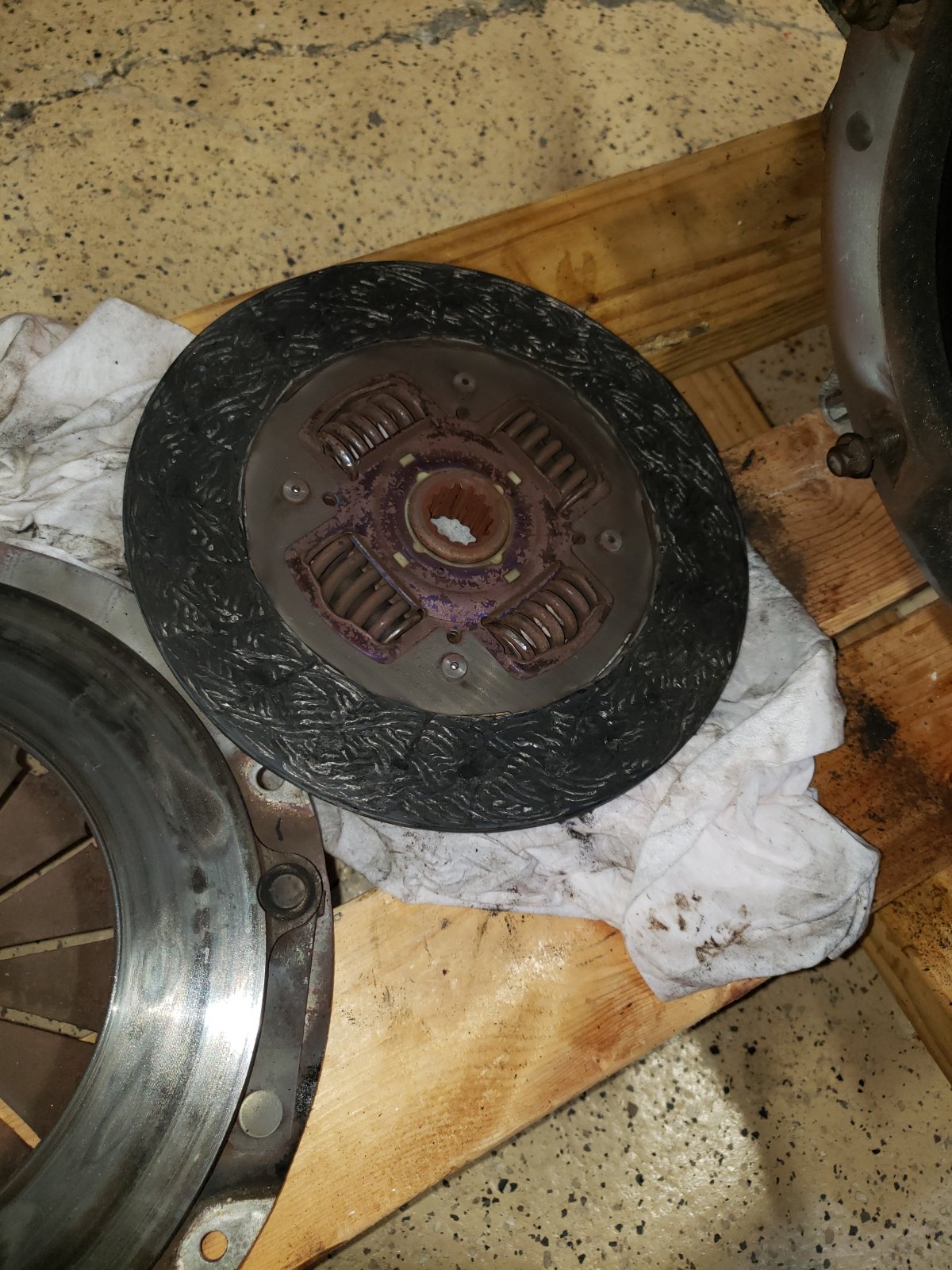

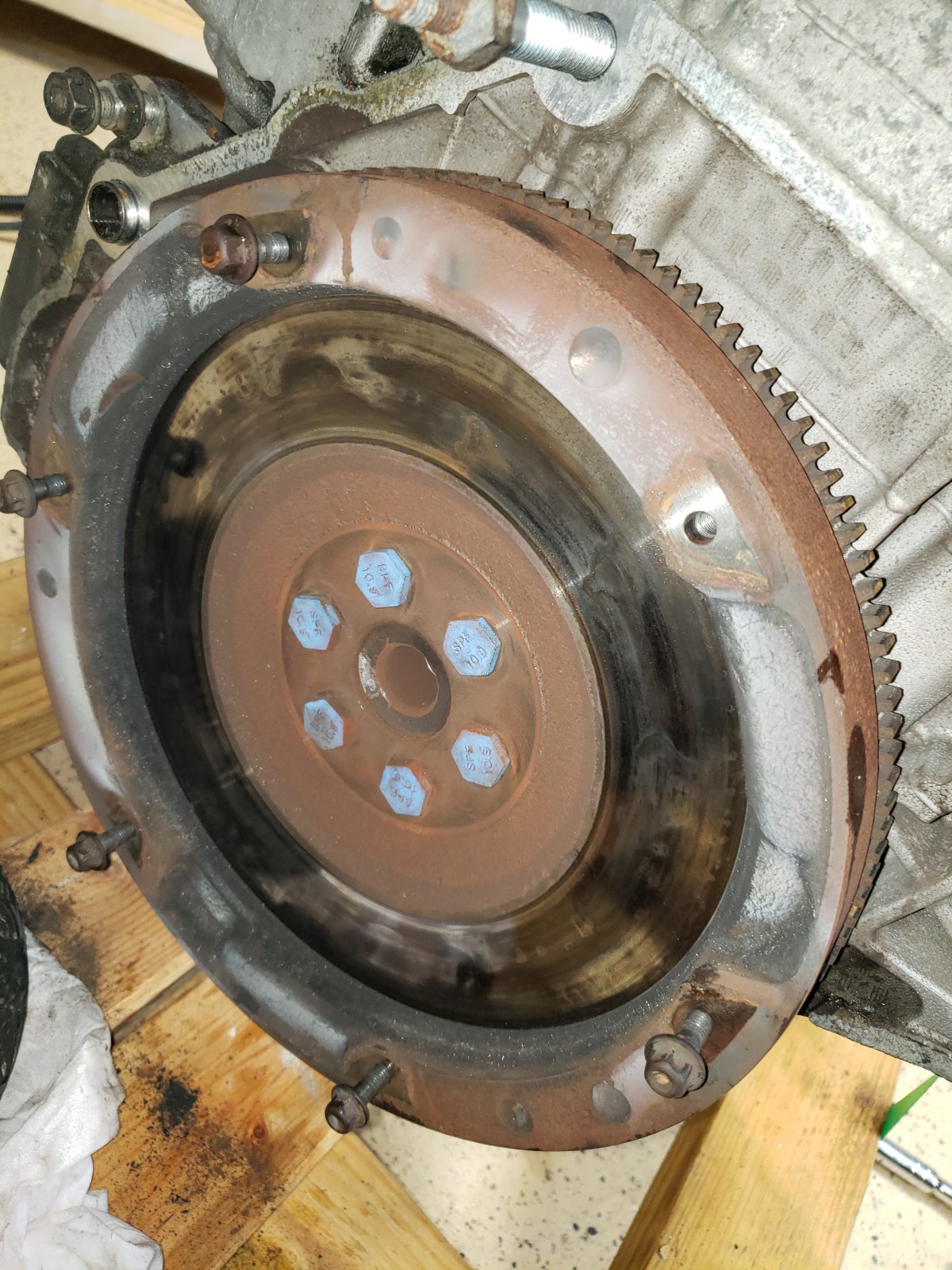

Pulled the clutch apart... I think it could have lasted another 100k (sarcasm). Now to find someone to surface the flywheel
18845
18846
18847
18848
Oreilly auto parts resurfaced my flywheel. $40 per surface, and my LSJ flywheel had 2 different surface heights, hence, $80ish.
