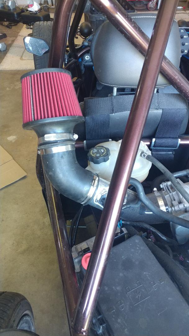

I had seen posts about the issue with the length of pipe prior to the MAF and normally have the filter set as far away as it can go and still seal. For testing I ran it even farther as seen below.

Just to cure my curiosity, rotate the MAF pipe about 90 degrees so the sensor is closer to the top of the fuse box, positioning it on the outside of 45 degree bend coming from the filter. See if this makes a difference, then rotate it 180 degrees so the MAF is furthest away from the fuse box, positioning it on the inside of the 45 degree bend.
There will be differences in the airflow at these positions from where it is now when the airflow velocity is slow. Maybe it will help, maybe it won't but can't hurt to try it. :D
R
Hey Sas, I tried it in nine orientation combinations with the bent pipes. Also tried it in three orientations without the second bend and just the filter connected to the MAF tube. I couldn't tell a difference. I even tried loosening the upper 90 and rotating it while the engine ran... Maybe once I get a smooth idle I will be able to tell something... but not yet.
