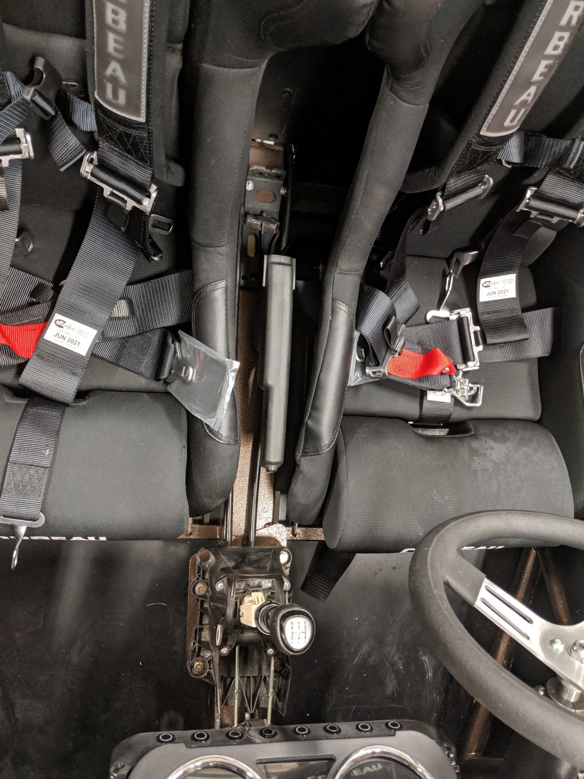

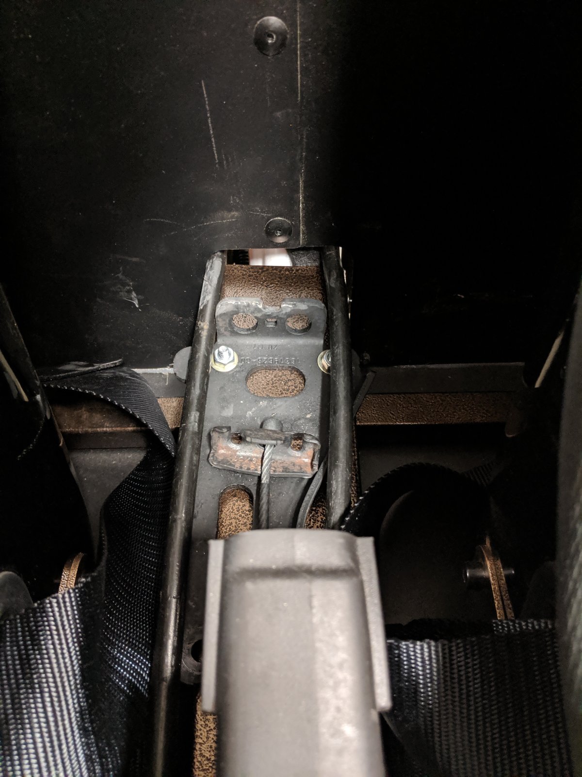

What a pain...I worked on the ebrake today. Figured out a lot of my questions. I also realize why there are no spacers in the rear. It really needs to be mounted like the pictures that lonny posted. The lines would be to high if the shift cables ran under it and not beside it.... But you'd only see this if the rear firewall is in place. See below
The cable tubes aren't scratched as much as they look. But I should likely put some edging on the firewall.
Now I need to go too the junk yard and get the tubes and lines...
It was such a pain because to mount the bolts I had to take the seats, cables, and tunnel out...re-rivet them...glad it's done. Hopefully I can make it out to the junk yard tomorrow.
Thanks for being a pioneer... I have started the E-brake process, and your pictures help. I was thinking of using rivnuts on the tunnel just in case I want in there for future changes.

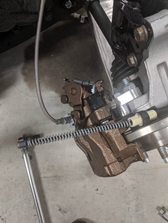

I made it out to get the cables and tubes from a pick and pull. It was an automatic SS, but everything looked the be the right sizes. Not easy pulling it all from a smelly car that you can't get the wheels off of...20 bucks later I've got what I need. I'll put it all together sometime this week.

I finished up the Ebrake yesterday. Everything is tight and works as it should.

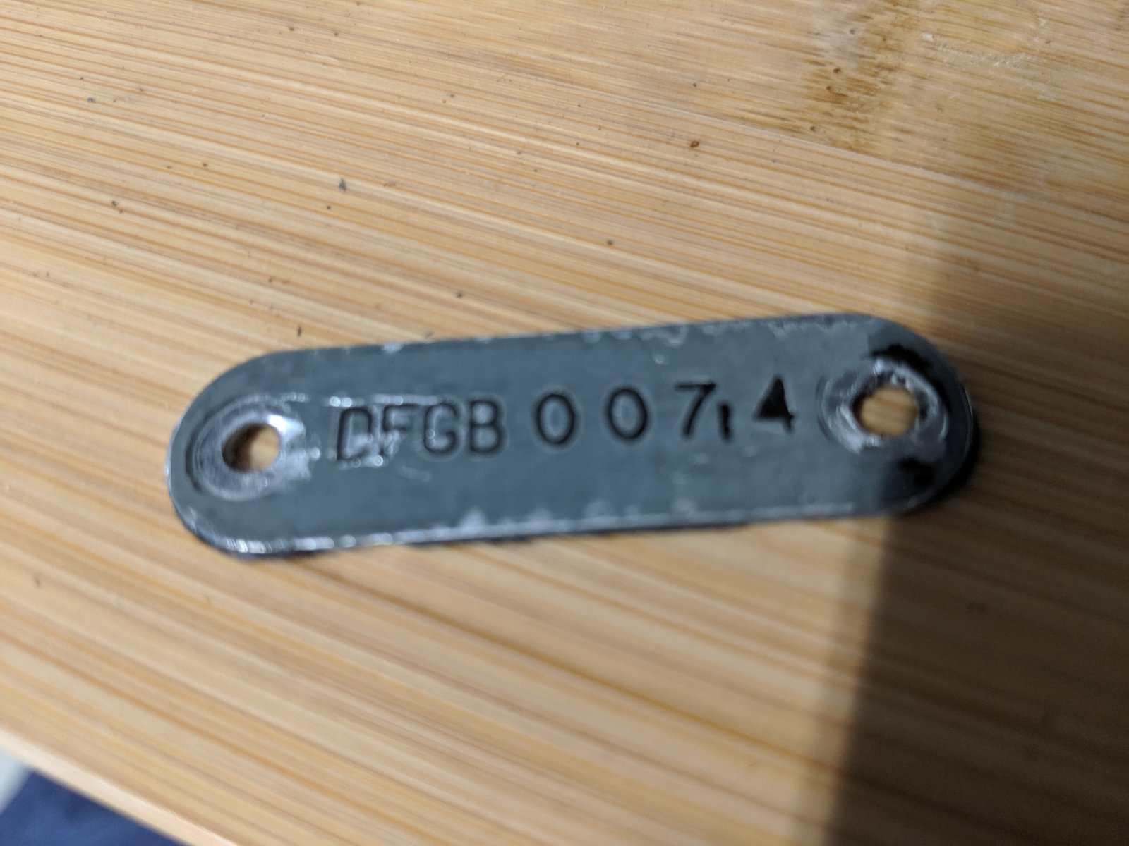

Well...No registration yet. Since I don't have a title and I'm looking to register it in Montana I need to find an officer to vin/serial number inspect it for paperwork.

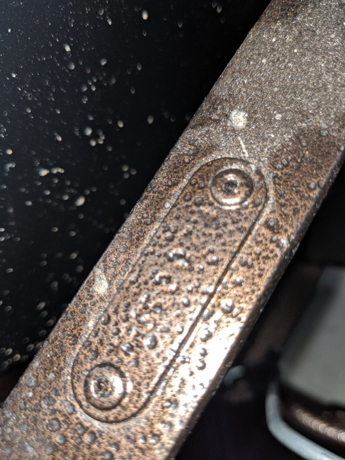

My serial number was powder coated over so I had to take it off to strip it then re install.
Before:
After:
