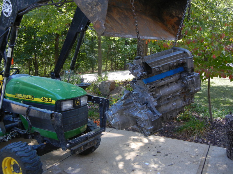

To answer your question about how we painted the engine, I put it up on a large bench I have in the basement garage so I could work on it whenever I wanted. To get it up there and to paint it, I used this handy little tool...

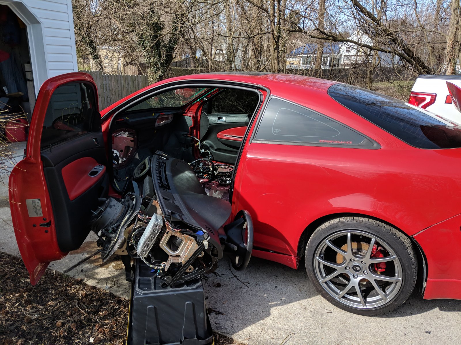

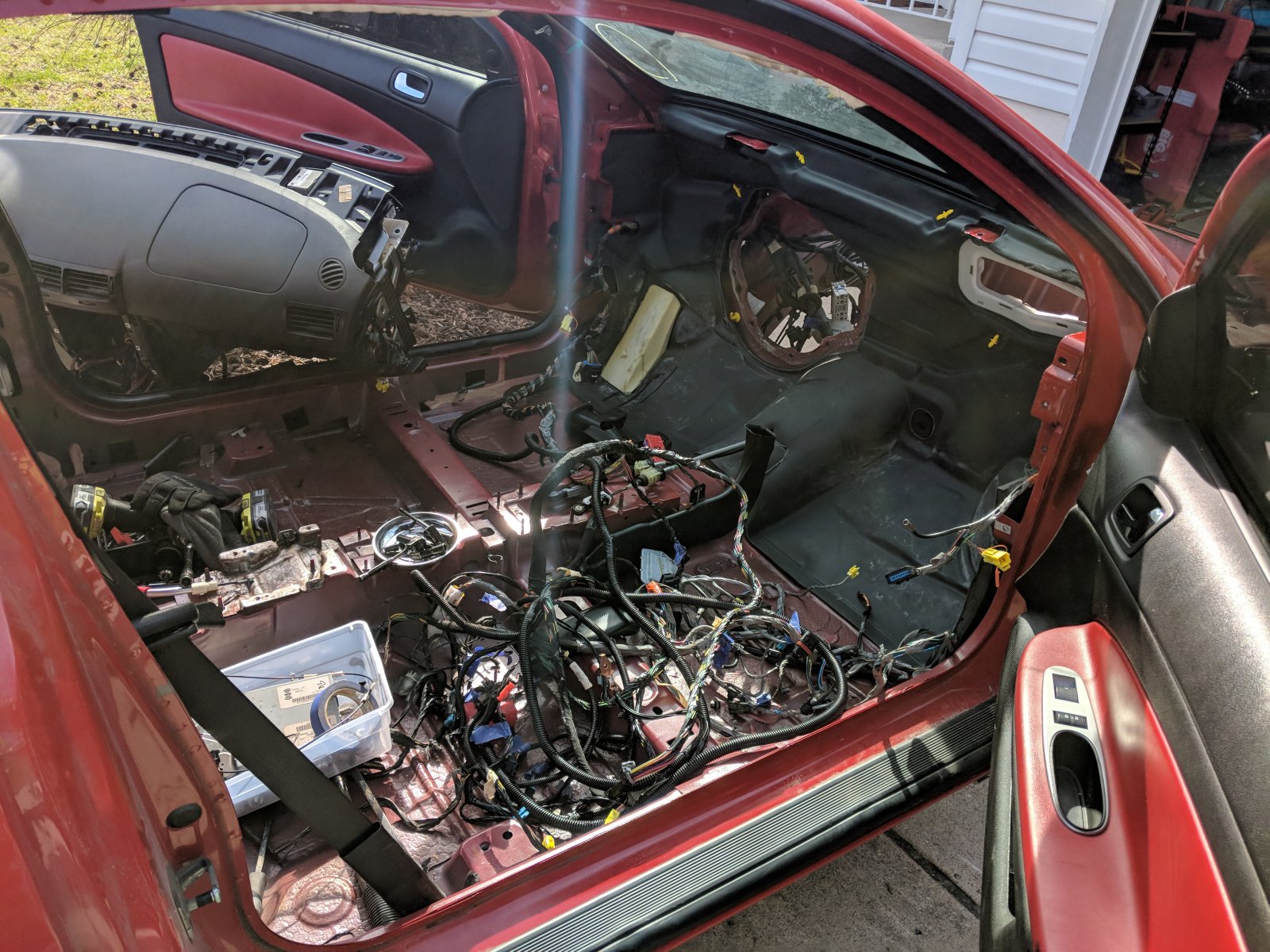

Spent a few more hours this morning working.

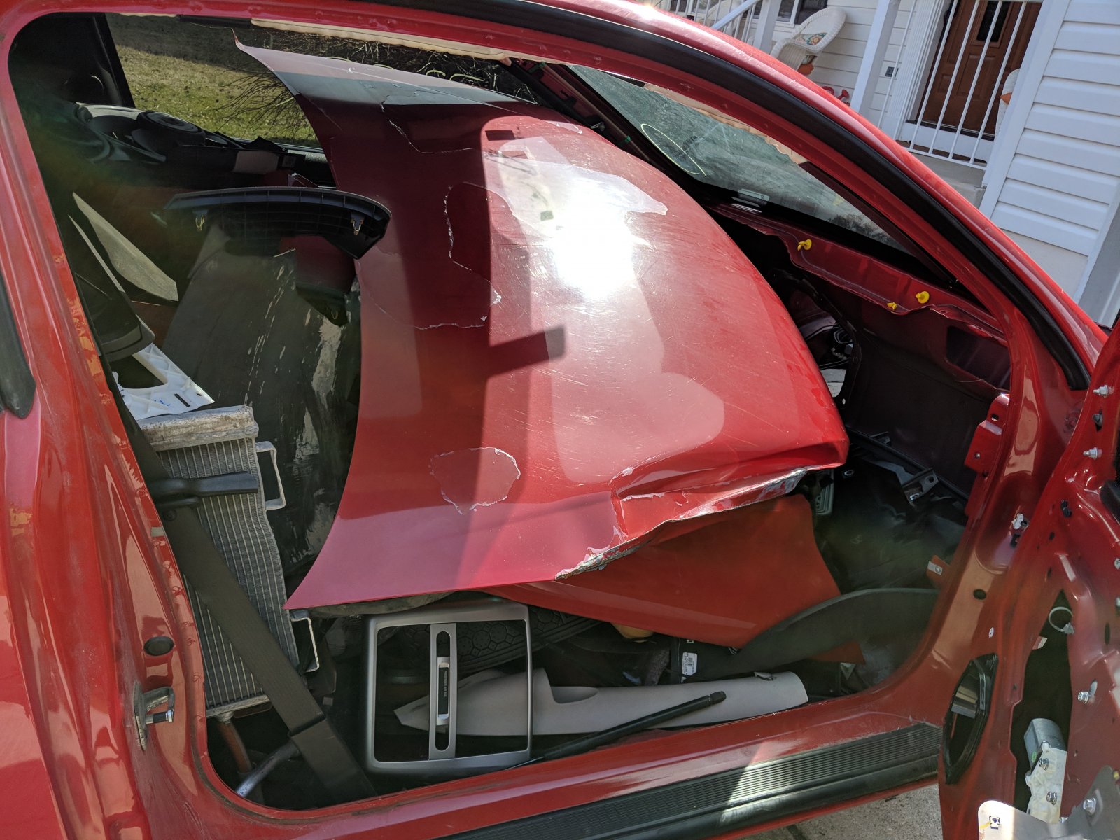

You guys were right. The dash is heavy. I ended up removing it on my own. At first I thought I was going to have to slide / roll it but to my surprise I had it essentially dead lifted and made it into the garage.
The wiring harness is removed and the last thing I need to do is remove the fuel tank / whatever is associated with the rear.
Do we need the front seat belt bolts for assembly? I don't have a T50 so I didn't get those removed.
At this point everything is in the car and hopefully next weekend I can get rid of it. I need to figure out who will take it. Any recommendations?

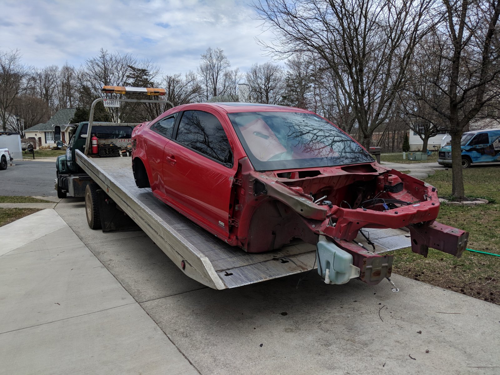

A little more progress...I got rid of the cobalt, gave it away in return for someone picking it up. Otherwise I would have had to rent a trailer to scrap it myself.

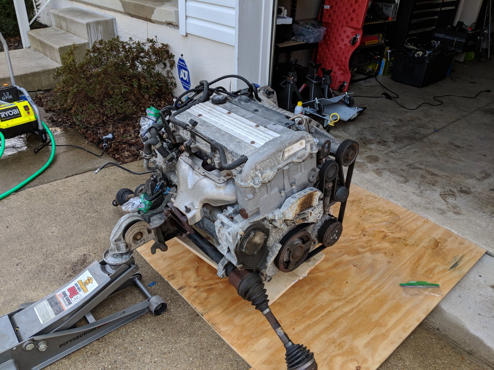

Then I pressure washed the engine, subframe, etc...the engine could def use some cleaning still. I think I'll really have to take my time to get it to where I want it. The picture is before the wash.

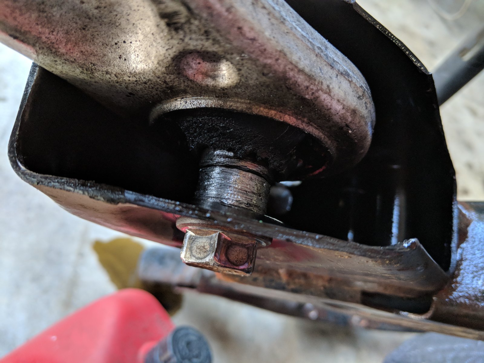

When I took the subframe out one of the bolts was seized in the control arm bushing so I worked on getting it out. About 1.5 hours struggling with all the wrong tools (like multiple hammers, sawzal, impact wrench, torch etc) I decided to go get a cut off wheel big enough to do the job. A five minute drive to home Depot and another five minutes later the bolt was cut enough to get out.
So now I need to get a bushing and an subframe bolt. I don't have a press but I think iIcan rent the kit at advance Auto. My head is still ringing from 30 minutes holding the sawzal.
I pressure washed my engine and transmission also. A month later I found out water had gotten into the clutch and rusted the heck out of the flywheel. Destroyed it. For me it did not matter because I was going to replace the clutch and flywheel anyways.

Also I read that the subframe bolts are not reuseable...did you guys get new ones?
On my aluminum arms, I had a shop press them in for me. On the base Cobalt I worked on, I was able to press them in using and old carb and the log splitter (don't ask, it wasn't pretty but it worked great).
