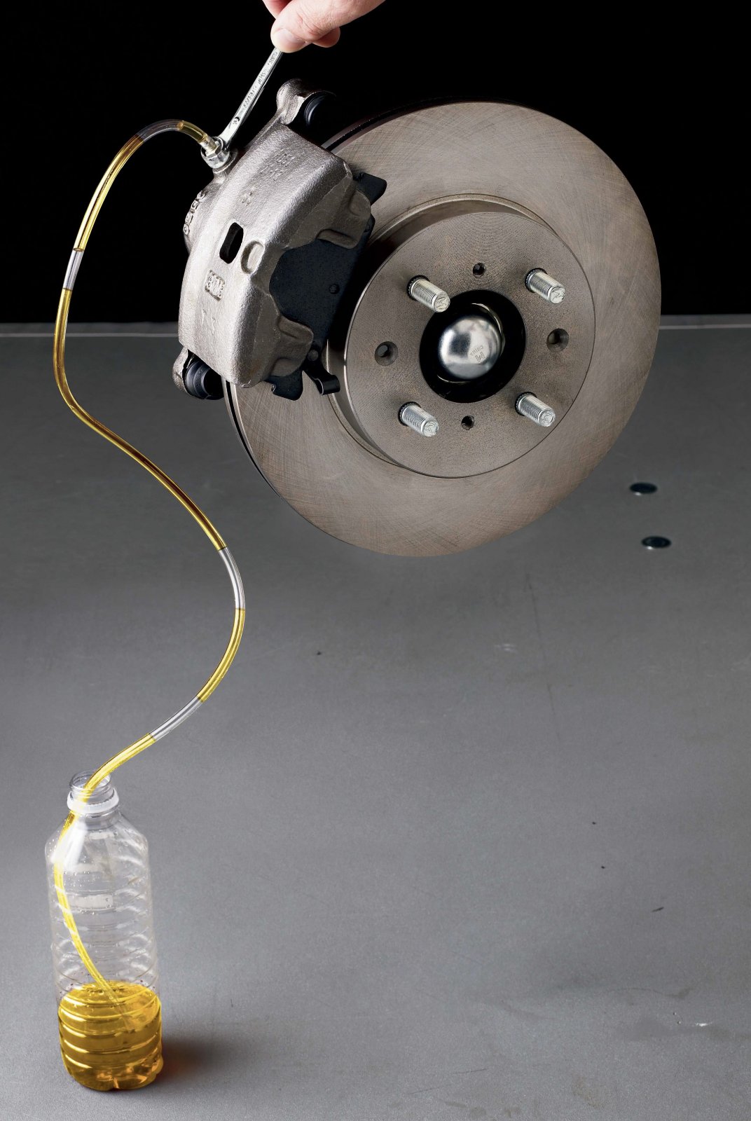

money saving tip:
poke a hole in cap of an oil oil jug and run a hose from there to the bleeder screws on the calipers. Open caliper bleeder valve and pump the brake pedal. The fluid will go into the can without a mess.
something like this
I actually have a bleeder kit without pump, but I always used it when I had a second person to help me. I figured I would get the kit so I could handle it solo. Worst case I may see if I can give this a try. I guess thinking about it now, I'm not trying to bleed the brakes and get air out I am just trying to empty the line.
I'm hoping I can actually open my bleeder screws. The from rotors are really rusty.
Yep. Just trying to empty the system to keep from making a mess.

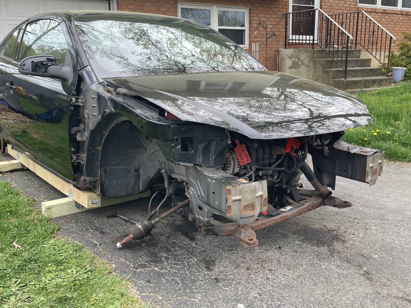

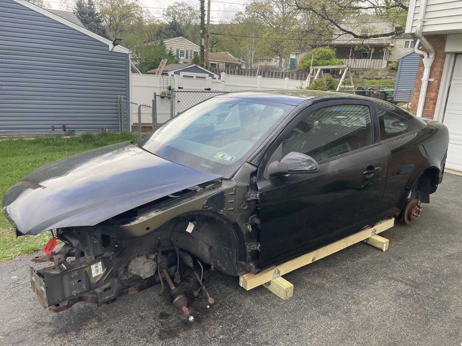

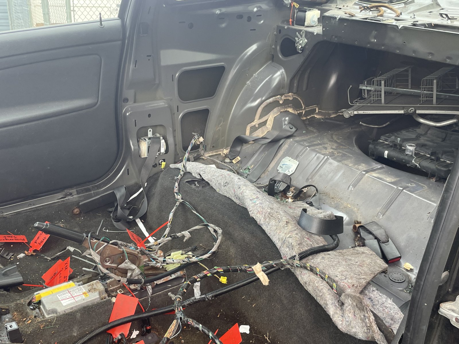

Ok guys been a productive last few days especially today.
got everything wiring harness related pulled from the truck to where the carpet starts.
Pulled the front suspension. The sub frame is ready to come off but that pesky steering column is still holding on. The bolt came out no problem but haven’t gotten the shaft to let loose.
Had to close it up for today because nasty storms are about to start.
I wouldn't mess with it - just cut it.
Many of us were able to get the shaft off just fine and still had to replace it because it wouldn't collapse or was just a mess. Some have had success reviving them, but for $45 and the fact it's your steering we're talking about, it's just not worth it IMHO.
Metal Mech
I can try cutting but getting to it isn’t that easy.

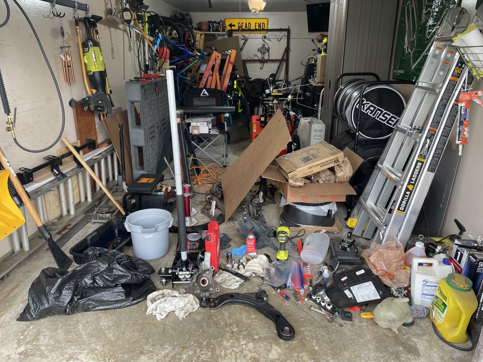

Well I got the interior stripped down to the point it’s time for the dash to come out.
Still no luck on the steering shaft. Comegetjoe came over with a pry bar and we messed with it for a few mins. We determined the next step is cutting it so I may give that a try tomorrow.
Right now my garage is an absolute mess. So probably need to work on cleaning that up this week.
Really hoping I get my frame back before or on the 4th/5th of May. Got a four day weekend that would be awesome to have the frame for.
Overall a very productive weekend.

I tell ya. I give y’all props for building these in your garage. I have a big shop and it was nice with all the space. I put off this project off for a few years because at my old house, there was just no room in a 2 car garage filled with motorcycles and 4 wheelers.
Metal Mech
It’s been a journey. My garage has been my storage shed for years. I finally got a separate storage shed and started organizing the garage into a workable garage/shop space. None of my daily cars will fit inside so it’s perfect for working on and storing the Goblin.
Still needs a bit of work to get it where I want. That’s on me though. I been so excited to start on the Goblin I been putting off garage and shed organization haha.
