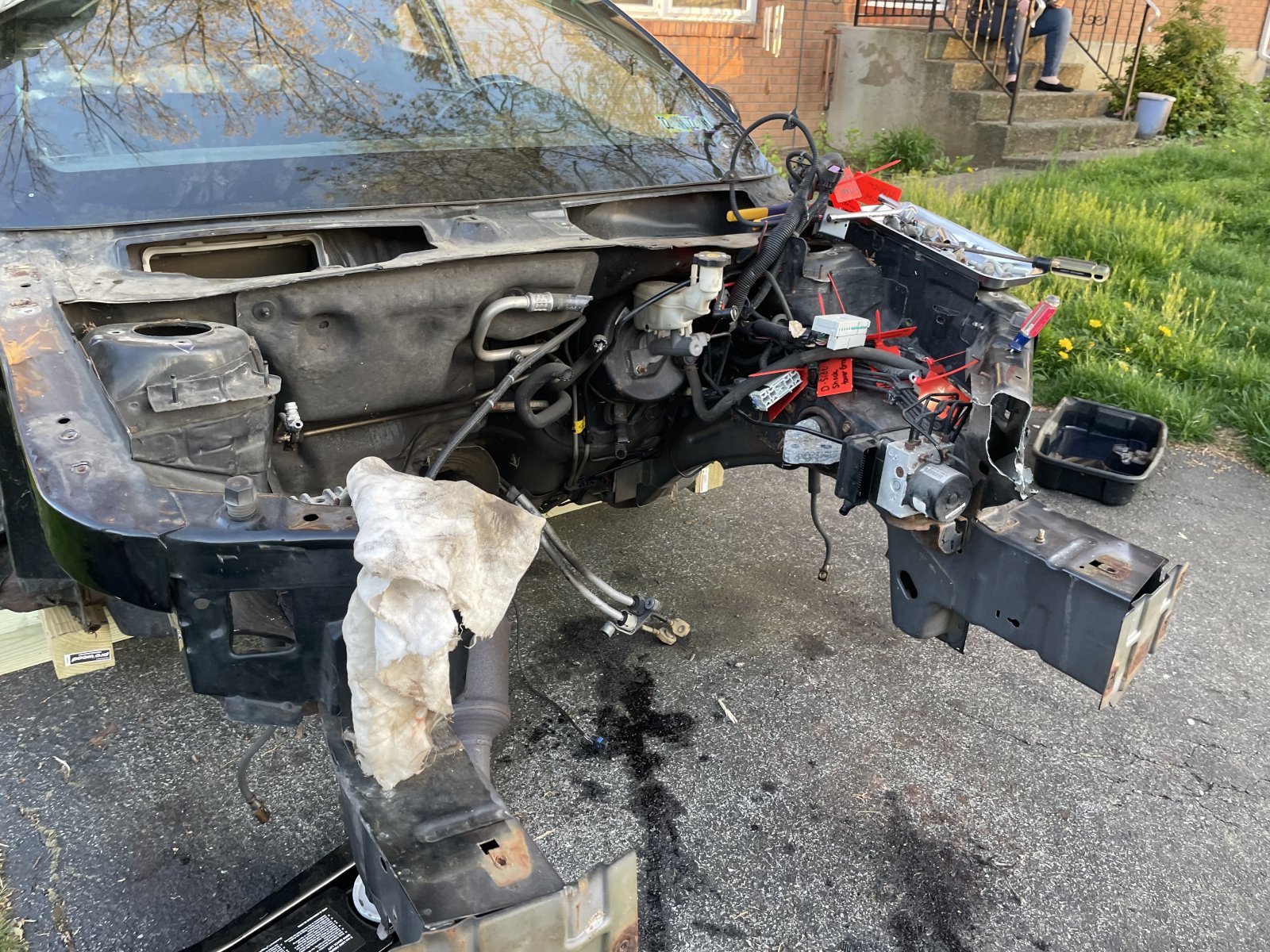

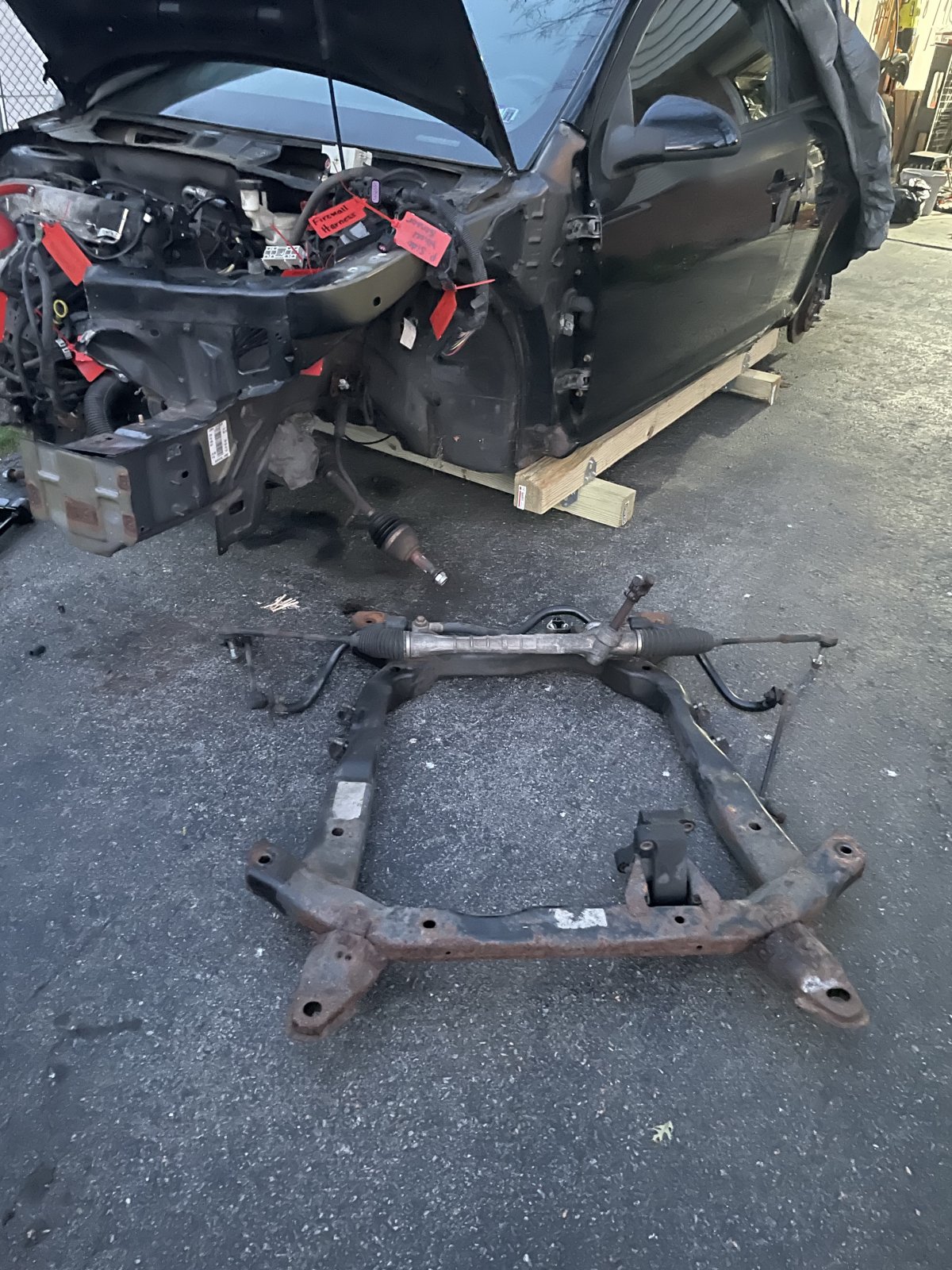

No my steering shaft won’t come off the steering rack.
My entire sub frame is literally hanging on only by the steering shaft. The bolt was completely removed with no issue. Today we took a pry bar and pryed open pinch clamp. Still no dice. It’s rusted solid. Its even been doused in penetrant multiple times.
Metal Mech
Oh ok, thats unfortunate. My only other suggestion would be heat and a lot of it, but I'm sure you have already tried that.
Don’t have a torch but do have a saws all and a good blade. Plus I am hesitant to apply a torch in such a small area where a lot of chemicals including fuel have been spilt lately.

Success, I took the saws all to the steering shaft this evening. Cut through one side of the U-joint and the other side popped off.
I am still gonna have to free it from the steering rack but that’s a project for a later time. Now time to pull the engine and transmission.

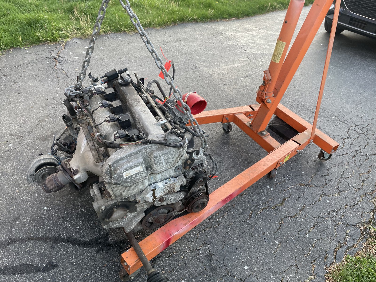

And the engine is out of the donor. Feels like a big milestone reached. Now to get it in the garage. My drive way really sucks for rolling heavy stuff around.
Up next is the dash. Probably spend weekend cleaning up my shed and garage. I cleaned it up enough to get the sub frame and engine inside but I need to get the snowblower and grill out so I can have room for the frame when it gets back from the powder coster. Whenever that will be.

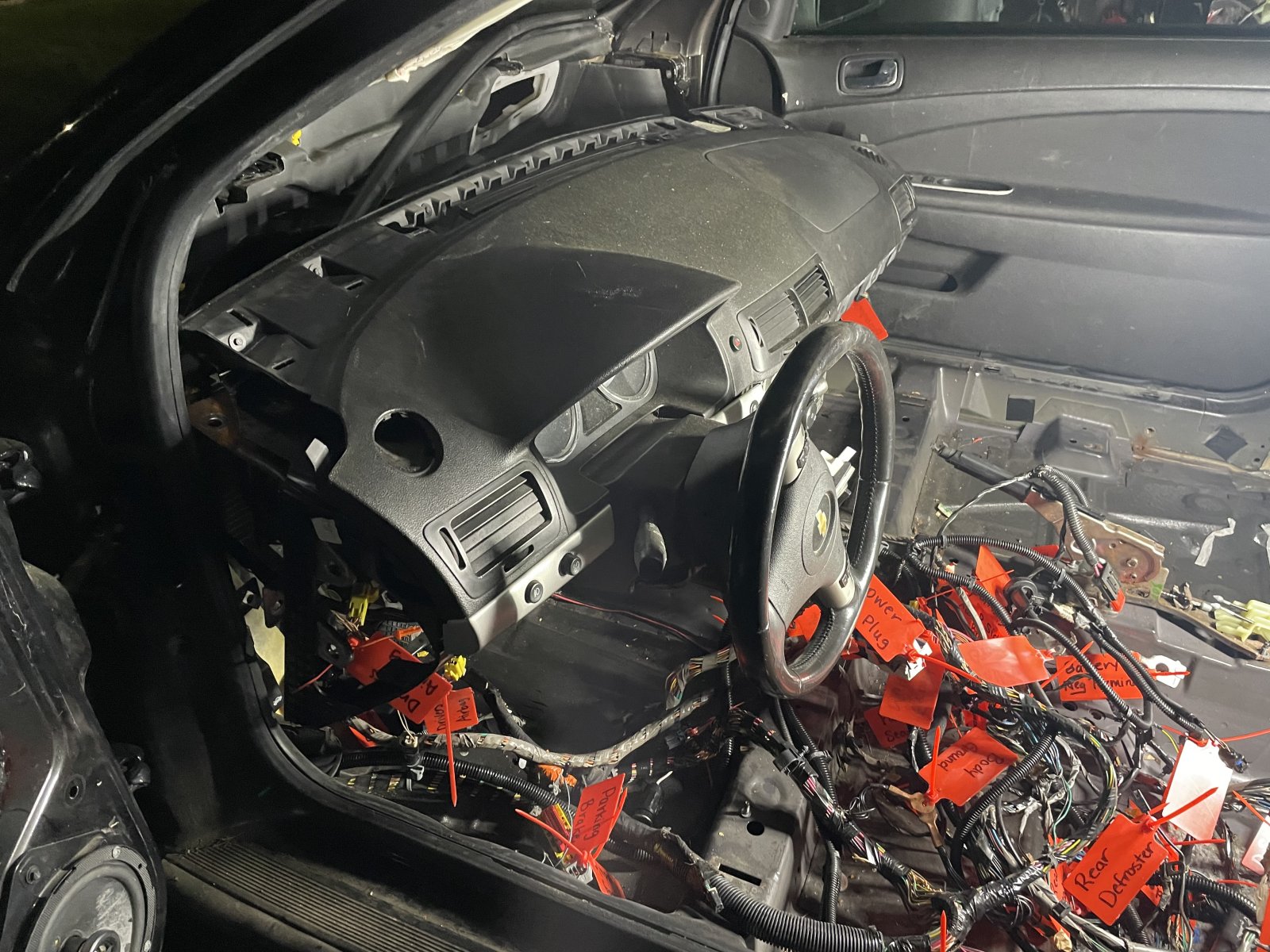

I hope you are labeling and labeling and labeling if it’s going to be that long before you are assembling. And especially on the wiring harness. People think that they can trhow up a picture of a connector and those of us who have completed the Goblin will remember exactly what it is. After several months you will start to forget which are which. Label, label and label again.
I hope you are labeling and labeling and labeling if it’s going to be that long before you are assembling. And especially on the wiring harness. People think that they can throw up a picture of a connector and those of us who have completed the Goblin will remember exactly what it is. After several months you will start to forget which are which. Label, label and label again.
This is the truth. I barely remember wiring mine at this point.....
RCK605
Don't take multiple month breaks if you can avoid it. I did that a couple of times and usually spent half a day figuring out what I had done and where I needed to start on the videos again.
Metal Mech
If you look at my photos and you see all those red tags, those are my labels. I have put one on every single connector end and on items like hoses and even obvious things like the BCM and ECM. I am not taking any chances. I have seen way too many "hey where does this go?' threads.
I have also been bagging and labeling important bolts that I am not able to put back into the part it came off of. Otherwise I try to keep everything together.
