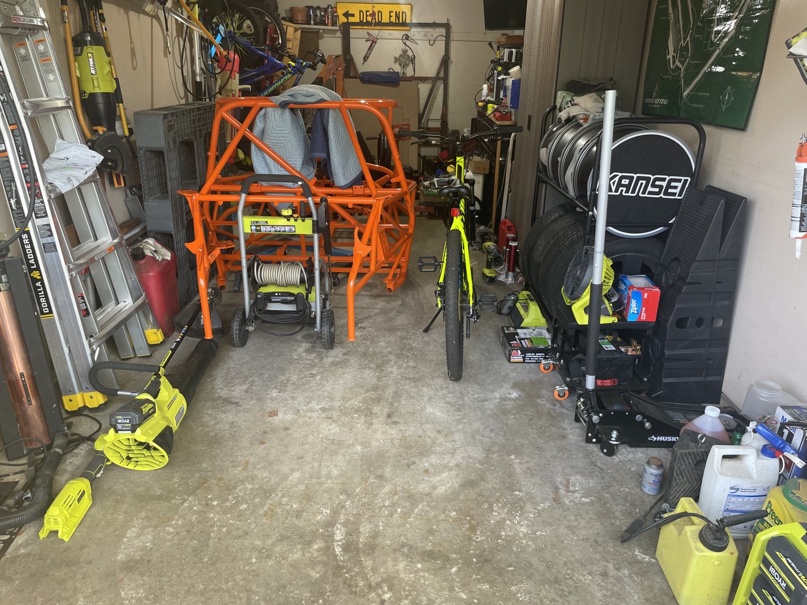

Well it’s not quite perfect and still needs some work but my garage is getting better. The frame is in and there is actually lots of room for activities.
40419
I gotta give you guys props that do these in a garage. I held this project off until I had the space. There was no way it was gonna happen in a 2 car garage with 4 motorcycles in it. Once I move to where I am now, I decided to jump in. An airplane hangar is good space for this project. :D
Sluggonaut
An airplane hangar would be a luxury. I stripped my donor in a 10x20 storage unit with no air or electricity. I did the build in my 2 car garage and felt I had plenty of room to work along with the bonus of having electricity and air available (air tools would have been nice for stripping but weren't needed for the build).
I switched everything to battery power (all Milwaukee). I would say I only use my compressor to air up tires, but that’s battery powered too. :p
Mahkoi
Same. Except for the powdercoat gun, tires and when the air hammer needs to bail me out of problem. The compressor doesn't get used too much anymore.
Fozda
I switched over to electric everything but there's still a fair bit of stuff that needs air like the tire machine, blast cabinet, plasma cutter, etc.

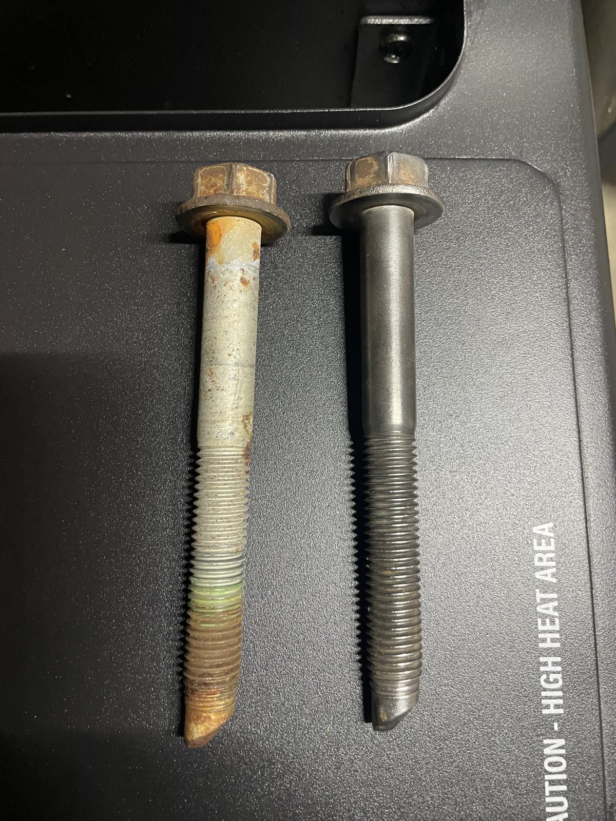

Got my 14mx2.0 tap today. Along with the winch.
Didn’t get a chance to build the winch yet but I got the rear threads cleaned out and I took one of the bolts to the wire wheel on my bench grinder. Still need to clean the head up a bit more but totally night and day. Test threaded it down the tube and goes in nice and smooth.
Metal Mech
A little anti-seize when you install it for the last time and some paint on the shaft/head to keep the metal mites at bay and will be as good as factory!
I usually use anti seize but I read an about someone having trouble keeping it tight and using loctite. So was wondering if I should go that route.
I don't recall seeing these bolts as a common problem coming loose. Torque them correctly and they should stay put, even with anti-seize. A 14mm bolt is good for more than 100 ft.lbs. - but follow the DF spec.
Those bolts don’t normally loosen, but some mild loctite is not a bad thing. The front ones that are square bolt to round hole may need some retightening once you get some miles on it and it settles in.
also it’s a good idea to put a wrench on all nuts and bolts once a few miles are put on it.
