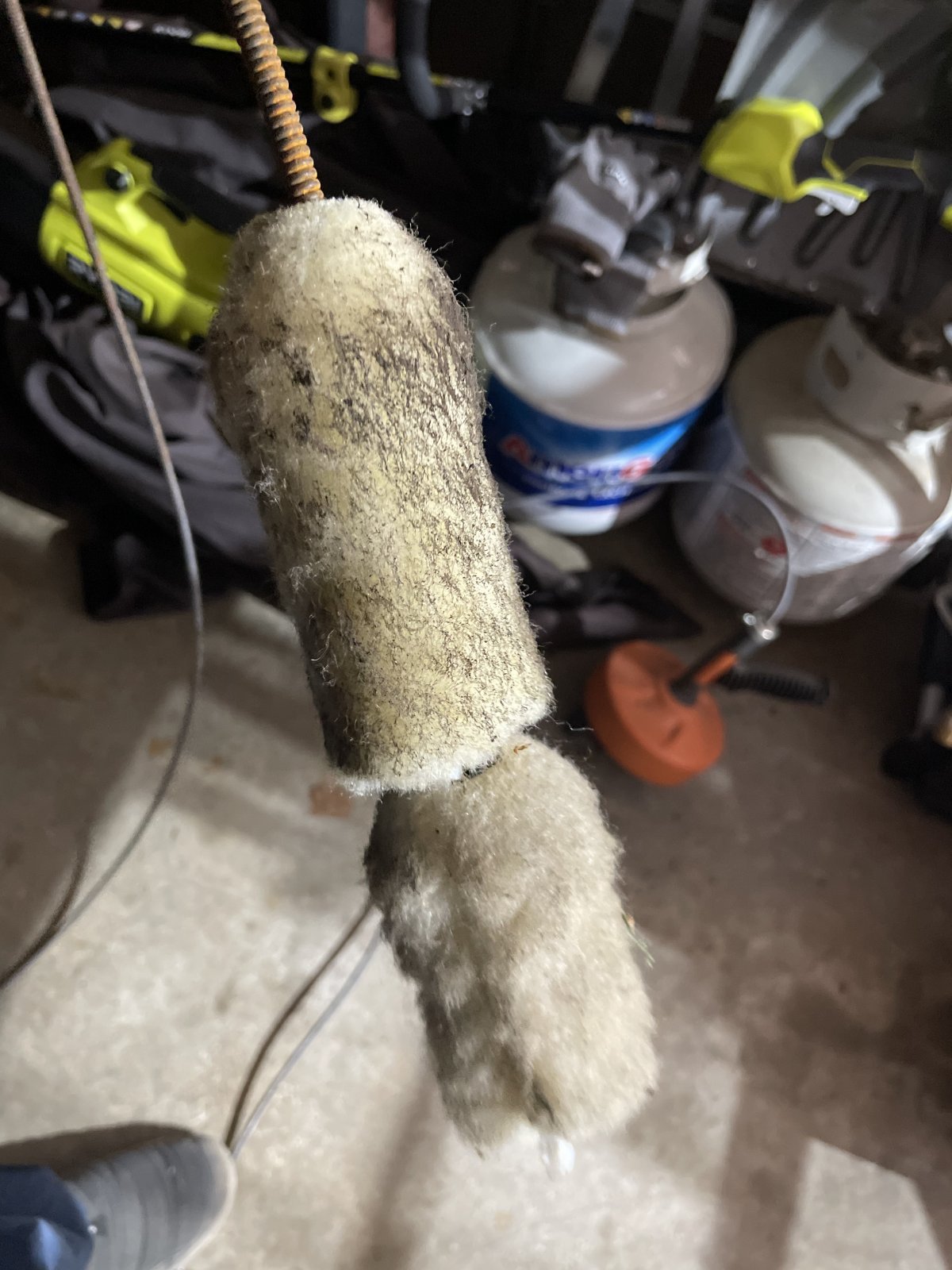

Yes, that’s how I read it and was giving suggestions on how to get hose out. I didn’t do the paint roller lube method.
Yeah sorry about that: I can see how it was confusing
I actually didn’t do the paint roller method to Lube the tube, probably should have. I just did a dry run to get out all the nasty gunk inside the tube.
40697
Metal Mech
And now the hose is stuck 2/3 of the way in the tube. I don’t understand why this second one has to be such a pain in the butt when the first one went so smoothly.
i did everything exactly the same. So frustrating.
It looks like it was 50* overnight in your neck of the woods. That hose is cold. Set it out in the sun for a bit.
Joebob
Use the paint roller to lube as well. If you are winching it into the chassis from the front to the back, lower the front, have a helper rub lube on the hose as it goes in AND you can pour a 1/2 cup of lube from the back into the tube after pulling a foot or so of hose it to keep it from running out the bottom. This will keep the leading edge wet and help pull it in easier. Like @Rttoys stated, you need the hose warm either from the sun or sitting in hot water for a while to get it pliable.
Yeah gonna have to get it back out first that that’s not easy either.
I have had help with the kid cranking the winch while I push the hose and lube it. I didn’t have time to sit it out in the sun but it was in the warm house so it didn’t get too cold. Also was trying to get it done since the wife decided to take him to the water park today even though I had made it clear I wanted to get things done on the car.
So now I have no help and doing other things to not think about it at the moment.
Joebob
When you winch, make sure the rope or strap does not stretch under load. A lot of people can struggle with the hose breaking for whatever reason and at least one admitted to the winch end smacking him in the chest which is doubly worse if a shorter person in the one cranking on the buisness end of the car. Stay safe and don't rush it.

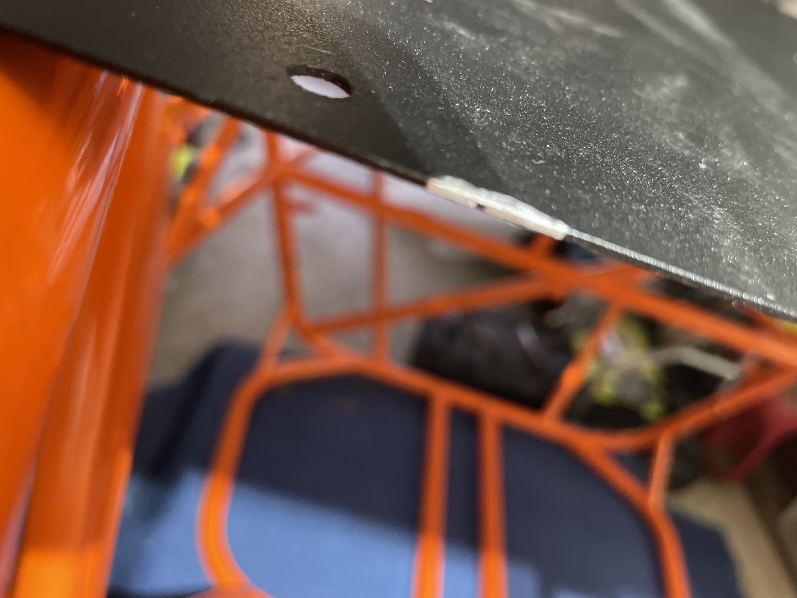

Found a damaged spot on my floor pan.
Not worried about how it will look or rusting. More about it possibly being a weak point for the powder coat to peel/flack. Rustolioumn paint has bee suggested. Anything else I should do or am I just over worrying about it?
40719
The floor pan is aluminum so it will not rust. Hit it with some rattle can in the same color and finish - and we promise we won't tell the concours judges you have a paint flake missing on your floor pan. LOL! :D
Most of us don't store your goblin outside, and drive in the rain. So the occasional puddle splash will take years to oxidize the aluminum enough to start flaking the powder coat. DS suggestion sounds good to me, and "mom's the word" for the concours judges.

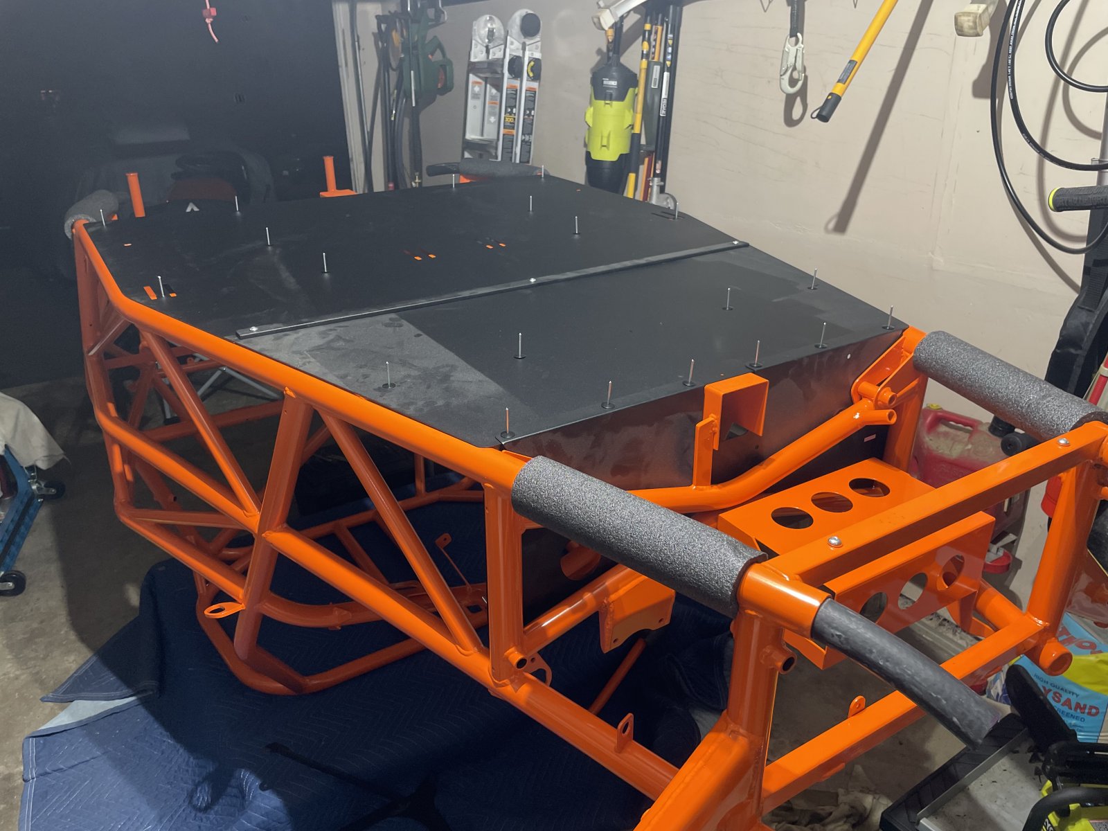

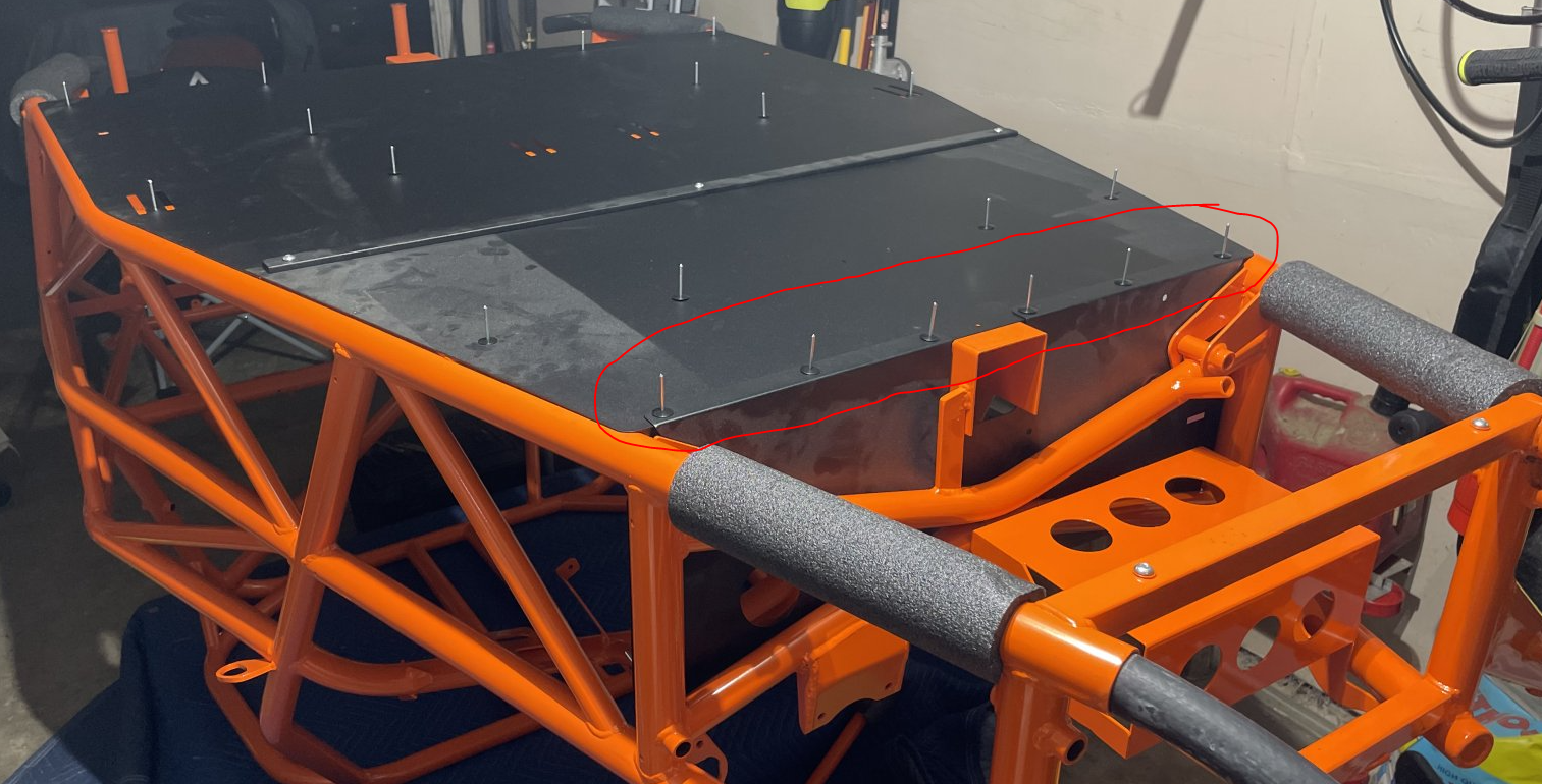

Test fitted the floor pans, bulk head and brace.
All good. I’m excited to get these permanently mounted but I figured I should probably drill out the holes for the tunnel cap. I plan to install threaded rivets and I’m sure I will have to make the holes bigger. Probably easier to do it while the floor pan is off. I just wish I had thought to do it before I sent it to powder coat.

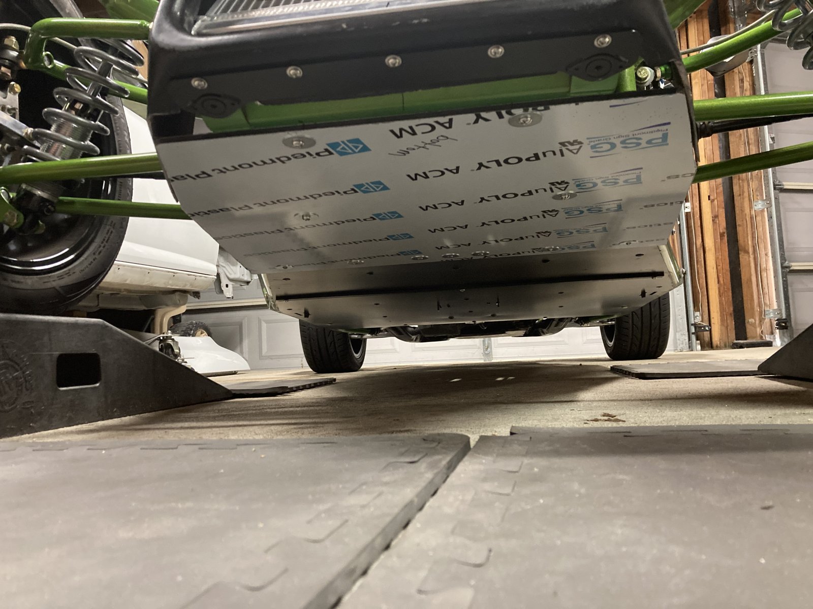

40753
I replaced these location from rivets to rivnuts. They make a great mounting location for a front splitter/ spoiler/floor panel with the HE rivnuts already in place on the frame.
