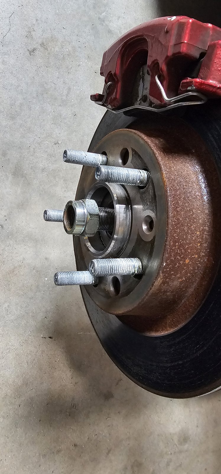

The part came today, despite in the description it came only one part, but the price was still ok. I started to disassemble the wheel hub and thought I came to a stop when I saw that 30mm axle nut. I did not have a deep 30mm socket and thought this nut must be torqued quite a bit. The 30mm socket I have just barley touched the hex. Anyway, lucky me I was able to losen the nut. It was hand tight, not more. Now I wonder was that the reason why I had play? I don't think so, but wanted to be sure.
Another question, please have a look at the picture. The nut is oriented in the way it was installed. Is that the right way??

I think the nut is placed correct. At least in this video it's installed in the same way. However, I will need a longer nut to torque it and I am missing the washer behind the nut.

Another question, please have a look at the picture. The nut is oriented in the way it was installed. Is that the right way??View attachment 46401
I don’t remember what the actual torque spec is for the axle nut but if it comes loose it will make the bearing loose

I found several Axle nut torque specs and am still unsure as to the proer spec but the lowest found was 155 Ft. Lbs., so IF that nut was finger tight it certainly wasn't helping things!
Washer was always shown in diagrams, so it appears to be essential! Also, a torque spec of 155# or more does not sound unreasonable. I always look up such info and/or is usually included with new axles and/or associated parts.

I replaced the hub now anyway, the old hub definitely has play while the new one has no play. I will torque them to 210Nm. And check the other side too.
