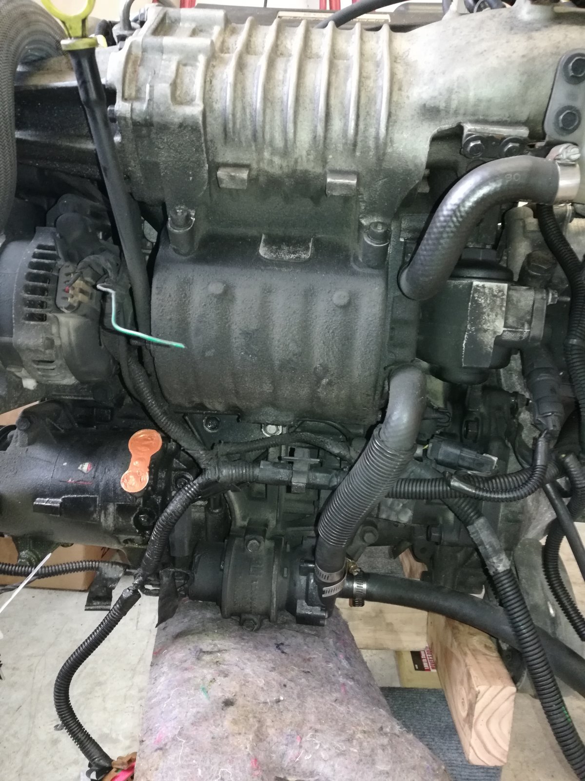

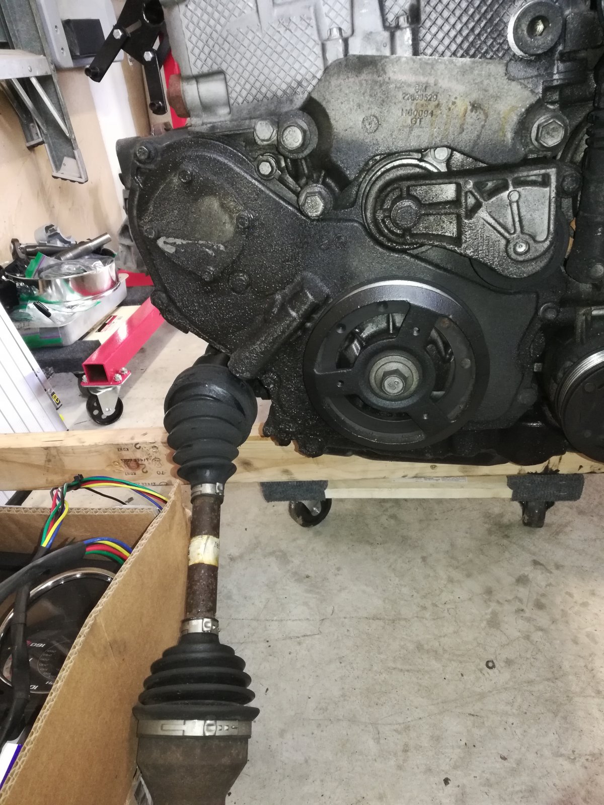

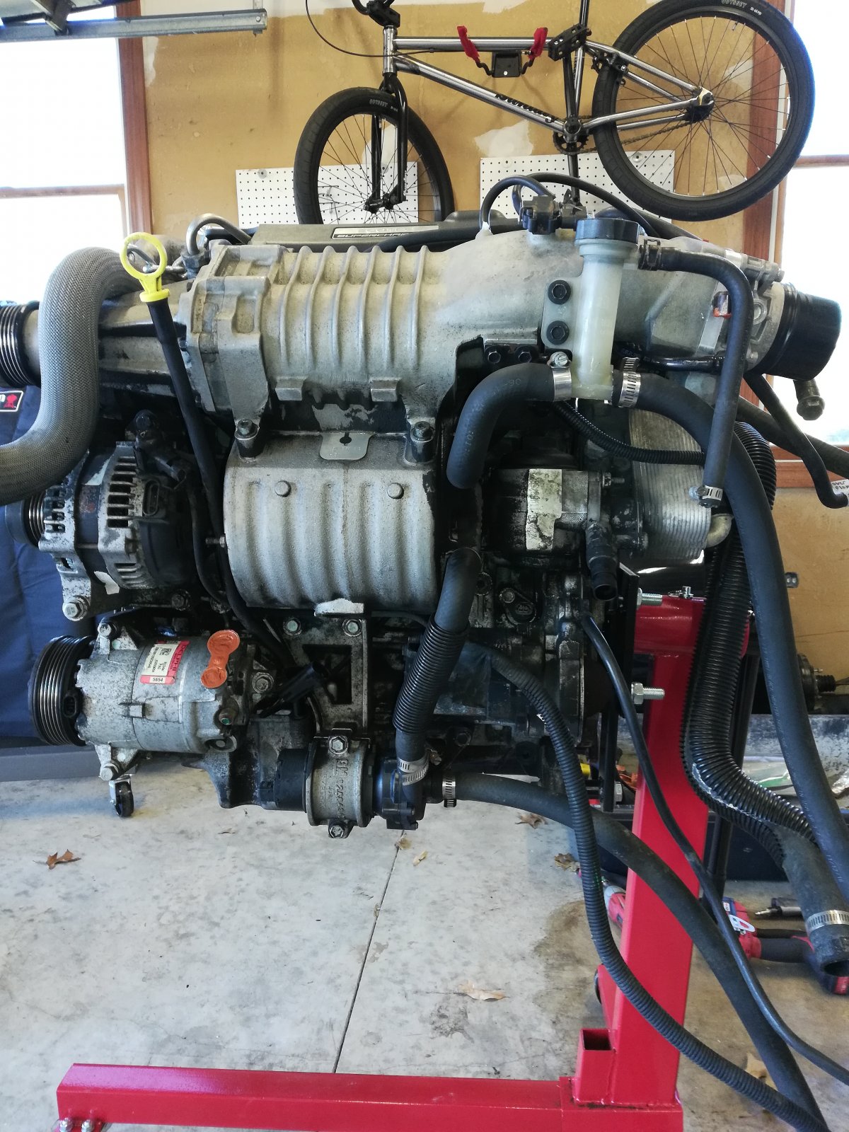

About to start engine cleanup and tear-down. Anyone else have a really oily grimy engine before cleaning? It never dripped or used oil, so I'm not super concerned for engine health, but I'd like to address whatever parts are weeping if I can easily do so.
I think this one can be addressed with a new timing cover and water pump cover (?) gasket.
11181
I'll be pulling the SC so hopefully this one becomes clear at that point. Whole front is just covered.
11182

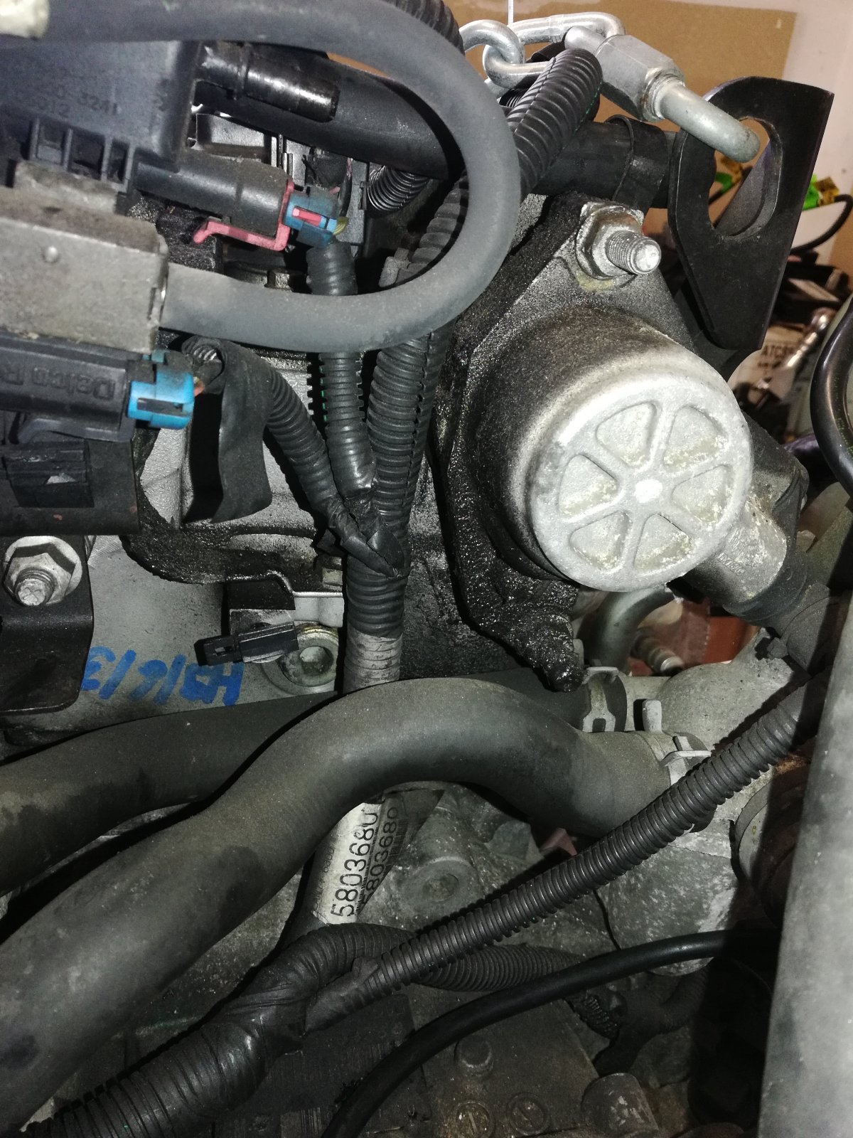

This one on the driver's side top I have no idea. What's the little circular part in the top right that's oil-covered?
11183
Thanks
Karter2026
Crank seal and the water pump cover seal. When you do the timing cover seal. It doesn't look like a cv boot they look clean from the picture. How many miles?

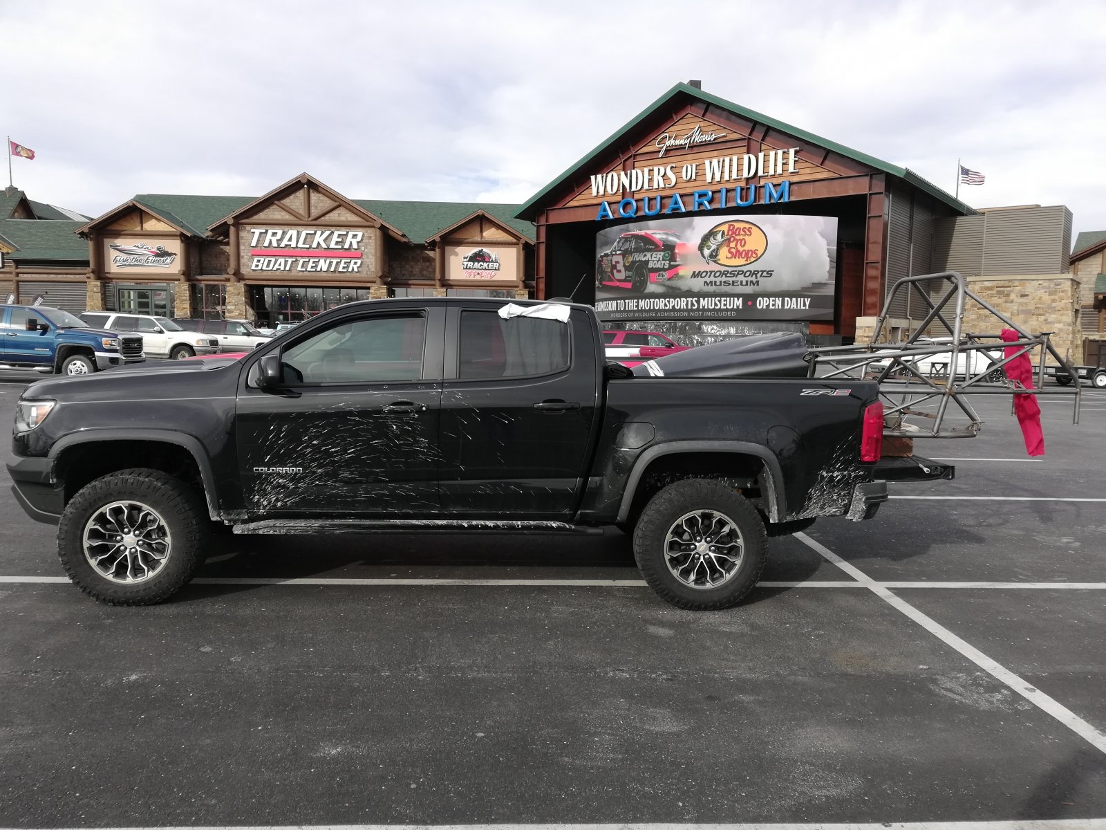

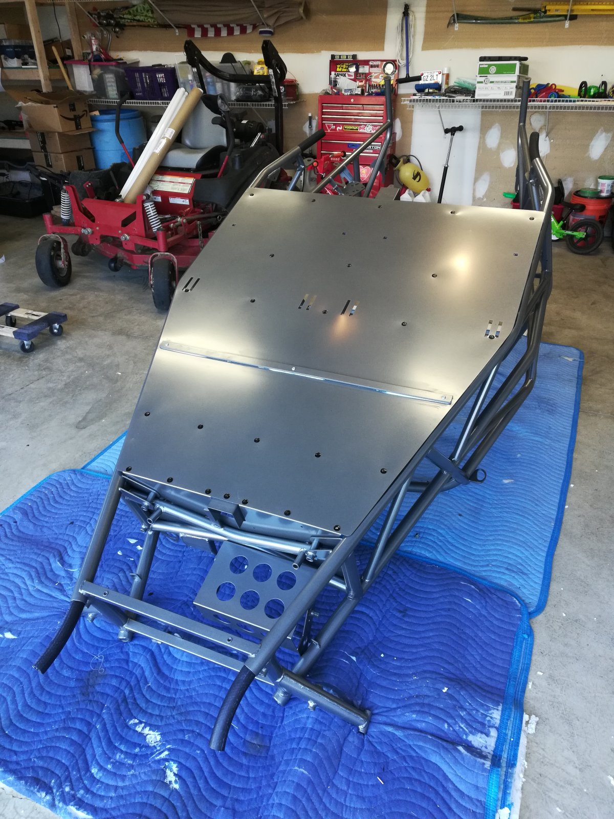

Today was my day. Big thanks to the Doyles who went really above and beyond to get me my kit.
It can be done with a mid size truck with back seats but it's tight. The floor pan just barely fit through the back doors.
Haven't opened any boxes yet but I'm amazed by the fabricated stuff.
Besides threading in bolts and nuts, any other tips before powder coating? I won't be welding anything.

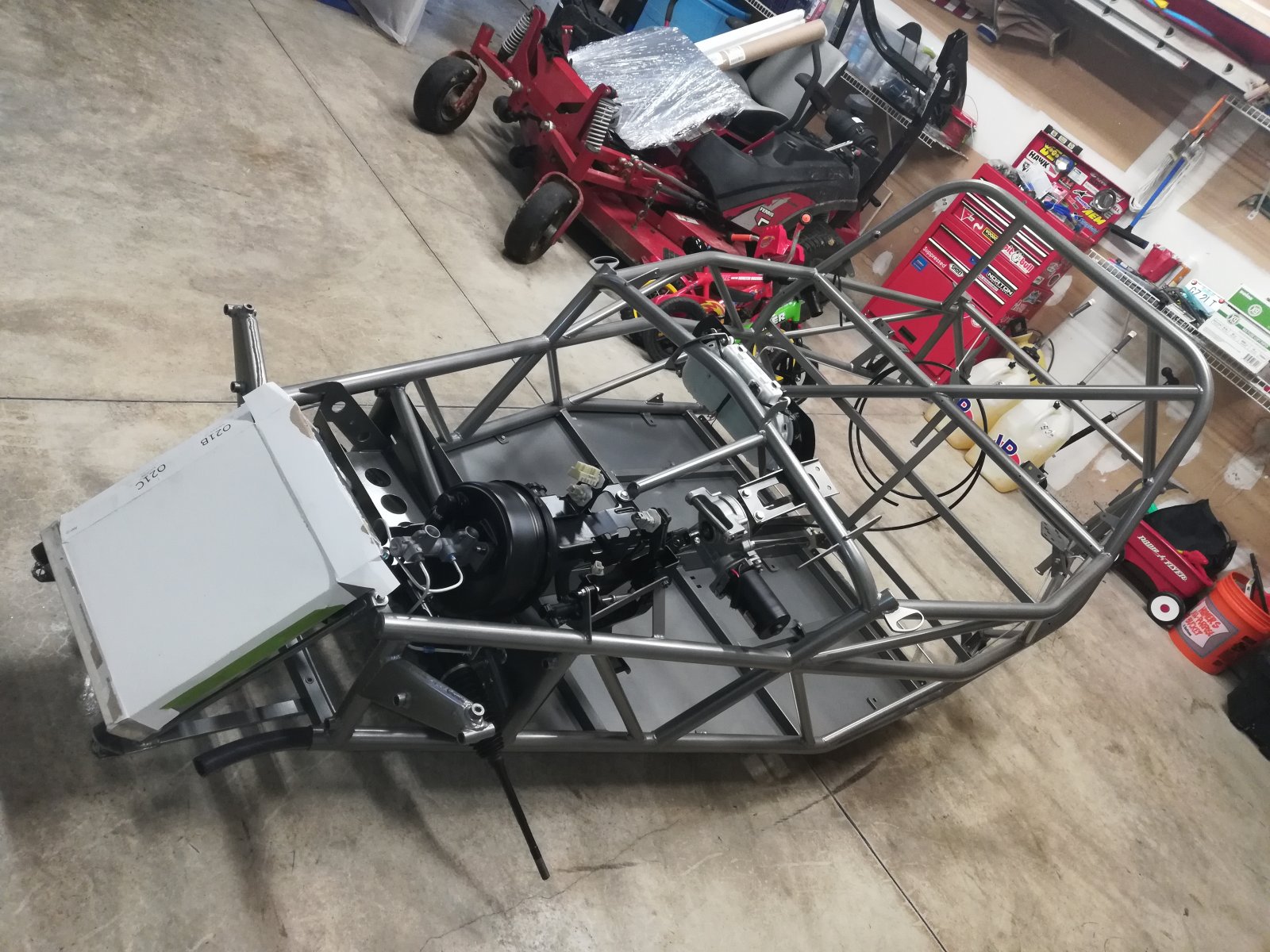

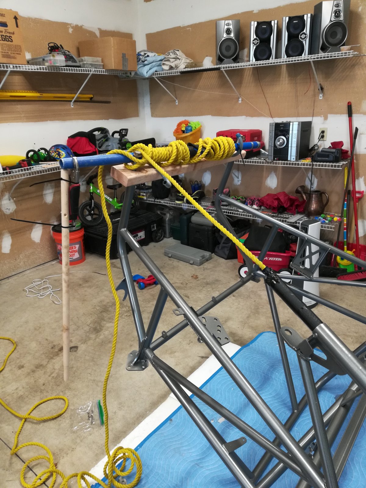

Got to start on assembly today. I'd really recommend a pneumatic rivet gun.
On the main hoses, heat em up, cut slits in the end you tie the rope to so it can collapse easier, I tied a washer to the rope and cinched that inside the hose so it couldn't pull out, and use a crank or rig up something awesome like this for leverage.

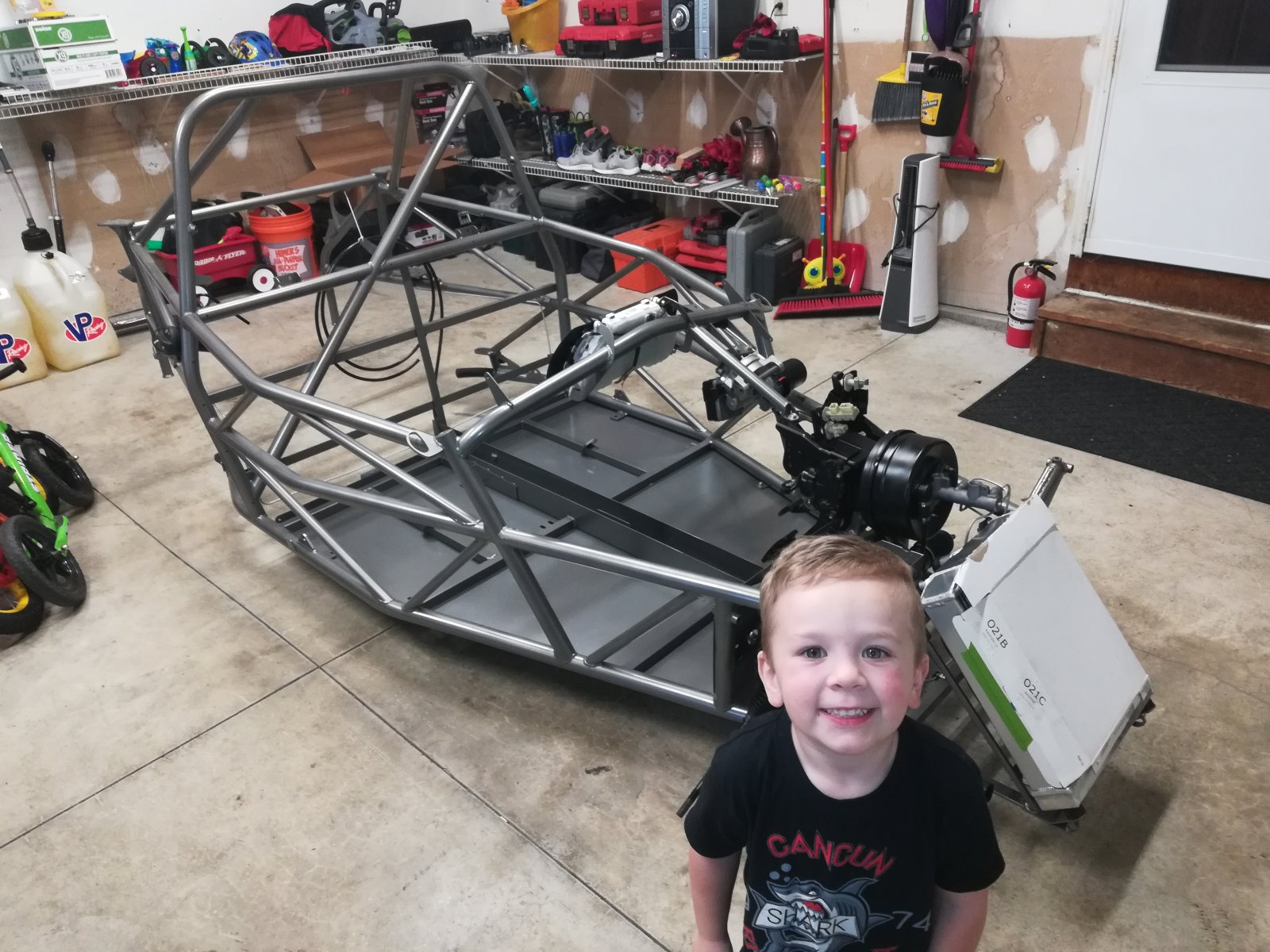

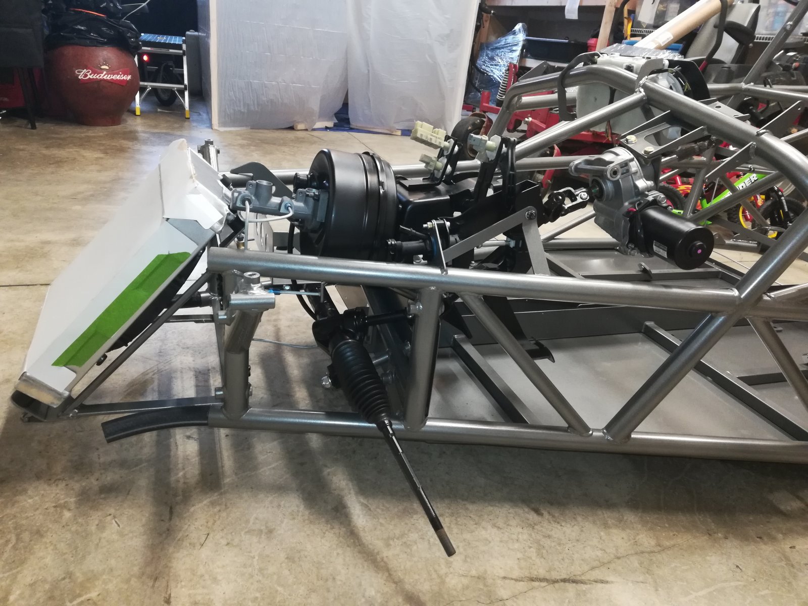

Great progress! I see you have a garage helper - always a good thing to start them young. :);) Are those the new or the old steering rods on the rack up front? Sometimes these get mixed up in the large number of things that need to be remembered.
Murcielago311
Just the naked steering rack right now. If I remember correctly I have DF replacements that go up front and I need to buy some new ones for the goblin rear because the old cobalt fronts the boots were cracked up.
New parts are good. One of my arms was bent on the donor so new (now) rear arms were a must!

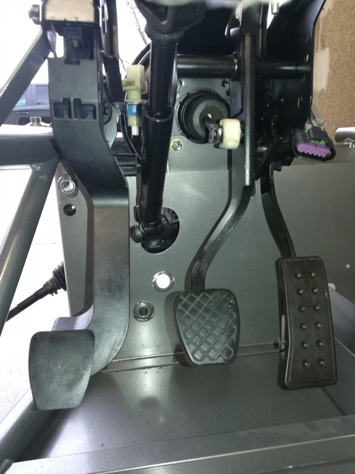

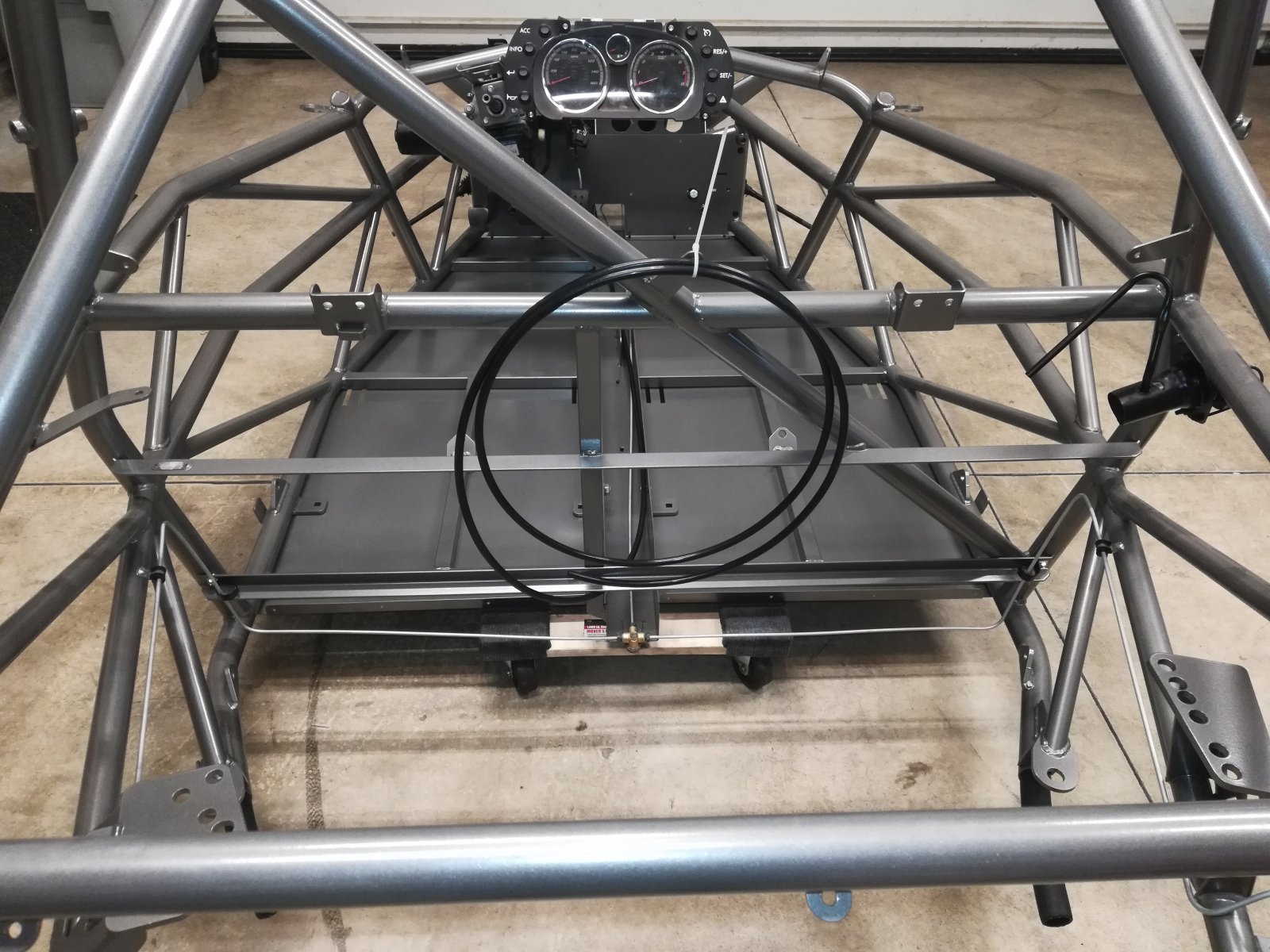

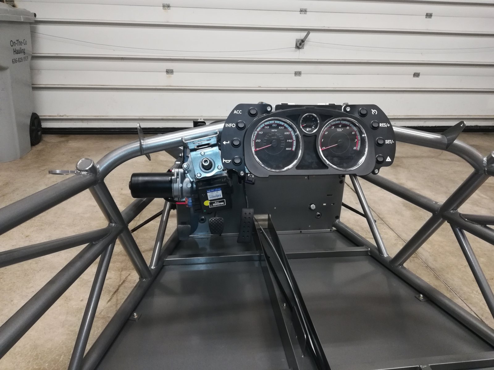

I see you have plenty of clearance between the steering shaft the clutch pedal arm, did you have to do any trimming or part re-adjustment (bending)?
Murcielago311
No bending. I was able to cut enough of the little switch leg off to clear the shaft and still grab almost all of the switch. Good eye.

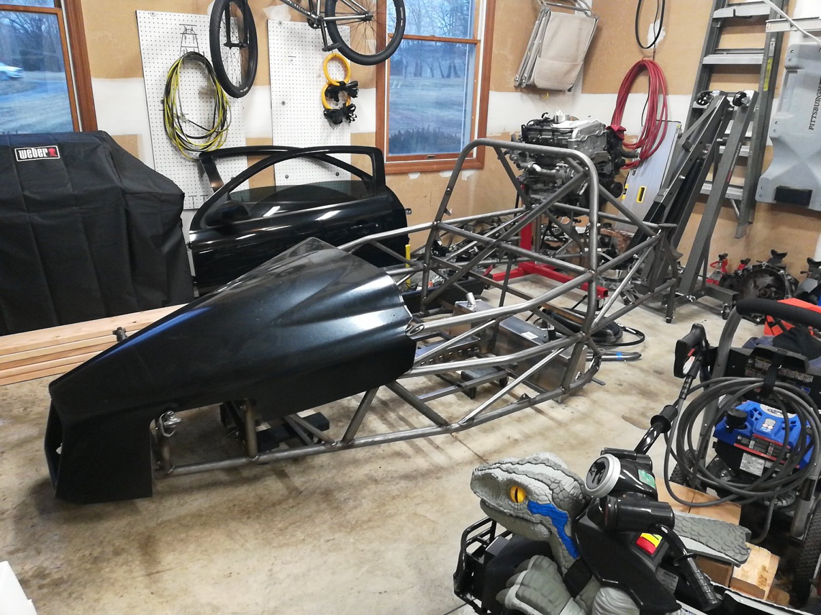

Can I hear some opinions on whether or not I should do as many here have done and add my large donor ZZP heat exchanger up top on the roll bars or just stick with the DF HE up front that I already have mounted?
My LSJ has 60lb injectors and 2.8 SC pulley. Was pushing about 15 psi on the donor. Will only see street duty.

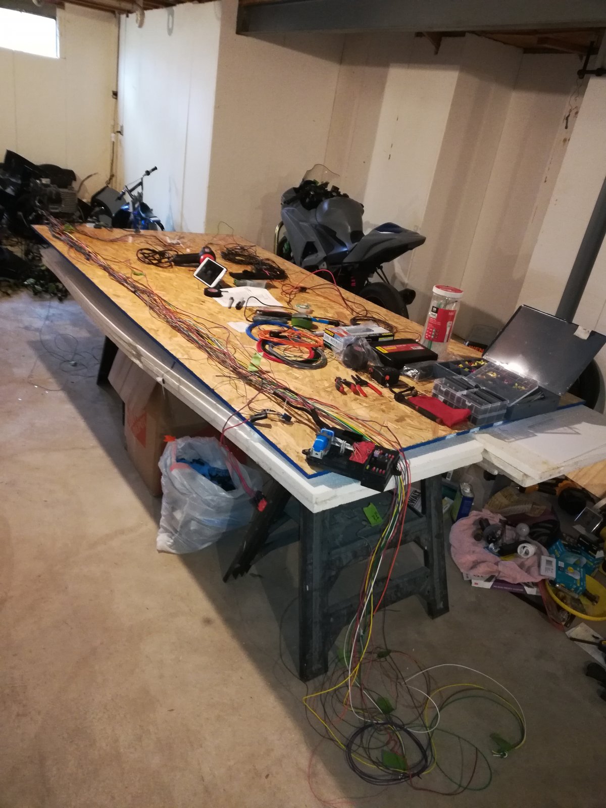

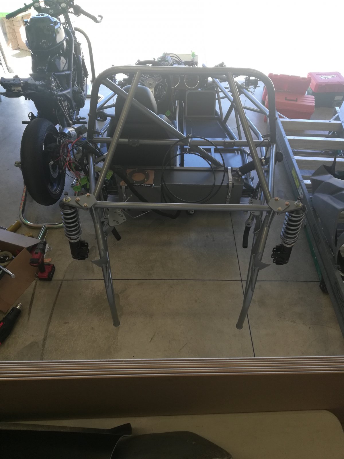

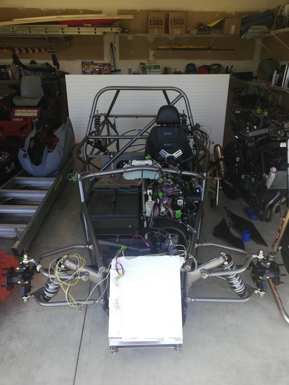

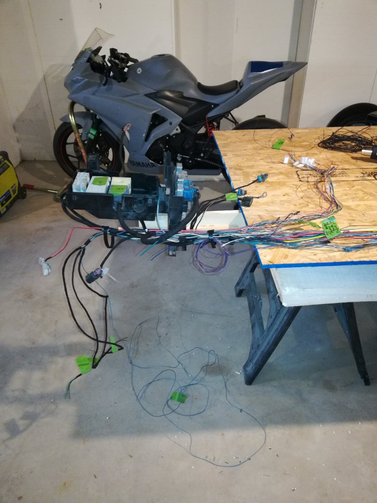

As an update, I completed my harness and it's in the car. Need to do some final taping and securing but all the connectors plugged in. Thanks to the new videos and Adam's 'Rock On' lighter and Lonny's calming 'you can do this' VO work.
I was able to add in the necessary wiring for my AEM wideband, Aeroforce Interceptor, and WOT box that came on my donor. Also several extra positives front and rear for my street glow and 15" woofers (JK).
I have the driver controls mounted, driver's seat, because I just HAD TO sit in this thing to see what it would feel like. Front suspension is done. Rear coilovers on, fuel tank, brake/clutch reservoir, radiator, and HE on and plumbed.
Next is my engine work and painting, need to figure out how to get these *****ing control arm rear bearings out. Now that all my moto track days are being canceled I'll have more time for the car.
