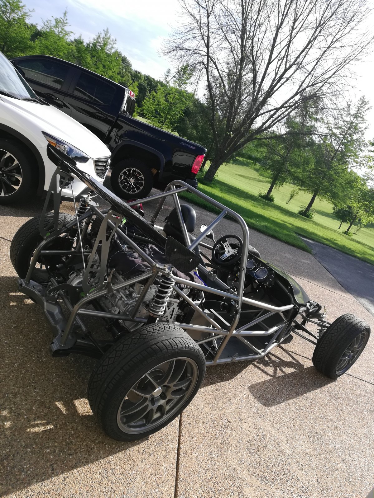

I have a roller. Things move quickly after that engine goes in. Still waiting on my valve cover, header, and calipers from coating. Hoping for that first start by this weekend.
14406
14407

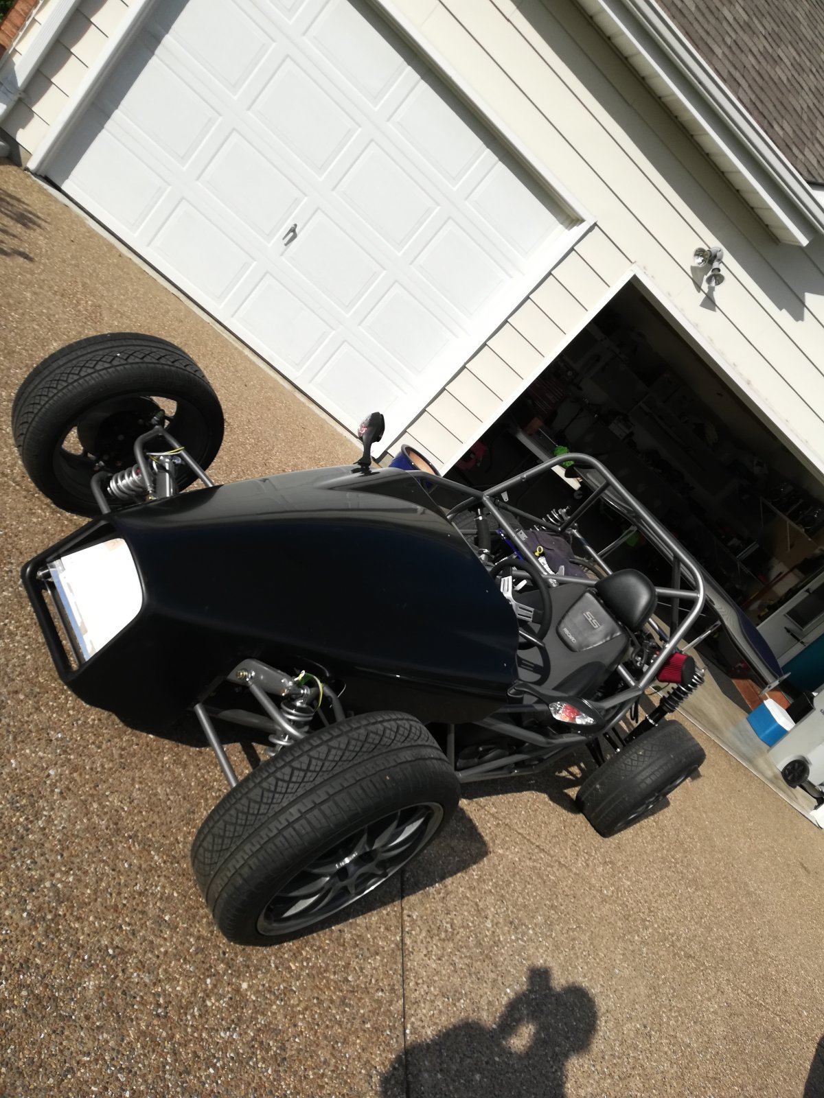

Murcielago311
Thanks! But he's already asking for the keys. Until today he could 'drive the car' and turn the key. Had to watch he didn't try to crank it with no valve cover!
