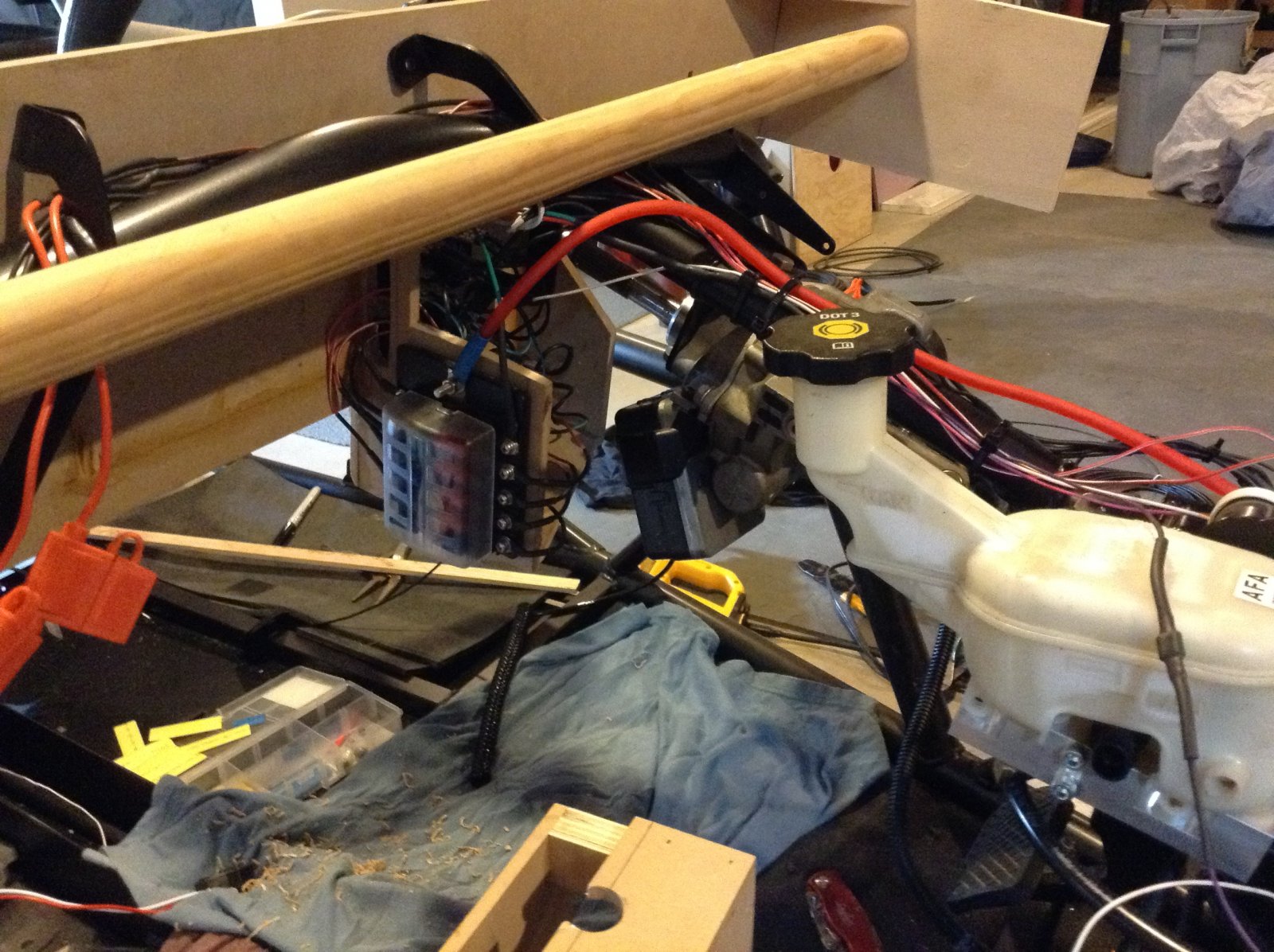

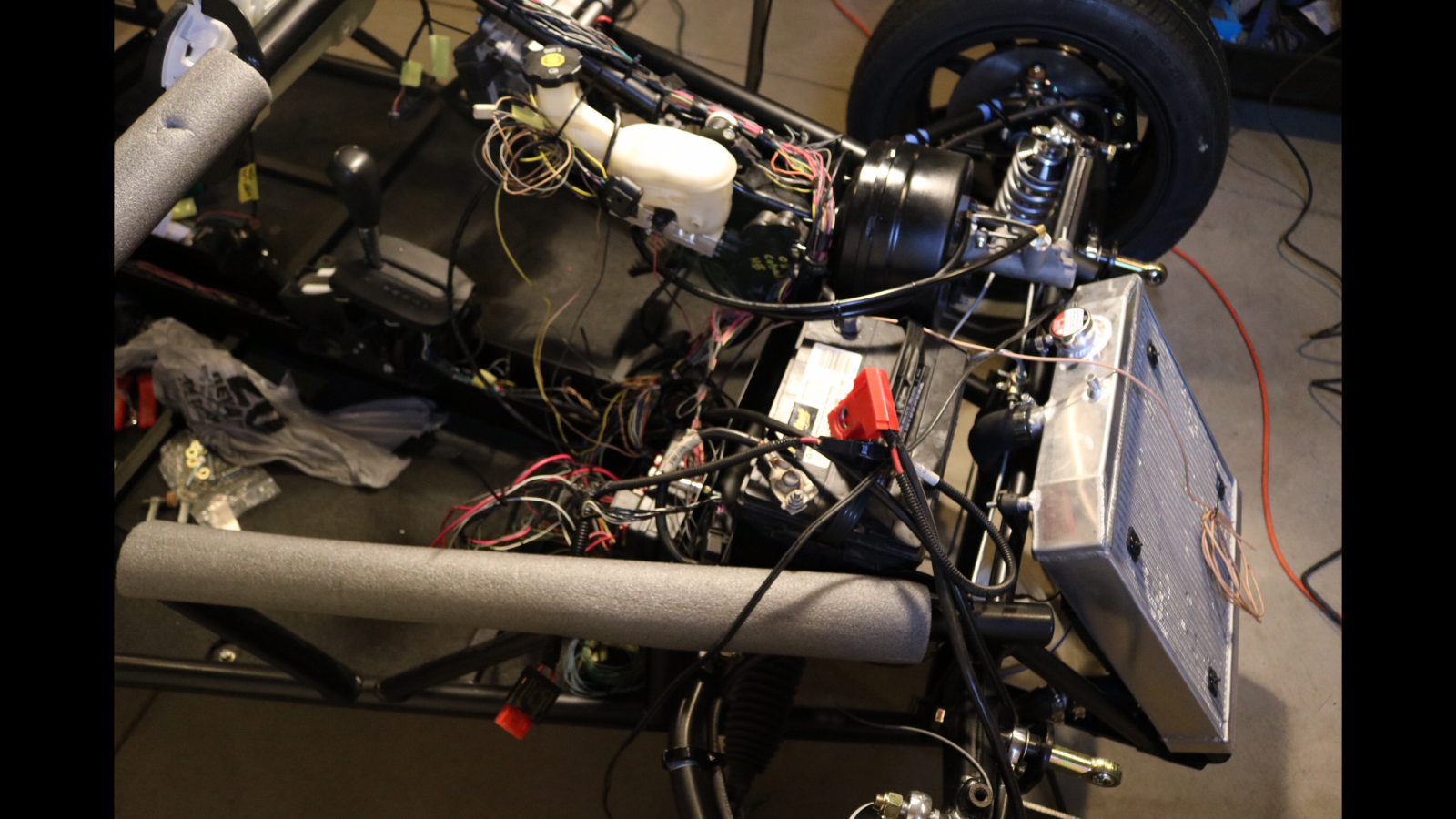

So we have some progress, turns out as I was cleaning up the front I found that the BCM ground was not grounded. I still only have the VATS light indication on my instrument cluster but the dash does light up, which it wasn't doing yesterday. There is also clicking at the main fuse panel, which means that there is some sort of communication going on. No additional lighting on the instrument cluster
Nate
Here is some of the cleaning I have been doing to the front of the vehicle:
Before:
After:

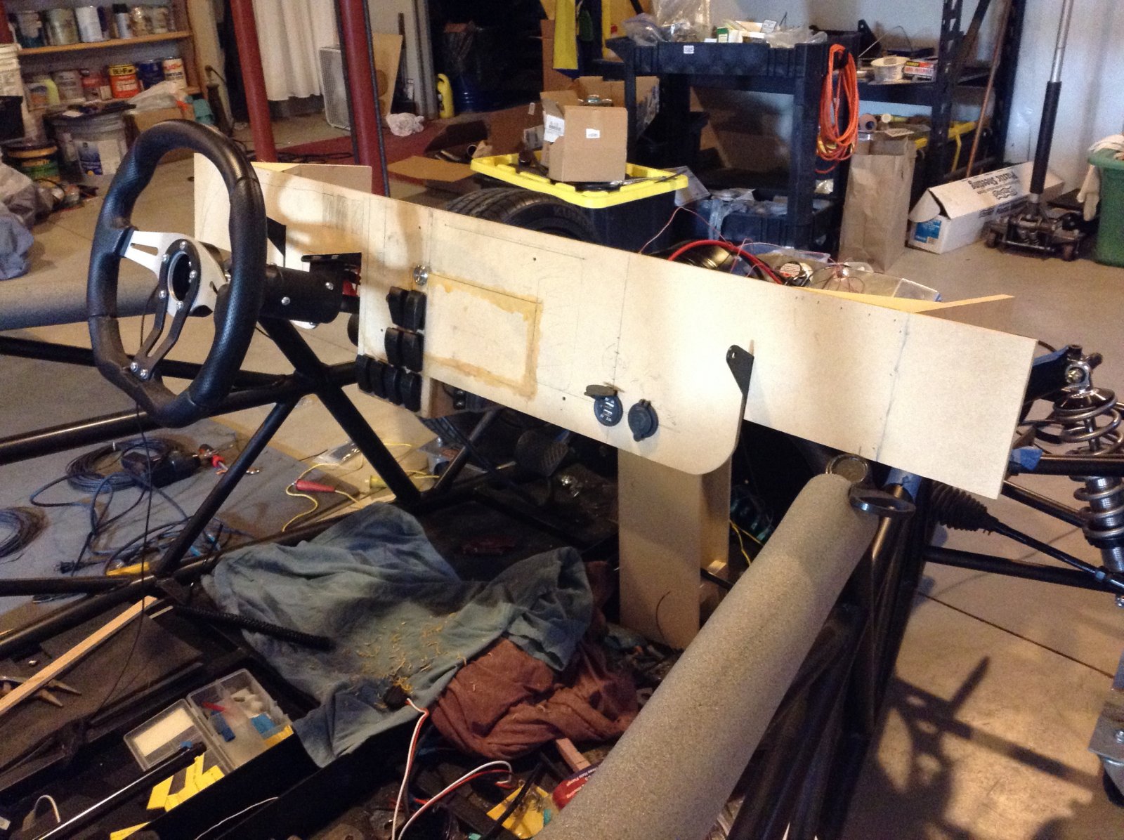

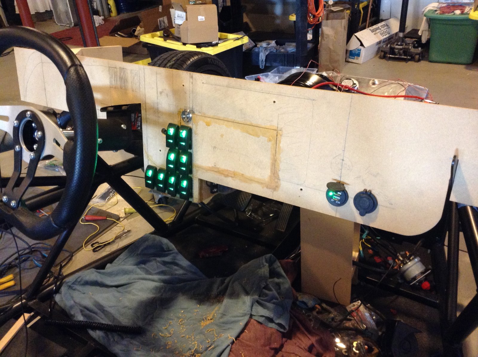

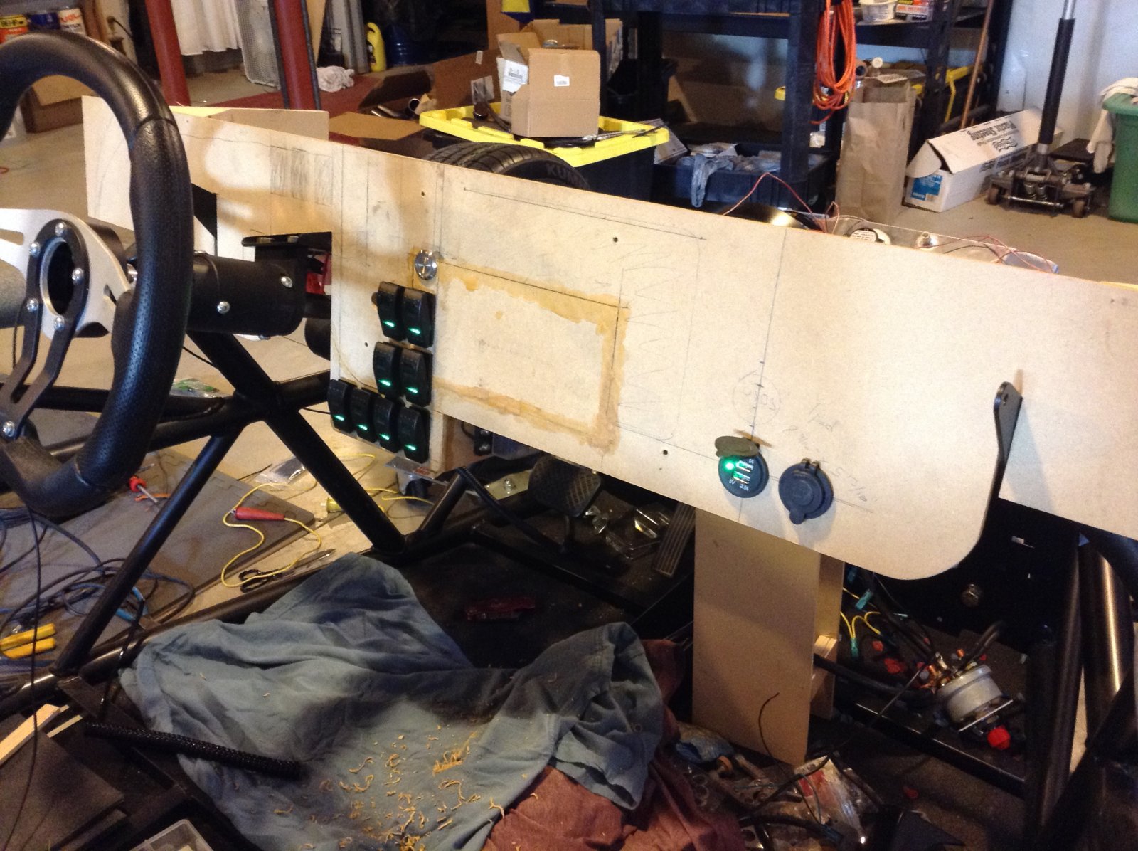

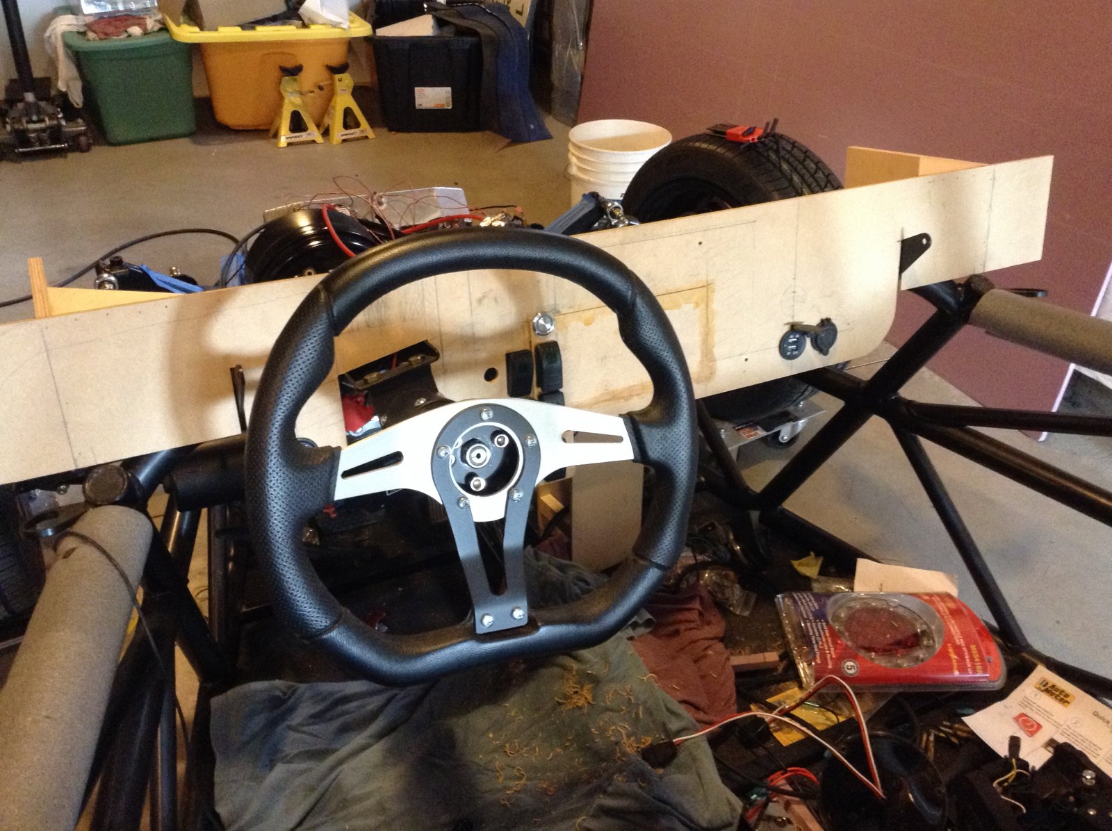

I have been doing a lot of work on my dash lately as well as completely revamping my wiring in the car to give it an overall much cleaner look. I've decided to go away with the instrument cluster from my donor and design a whole new dash for the car. It's still in the wooden prototype stage but here is my progress:
New steering wheel along with powered off dash:
Here is the lighting that is incorporated with the dash when powered:
The center section of the dash is to be the location of a hard mounted iPad mini. I have recently purchased an AutoMeter Dashlink which I will be using for my gauge package as I think it will tie in nicely to have digital displays. Besides the 8 switches I also have a dual USB port (one of which will stay connected to the iPad to keep it powered), a 12V charger, and a voltmeter (located on the lefthand side of the steering wheel).

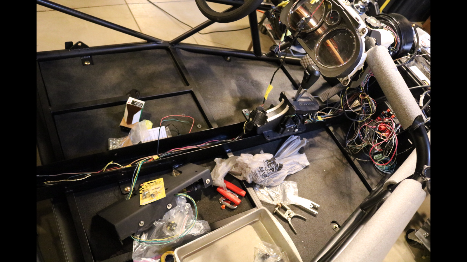

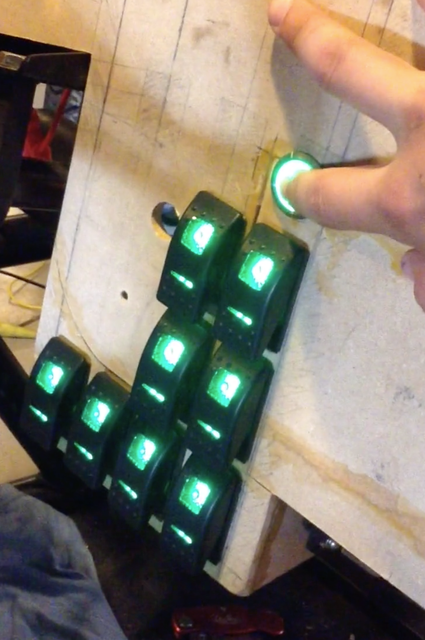

I have also gotten rid of the ignition cluster and wired in a push button starter:
^ I had to screenshot a video so sorry for the poor quality (wouldn't let me upload the full video file)

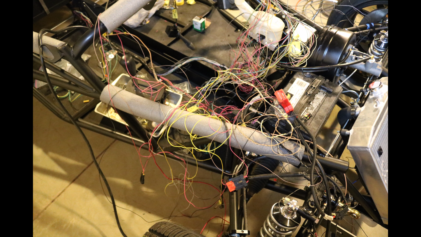

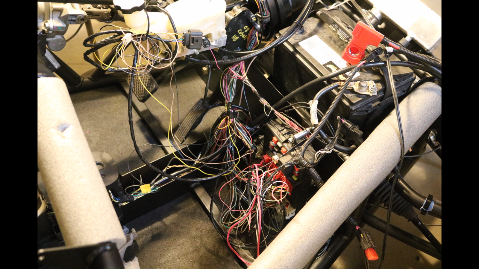

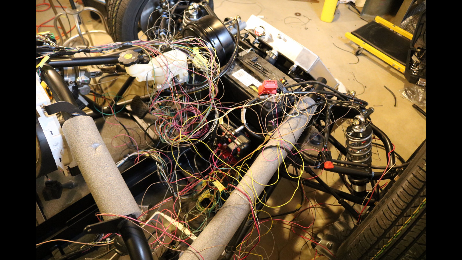

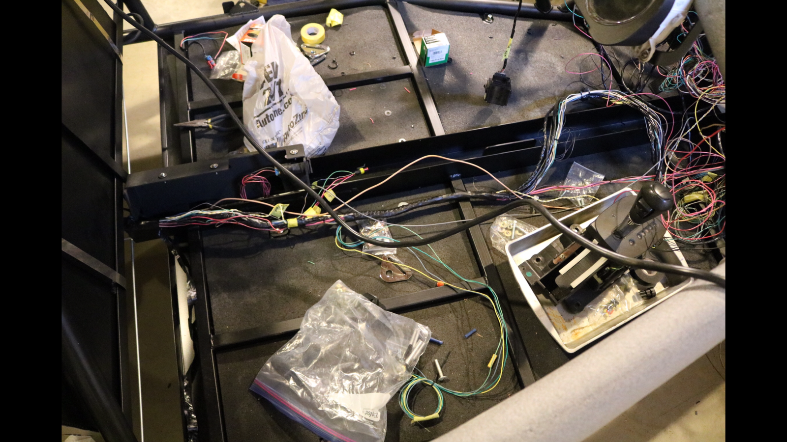

My father and I have always tried to think of a way to wire the car that would eliminate many of the unnecessary items that come with the cobalt donor harness. After long consideration (especially after working for a good chunk of time on cleaning up my donor harness), I have gone away with all of the wiring and converted to a stand alone harness in my vehicle. I have to say it looks very clean:
With the above wiring configuration I was able to eliminate the large bulky fuse box as well as BCM in the front to stream line the wiring both physically and aesthetically.
Instead of the BCM, I just have a simple fuse box that will be incorporated into my dash to power switches and other dash accessories (a lot of work but I believe it looks the part):

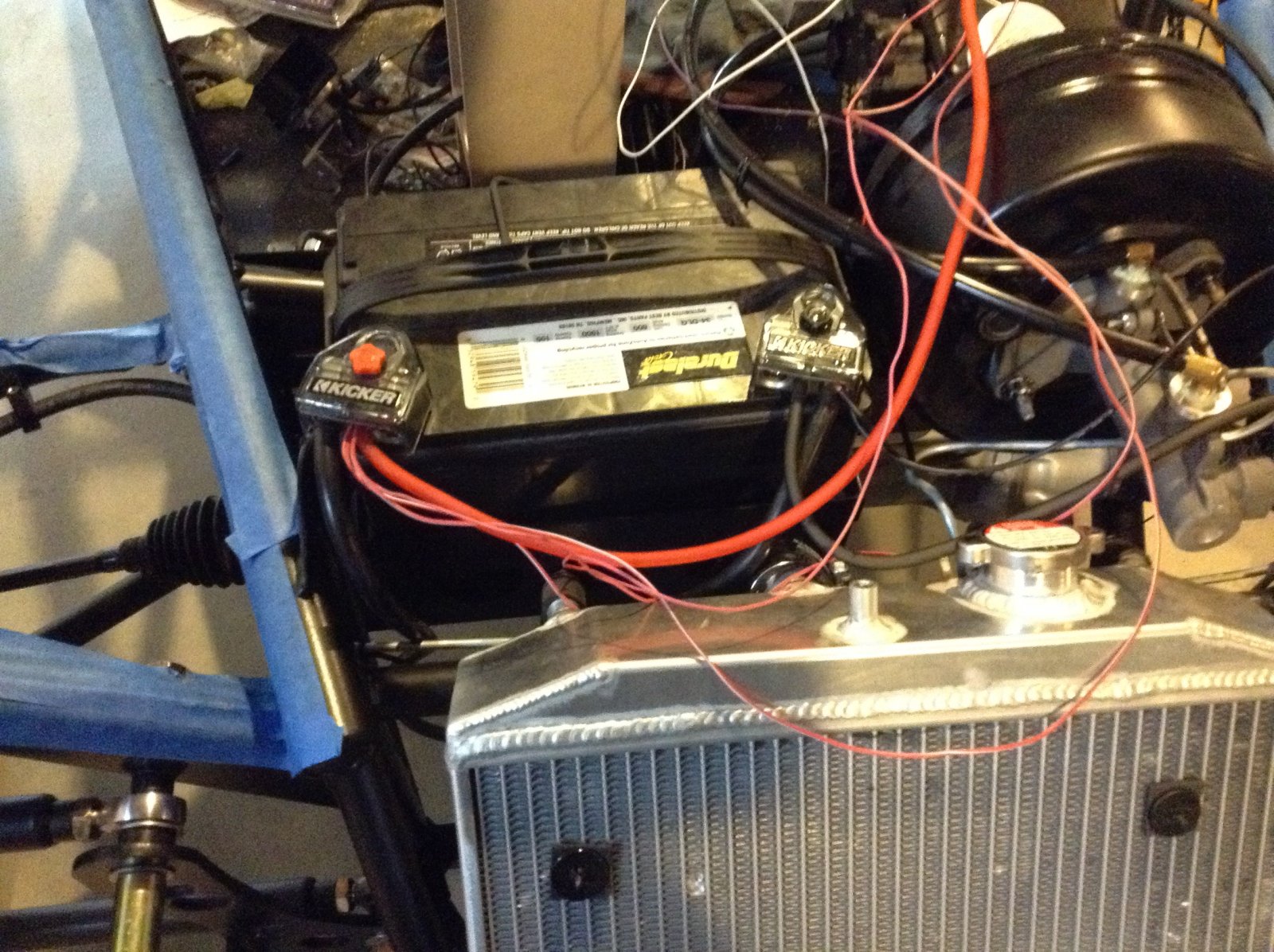

I have also installed a set of Kickers to the battery terminals to give me the ability to easily wire into the battery:

I used the Yakamoz DC12V 22mm button. With the stand alone harness the ignition (and three plugs) is no longer needed so I just needed to use a momentary to signal the starter @JSATX
