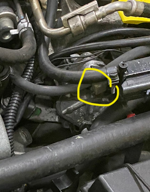

Also, in the infinite wisdom of the previous owner, the bottom port facing the front of the solenoid boost controller has been capped off with a small hose and bolt. It seemed to run and drive just fine when I first bought the donor. What issues would that cause? From what I understand, that is some sort of vent to or from atmosphere, correct? And where would I even get a piece of foam or other appropriate filtering cap for that to correct it that fits over that fitting?

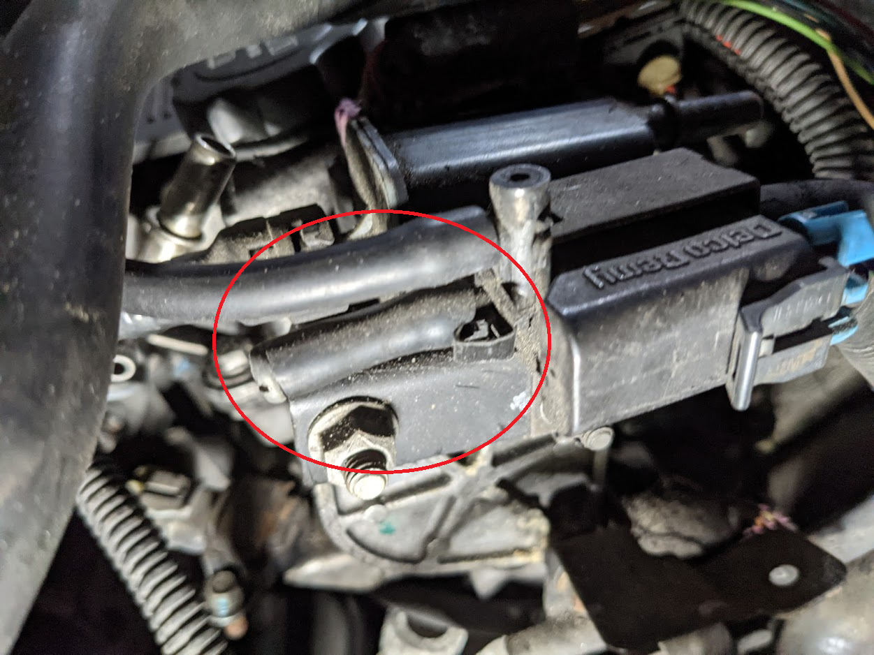

1. No evap required in SC. I managed to remove part of the bracket for the evap and boost control solenoids just to clean it up, I can snap a picture tonight if you're interested but I'd imagine you could figure it out.
2. Can you post a picture? Or others with better photographic memories can chime in, but if I understand correctly, it should be open to atmosphere. I've read a few "solenoid bypass" mods from other forums but none seem to make any sense to me. If it ran fine then I might not mess with it though.

If you could snap a picture of how yours looks, I will definitely use that for inspiration.
Offending tube/bolt in image.

I'll do that tonight.
I can't for the life of me figure out what that bolt is attempting to accomplish. From my understanding of the system, the bypass control valve (mounted to the supercharger) is actuated by intake manifold pressure. I think the solenoid usually stays open, so if you have vacuum in the manifold, the bypass valve stays open. The solenoid only closes, thus preventing the bypass valve closing due to an absence of vacuum, under situations where it would normally be making boost but the ECU doesn't want to. I've heard of hacks to prevent the system from functioning as intended in the hopes that it will make boost sooner, but I think that's silly and I don't think that bolt is how that's accomplished anyway. I'm sure smarter folks will chime in, though.
Any piece of foam will work. It’s just a little filter so junk doesn’t get inside the valve and make it malfunction.
