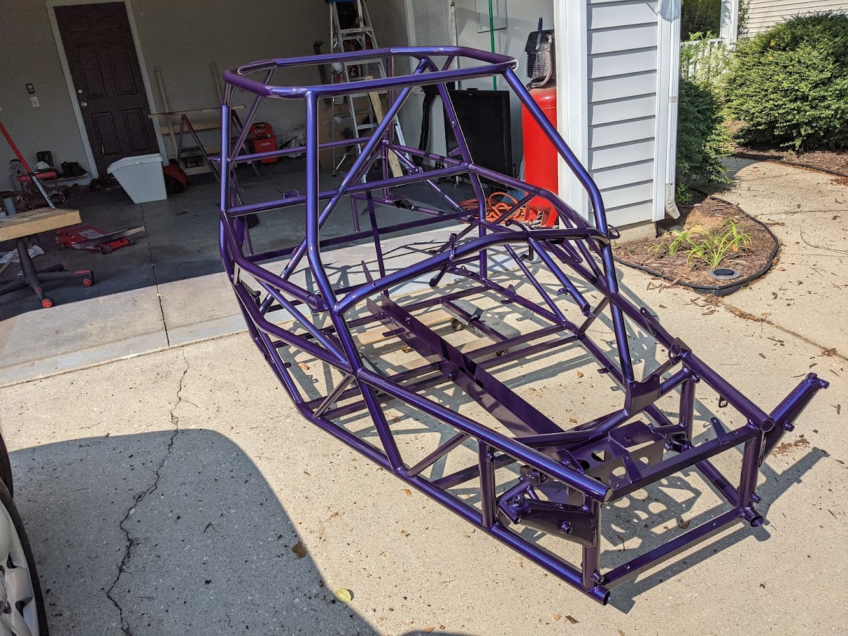

I rolled it out in the sun for a glamor shot this morning. In love with this color!

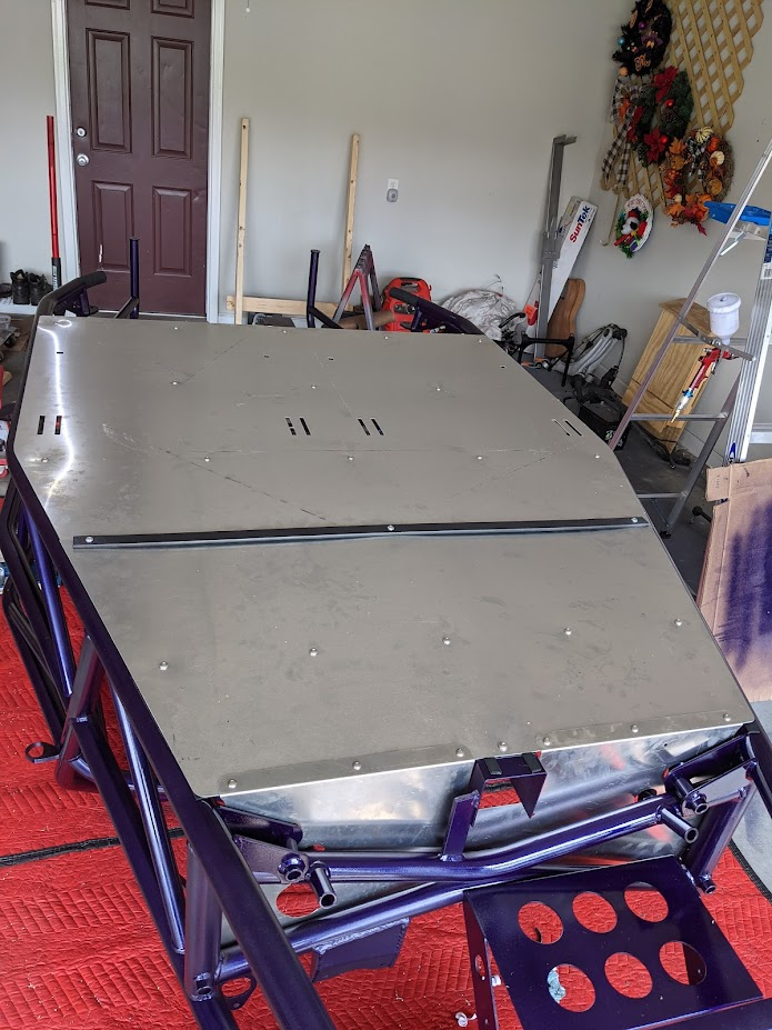

Floor boards are on. I kept them bare since I'll be putting a non-slip coating or mat later down the line. Plus, I like the bare aluminum look because race car :cool:. I went with the rivnut and screw method instead of the rivets in the kit. Very happy with the results - it looks very clean and I like the peace of mind that I can always take off the floor.

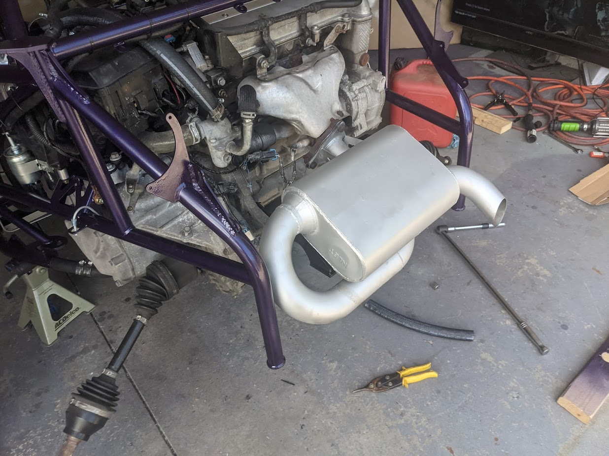

Well my dad and I got the engine mounted and running this weekend! Definitely a big relief after the engine sat around for a few months. The K-member was installed after this photo.
26262
The only nagging issue so far is the OBD port does not seem to be powering up. I have a bluetooth reader that plugs in and will export to an app on a phone. I confirmed it worked just fine in both my truck and my dad's truck, but it acted like it had no power in the Goblin's port. Any ideas where to start?
Corgithulhu
That helped a ton. Saw no voltage at any of the pins. The cigarette lighter outlet fuse was blown, and putting the good fog lamp fuse in its place made it receive voltage fine. I didn't want to start it up at night to test data, but I will definitely try it tomorrow. Thanks!
