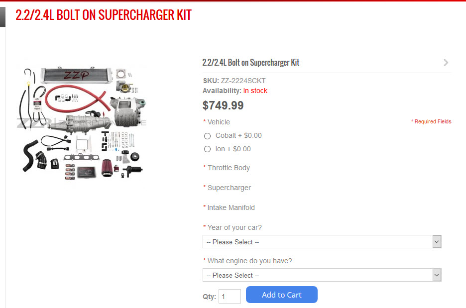

The stock Cobalt power makes for a surprisingly quick car (just ask anyone that has ridden in one of our demo cars) but we went and did the next logical step: we installed a power adder... specifically, the ZZP supercharger kit.
ZZP doesn't mention how much horsepower you will get out of the kit. Luckily, we've already dyno tested P2 without the supercharger (151 hp) so we can dyno it again soon to see the difference.
The kit comes with lots of parts (some of which we won't use). Most of the parts are straight from the supercharged Cobalt SS so they bolt right on to the stock 2.2 Ecotec.

It appears that going with a base model Cobalt will save a lot of money. However, is that a wash when factoring in the cost of the supercharger kit you pictured above? What does that kit cost?
(Yes, I'm going over to look around at ZZP's site.)
smithvmi
The zzp kit is a bit more than twice the cost of piecing your kit together from used parts. The 750 starting price doesn't include the TB, intake or blower. And the zzp kit has parts you don't need.
Consider also the type of driver that had a ss cobalt vs a ls or Lt. The ss donors I test drove were ROUGH. Just my two cents and your mileage may vary.

Reviving this, because I like the idea of adding the SC to an easier to find base model. I was wondering what the Dyno numbers ended up being. Also, like it was mentioned, the kit has extras you don't need, and stuff you need to add as well. It ends up costing something like $1300 to add a supercharger. It's nice to have new parts, but I'm questioning if it really is better bang for your buck than just buying the SC model to begin with.
I'd assume you'd need to add extra parts from DF as well to make it work. So while the donor car and kit price may start cheaper, it sounds like you're about at the cost of just using a more expensive SC model from the start.
