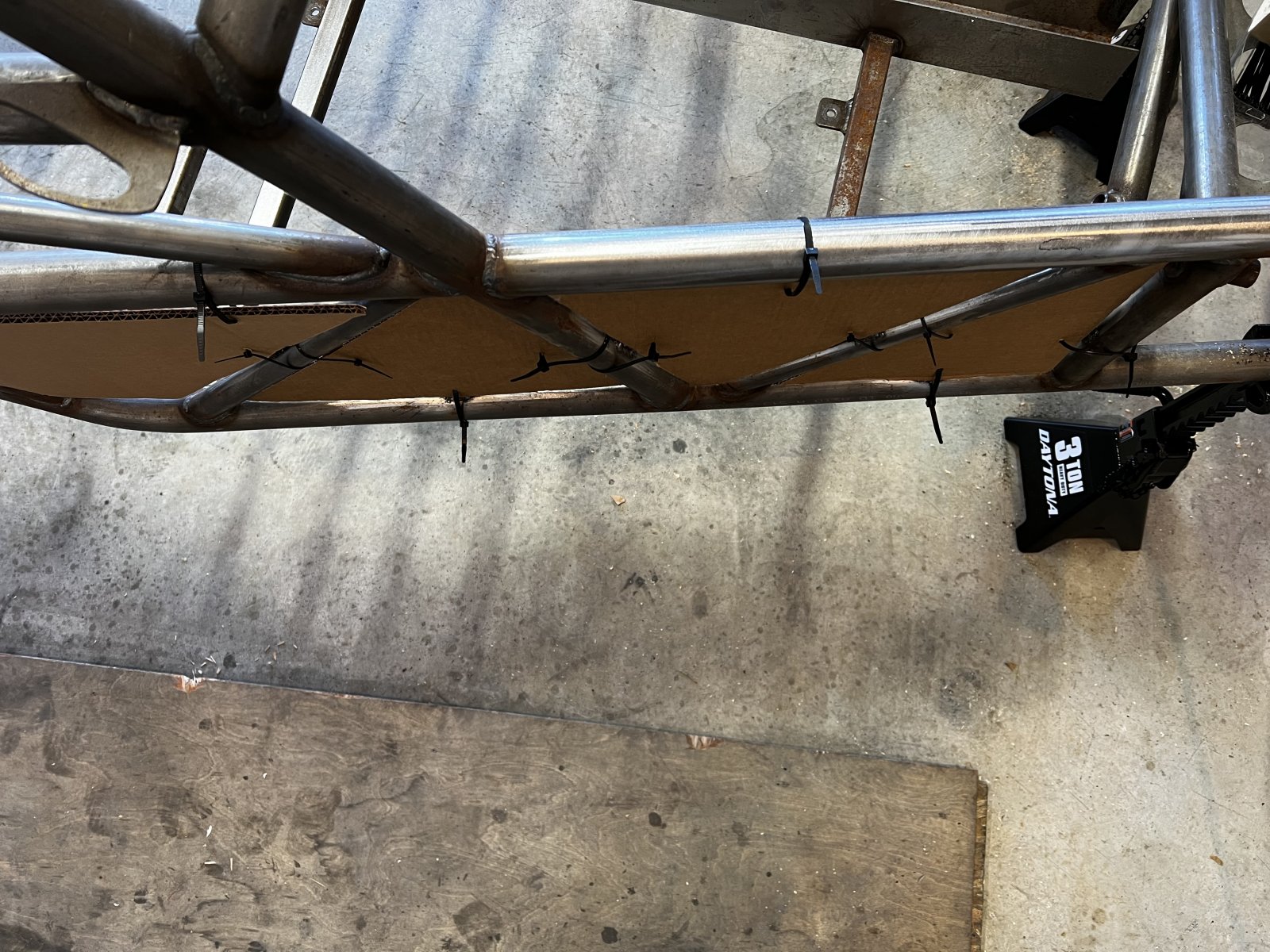

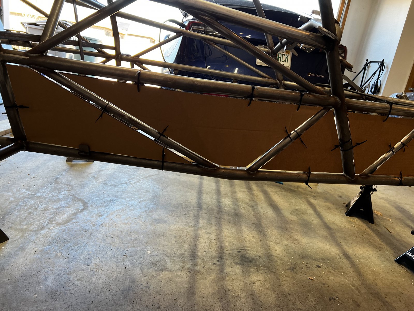

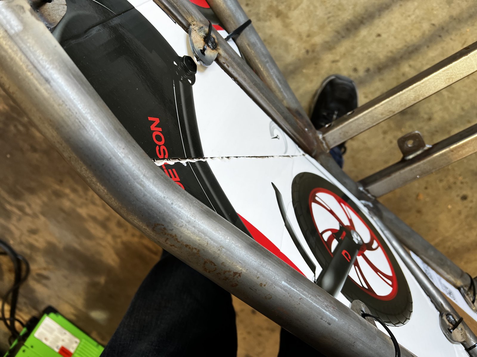

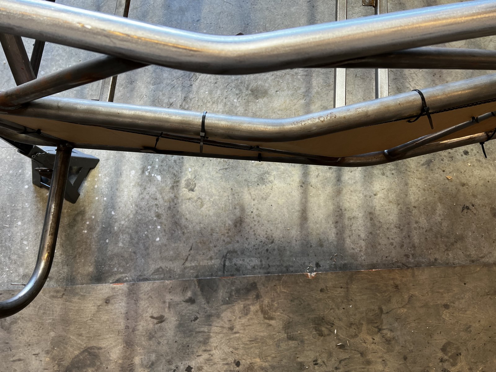

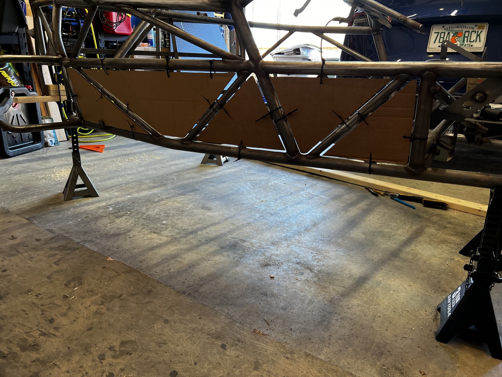

C.A.D: The use of Cardboard to Aid in the Design process of a product.
Used a little trick I learned from watching @Brian74 build log develop to score the cardboard to get the bend I wanted. Hoping I can transition this to the aluminum panel for that section to mirror the bend of the chassis. Found 2 spots where the cardboard didn’t sit nice when held in place with zip ties, so gonna add 2 more tabs on each side to get the fit I want.

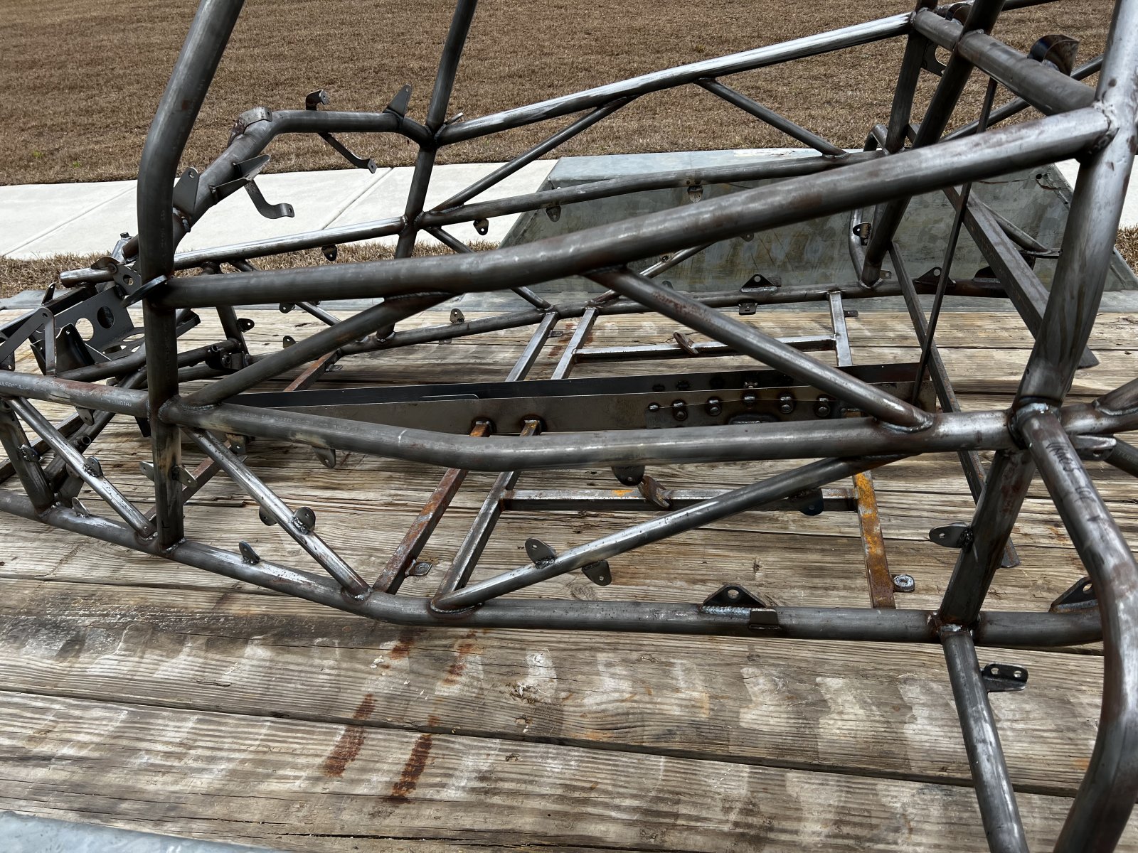

**please ignore my poor excuse for welds. It’s been 15-16 years since I last welded and this is the first time using flux core. I’ve used MIG, ARC, and Oxy and wish I had the space for a proper welder and gas tank**

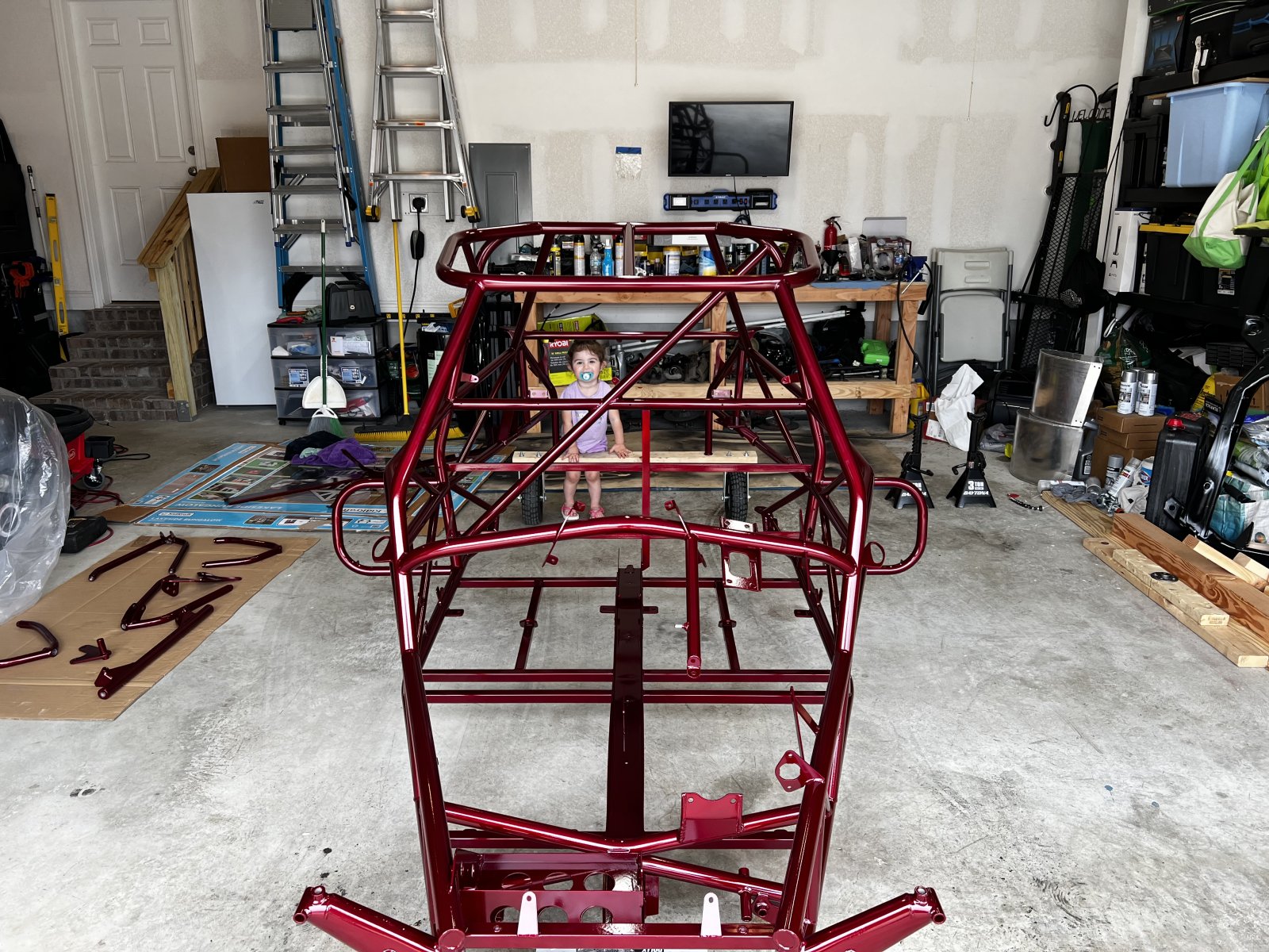

R

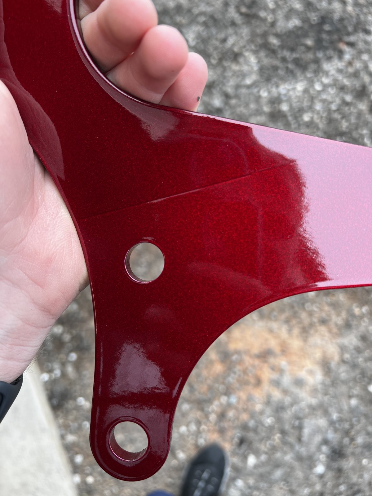

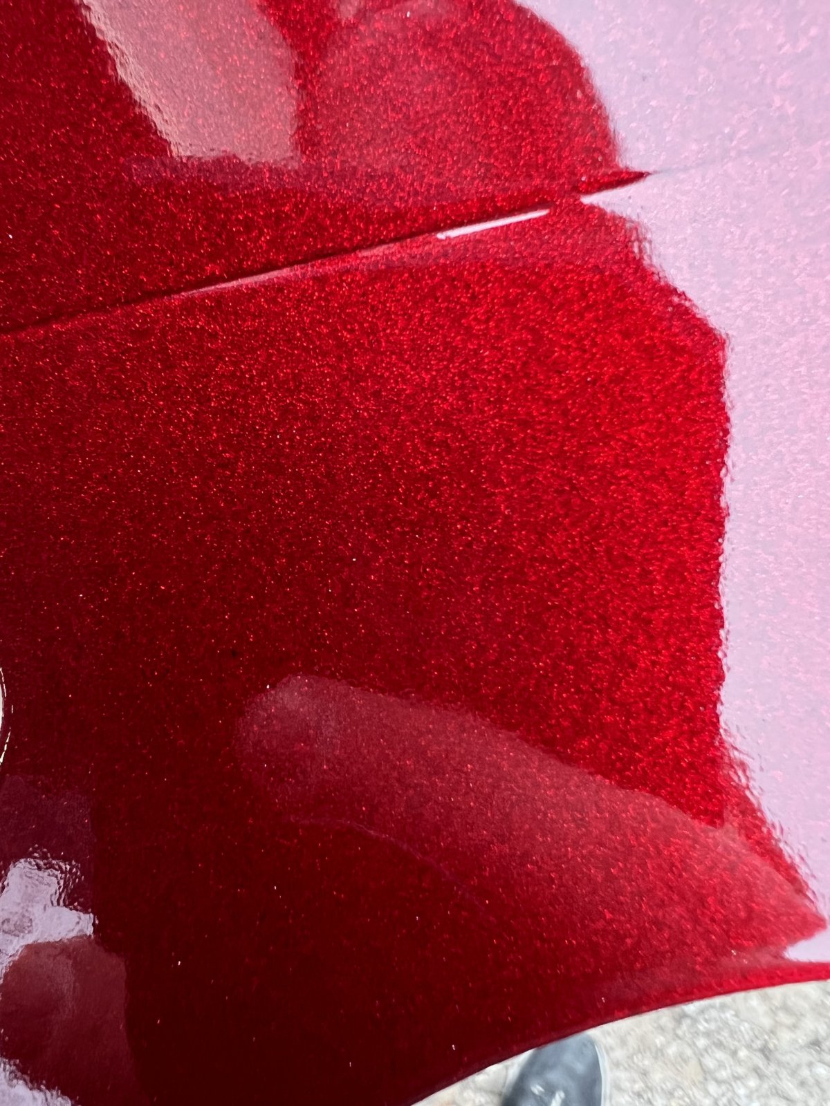

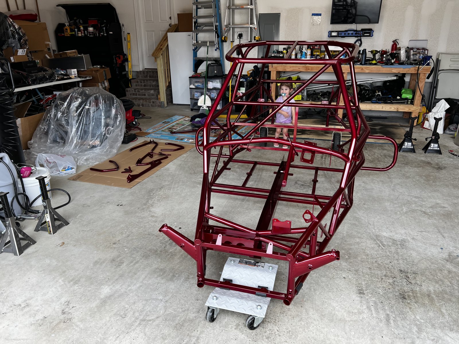

Took the chassis and some parts to get sandblasted yesterday. Plan was to spray paint it after blasting to save some money. But I caved and will be spending $1600 for blasting and powder. Sticking with the Illusion Cherry.

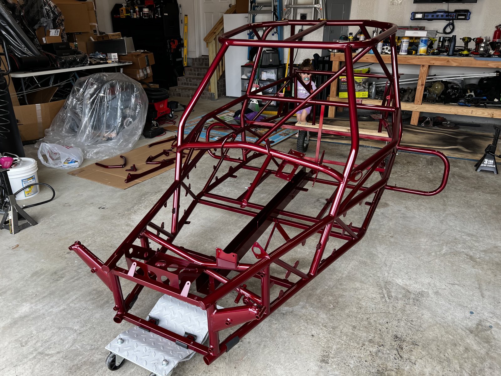

R

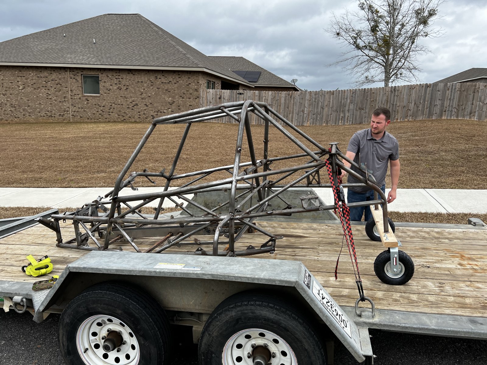

I like what you did here to make it maneuverable!! GREAT IDEA!!
Initially thought I should’ve got rotating casters, but glad I went stationary. Allows for more control when moving it solo so I didn’t hit my engine on the furniture mover next to it. Also put a car wheel dolly under the front so I didn’t have to lift it the whole time. Took it out for transport so it wasn’t as free moving before strapping it down.

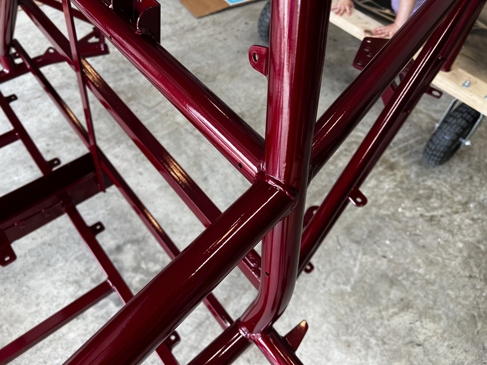

Spoke with the Powder Coat shop and they said chassis and stuff should be done by the end of the week. I spray painted the small pieces gloss black that I wanted and also the subframe.
Added some eye bolts to the subframe for drag chains as well before paint. Should be ready to start assembly early next week (have reserve duty this weekend).

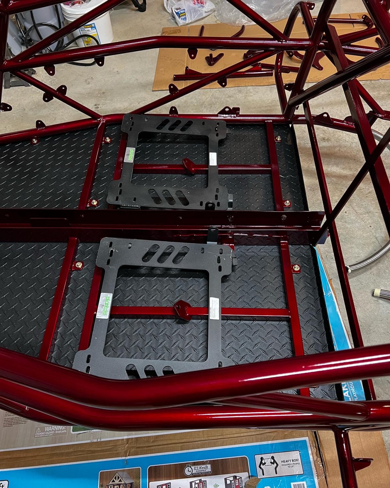

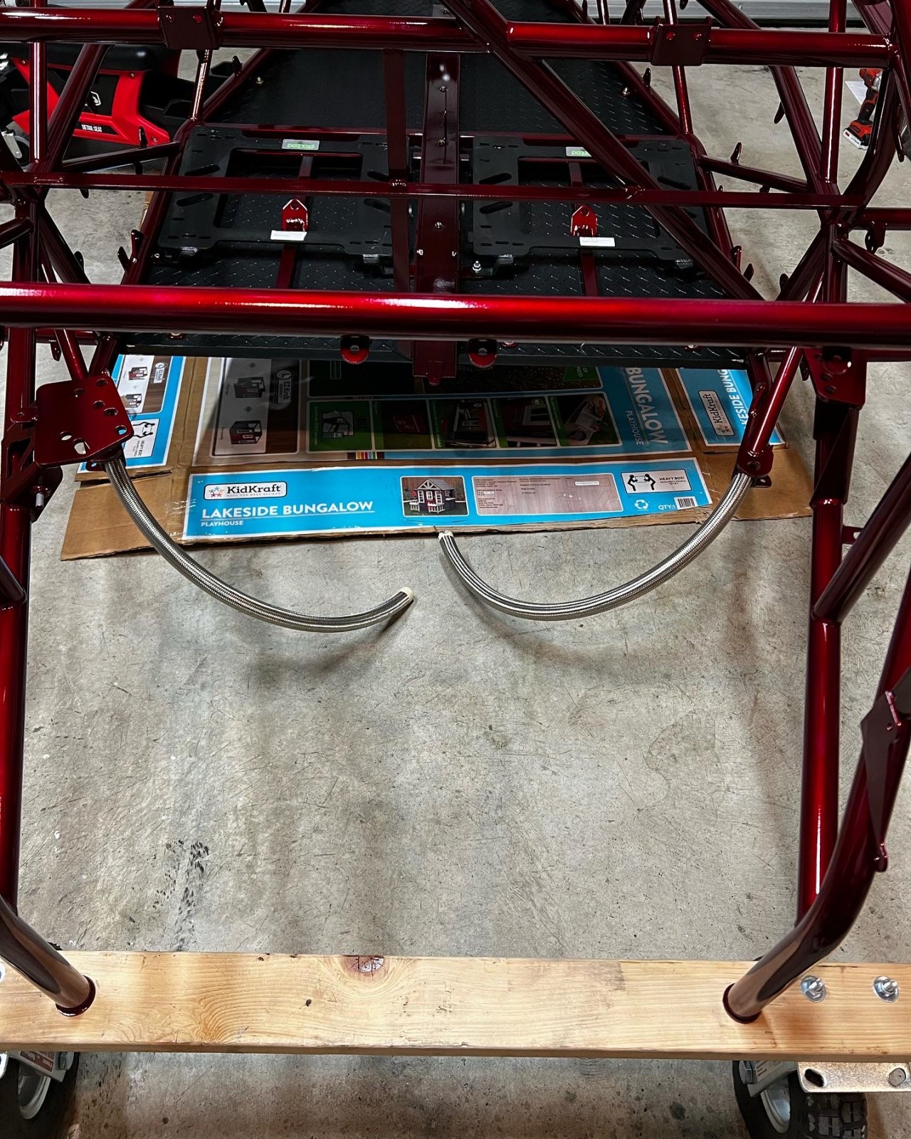

Ran the coolant lines, installed the radiator mount, floor pan and seat brackets last night. Plan for today is install the steering rack, brake and clutch lines, and pedal box. Since I’m going manual brakes, I know this will take some extra time to install.
R

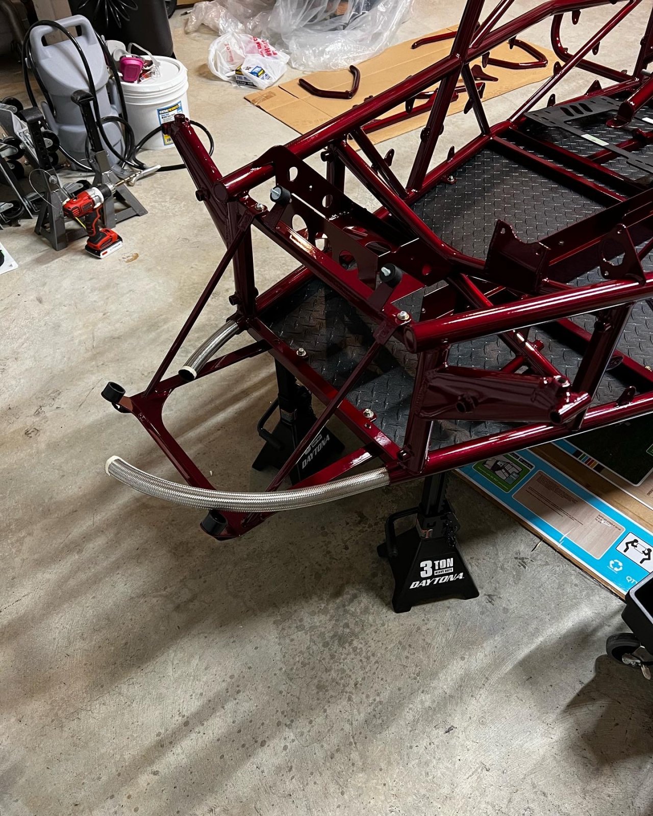

It has a smaller ID than traditional heater hose since it’s -16AN SS line. I was able to feed this through with 1 hand and the other hand stabilizing the chassis. Believe ID is 1” but don’t quote me. Got it here:
Autobahn88 Synthetic Rubber Hose with High Tensile Stainless Steel Braided (Double Layer) compatible with Fluids : Oil, Water, Coolant, Methanol. Silver. (-16AN, 10 Feet) https://www.amazon.com/dp/B019O1XA6...t_i_6GGGHGKF6EFYWKNNBBWM?_encoding=UTF8&psc=1
Using 16AN to 1-1/4” adapters to connect at the radiator and engine:
Moroso 63521 Fitting https://www.amazon.com/dp/B009RL342...t_i_P94876ZMTBZCVQDC0HHK?_encoding=UTF8&psc=1

I may rob your idea. Those hoses change the look up a lot
PaulPerger
Wasn’t my idea, I stole it from someone else on here :p don’t remember who exactly, but it was someone in a more northern state so it was argued it’d be fine there with less flow to the radiator compared to me sitting down in balmy Florida
This is my only concern... I plan to track the car so I think I'll go with the full size hose... BUT, this made me think about dressing up that hose a bit with a sleeve to make it look nice for Cars & Coffee.

I'm aiming for 400whp on my setup and I drive kinda hard normally. I'll report back my temps and what not once I'm built/registered. I'm also going to see how the dual heat exchangers will perform for the intake coolant being in series/parallel to see if it's worth the added cost. I'm also running an external oil cooler so many factors at play. Could also lower the temp at which the radiator fan comes on to increase some cooling.

Nothing a little coolant additive like Purple Ice can't help. I've ran it in a few of my past turbo cars and Temps were 5-10⁰ cooler.
PaulPerger
I read so many of the build threads.... I had forgotten you were the one doing the extra cooling including an oil cooler. That should help with temps a lot. I am sure I will be doing a turbo swap in the future, and will likely add an extra (or much larger) inter-cooler then.
